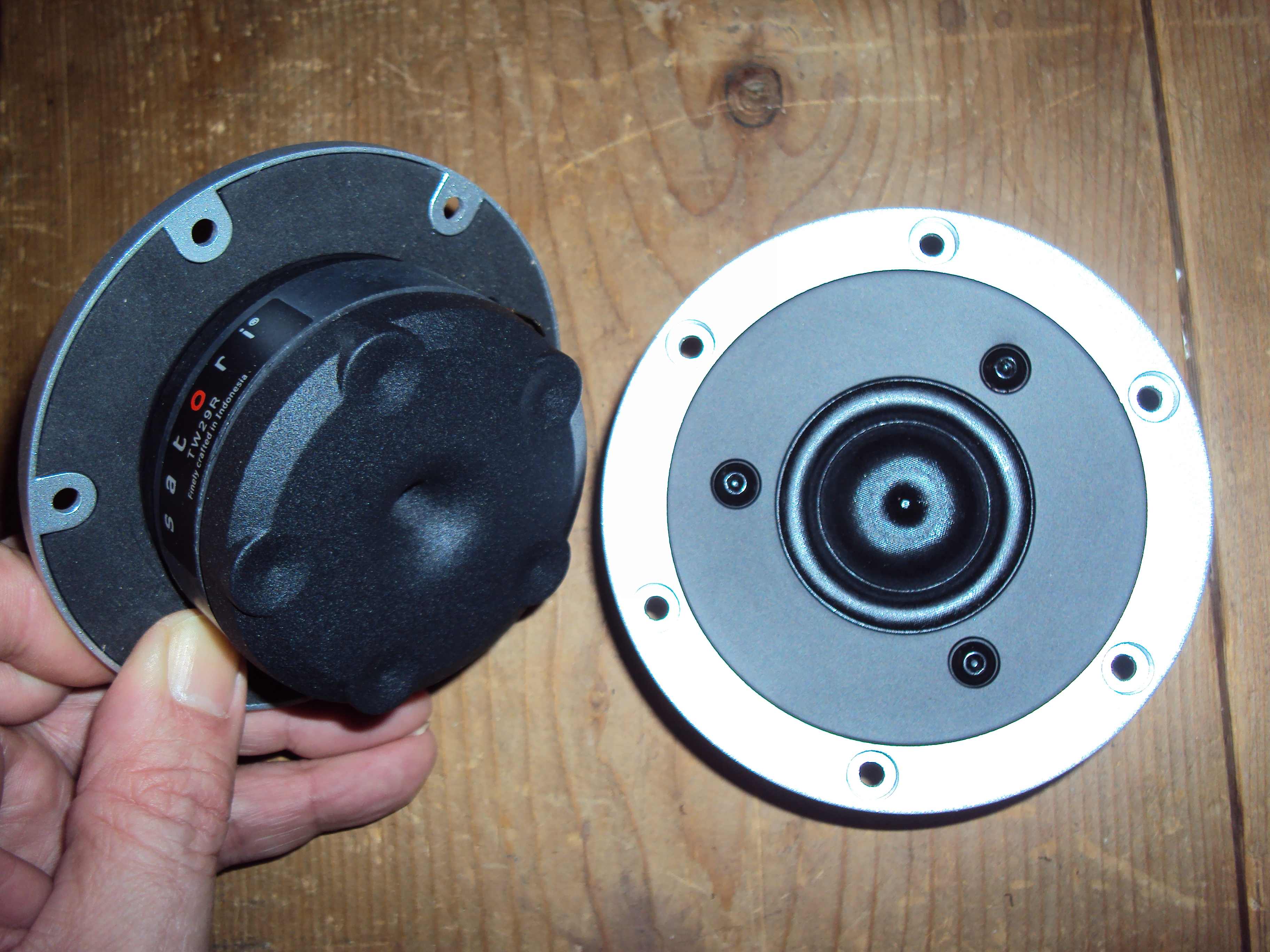

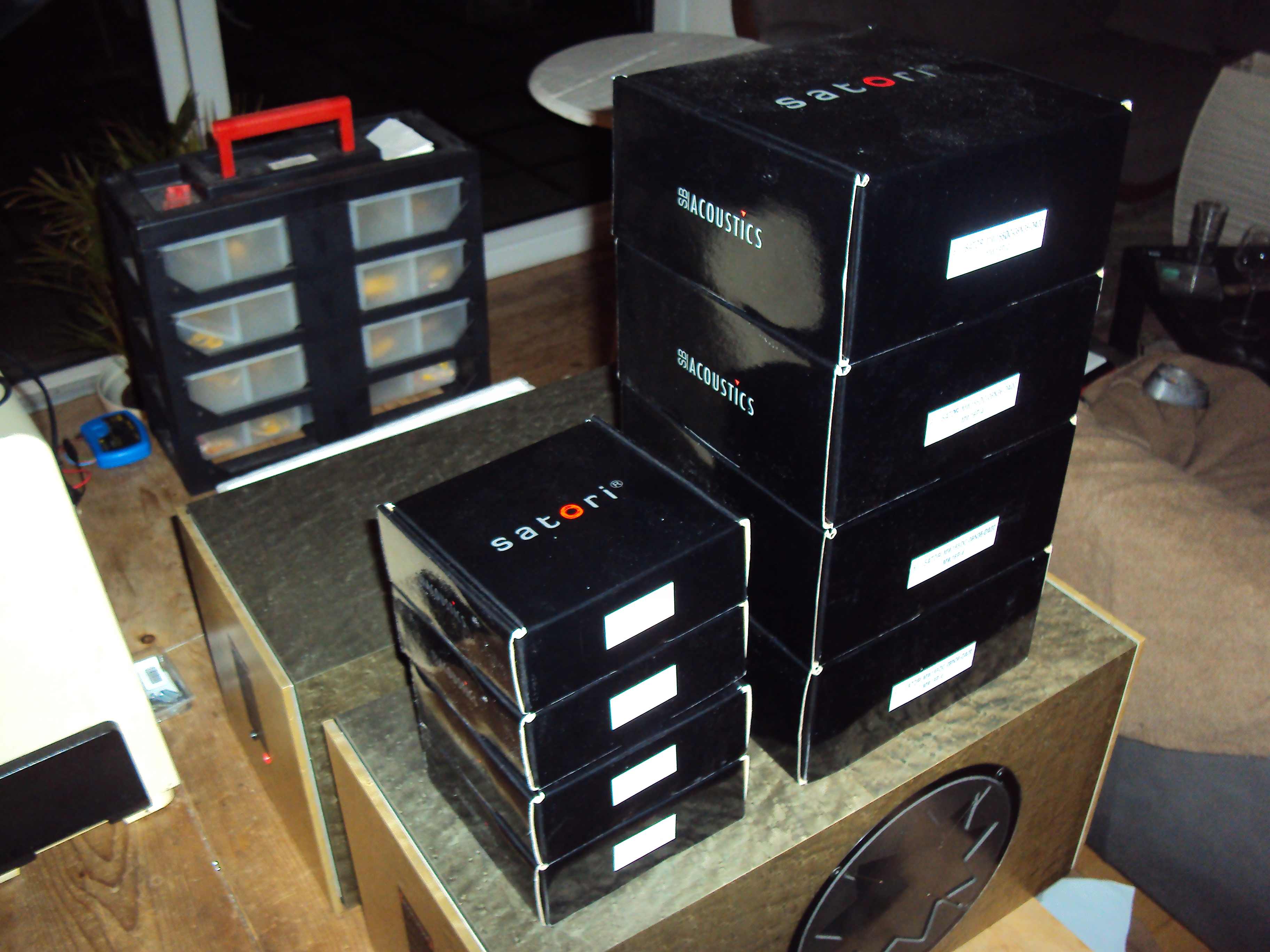

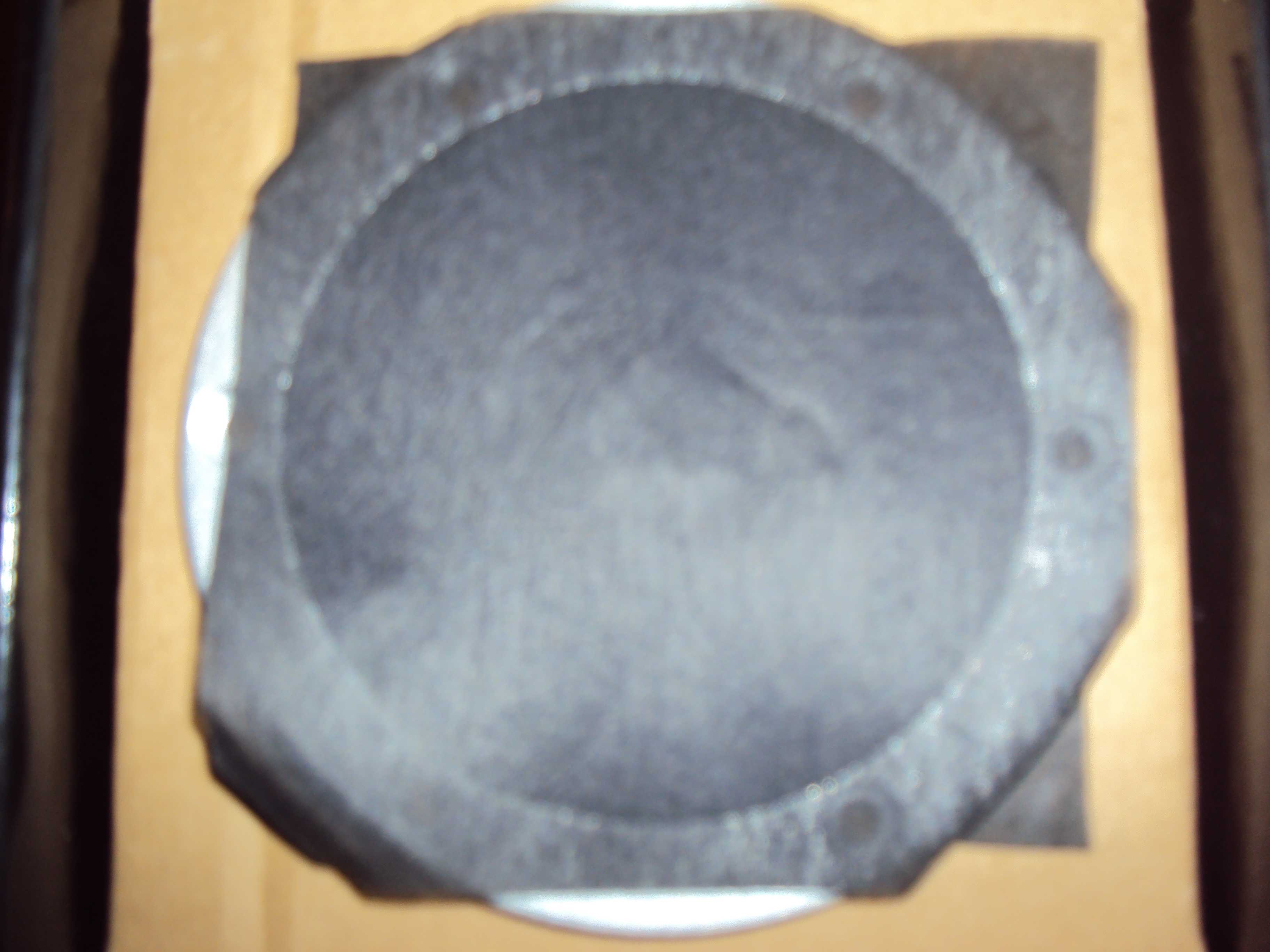

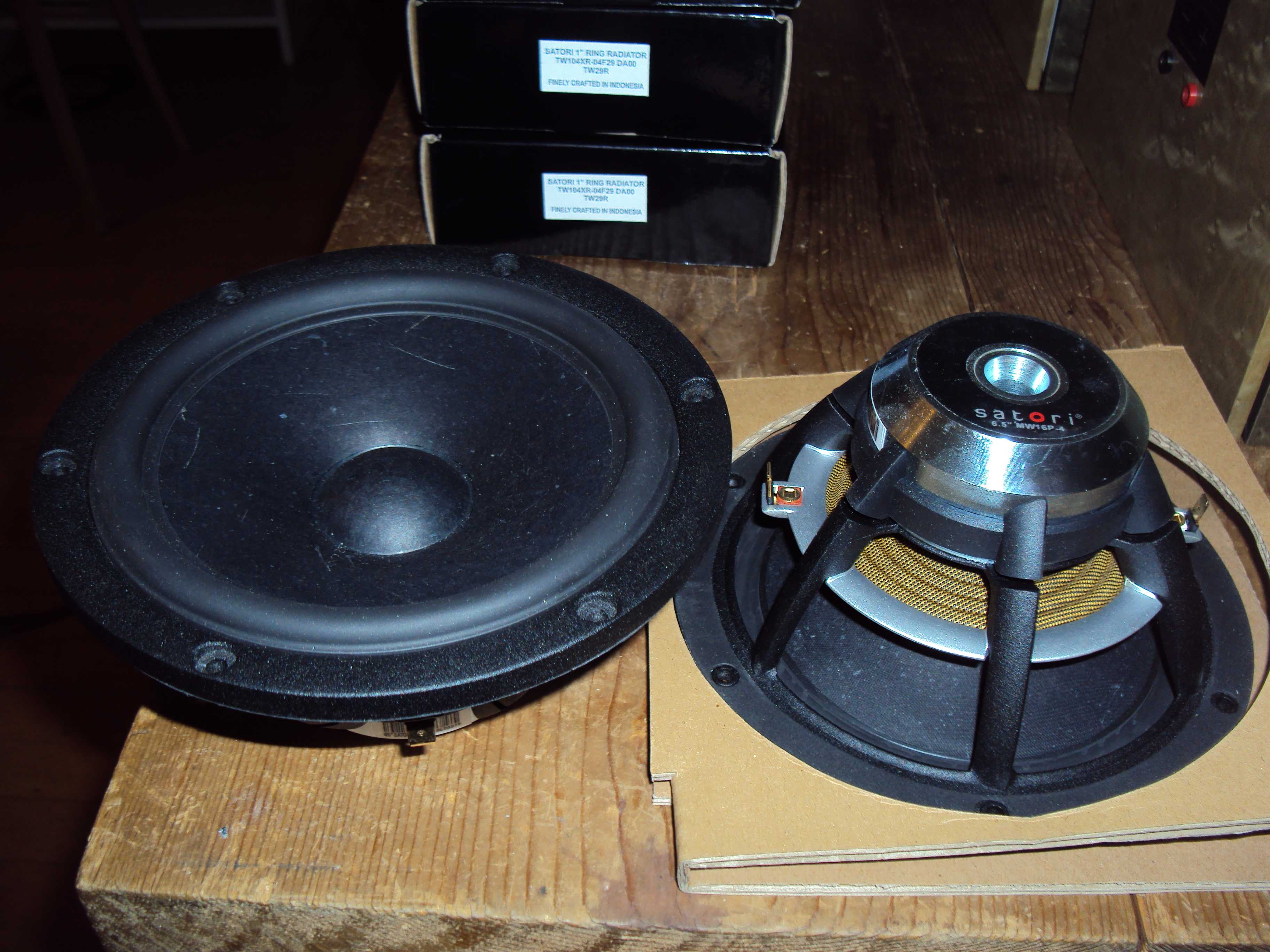

The drivers came well packed and presented, full intact. The woofers are 6 1/2 " and on the market since some month. The tweeter is brand new. When i unpacked them, there was some protection silk over the membrane. when i took it away i saw why. They are so new that the membrane was still a bit sticky from the coating but not so much as to collect dust.

One first commend : The cones of the mid woofer are trumped shaped and from a paper material that contains papyrus fibers. That makes the cones very stiff. Together with the impedance compensation that results in a very extended bandwidth up to 10kHz, as good as many wide band drivers. There is a small hole in the response at ca.1.3kHz. That comes from the very low mechanical damping of the rubber surround. It would be easy to take that away by using a high damping surround or edge coating but that would have increased mechanical losses. It was decided that good dynamic behavior is more important then a small and benign hole in the response. I will measure the units i have here of cause. The data sheet is only priliminary and i am using the 4 Ohm version that may behave differently.

The tweeter looks simply perfect. Low, symmetric and well damped fundamental resonance. Both drivers have a very flat impedance curve so they must have some copper in the magnetic gap. Actually this kind of low rise is a rare sight so modulation from changing inductance over lever is very well controlled. Inductive modulation is a very nasty type of distortion so i am very happy to see this eroded here.

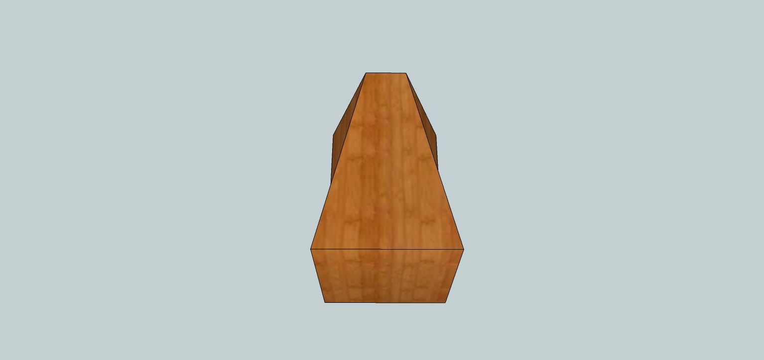

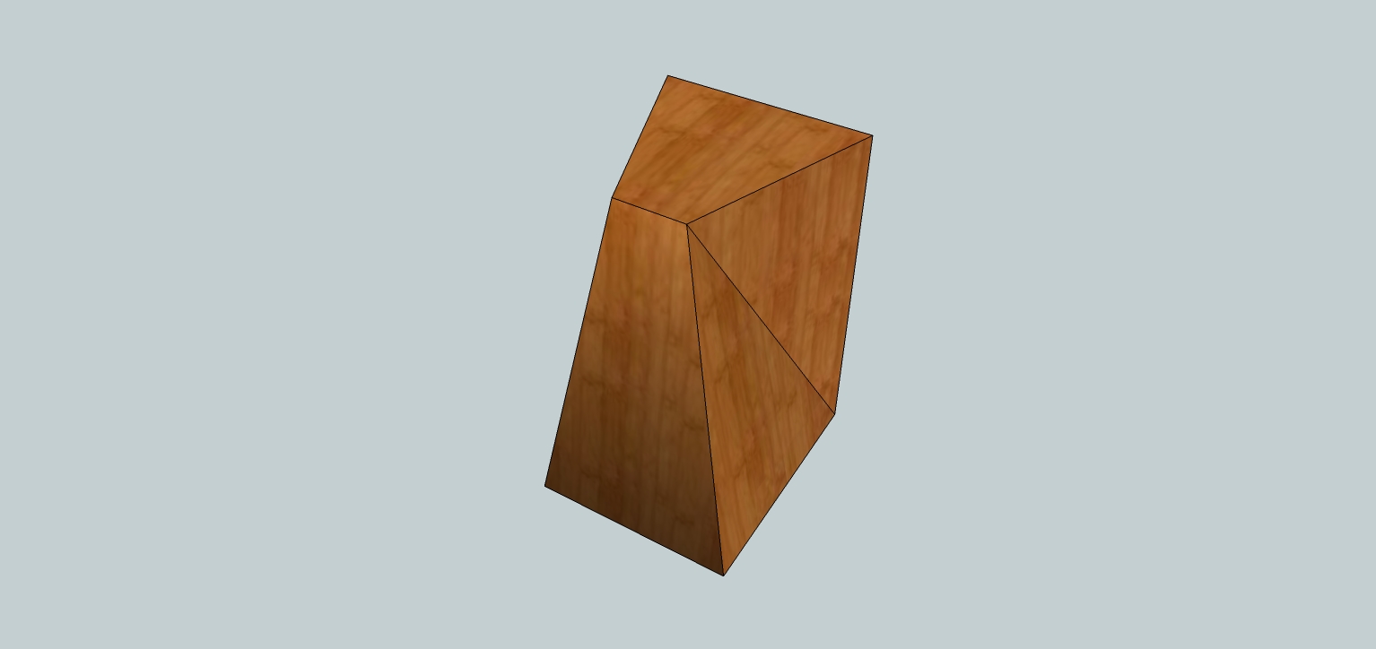

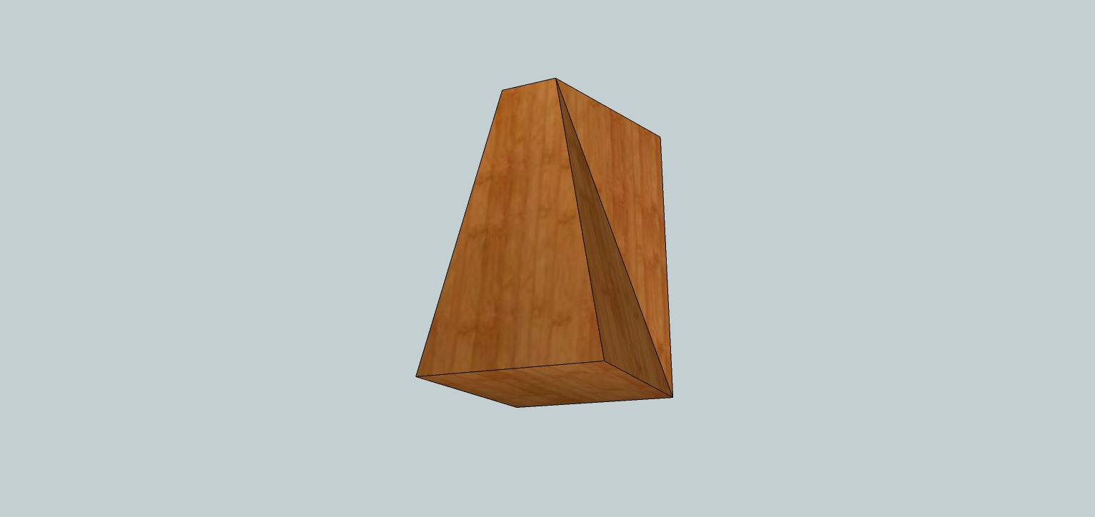

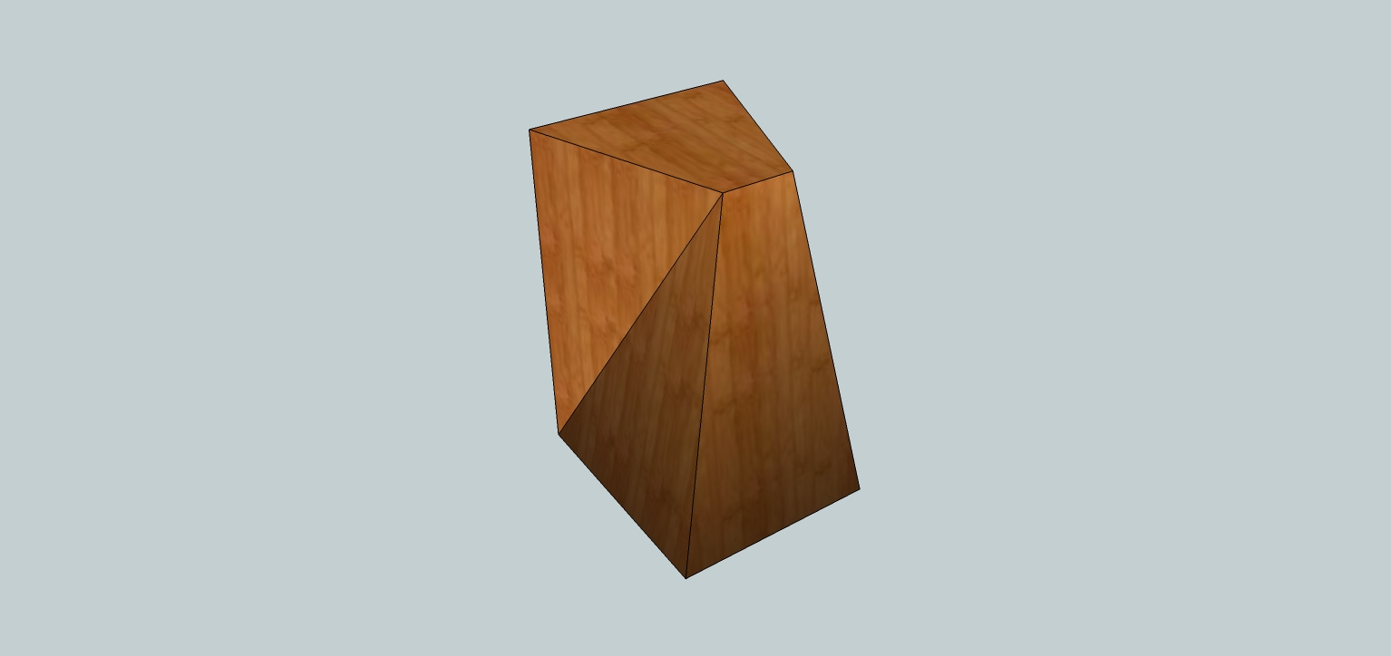

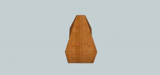

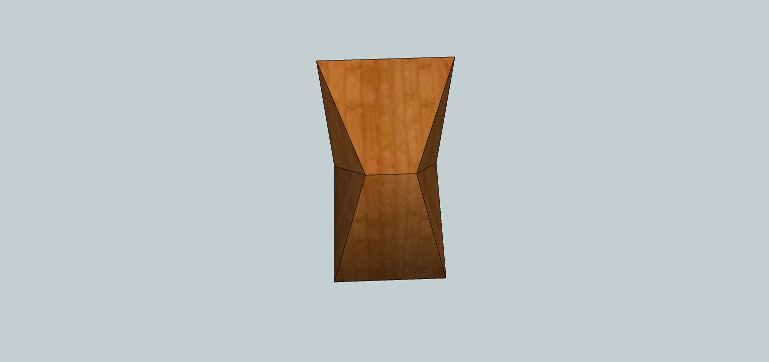

If the kit includes a flat-pack cabinet then some extravagant affair is fine. If not I'd stick with a standard box, boring I know, but if it's to be build-able by the majority then that's pretty much necessary I think.
