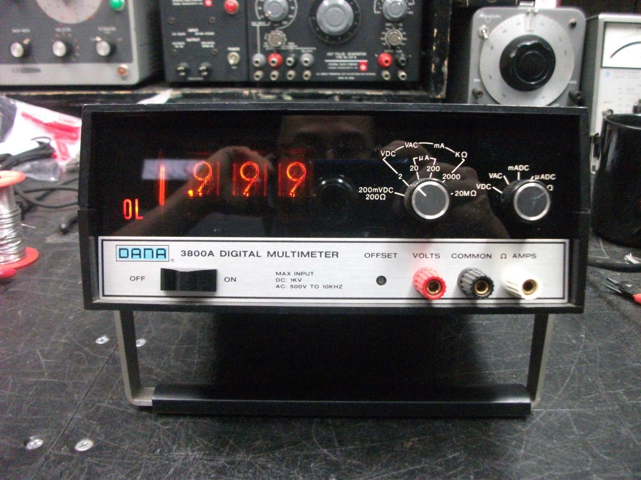

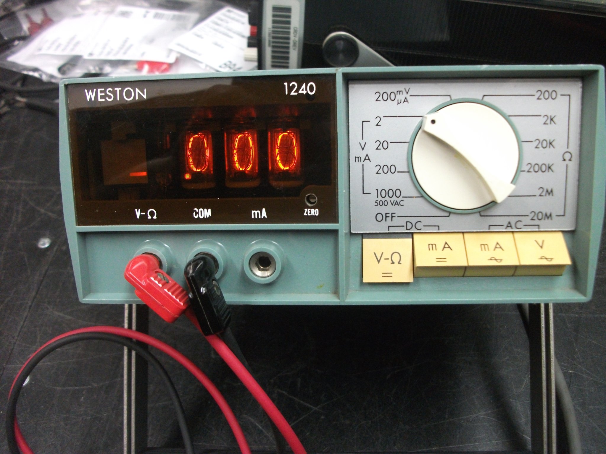

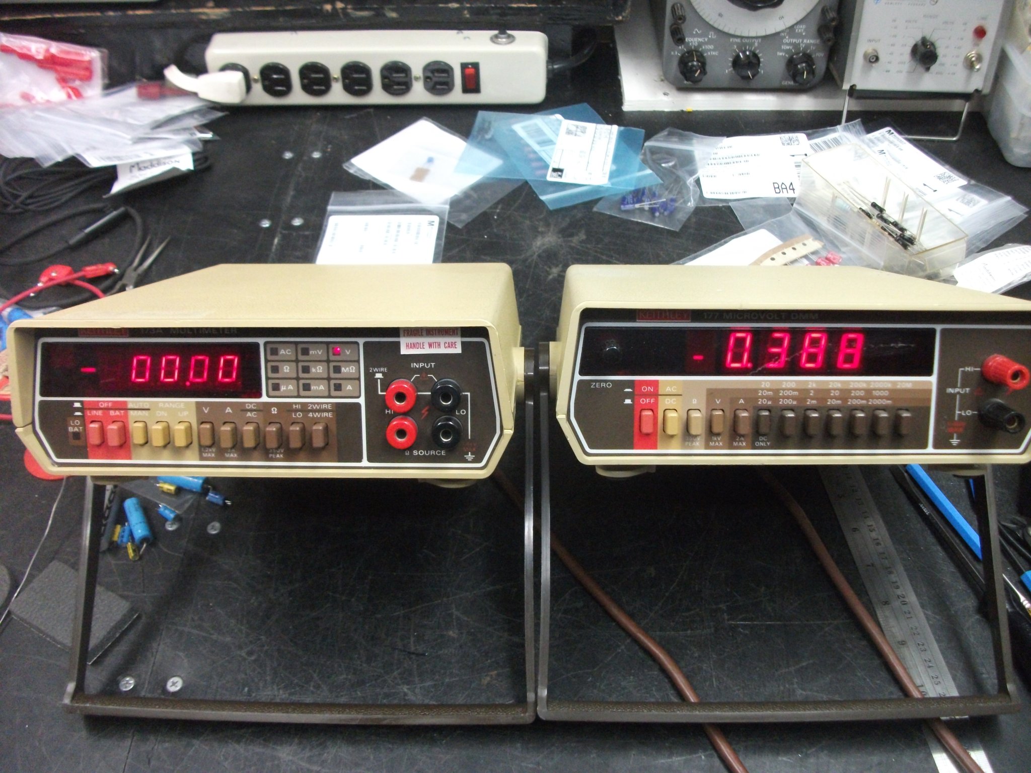

I'm a big fan of both Nixie tube and the big old LED meters. I find it very convenient to be able to read those huge displays without needing to have the darned thing right under your nose or in the work area. They're bright, easy to see and read from any angle or distance, and they look pretty cool too.
My own bench meters include Keithley 173A & 177, Dana 3800A and Weston 1240. My (so-called) handheld is a Simpson 360-2.
