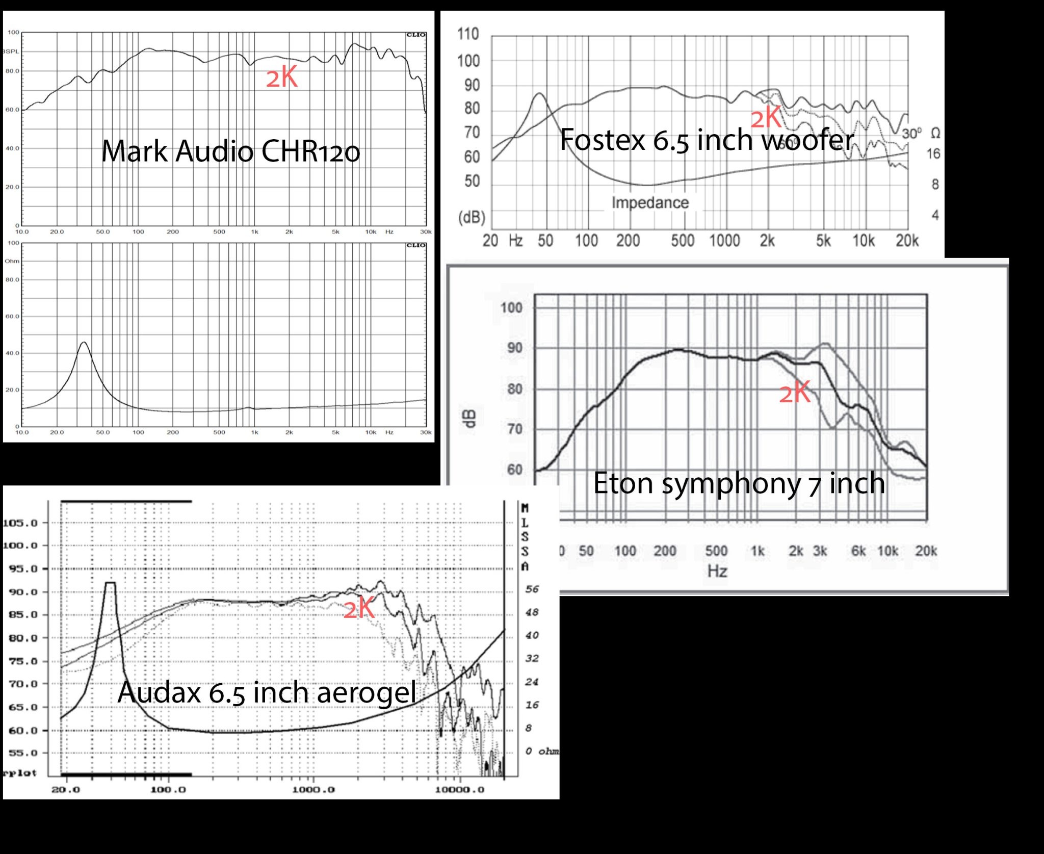

I made up a comparison of 3 well regarded woofers same size as the CHR 120 to illustrate the natural roll offs and break up of standard woofers VS a FR driver at crossover. There is audible benefit to having stability in a drivers roll off response 2 octaves beyond crossover point. Maintaining linearity with low distortion 2 octaves beyond the crossover point in a woofer contributes to a well-integrated, coherent, and faithful reproduction of audio, enhancing the overall listening experience.

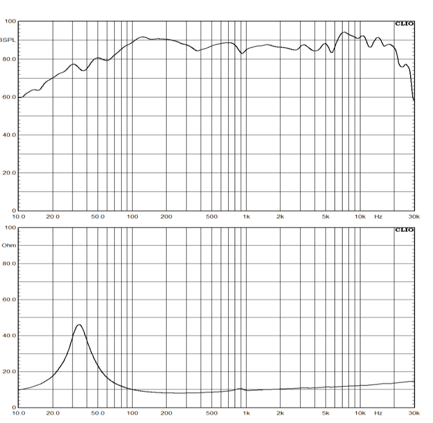

In the post, I emphasized the prevalence of 2-way speakers and their non-niche status. Specifically, I wanted to discuss the technical merits of the FR driver as illustrated, such as the eloquently engineered rise in low bass before resonance. This characteristic eliminates the need for a dedicated woofer, resulting in a 2-way design with robust bass as opposed to a 3-way one.
The benefits of this 2-way design include fewer crossover parts in the signal path, a smaller cabinet size, concentrated financial resources allowing for higher-quality drivers, and improved phase coherence. Additionally, the absence of a dedicated woofer contributes to reduced shipping and construction costs, enabling us to offer a superior product at an affordable price compared to compromised alternatives.

Breakup causes the cone to flex and act inconsistently. You cannot judge the problem by looking at an axial plot, so a flat response doesn't indicate the potential for a better cross.compared to compromised alternatives.
Axial plots play a crucial role in ensuring proper crossover design, especially when it comes to understanding a speaker's on-axis frequency response. While cone breakup and certain off-axis issues may not be fully revealed in axial plots, these plots provide valuable information about how a speaker performs in the direction it is directly facing. The axial plot, which represents the on-axis frequency response of a speaker, provides a fair representation of what a listener may hear when the speaker is toed in at a specific angle, such as 15 degrees.
