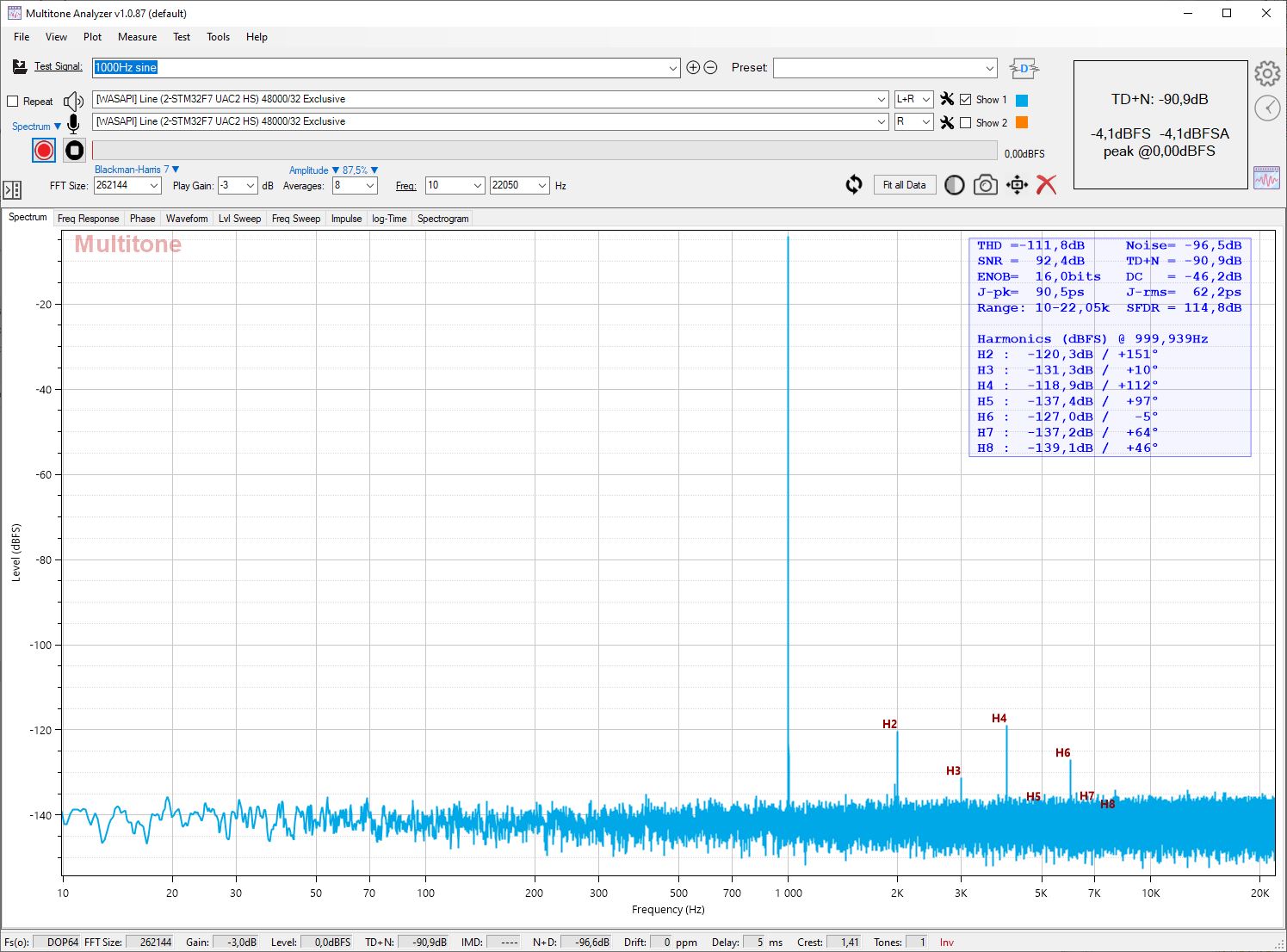

Yes, these measurements are nice but DSC3 measures better.
https://www.diyaudio.com/community/attachments/rtz_1khz-jpg.1199176/
You see THD of -112dB and that is good, but what bothers me is that the fourth harmonic is at the same level as the second one. With DSC3, only the second and third harmonic have some significance, higher harmonics are lower.
My 1 kHz measurement of DSC3
https://www.diyaudio.com/community/attachments/1-khz-png.1192222/
Of course, these measurements are nice and all that, but I do not know how the boards from the previous post sound. They could sound better then DSC3, I do not know. Only people who build them both could say something about that.

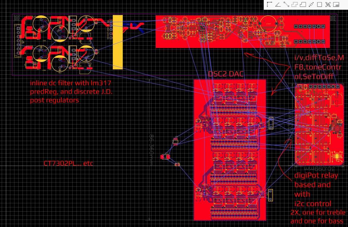

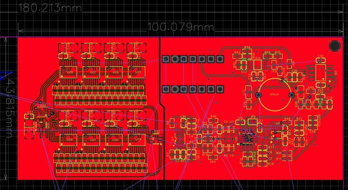

In relation to post 2186 , thats very good replacement for dsc2 audio transformers, in the same time you have possibility for tone control with good result close to sound while using audio transofrmers. My next plan for next half analog audio project will be Hypex Nilai frontend using the same dsc2 (maybe dsc3 if I get any info about it) dac definitely, dsc is good sounding dac with great dynamic and is definitely worth to try, in my case its on my main system, just need to revisit it in next project using better digipot with less thd, in my case I have used one of the Maxim Integrated digital switches with discrete pot resistors which was my bad because analog signal trought Max add noise to my tone control, next plan is using the same Max but this time to control relay based resistor lader with 6 steps for treble and 6 steps for bass, it will sound finaly right : ) I will probably open source that project.
Just to share revised concept, work in progress, hope usefull. Configuration will be fully dual mono. Dac dual mono, smps dual, power amp.... etc for dual mono configuration : )
Main care was done to dsc2 frontend. All the gnd signal line gnd is fully separated from supply line, canaling those grounds so that every part of the frontend is on their gnd canal, whole pcb canaled, with their ref gnd at ina849 which doing the magic things here. : ) And also relay based tone control is another improvement. Dual mono in comparation to previous design as stereo variant. New opa1633 instead of opa1637 as i/v. Shileding smps and power amp from fine circuity. All the tings when sumed in comparation to my single pcb stereo variant it will be definitelly better and sound better, measurement too : )

Work in progress on diff DSC dac monoblock with their diff frontend, main care to canaling DGND, signal GND and REFGND from the supply GND at a center at REFGND, I'm expecting pcb size around 200x180 with all the things inside, ct7601 as a isolated usb bridge, ct7302 as a heart of pcb with their 4x optic inputs, 3x i2s inputs. Power supply is torus transformer 50VA with 5X secondaries, two for upper monoblock two for lower monoblock, and one 5V for rpi4 and DGND things. Pre regulators is lm317/337 with postregulators mini J.D. super regulators. Looking for low dropout linear regulator 3A for rpi4 and J.D. 5V will be for dsc, digital things also their regulators. Booth will form main pcb for an power amplifier 2x monoblock with their smps supply.
