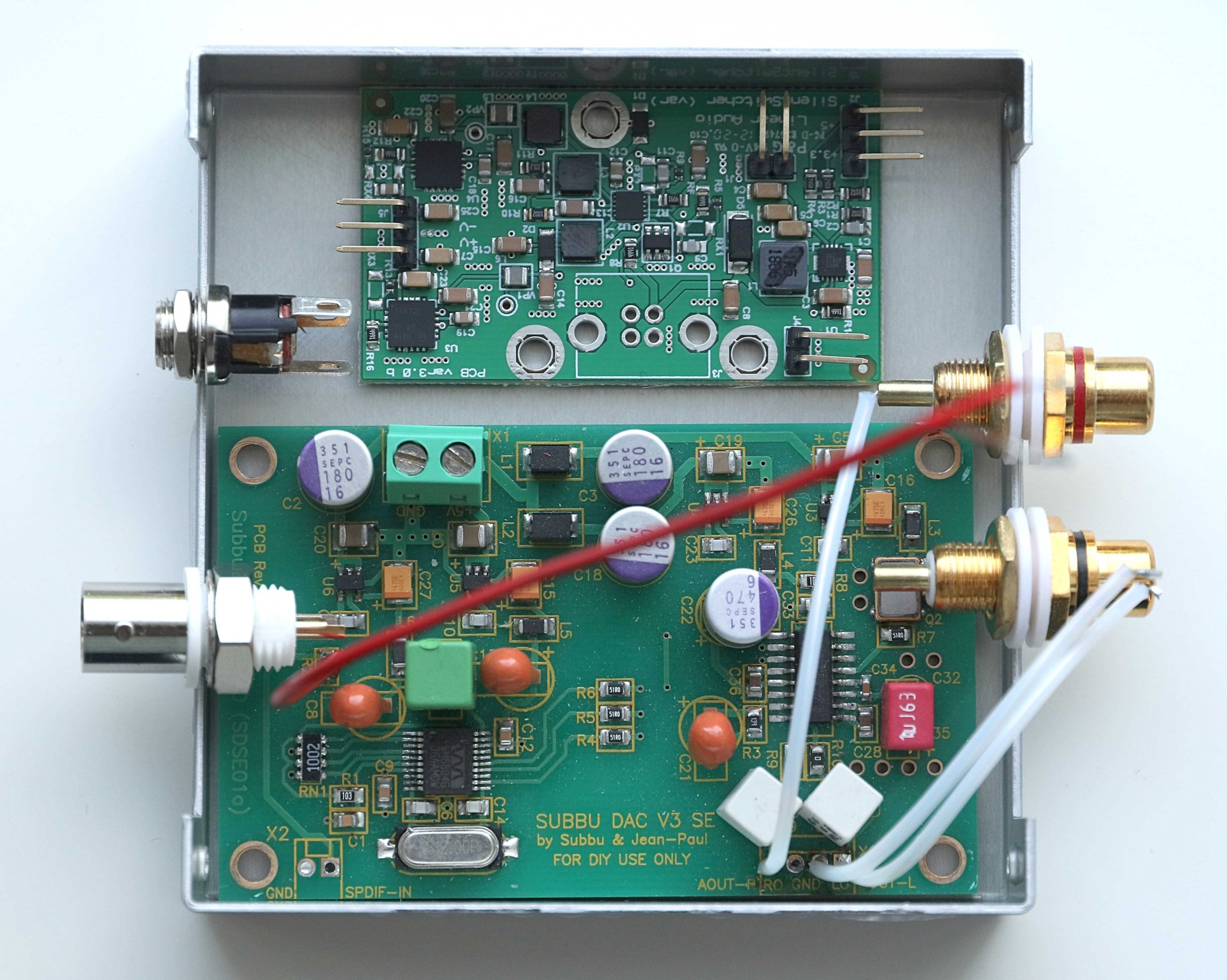

Not really, but I would move those RCAs to the bottom of the case where the text 'FOR DIY USE ONLY' is.
Ideal position with very short wires.
Why place them close to the supply and running unnecessary long wires to them?
And move the DC input jack up, away from the DAC, because that jack carries pulsating currents.
Move it all the way up as far as it can go.
