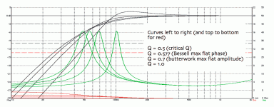

Neither of the 2 1st mentioned Peerless are suited for sealed & bass production.
Standard sealed sims & a BR sim for each attached.

I wish I was at a point in my learning that I could make sense of those graphs, but I can't. I do have a question though, I'm trying to learn about using the Linkwitz Transform through the minidsp to add to the lower end. Would that help in the decision of using any of these woofers in a sealed enclosure?

If you can't understand those sims, you might have trouble with an LT because they are the starting point.
Basically an LT is a specific EQ that extends bass response. This requires more power and uses up excursion quickly.

is there a legend that describes what the color lines represent?

The ledgend under each vertical scale is in colour and is the legend.
Purple for (Impedance) Phase, Black for Magnitude (ie frequency response), Red for Excursion, Blue for (Group) Delay, Yellow for Impedance (Magnitude)
Information about each alignment in the bottom right panel.
