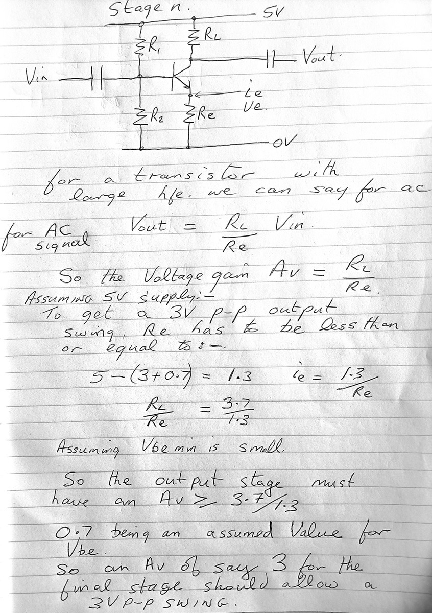

@rayma Agreed that OpAmp solution is easy option but its still interesting to do this with discrete components using a few 2N3904. In fact if I were doing this I would be tempted to do two versions one with an OpAmp and one with a few 2N3904 and compare performance of both designs. The comparison could be done between physical built designs and using the simulator.
I think the output voltage maximum peak to peak voltage swing mentioned of 3 volts can easily be achieved by a 2N3904 design.

As for the AC gain Av - for a transistor operating with large hfe Av = Rc/Re as long as Av is low.
To understand this for an ideal transistor think of this "voltage divider bias" circuit as a Emitter-Follower where the Emitter AC voltage follows the input AC voltage. Now its clear that
ie = Ve/Re and since ie flows through Rc then Vc/Rc = ie so Vc = VeRc/Re so Vc/Ve = Rc/Re since Ve follows Vin and Vc is Vout then Vout/Vin for AC signal equals Rc/Re and we can write Av = Rc/Re
For low distortion the key is to set an operating point (using bias resistors) to work at maximum hfe, also keep Av low for a stage. Assuming three stages in series, for the first two Rc needs to be low compared to the next stage R1//R2 for the output stage Rc can be higher because it feeds into a high impedance load.
So hfe >> Av needs to be true. Typically Stage 1 might have an Av of 10 stage 2 might have an Av of 10 stage 3 should have an Av of 3 - Total Av AC input to AC output then is 300 and will remain stable.
Any distortion will be because hfe is finite.

I am trying to do a low distortion class A amp that scales a voltage from 50 mVpp to 3Vpp. The output has to be in phase with the input, so I've added another 2n3904.
My main technical hangup is deriving the internal transistor resistance, sometimes referred to as Ree. Wouldn't it just be the Voltage drop divided by the base current? Vforward/ib?

You are right to choose collector current based on something like rise time performance but in this instance rise time is way faster than what you need for audio frequencies. Better to choose collector current for things like maximum hfe and noise performance. After another look at the 2N3904 datasheet it looks to me like a collector current in the 1mA to 10mA range would be good.

That would kill the bias for the transistor. You'll probably also want a capacitor on the output of the amp.I also recall that I forgot the input cap, so the input was dc coupled to the signal generator
Usually in a single-ended design like that one designs for around 1/3 of the supply voltage at the base of the transistor and 1/2 to 2/3 of the supply voltage on the collector. Keep in mind that the output impedance of the amp will be high-ish, so your 1 kΩ load might be too heavy for the amp to drive.

3vpp which the circuit appears to be doing per the simulation above thanks to your suggestions. I've no idea how much distortion is really there, however. Voltage gain over all needs to go from 100mVpp to 3Vpp, so 30.
but the real world hfe is 100 instead of 300 and that would even vary with current
The average HFE at 5V is 40 with 2n3904 the ones I tested here.@MarcelvdG If the input coupling capacitor shown in the circuits given by @rectifryer is by chance left out, the low output impedance and any DC offset of a typical signal generator will completely destroy the DC bias, operating point and AC gain provided by R1, R2, Rl and Re.
Same sort of comment applies to the output.
If the resistor values were correctly calculated and the voltage gain was quite small compared to hfe then the distortion would be small and can be calculated. Typically a design voltage gain of say 3 would work really well if the transistor had a hfe greater than say 300.
