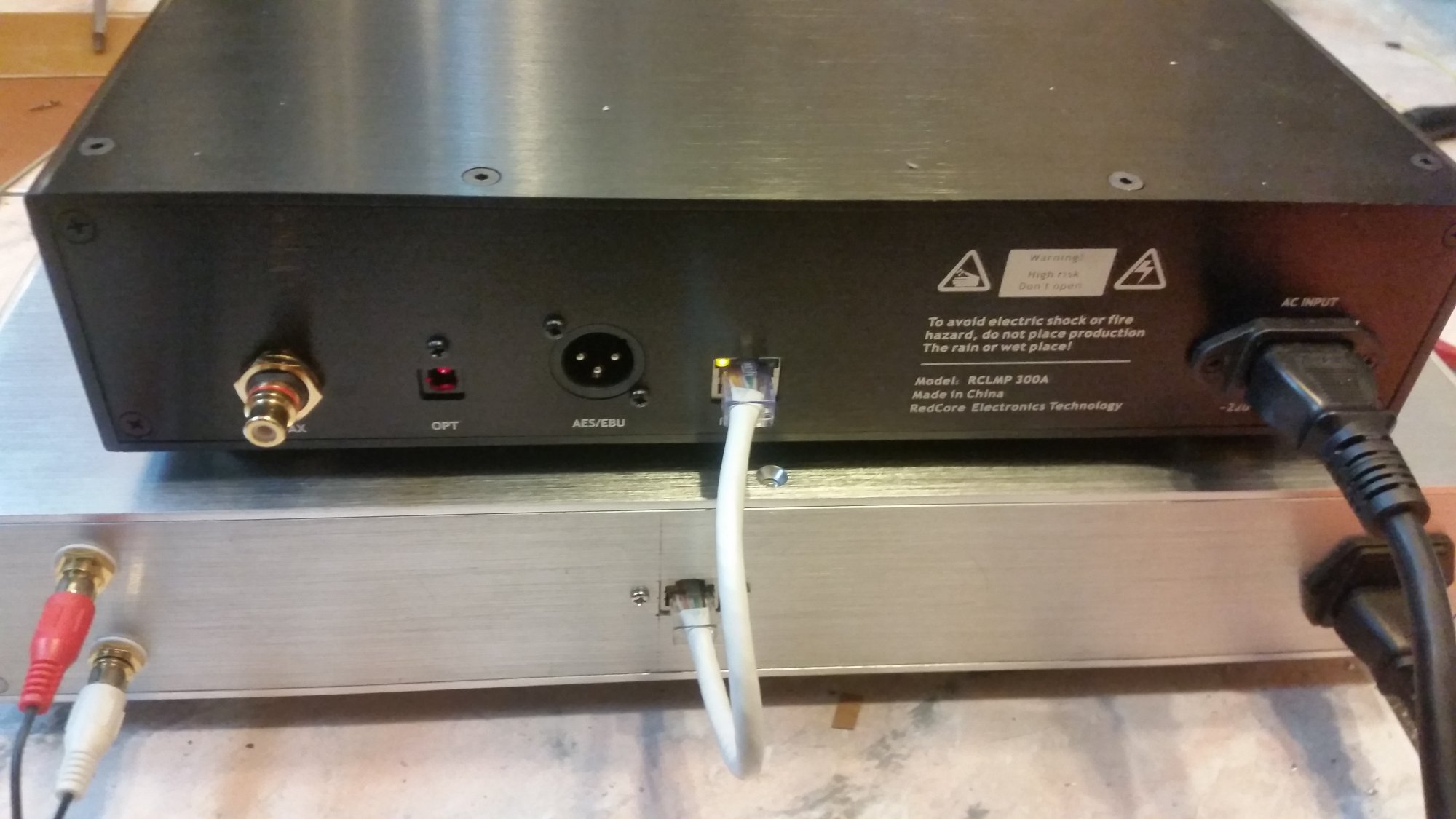

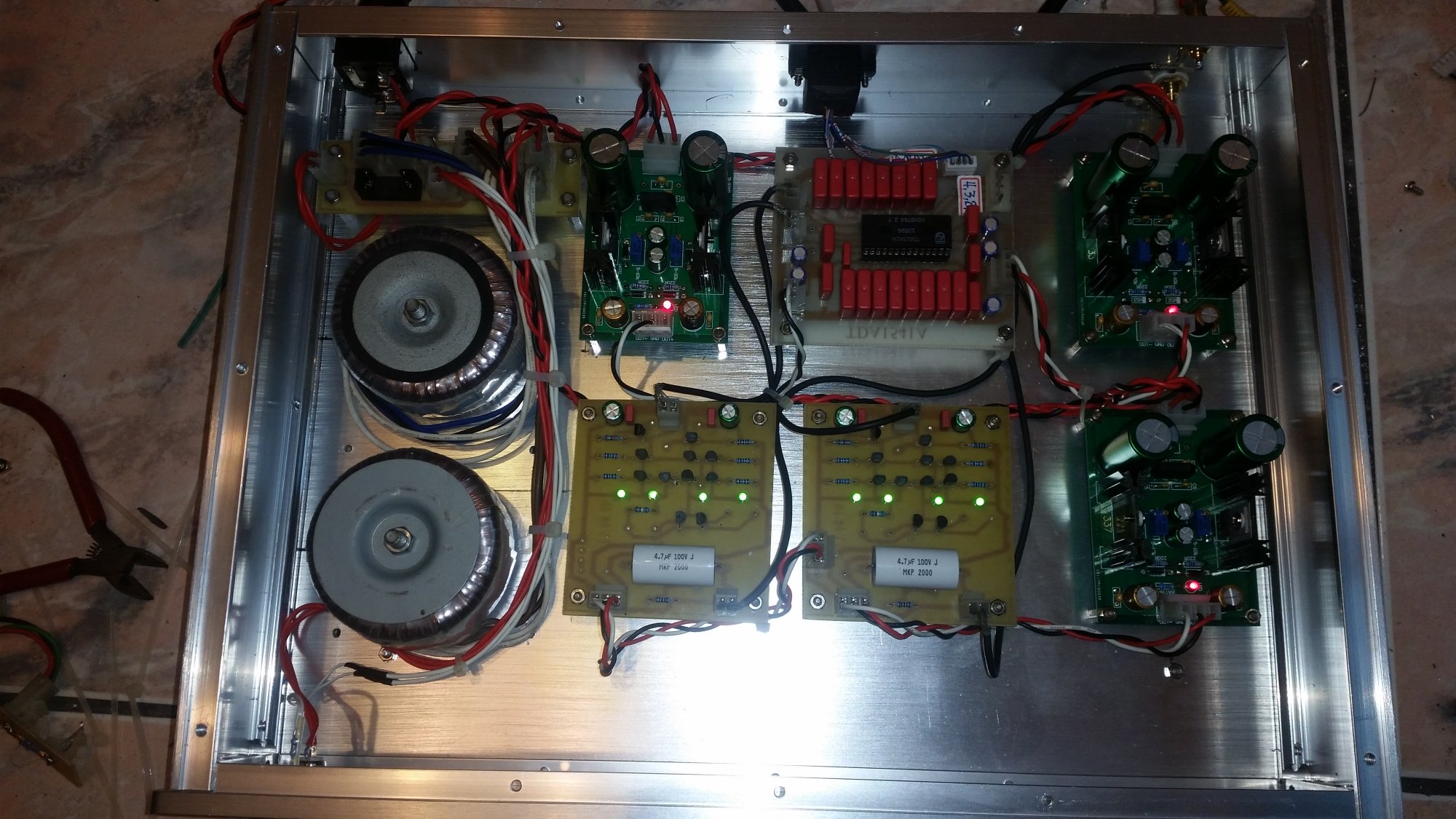

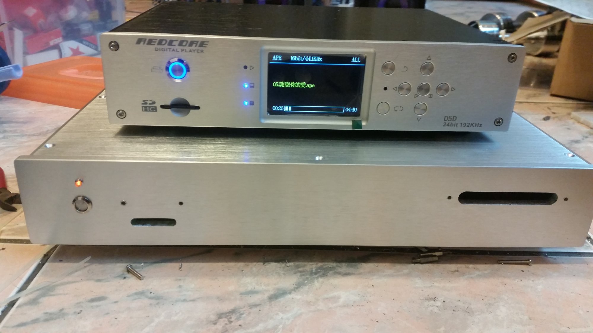

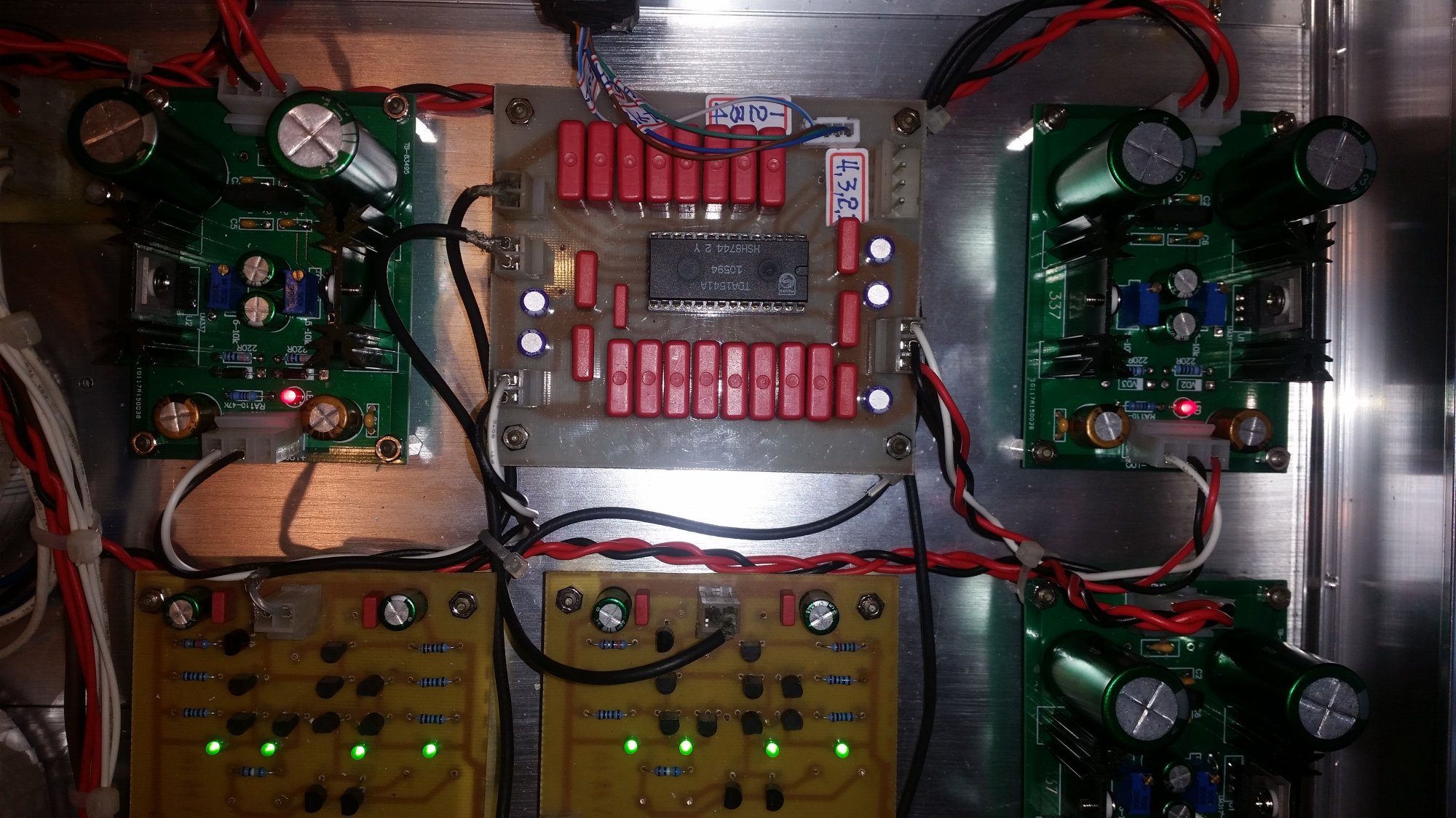

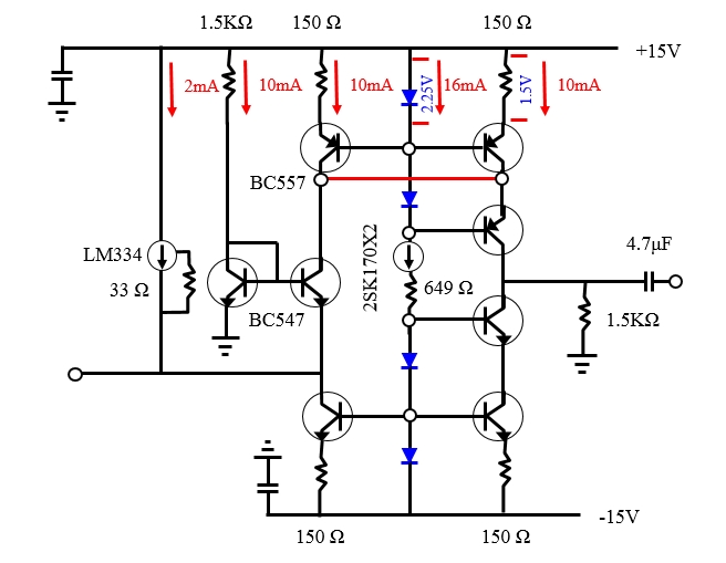

Recently I rebuild my I2S input TDA1541A DAC, where simple IV converter is used. The IV converter had been slightly modified as shown in attached files. A SD card player with I2S output is connected to this DAC, which works perfectly.

I had been using opamps for I/V like most others, and much preferred the LM6172 as least evil above others like OPA2604, AD811, LM6181, AD797, OPA627, AD828, AD826, AD825, etc. etc.
About 1.5 years ago I made a real big step forwards using circuit shown; applied it to TDA1541 and TDA1543 cd players.
Didn't use opamps as I/V anymore since then.
The common base circuit is another step forwards and to quote Droopy "I'm happy".
If the Thorsten proposed circuit SOUNDS better, I'll use it, it is minimalistic enough for my DIY activities.
