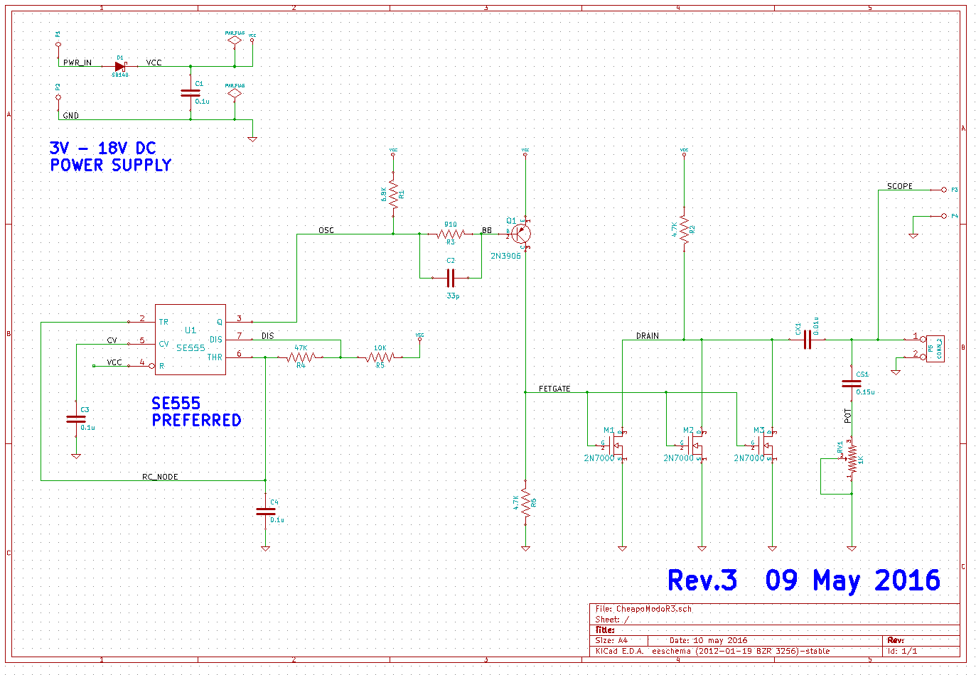

It's possible that your Cheapomodo board is faulty and has no output. That would be one possible explanation for the observation of no output waveform with an oscilloscope.
For example if diode D1 is soldered poorly, or if it is installed backwards (!!) then there will be no power supply voltage for the 555 oscillator. No supply voltage means no output waveform. You can verify this with your digital voltmeter by
1. Measure the voltage between PWR_IN and GND (upper left of the schematic).
2. Measure the voltage between circuit node "VCC" and GND. VCC is found on pin 8 of the 555.
Both of these measured voltages should be very very close to the output of your battery or power supply. If one or both of them is low, you've found a problem.
Another possibility is that your 555 chip is faulty, or installed backwards. You can test that by connecting your oscilloscope to 555 pin 3 (circuit node "OSC") with the scope ground clip connected to circuit GND. With the vertical amplifier set to 5 volts per vertical division and the horizontal sweep rate set to 2 milliseconds per division, you ought to see a square wave on node OSC. THESE ARE NOT THE IDEAL SETTINGS TO OBSERVE TRANSFORMER RINGING !! THEY MERELY SHOW YOU THE ENTIRE LOW-FREQUENCY SQUARE WAVE ON NODE OSC.

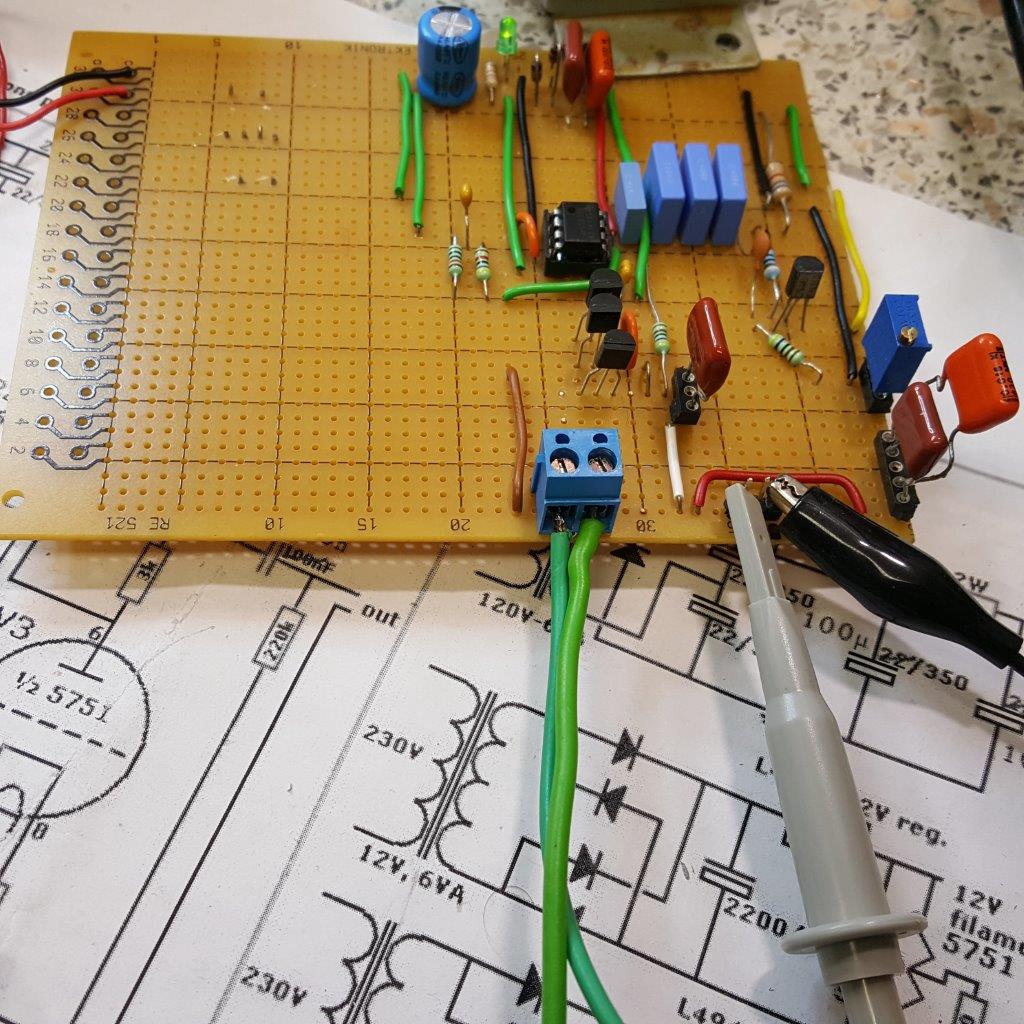

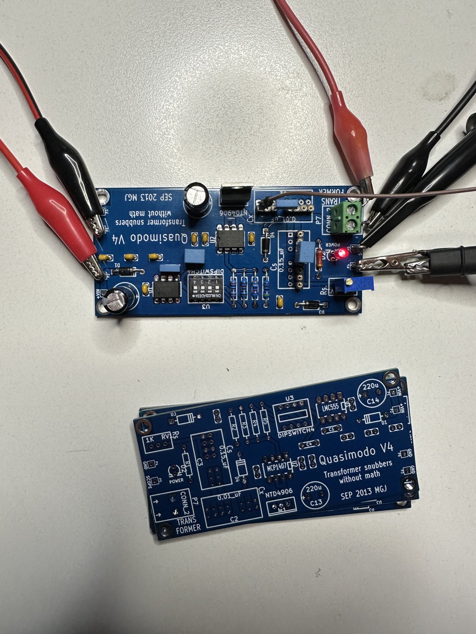

Good afternoon sirs.

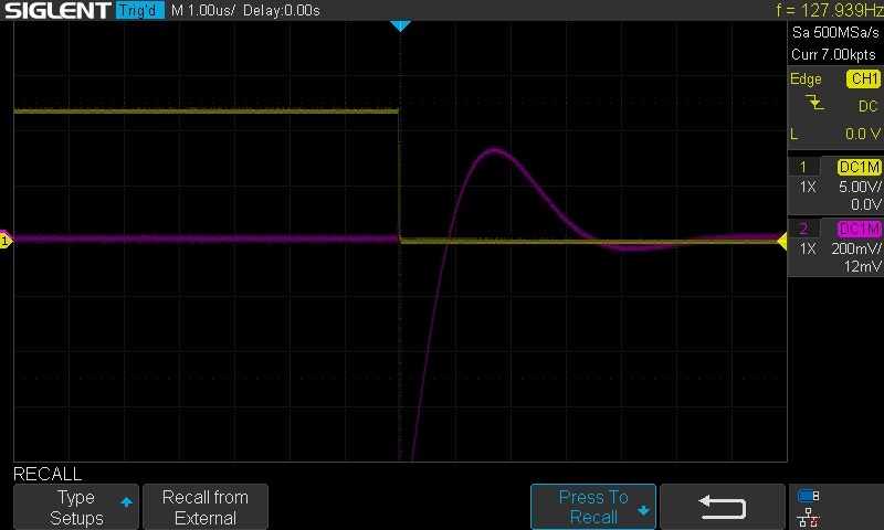

As you told me, Mr. Mark, I checked the output of pin 3 of 555, and indeed a square wave signal comes out as you told me, I checked the breadboard and the problem was the lack of gnd in the connections that go out to the oscilloscope.

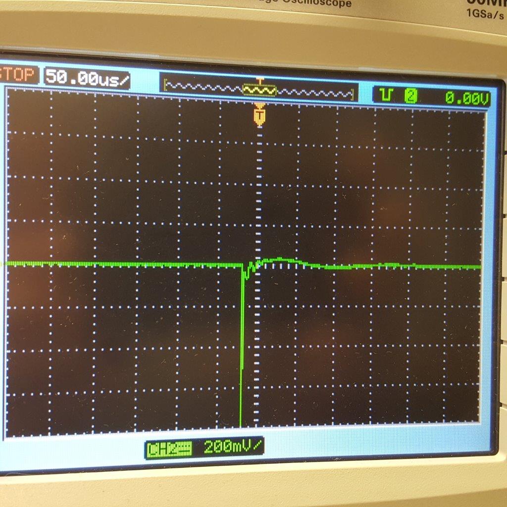

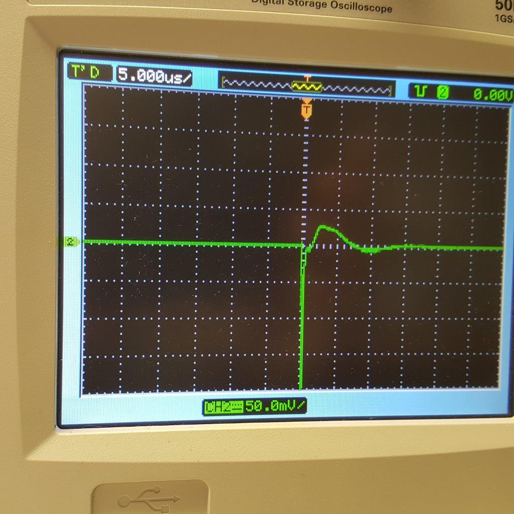

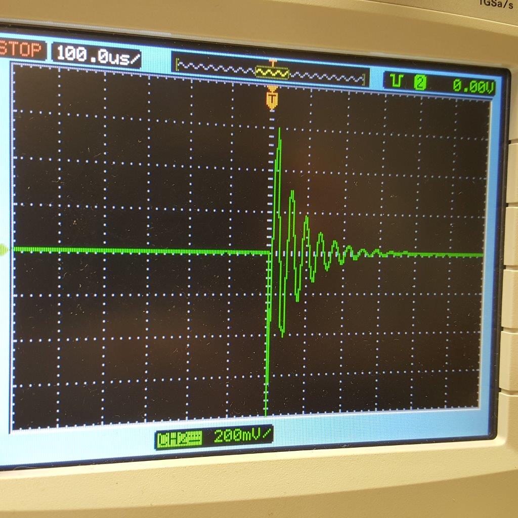

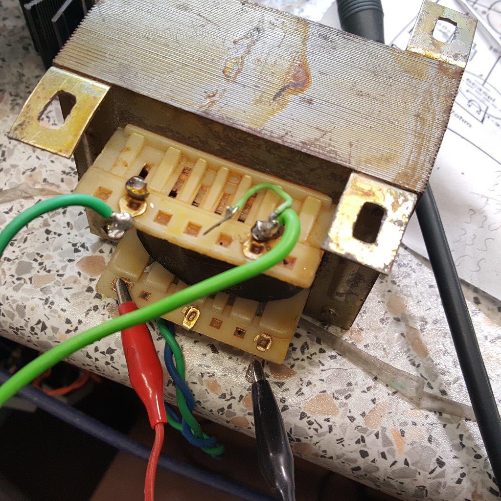

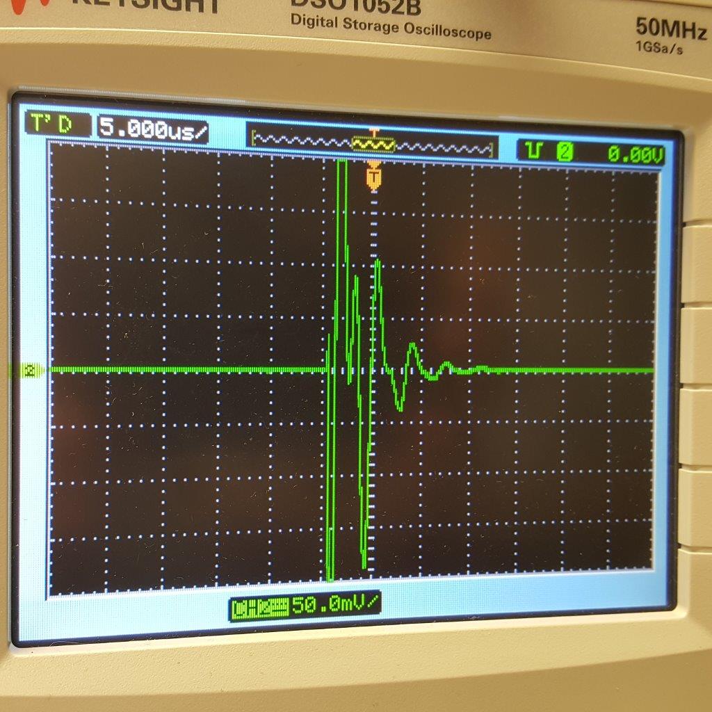

I have attached photos of a small transformer, which works fine but with different oscilloscope voltage and time bases (perhaps the bc546 is the cause of a low output signal), with CX 10nf and CS1 150nf, the resistance resulting was 90 ohms.
Another photo attached with a bigger transformer with CX 10nf and CS1 150nf and the resistance of 22ohms after the correction.
What opinion do you give me regarding the low outputs that are represented on the oscilloscope?
Photo #5 is just about perfect, congratulations.
Photo #2 is not perfect, you have flattened the trace too much. Go back and do #2 again until you get a waveform with one up bump and 0.1 down bumps.
Also watch some videos about oscilloscope triggering, your photo #6 has poor triggering.
