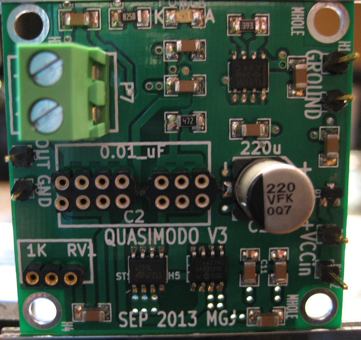

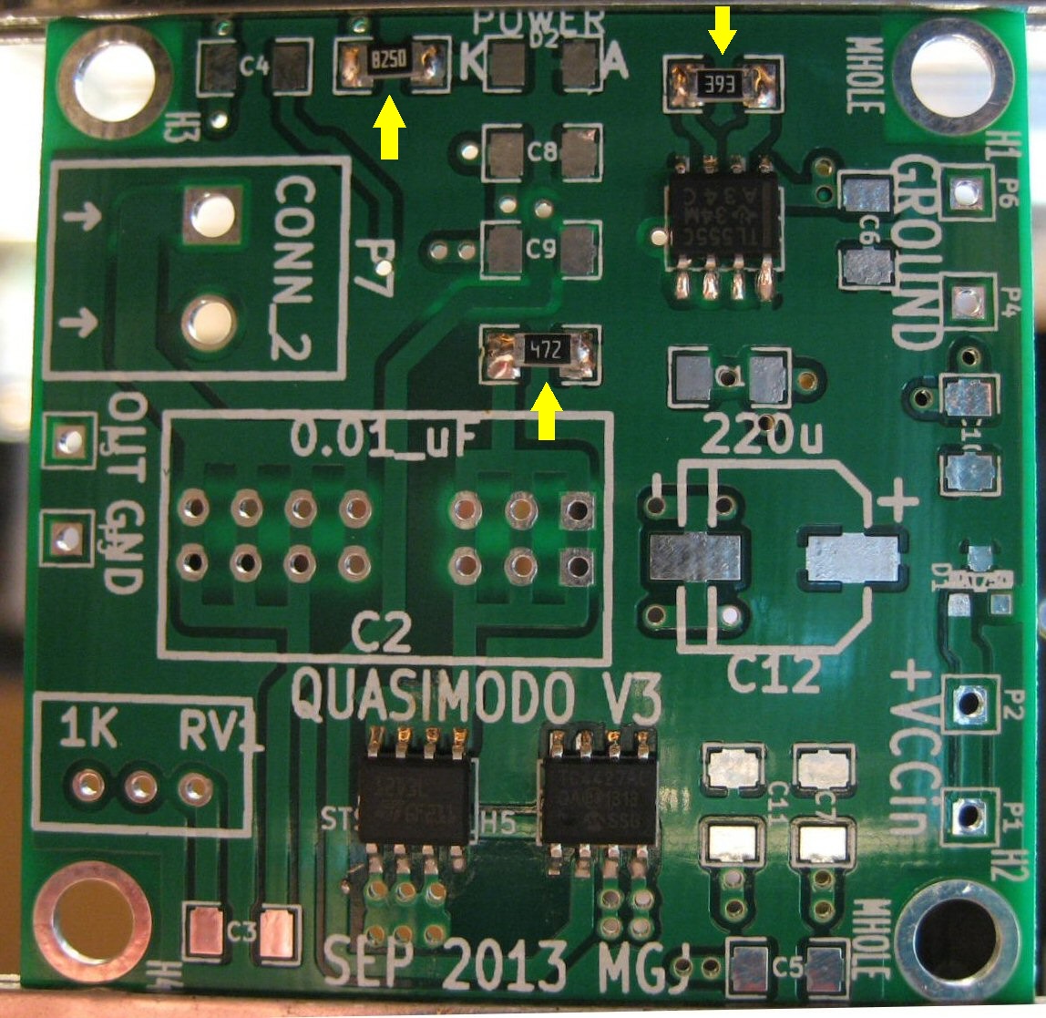

Here's a photo of Quasimodo V.3 in operation. The 25 turn trimmer RV1 is clearly visible (dark blue box, upper right), and so is the injection capacitor C2 (light blue box, center), plugged into its socket with many pins. You also can see the three 8pin SOIC packages. It's a two layer board and if you look around you can find some vias. Frontside fill is VCC, backside fill is GND.

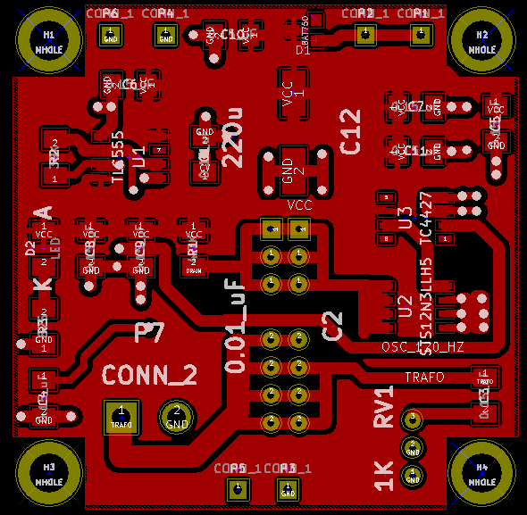

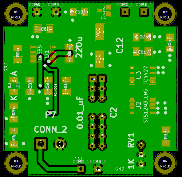

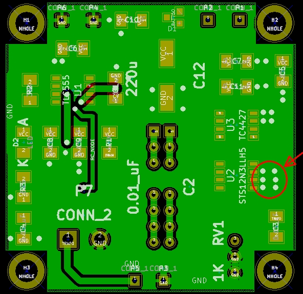

Attached are the Gerber files to make Quasimodo V.3 SMD boards, in the exact format required by PCB vendor Seeed Studio (link), which is the fab house that I used. The .zip archive also includes a Bill Of Materials (excel spreadsheet) and a schematic diagram. A photograph of this 5cm x 5cm surface mount board is attached to post #10 in this thread. KiCad screen shots show the component layer (red) and the back side layer (green). See if you can find the place where I connected the MOSFET's source pin(s) to the ground plane with six vias in parallel.

Congratulations coolnose, you found the six parallel vias which connect the Nchannel power MOSFET's source terminal to the ground plane. Although there were precious few groups-of-six-vias to investigate.

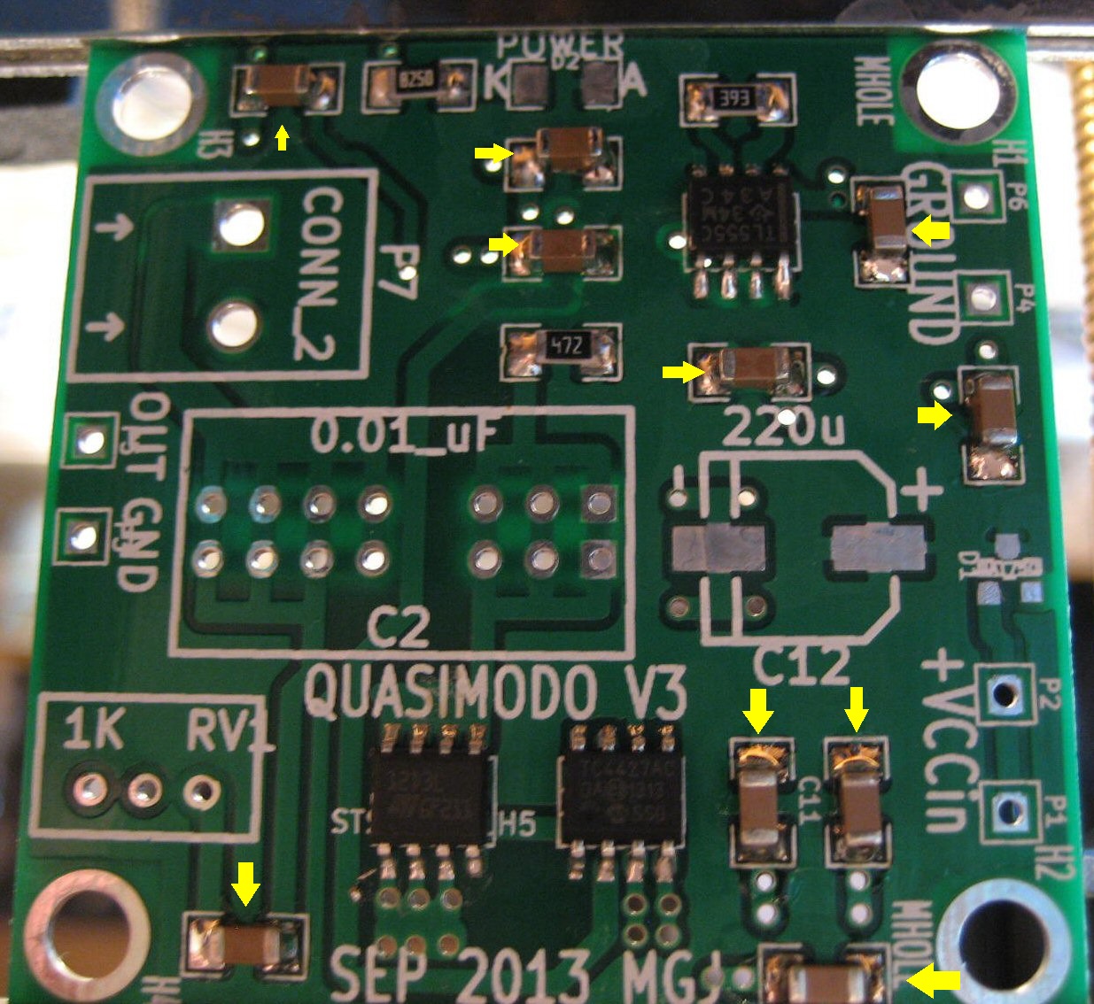

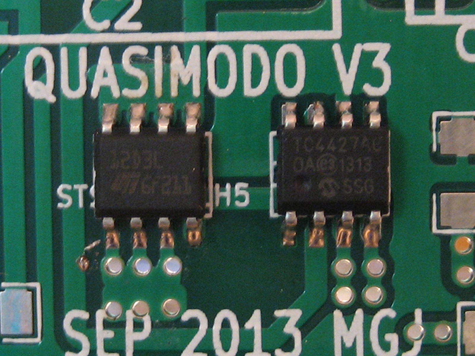

  • Place and solder the three 8-pin SOIC packages. See photos STEP_1 and STEP_2 for the correct orientations.
  • Place and solder the three 1206 resistors. See photo STEP_3
  • Place and solder the ten 1206 capacitors; they're all the same value. See photo STEP_4

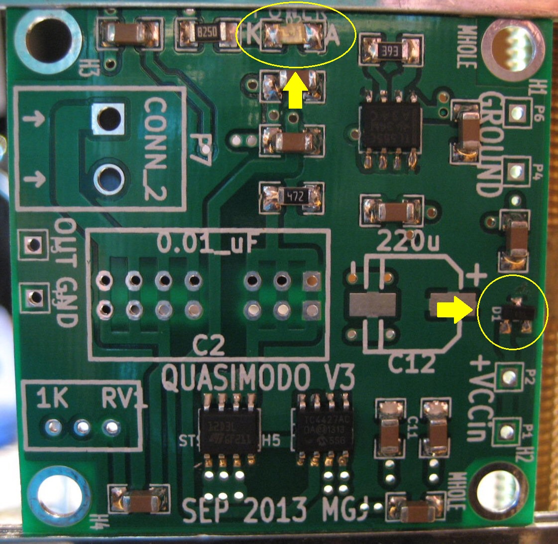

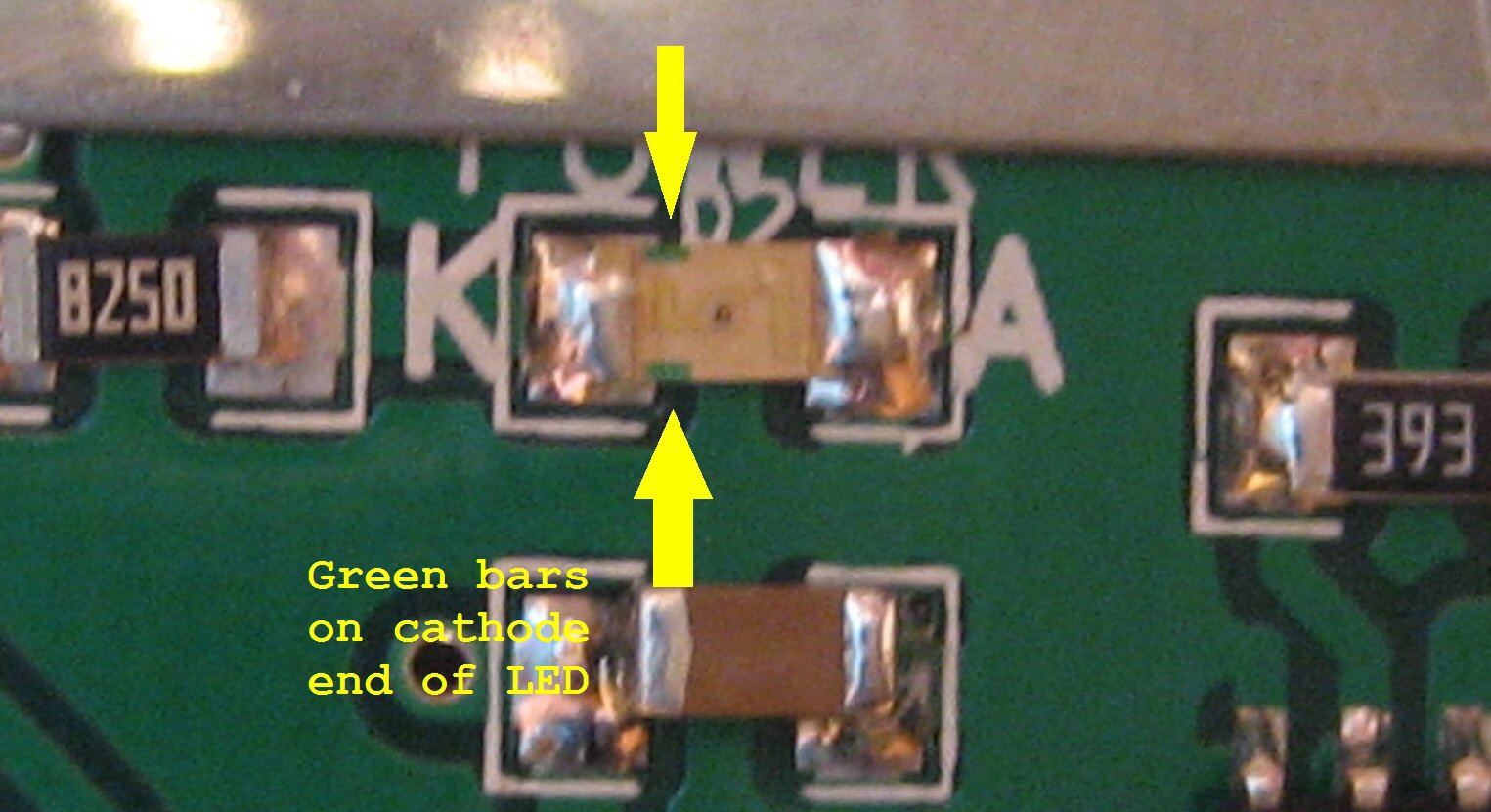

  • Place and solder the LED (1206 pkg) and the Schottky diode (SOT-23 pkg). See STEP_5 and STEP_6. The LED has a pair of green bars on its cathode.

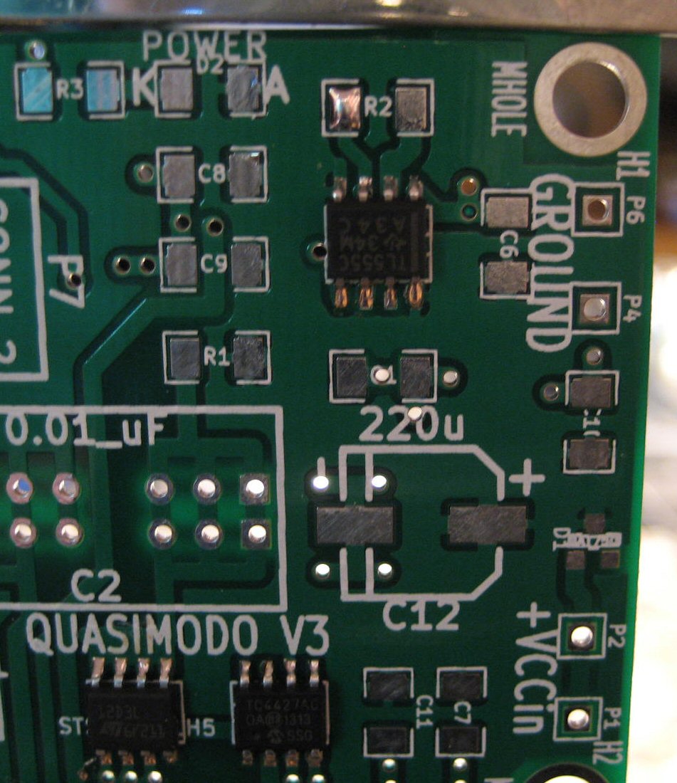

  • Place and solder the electrolytic capacitor. Be sure to do this before you solder any of the thru-hole components.
  • Place and solder the thru-hole components. And you're done! See photo STEP_7
