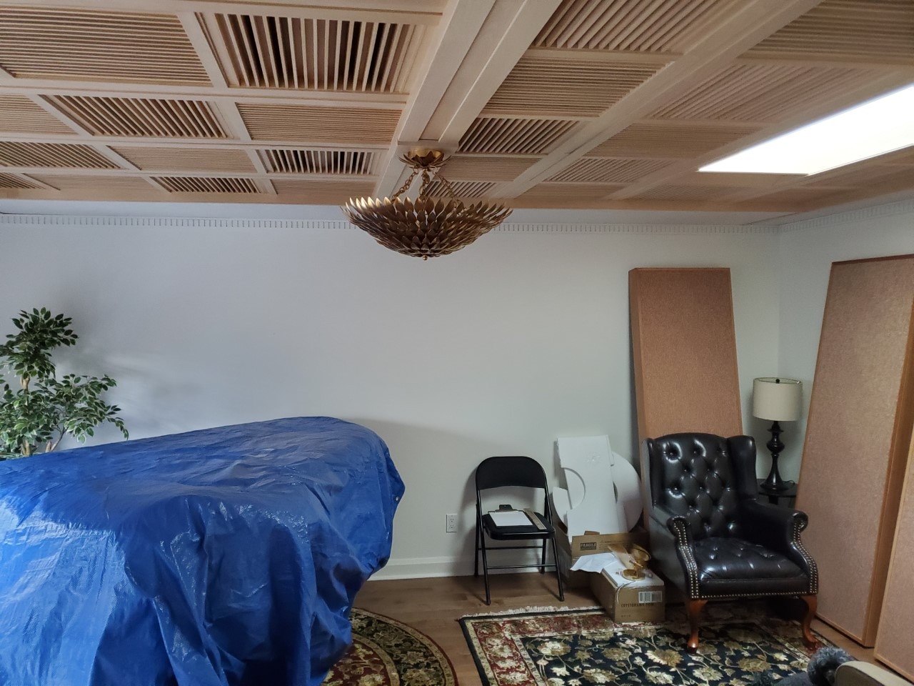

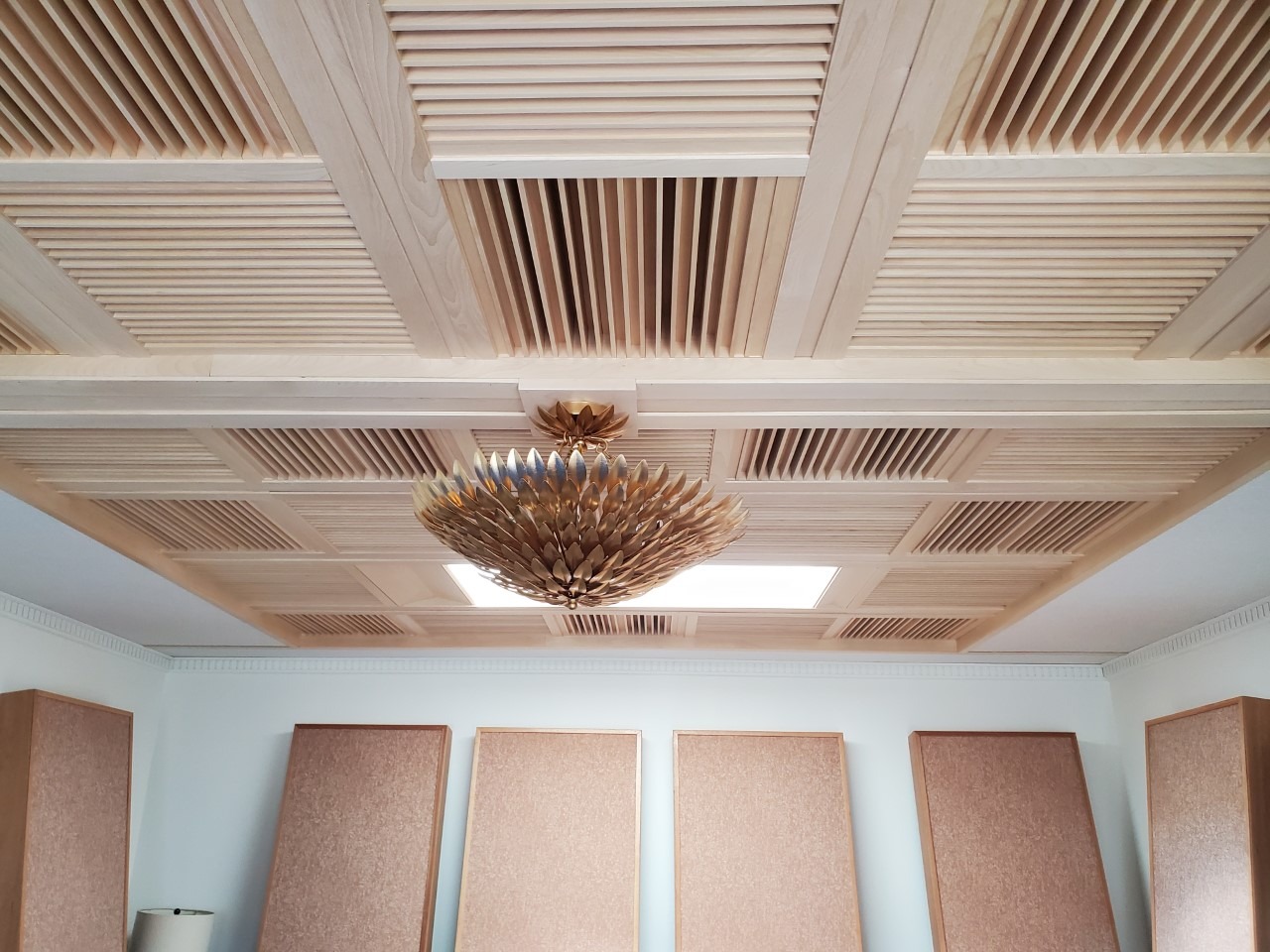

I built and installed 6 inch deep diffusers in a piano practise room. Joy to hear the piano in this room. my low-ish basement ceiling will have 12" deep of rockboard.

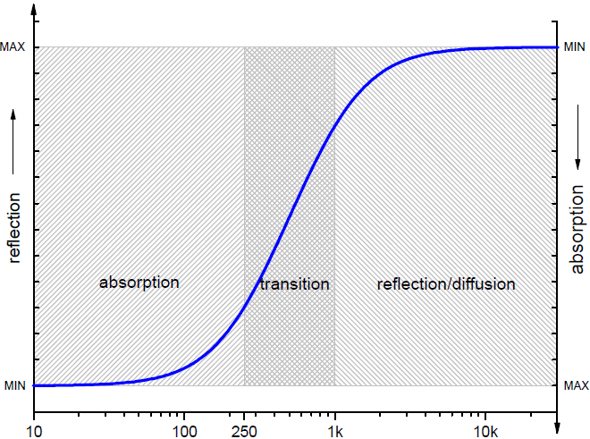

In "B.Petrovic, Z.Davidovic, Acoustical Design of Control Room for Stereo and Multichannel Production and Reproduction — A Novel Approach" Fig. 4 IMO is useful for disputes about absorption and reflections
I know that's just a hand drawn quick graph - but when you REALLY would do that to a room like it's shown there it would be a very bass light and unnatural sounding room! You need FREQUENCY NEUTRAL absorption!
Of course in a real room you very often have overdampened high frequencies - ADDING treatment like shown in this graph would help to balance that.
But when building/planing a room from scratch that's way to much.
And be careful - there's a difference between a large room (where all the theory is based on) and a small room (what we are talking about here). A diffusor needs some distance to work properly, otherwise it's comb filters.
p.s.: We are used to rooms which have higher dampening at high frequencies. I built a neutral room with linear absorption - it already sounds bass light and fresh. Adding high frequencies to that wouldn't be a good idea.
