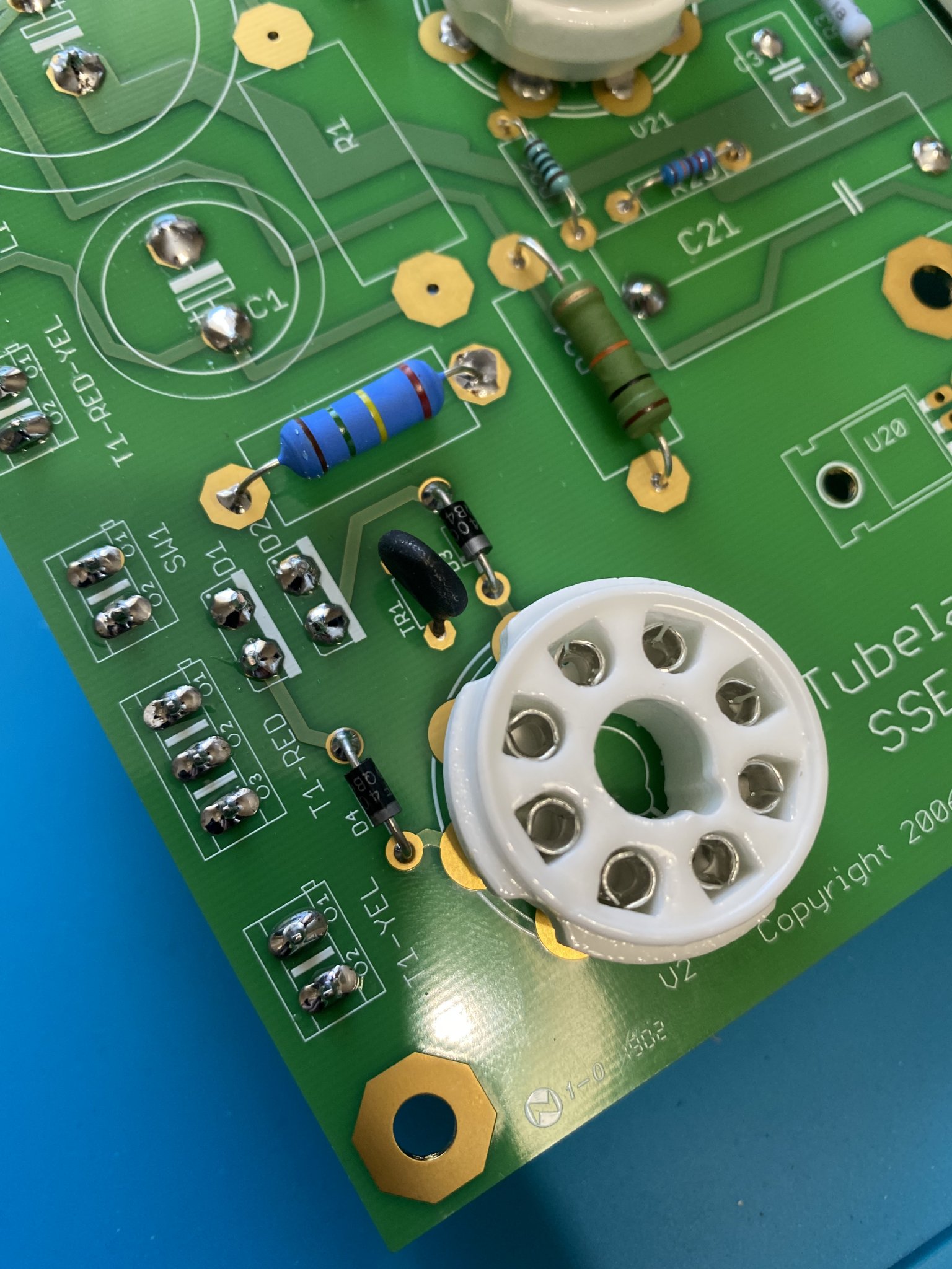

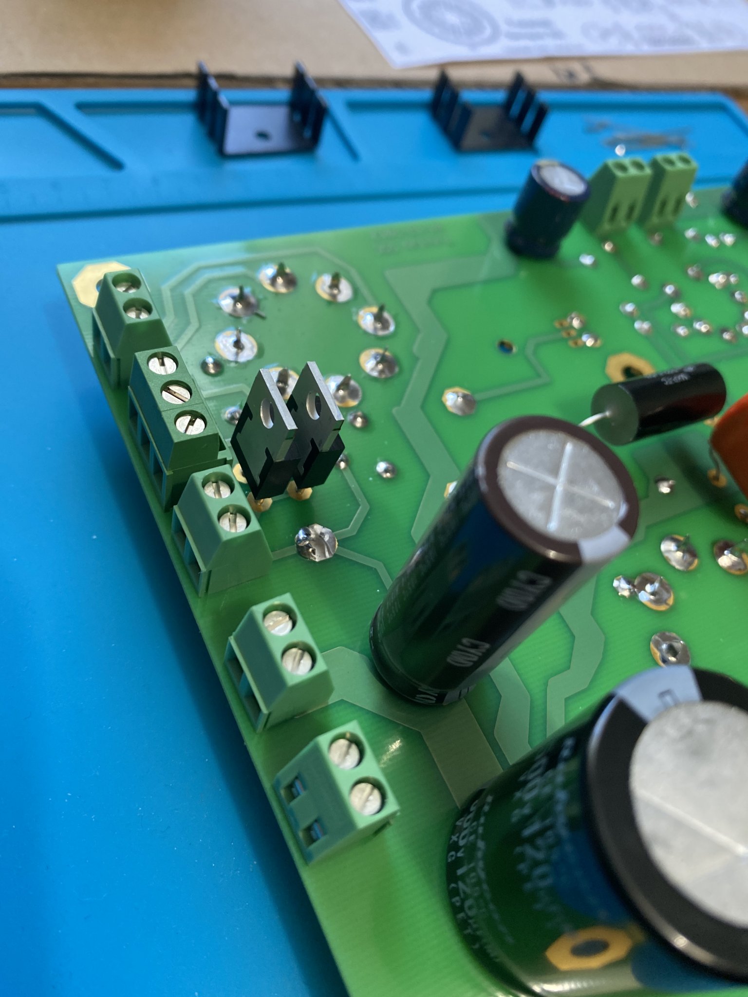

I was doing some soldering today and I got to the page in the build guide about semi conductors and I’m a little confused about the diodes. I have all 4 diodes here and I also have the CL-140 for TR1 . In the guide, George has a method for the FRED diodes where he bends them over one another but that seems like it would interfere with TR1 and D3.
Should I just mount the diodes on the underside like I did with the capacitors so I still have room for tr1 and d3? Or am I missing something?
There are no mentions of d3 d4 and tr1 in the build guide. I’m assuming because they are options for different builds. It also appears that the board in the photographs doesn’t even have these components at all.

Put them on the bottom, yes. Pat close attention to polarity lest you release the Magic Smoke on powerup.I was doing some soldering today and I got to the page in the build guide about semi conductors and I’m a little confused about the diodes. I have all 4 diodes here and I also have the CL-140 for TR1 . In the guide, George has a method for the FRED diodes where he bends them over one another but that seems like it would interfere with TR1 and D3.

Look at the lower left of my underside picture, right above the empty rectifier socket. That's where d3, d4 & tr1 go.
Again, pay attention to polarity on the diodes.
Great thanks guysPutting the TO-220 packages on the bottom also allows easy mounting of heatsinks to them if needed.

diodes in! Hopefully no magic smoke.
tr1 in as well.

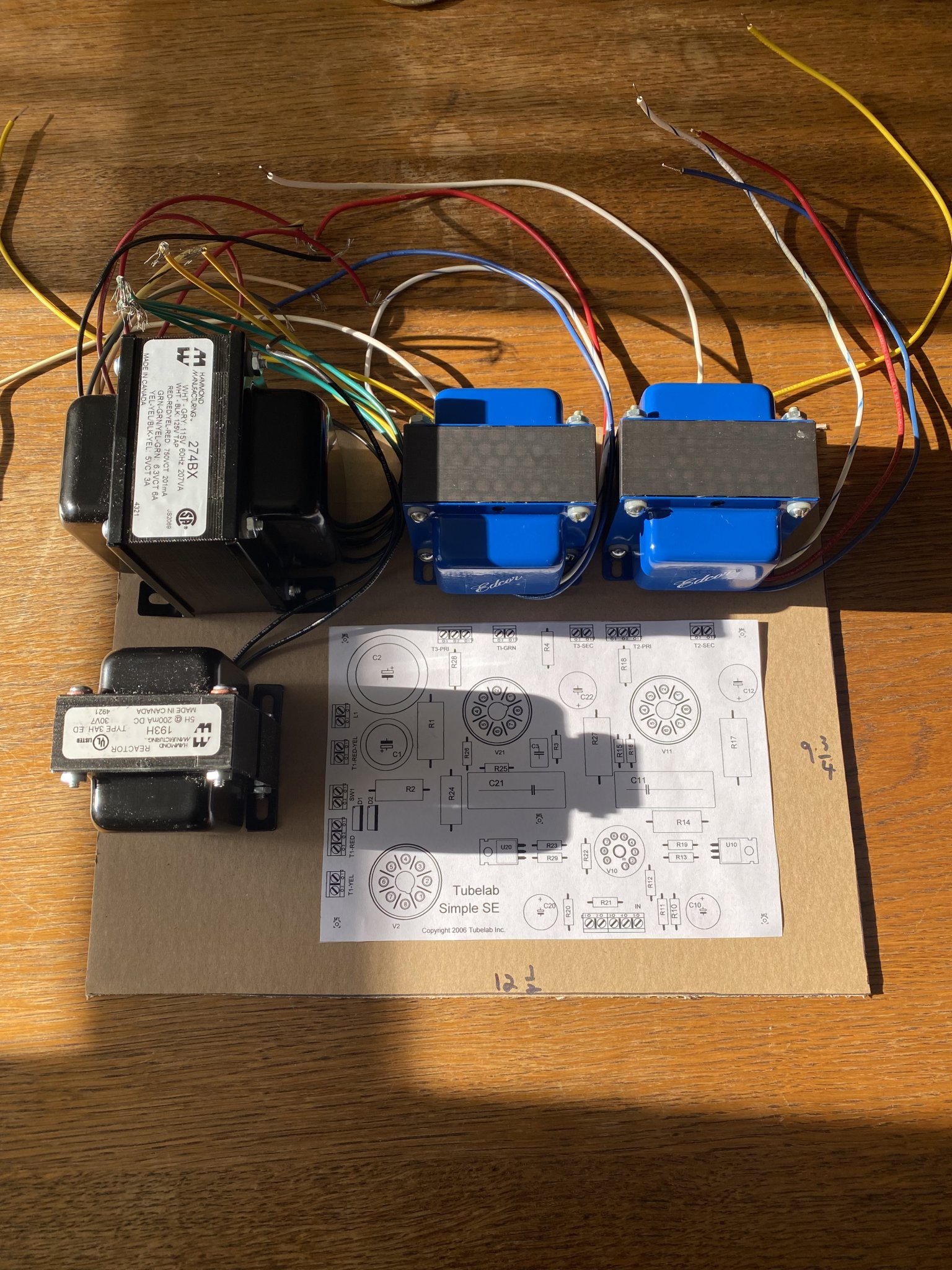

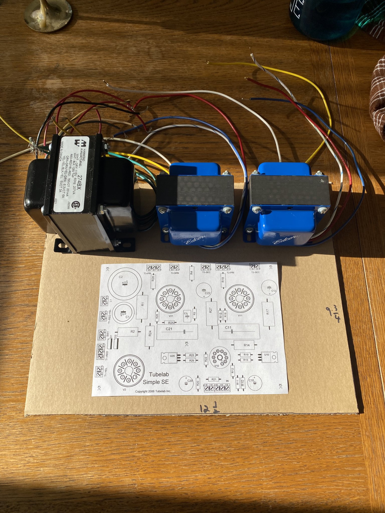

Consider leaving room for a motor-run cap.......with the board shifted to the right you likely have room for the motor-run. Also consider knocking out a "breadboard" chassis out of scrap or plywood or whatever. Get the amp up and running in that while you build your nitrocellulose lacquered spalted quilted dovetailed birdseye masterpiece (we are expecting nothing less) You may find that you can't squeeze everything in your final chassis...or perhaps the chassis is larger than needed, so a quick and dirty box isn't a bad idea. You can also slightly oversize your top plate if you are paranoid...cut it down on the tablesaw if needed.....easy enough.

One more thing..since your terminal connectors are also on the bottom and the silkscreen is on the top....triple check those too....you can refer to your paper doll cutout.

I do not have a jumper on R1. I am jumpering R14 & R24 because this particular SSE build is being set up for 6V6 or 6F6 finals. Much lower voltage than the model you are following.I noticed you have a jumper across R1. I’m assuming that’s because you’re running a choke. I have a choke as well. Does that mean I need a jumper there?
I am using a choke. As such, you leave R1 unpopulated and connect the choke at the L1 pads up between C1 & C2.

Great idea. I’ll start here.Also consider knocking out a "breadboard" chassis out of scrap or plywood or whatever

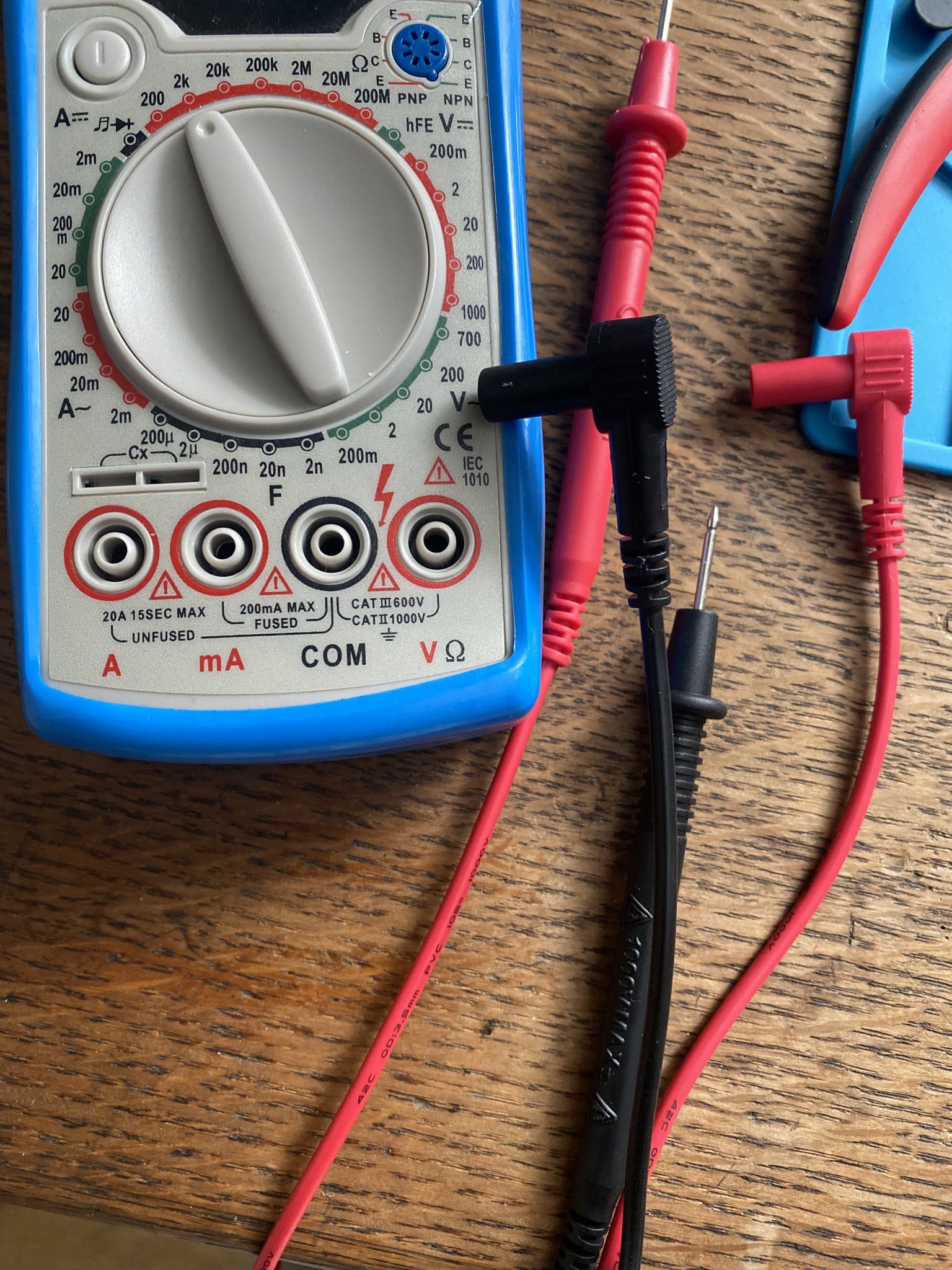

Do those clip leads you shared with me play nice with any multimeter?

They are standard banana plugs........however most modern multimeters use safety insulted ones, and the actual banana socket may be recessed down in the meter or flush with the top surface of the meter.
Post a nice close-up picture of the lead sockets on your meter.....
Your meter has the safety style bananas.....and the female metal conductors in the meter are recessed (the top part of the connector is just plastic). Plain vanilla old fashioned bananas MAY work ...but on one of my meters with these recessed female conductors they barely contact and tend to fall out. The selection of grabber leads with the safety style bananas is a bit limited......here are some............Pomona is a quality brand......the grabbers on some of the cheaper brands tend to be....cheaper. Remember, you are measuring 450V+ so these are important.
