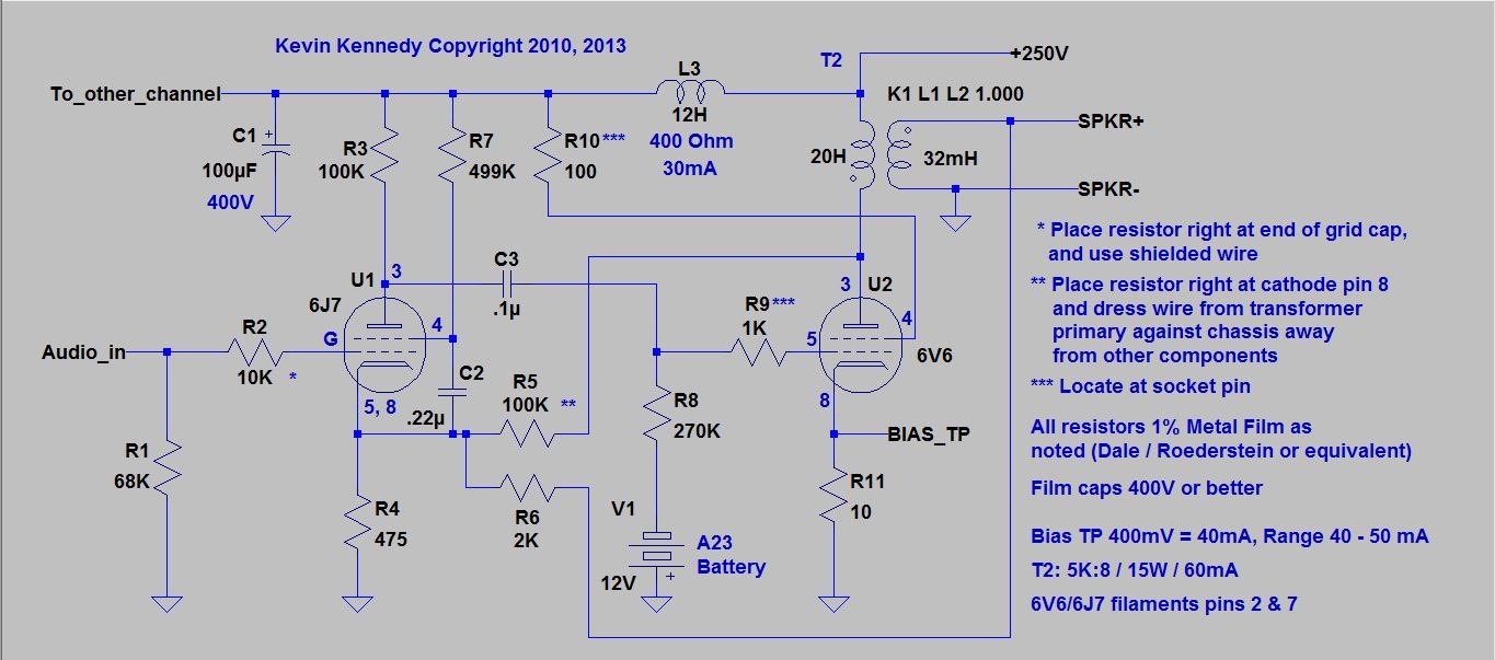

Single ended pentode with plate-to-cathode feedback
Or use a capacitor in series with the feedback resistor (use a large capacitance....
In Spice increasing the blocking cap from 0.33 uF to 330 uF makes almost no difference to the interstage or output response from 0.2 Hz to 20 Hz. The dominant RC constant appears to be between the feedback blocking capacitor and the feedback resistor, below 2 Hz in my example. While Spice uses an idealized OPT bench measurements didn't show any issues in the sub-sonics.
The build layout allows for easy conversion to secondary feedback if desired, plate-to-cathode was selected by ear and meter.

This might be of marginal interest, it is my now 13 year old take on a pentode SE amp with plate to cathode feedback. It's still in regular use. Thread is moderately long and long dead. Specific post showing the first successful implementation. Note this amp uses both plate to cathode feedback and global from the secondary of the output transformer.
https://www.diyaudio.com/community/threads/6v6-behavior-w-fixed-bias-se-amp.173454/#post-2302420
Cleaned up schematic: https://www.diyaudio.com/community/threads/6v6-behavior-w-fixed-bias-se-amp.173454/post-3707157
The amp was intended to a competitor in a local 5 tube SE stereo amp challenge, it was the only amp in the challenge that got built. It is also one of three tube amps still running here which maybe says something.

Or use a capacitor in series with the feedback resistor (use a large capacitance, the gain goes up at the RC pole frequency, can either be a wanted bass lift, or undesired lift. Watch out for 3Hz record warp frequency, for example.
Yep, the low frequency response goes WAY down with a big blocking cap (rumble filtering anyone?) plus LF distortion can be kept low. The blocking cap can be dispensed with (it works) but I restored it to make the set-up simpler when swapping different output valves for comparative testing. There is also the issue of managing the standing current in the OPT, so that dispensing with the blocking cap is less of an issue in the push-pull Telefunken designs referred to in earlier posts. As per usual, RDH733 is not a cure-all and involves trade-offs:

Thanks Chris, that corresponds well with both bench measurements and simulations. The only caveat is the output tube cathode bias capacitor (provisionally) merited experimentation for the local degeneration smaller values provide in the 0-20 Hz range.
Administrator
Joined 2004
Another option could be to used fixed bias in the output stage as I did in the design below (details linked a couple of posts back). An A23 12V battery provides bias - one per channel.
Another option would be to include an input capacitor which would be outside of the feedback loop and would allow independent cathode bias in the input stage. The plate feedback resistor does make a significant contribution to the overall bias on the input stage.
Additional loop compensation was not required to my considerable surprise, normally I would have connected an empirically derived RC lag compensation network from the plate of the 6J7 to GND, but it was not required in this design. I initially had a lot of problems with this design, over the past decade or so and multiple tube changes I have not had to do anything. I change the batteries about every 5 years.
Looked at that but went with cathode bias because the 7591 permits use of a 1 meg grid resistor in that mode, double fixed bias. Full swing distortion of a CCS biased 6F5 stays nice and low, a fraction of 0.1% from memory.

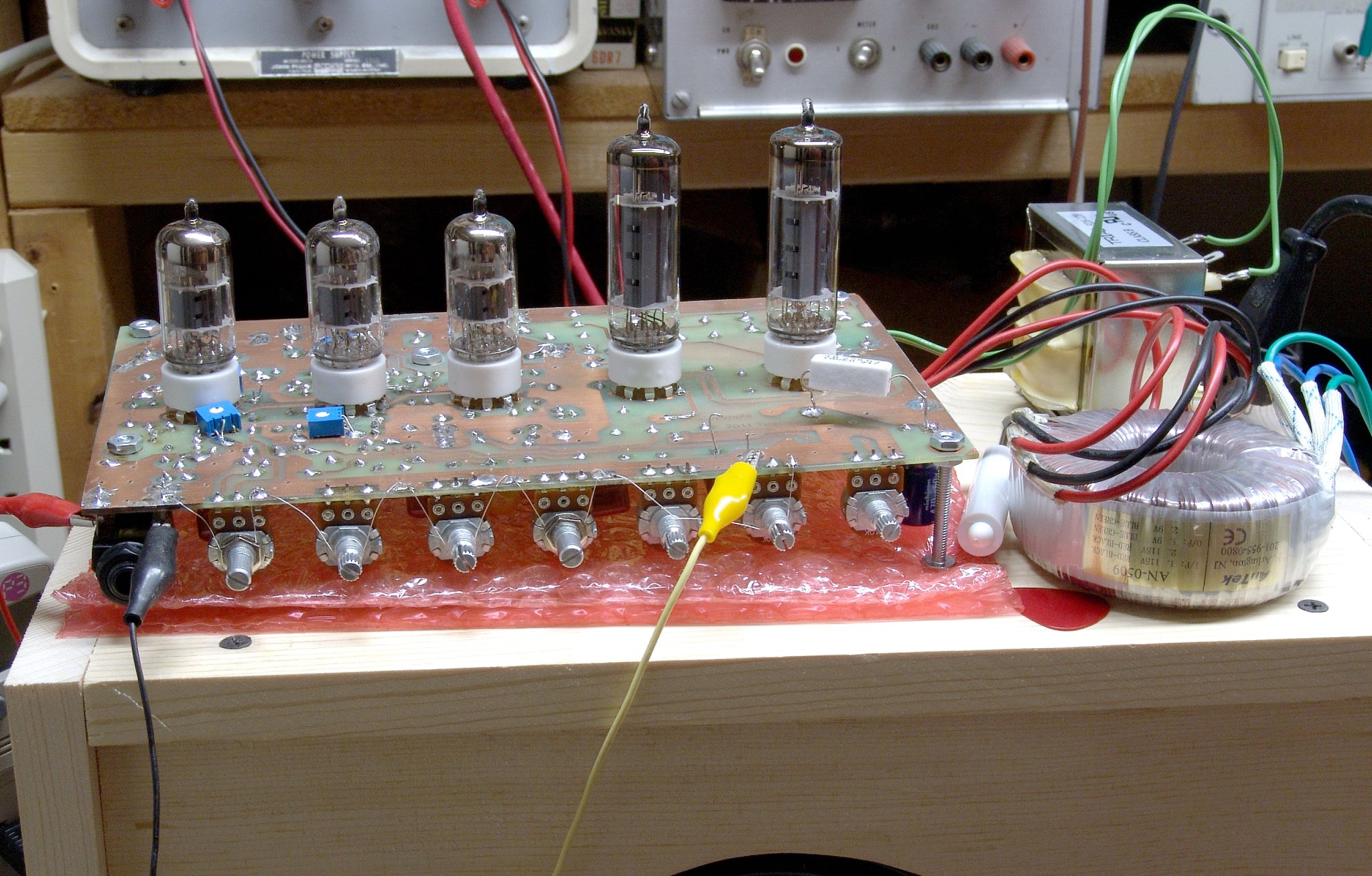

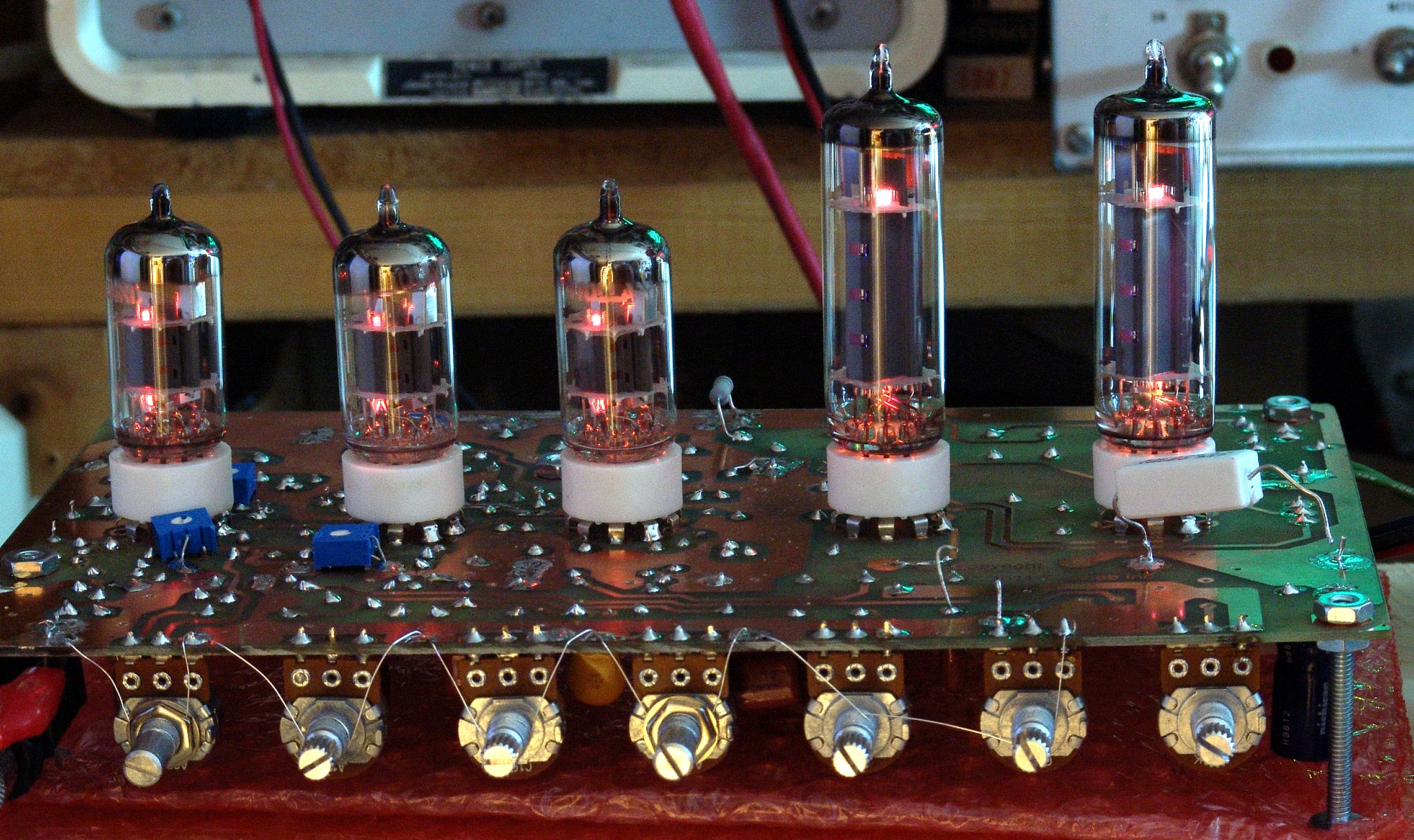

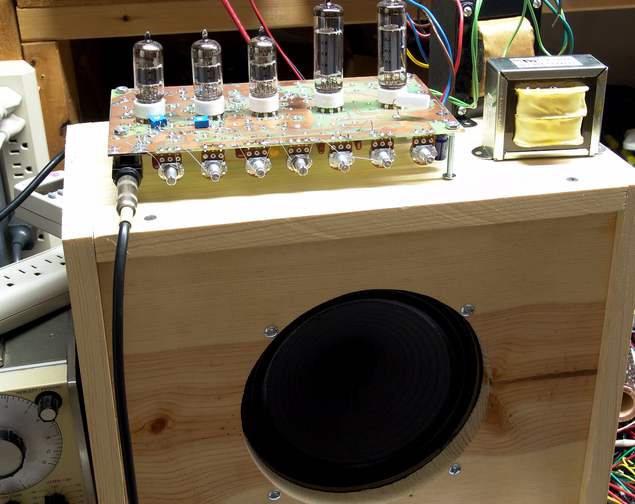

This Marshall inspired guitar amp made over 20 watts with a pair of UL84's driven by some UCC85's. It used a 120V to 120V isolation transformer for power running all the heaters in series, a voltage doubler that made 335 volts for main B+ and a simple diode bridge to make 130 volts for the screen grids. An Antek toroidal power transformer is used for the OPT to meet the $100 parts cost in the Hundred Buck Amp Challenge that ran in the intruments and amps forum about 10 years ago. The amp made 25 watts with a 3300 ohm OPT designed for a guitar amp.

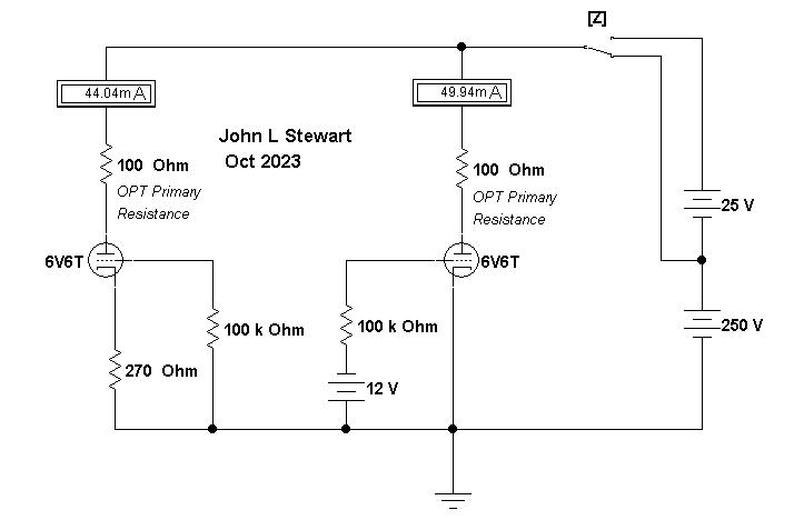

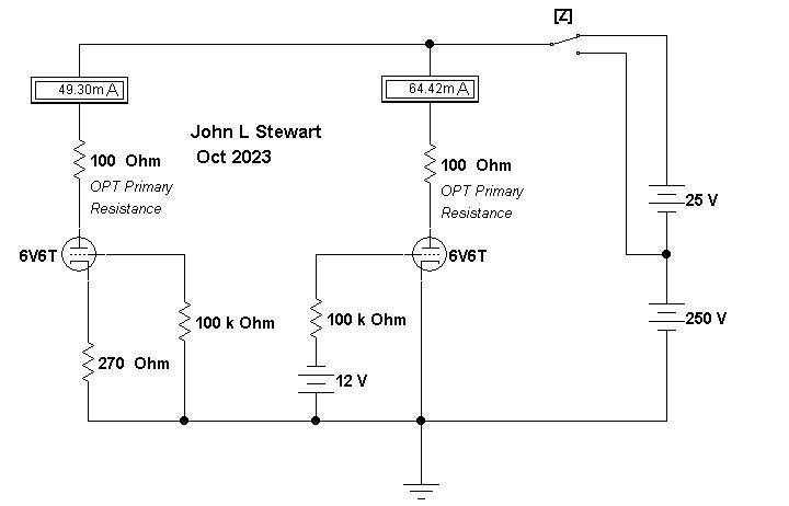

Fixed Bias is never a great idea for an SE stage running Class A.
Both tube aging & power supply drift will create problems.
Here is a simple simulation of a 6V6 comparing fixed & cathode bias as the power supply changes. The 6V6 specs are taken from the RCA HB.
This could be internal to the amplifier or the power from the local utility.
Not to infer that anybodies primary PS is a problem, but in some jurisdictions it may be.
Especially if it is owned by a large group of stockholders whose primary interest is the system profits. And not its users.
The switch operated by the key 'Z' on the laptop changes the supply by 10%
The cathode biased 6V6 plate current changes by 11.9% while the fixed bias 6V6 plate current changes by 29%.
Something to think about.
I'll post something similar on tube aging later. :)
