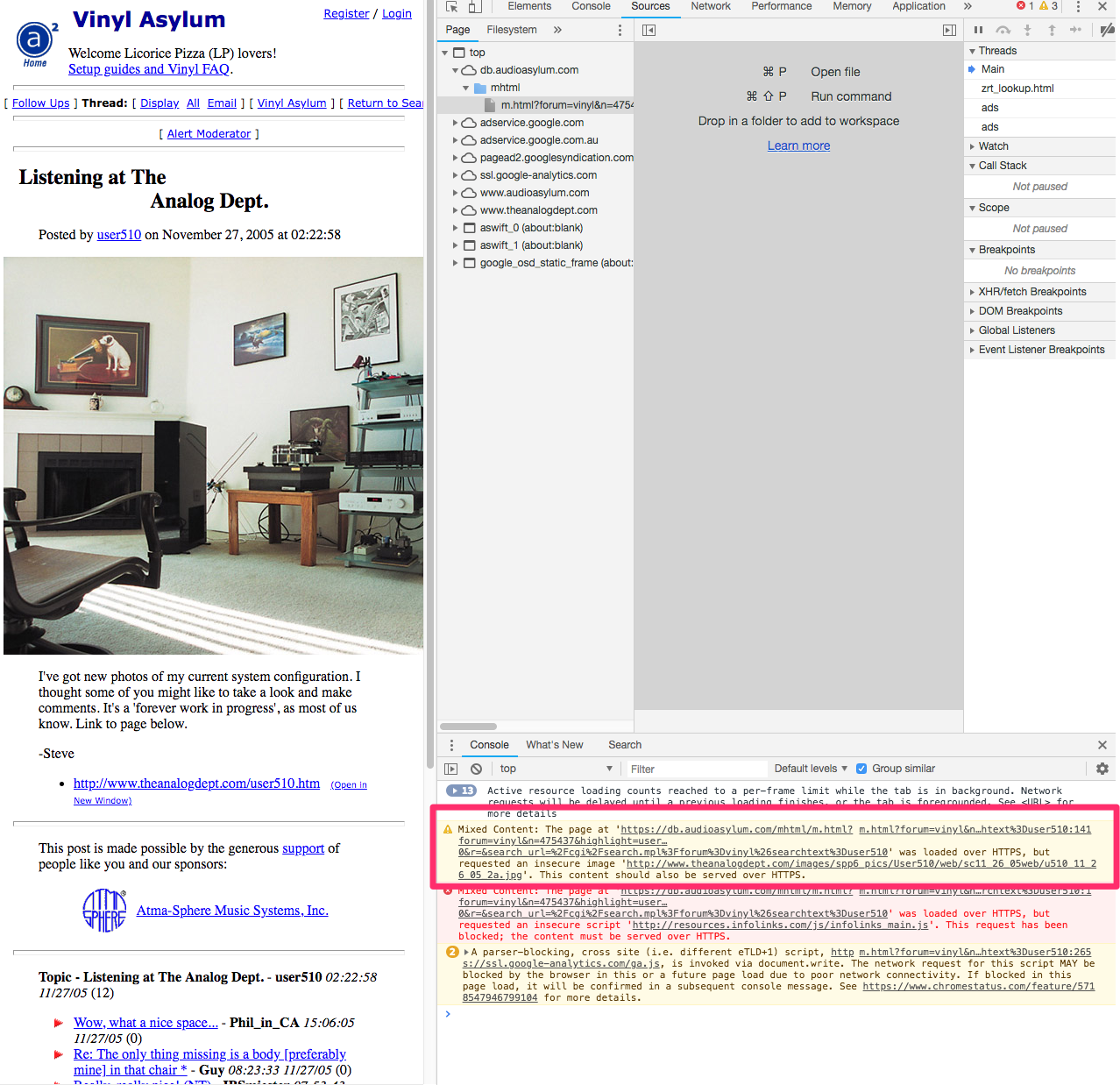

Just a sketch - Vinyl Engine
Fwiw I'm using Firefox latest version. When I click on the links I posted above I do see similar warning messages as posted above. However when I actually visit those sites and view the links there, there are no such warnings. I suspect that the warning messages are being generated here and not anywhere else.

Listening at The Analog Dept. - user510 - Vinyl Asylum
Switches things on and off again
Joined 2000
That page throws 2 mixed content warnings (one warning, for your JPG and one fatal, for an external script). This page won't get a padlock symbol, due to this.
Now, why your image is fatal on diyAudio and not a warning, I'm not sure just now. It's possibly because of the highslide script which is loading the image via a script, which is a worse category of issue. But you can be sure of one thing - the situation won't get better over time as browsers ratchet security ever tighter.
Actually I think the problem is on AA, the HTTP version is being loaded. The SSL version isn't, so the cert isn't being checked. On diyAudio, the HTTPS version is attempted, and since the cert is invalid, it's failing. The solution is to get a valid cert, which is free these days: Let's Encrypt - Free SSL/TLS Certificates.
