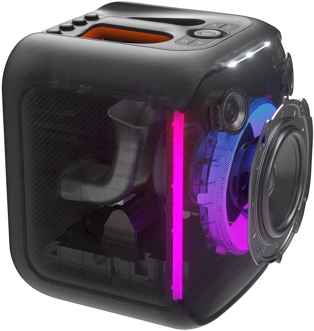

Why do brands like JBL create stereo portable Bluetooth speakers and not mono if the space between the left and right channel is so small?
Does it make sense to do it even if there is only 30-40cm between one side and the other? Isn't it better to go mono to avoid comb filtering?

In the past, boomboxes measured almost a meter so the stereo image would make more sense, but I can't understand what benefit they get from using two channels because if the deivers were together at least it would have more efficiency but being separated the only thing that should create is comb filtering
If you place a lot of importance on comb filtering as a primary deleterious quality in a portable speaker designed for higher SPL listening in a casual environment?…..sure…..why not. Not unlike diffraction, another nit to quibble about. Wide range drivers with narrow directivity work quite well placed as close as in your example……far better that a phasey mess in mono from a stereo or mid/side mix.

I still think that it would make more sense to make it mono, for example look at the Jbl Encore it has a woofer and two fullranges above, one on each side, I understand that they did it to gain SPL but for a stereo image it doesn't make sense, they are about 15 cm from each other
I've looked at the JBL specifications for the PartyBox Encore and those "fullranges" are, in fact, tweeters!
It would appear that the Encore is a mono device:
Transducers: 1 x 5.25 inch woofer, 2 x 1.75 inch tweeter
Output power: 100 W RMS
JBL says you can pair two of these devices wirelessly to get stereo.
https://uk.jbl.com/on/demandware.static/-/Sites-masterCatalog_Harman/default/dw37baa39e/pdfs/JBL PartyBox Encore_EN.pdf
Lobing can occur whenever you have a combination of two or more drivers, so is not any more of a problem with the Encore than with any other speaker system.
Possibly the wider dispersion pattern from the two outward angled tweeters better matches that of the bass driver and helps reduce the lobing that can occur between a bass driver and a tweeter at the crossover frequency.
And using two tweeters will certainly increase the high frequency power handling capability!
When you think about it, comb filtering between spaced drivers is more likely to occur with a mono drive signal because they are producing the same sound but spaced apart. If a stereo signal is used where each driver produce a different signal there is less likely to be interference issues. Additionally with a high directivity driver they may not interfere too badly, but they can be angled to bounce off different surfaces in the room and give a more immersive sound.
