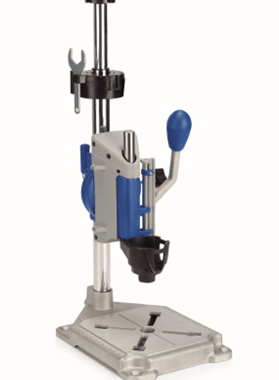

If it is for occasional use you can get a drill press attachment for a Dremel if you have one. As has been mentioned aluminium does run out so pin punch and pilot holes are a must. You will need to find a way of clamping the work piece.

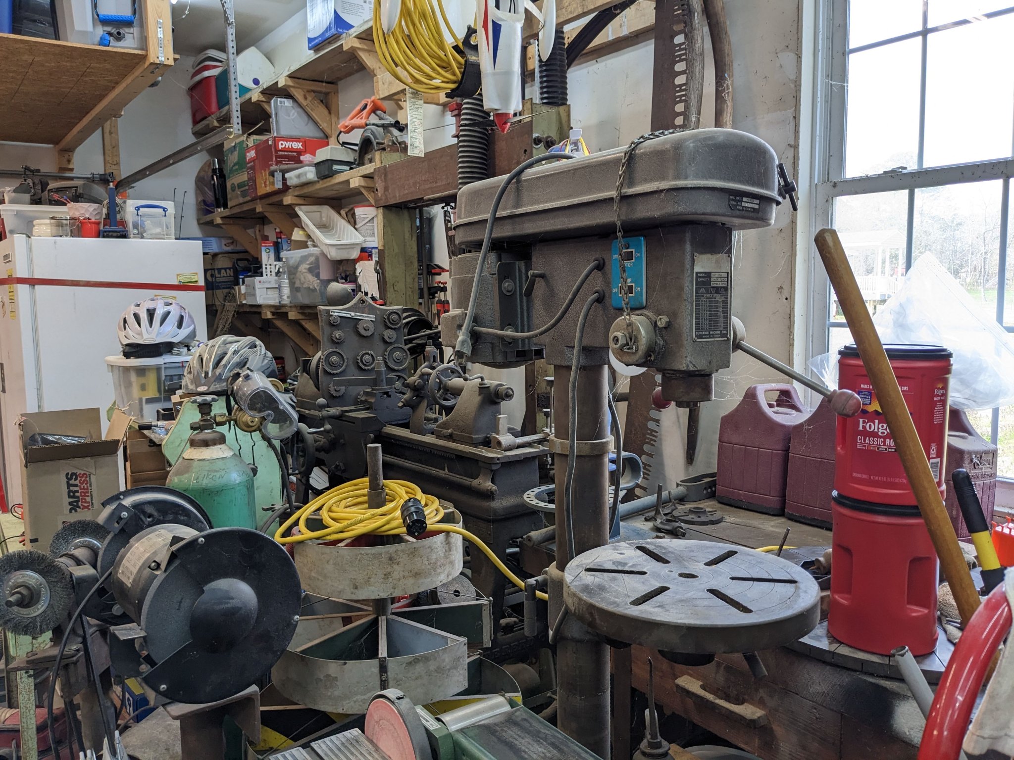

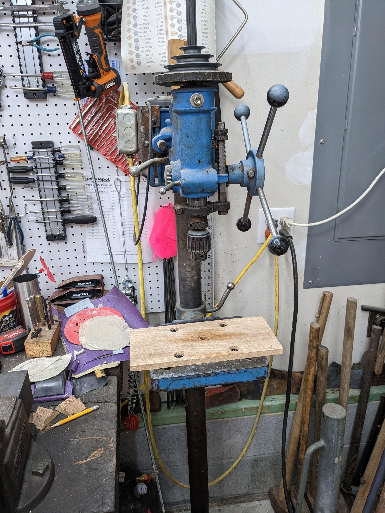

Thanks! For context, here are the two presses I have.
I don't have a project driving a firm size requirement right now, I expect 4" would be sufficient. I just misaligned some PCB mount holes that I could have swore were scribed and center-punched appropriately, pretty sure it's my ability to clamp it in the appropriate spot, even with a 4" flat drill press vice. So that brought back up thoughts that something like this would greatly help. While I would love a 6", that probably jumps up to a level where I have no justification. I expect anything that big falls into the agricultural area where I can probably get the required precision already.
I use the blue one mostly, the one labeled #2 had a 5/8" chuck with a lot of [runout?], I took it off but I was/am waiting on finishing out to retirement this fall and I didn't want to take a chance on a $30 chuck.
I expect there is some way to use the lathe, but while I used lathes at the machine shop (under supervision 30 years ago) this was my grandfathers, and I never actually set it up myself. And I am not sure I got all the equipment when we cleaned out the old shop a couple years ago. It's on my bucket list too.

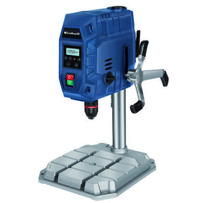

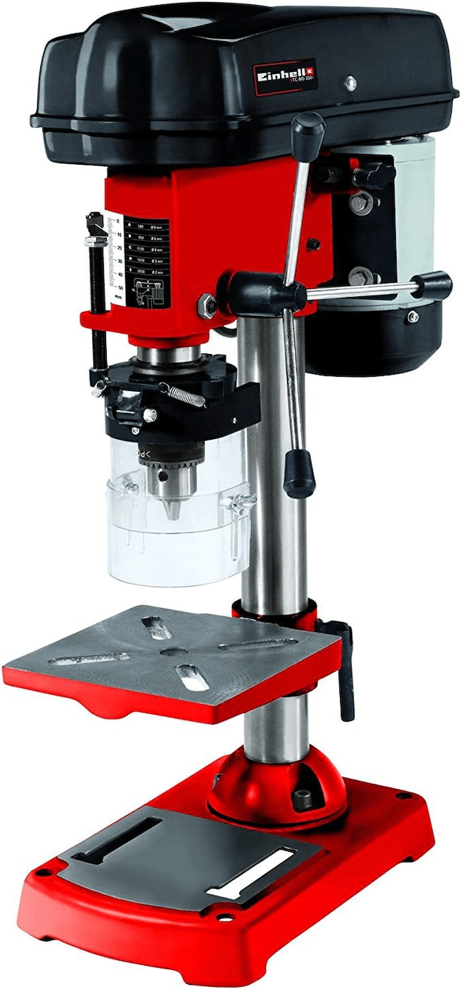

I was shopping for a drill press a couple of years back, and found out there's no relationship between precision and price. The only way to know is to go to the shop, grab the chuck and attempt to wiggle it. I bought the Einhell (house brand, made in China) with absolutely no play for about $100, after rejecting the Bosch at 2-3x the price and wobble like hell. Sadly, no spec. sheet will reveal this, so you have to go and figure out for yourself.

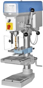

These are excellent and true German industrial quality. I used them but don't have one myself. 3 phase 400V but also available with frequency controller and 230V single phase.
My cheap Chinese drill press broke down (as usual) and I thought to be smart and ordered the Einhell BT-TB13E as it is very cheap (below 90 Euro). What a piece of crap! Unusable. For a very short moment I thought to replace the bearings to reduce the play but new devices should be OK out of the box. The VFD is a very useful addition and way more convenient than having to change the v belt. IMHO not many take the time/effort to change rpm with the v belt in classic drill presses. Yeah admit it!
