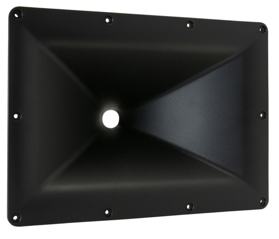

Here's the 10" x 14" x 5.5" QSC waveguide from the Econowave:
fetch
Here's the 7.9" x 15.6" x 4.9" SEOS 15 from the Small Syns:
I'm fairly sure that the latter might work decently with Bill's crossover.
Probably won't be a 100% match, but it's quite close. You might need to redesign the baffle due to the additional height. But otherwise, their dimensions are really similar.

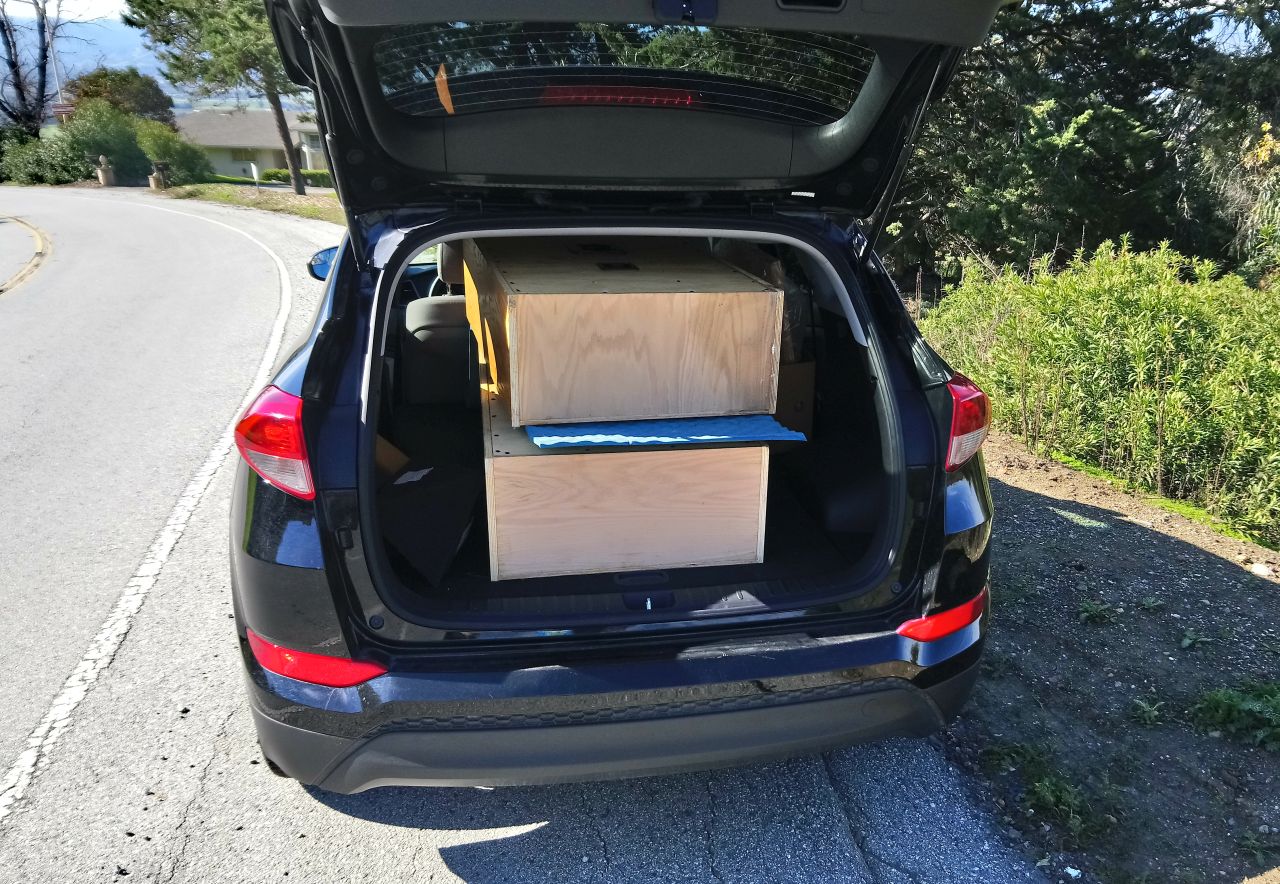

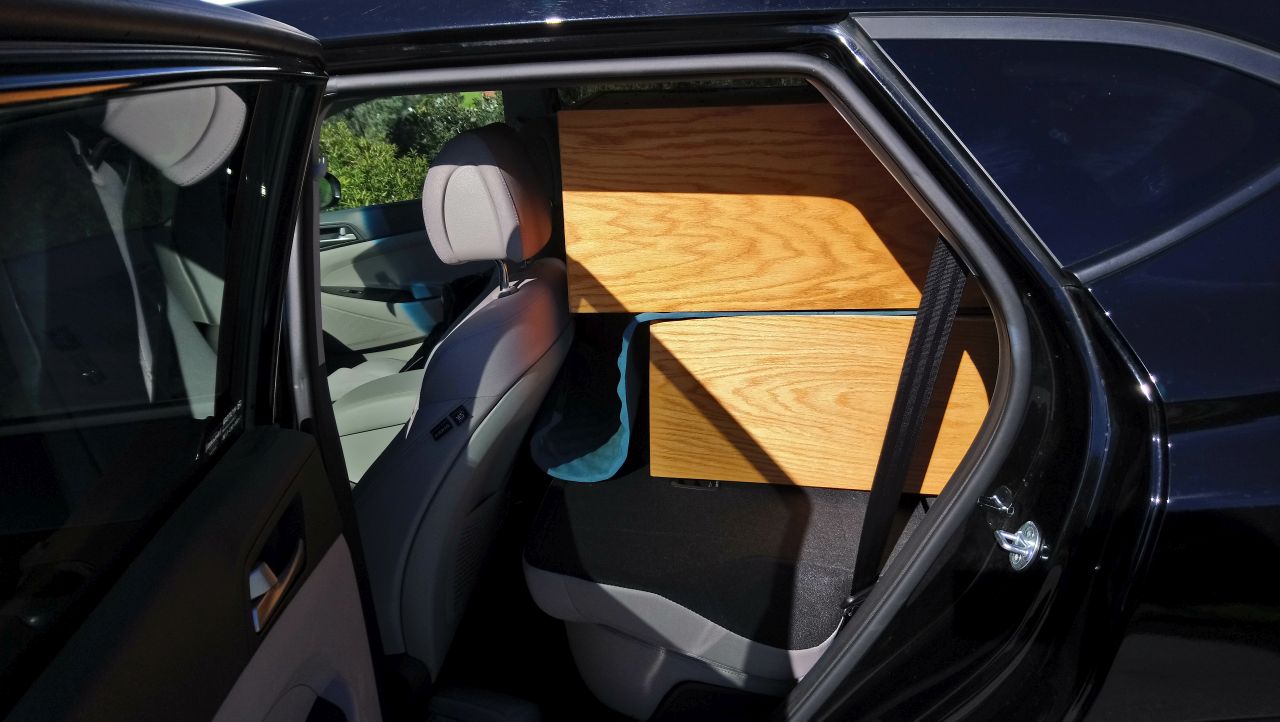

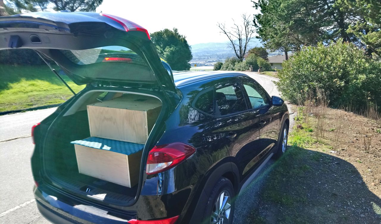

They *barely* fit in the SUV:

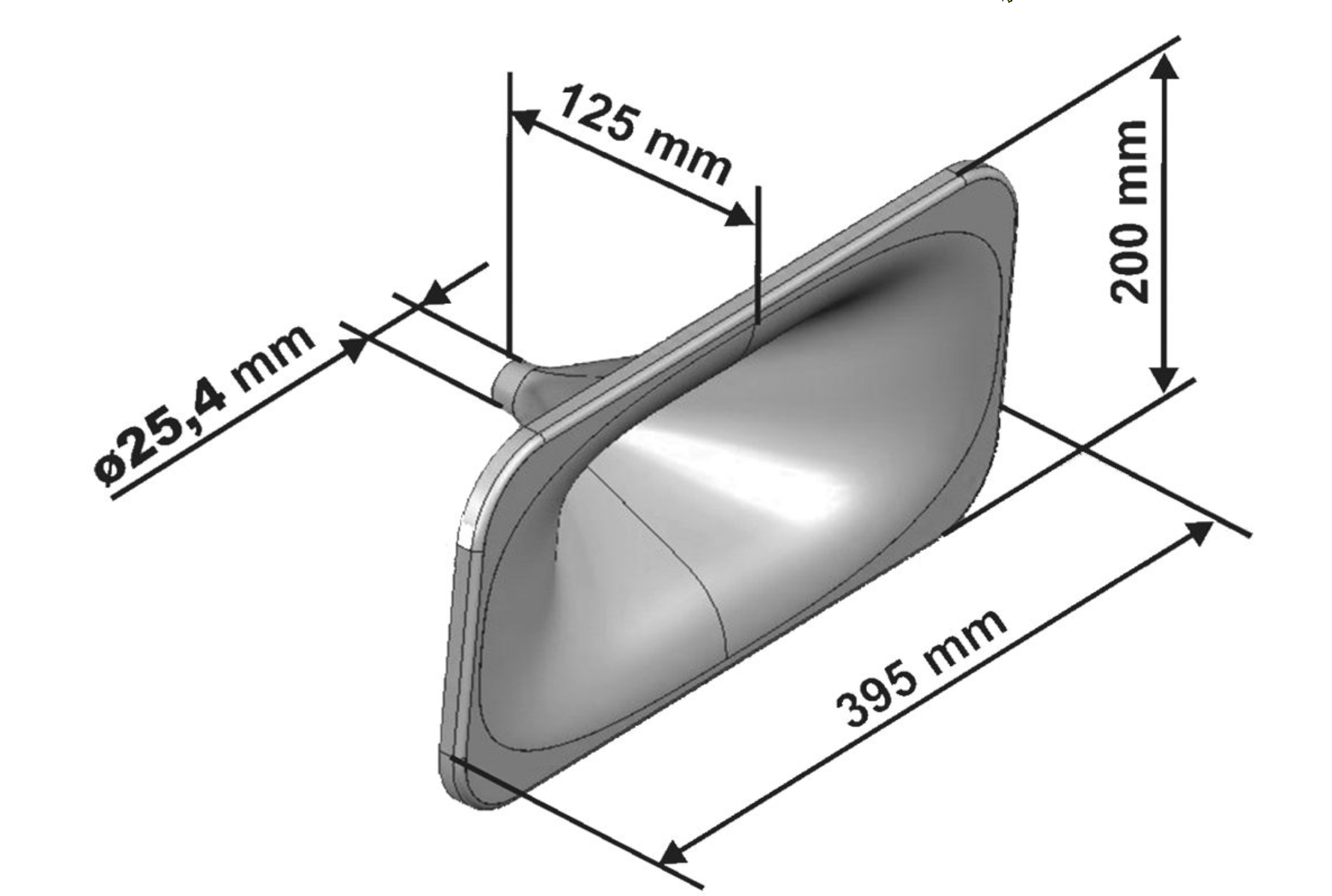

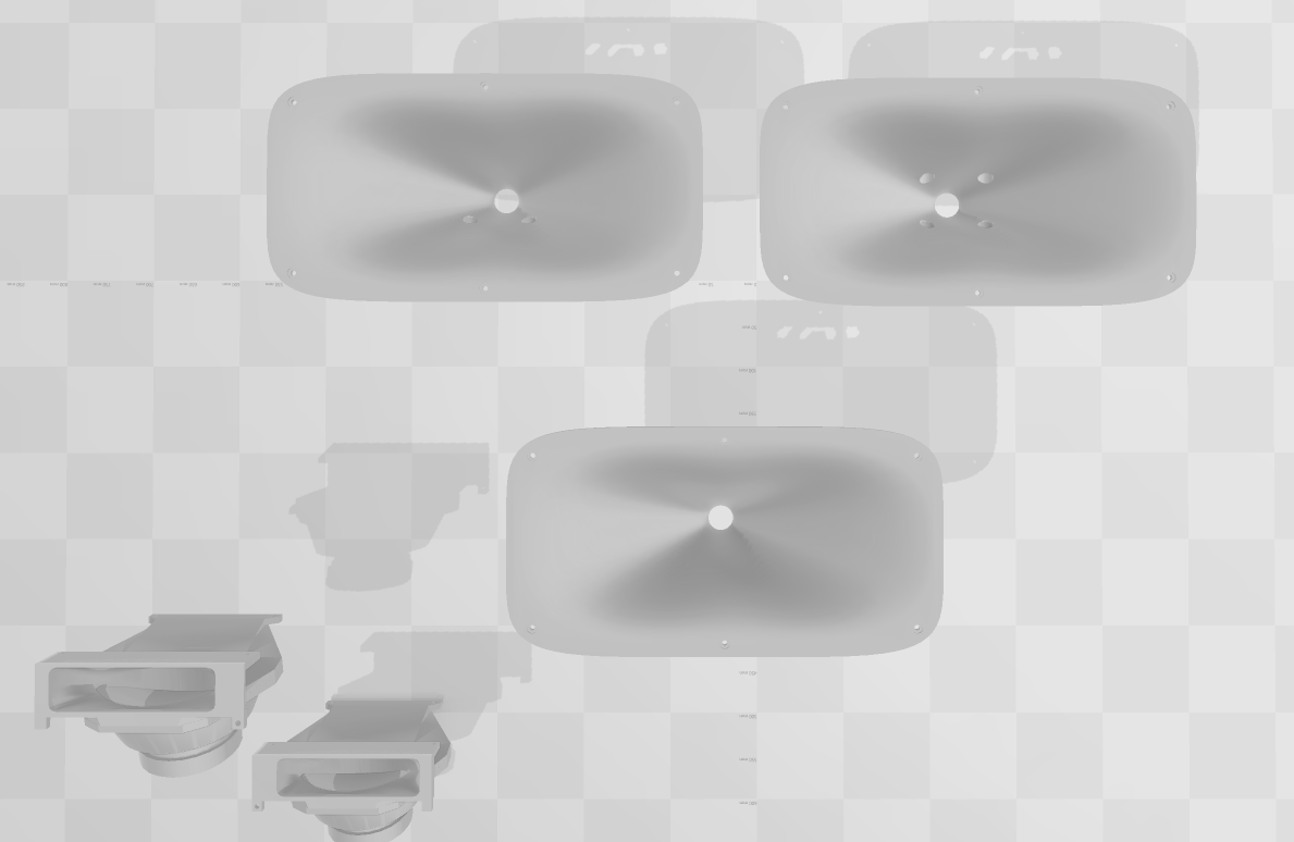

I am working on a printable replacement waveguide right now. I've been told they are coming to the website for over two years now... It's OS to SE 125 x 406 x 213mm. I'm trying to get as close to a drop in replacement as possible without making a straight up clone. I should have full system measurements by mid to late March.
I guess this only helps if you have access to a 3d printer...

I am a little bit late to the SmallSyns, but I need to make this question...
Is there an alternative to the SEOS15 waveguide? This has been out of stock for years in DIYsoundgroup!
I have one QSC HPR152i waveguide clone (I think it's the B52 clone) that I could use, I even have a couple of Faital 6FE100.
2) The mounting plates for my midranges frequently fell off. This is because the mounting plates would delaminate from the waveguide. This was a problem with the QSC in particular, there's something about the plastic they use, it's very difficult to get anything to bond to it. Eventually I gave up on trying to find a good adhesive, and I simply ran bolts all the way through the mounting plate for the midranges right through the horn walls. But that's ugly and probably causes diffraction.
Might be (way) too late, but PP and HDPE are notoriously difficult to bond with adhesives. You have to use special adhesives rated for PP/HDPE, and normally they also require that you flame-treat the surface before applying the adhesive.
