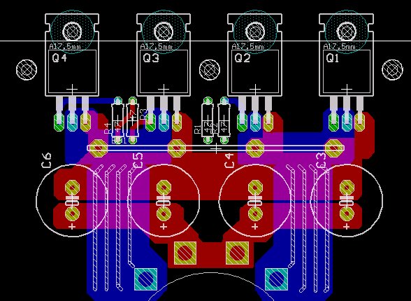

i'm currently playing around with a pcb for use with a computer powersupply to bring 240 volts down to 12v, then up to 35v.. and one area of the design is annoying me a little bit.. the trace length on the mosfets.
I have the layout symmetrical so the trace resistances(althoug minimal) will be identical on each side.
Also the trace length to the gates will be as short as possible.. however i cant get it that short.
In a computer motherboard the trace distance between the mb SMPS PWM controller and the gate of a mosfet is around 2cm at most..however its all surface mount which makes mounting easy.. even easier as they use 4 or even 6 layer PCBs
the current trace distance from the output of the SG3525 and the input on the mosfet, is.. as measured at around 8cm for the right mosfet, and around 6cm for the right mosfet. this is one side. it is identical to the other 2 mosfets.. as i said its symmetrical.
Included is a picture, your thoughts/opinions please.
