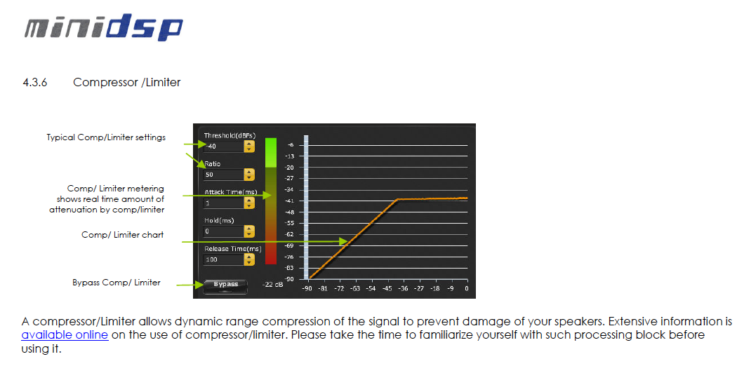

There is a "compressor/limiter" function mentioned in the user manual for the 4x10 Hd.
That's interesting info! Tony told me only the 8x8 had a limiter ... but that's out of budget for this project.

Same section on "compressor/limiter" is also in user manual for nanoDIGI 2x8K....

Actually, in the table in the link above, it says Compressor/Limiter "Not Available" for the 2x8 and the 4x10....
User manual for nanoDIGI 2x8:
www.minidsp.com/images/documents/nanoDIGI 2x8 User Manual.pdf

The 10x10 Crossover v1 (running at 48kHz samplerate compared to 96kHz of the 4x10) has a compressor/limiter and will also run on the 2x8 and 4x10HD. See the plugin table. So, if you can live with the lower samplerate you can have a compressor/limiter also with the 2ch in platform
