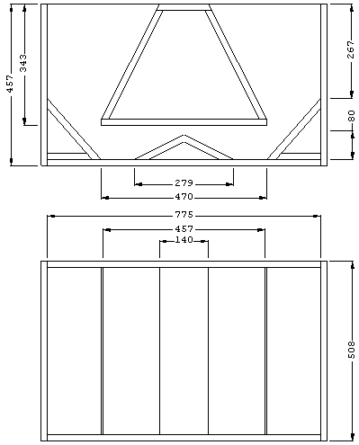

Dude, don't take this the wrong way...................
If you are not going to invest in the right tools
to get the job done right, you should just scrap the idea.
Either build the HD 15, or PD 1850 with the speakers
Rog recomended on the site, or don't build it at all. As
far as I remember, he offered alternative speakers that
will work in either cabinet. They may not be as efficent
as the Precision Devices, but they will get the job done.
You mean to tell me you can't buy any one of the
alternative speakers he recomended?
The speaker you want to use will not do the job in
those boxes. You'll end up wasting your time and
money, and be highly upset in the long run. Buy the
right speakers, or use those "Free Speakers" and build
a Double Fifteen box.
Period.

About the tool's .. i have all the tool's you can imagine ... from a driller to osciloscoope's , about the wood .. i get it for free ....
Yes , someone calculate my last speaker , they have about 104 dB and 36 Hz . As my amp's .. most of them are build by me .. for the horn's ( if i gonna build them ) i'll use a 2 x 800 W , useing 24 output transistor's ...
If i gonna find the right driver's i think i'll build the HD15 .. it's smaller ...
What speaker software do you recomand me ?
Hmm...
What about that box with 2 driver's ( 15" ) that you mention ?
It's a simple cabinet design ?
If i gonna put an Eminence Kappa 15LF in the PD1850 horn will sound good ? He dosn't mention alternative drivers... ( name's .. only some specs about the driver i should use )
From a PD15 Horn with Eminence Kappa 15LF and a W bin with the same driver what you will chose ? I'am telling you that because in this morning i visit a friend that haved 4 x Wbin's and it sound great .. all the room shakeing ... he gave me the plan .. it's a ordinary plan from the net .......
