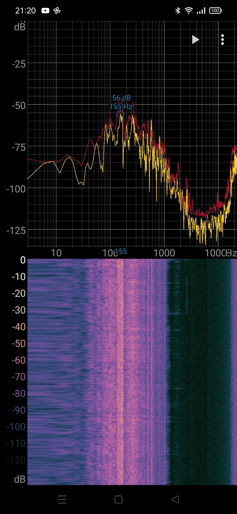

Hello,
I try to insulate kind of a wardrobe, where is heat recovery unit is hidden. Heat recovery unit is a mechanical air ventilation device built from steel with rotational heat exchanger, which has 3 electric motors inside: 2 for moving the air and one for rotating the heat exchanger itself. That last motor is connected with gearbox and both of them are VERY noisy. Think as a half of washing machine noise or more. That motor was changed by the seller of the device couple of times during warranty, the new ones were silent just for couple of weeks, then again: weird noises. The type of noise is vibrational-mechanical type, like a small drill or slow washing or drying machine.
What I did to lessen the sound:
I have no measures before and after.
Photos:
Sound profile 1m form wardrobe with doors closed and open:
Wardrobe is not air tight and there is no way I can make it.
There is still too much noise coming out, and if we think machine is a noise source, then we also can think that inside of a wardrobe is like a small room.

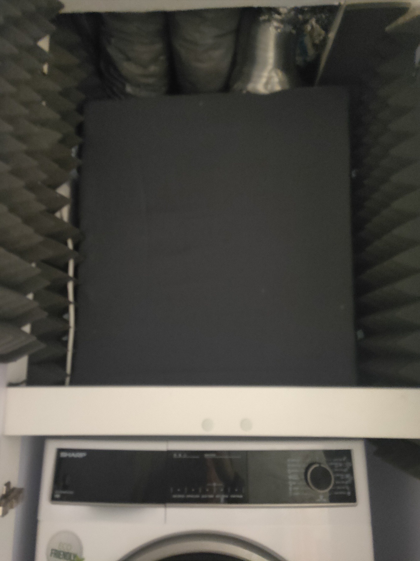

- I built a wardrobe type box for it. Result: now there is definitely less sound amount, but some resonances are more pronounced. Overall still a positive thing
- 5+% of total surface of machine including near that noisy motor, glued with antivibrational butyl rubber sound and vibration deadening material from automotive soundproofing industry. Maybe will glue some more, as only small amount had at hand from last project. Possitive impact, but expected more. I have a feeling, that it dampened the lowest freq sounds, or raised main
- 50+% of total surface glued with some 6mm rubbery foam, also from automotive industry. Not much impact
- Front panel on the inside glued 2 layers of dense synthetic 2mm felt, so 4mm total. Not much impact.
- Inside panels and doors of the wardrobe near the machine glued with pyramid shaped foam. A lot of impact, did not expected much, but it worked well!

Photos:

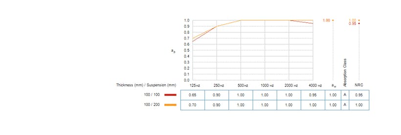

Hi, did you look into the Rockfon sound treatment products from Rockwool? E.g. from Swedish site https://www.rockfon.se/produkter/rockfon-koral-100-mm/
Looks quite good. They have a specialised Bass Plus product, for LF absorbtion https://www.rockfon.se/produkter/rockfon-bass-plus-a51d102b/. They have many more materials, different from regular Rockwool. I rebuilt a wall in my bathroom (next to my music room), using some inwall, higher density stuff similar to Bass Plus, with good results .

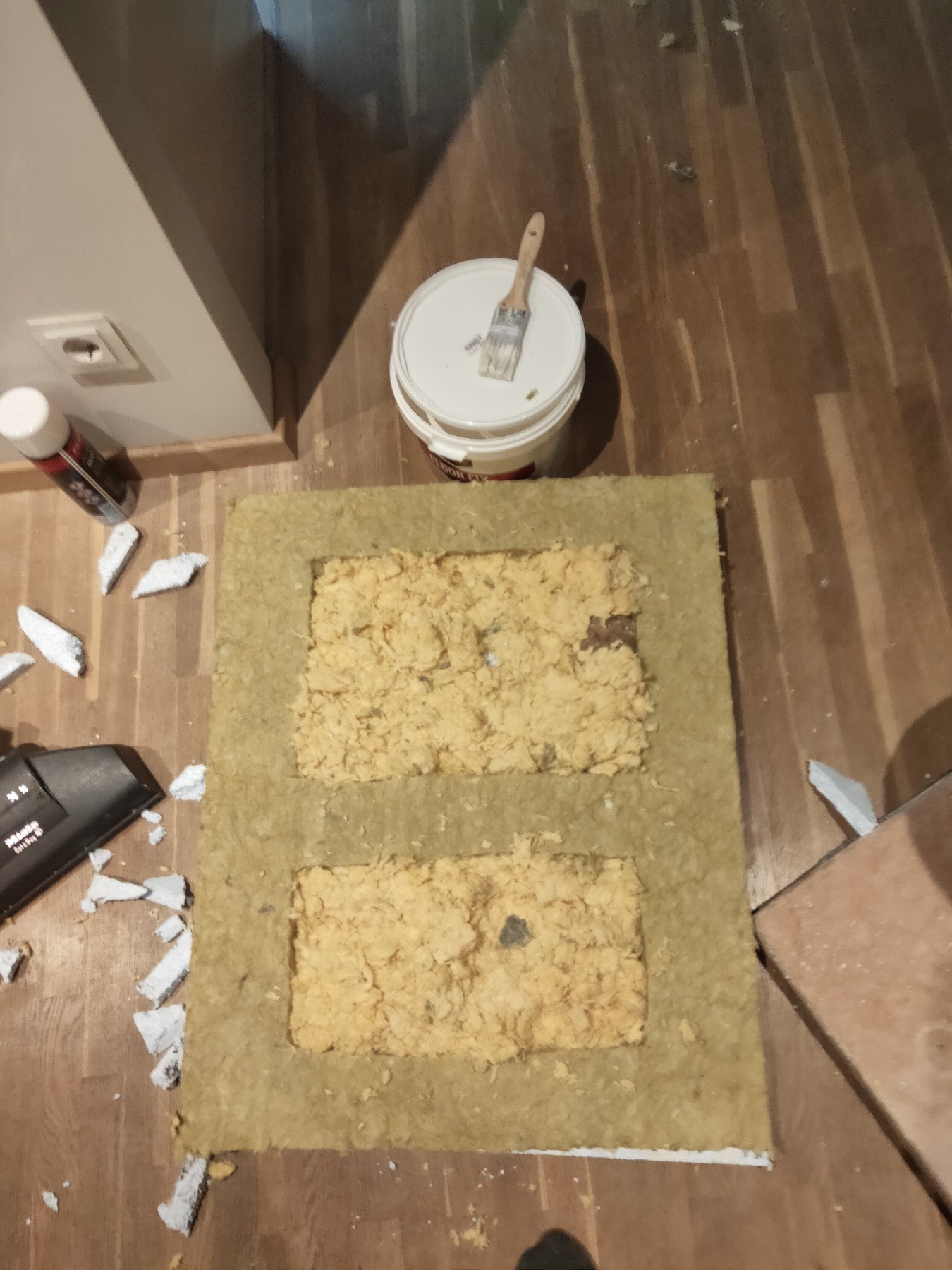

p.s. have built today some DIY panel from EPS frame and crumbly unpressed glass fiber wool inside. Glue is drying out, so tomorrow will see how it performs

You can look up the datasheets for materials and properties, but if you can't get them it doesn't help much https://www.rockfon.com/products/rockfon-koral/#Documents&Resources .I looked at some of the other products. I never heard about Rockfon, only about Rockwool brand products. They are not freely available in my country. I have a feeling, that they are pretty much... the same glass fiber or basalt fiber which is just covered with smth extra and given extra marketing weight and fancy brand name.

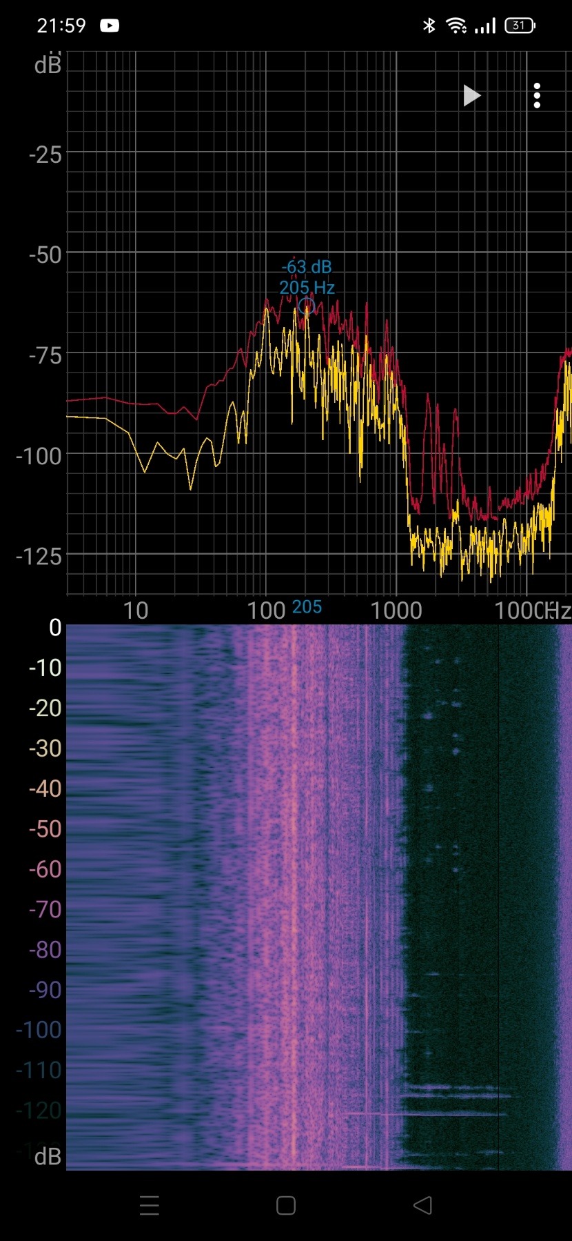

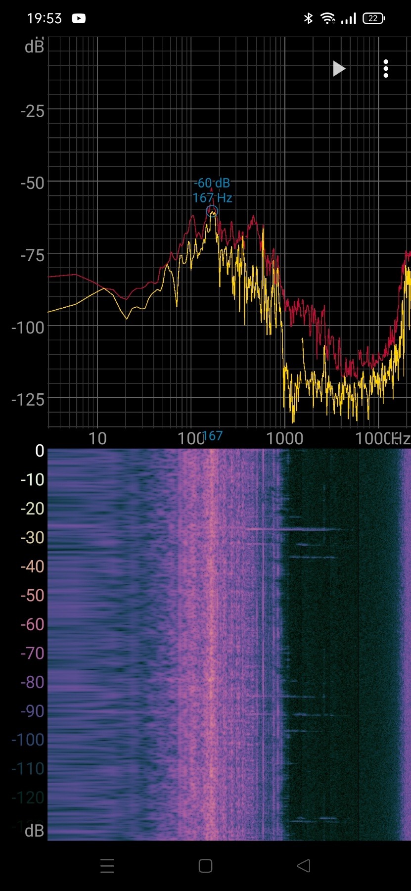

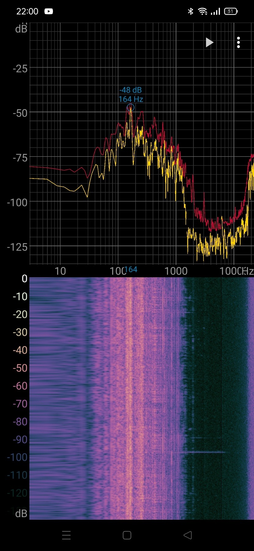

So, my little experiment results:
With open doors before and after
With closed doors (as it will be) before and after:

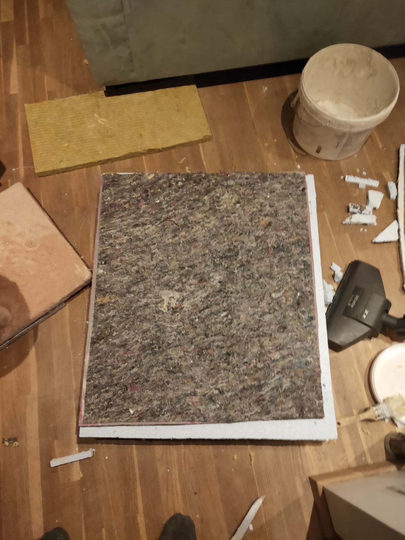

How it is made:
It is a
1x2mm felt
1x frame of 20mm EPS on perimeter
3x stone wool of 20mm with glass wool pretty dense filling
1x2mm felt
Everything covered with pretty light breathable fabric
It is **** and sticks... Budget of around 20EUR, as most of the materials I had as leftovers.
The overall result is kinda disappointment... I expected more
Subjectively it feels the difference is in 2dB range, sound just a bit softer. But there are still some resonances which... may be even stronger. Especially in low freq
The bad part is that I am not sure, if I not lost one of the files with closed doors before...
With open doors measurements are as they should be.
