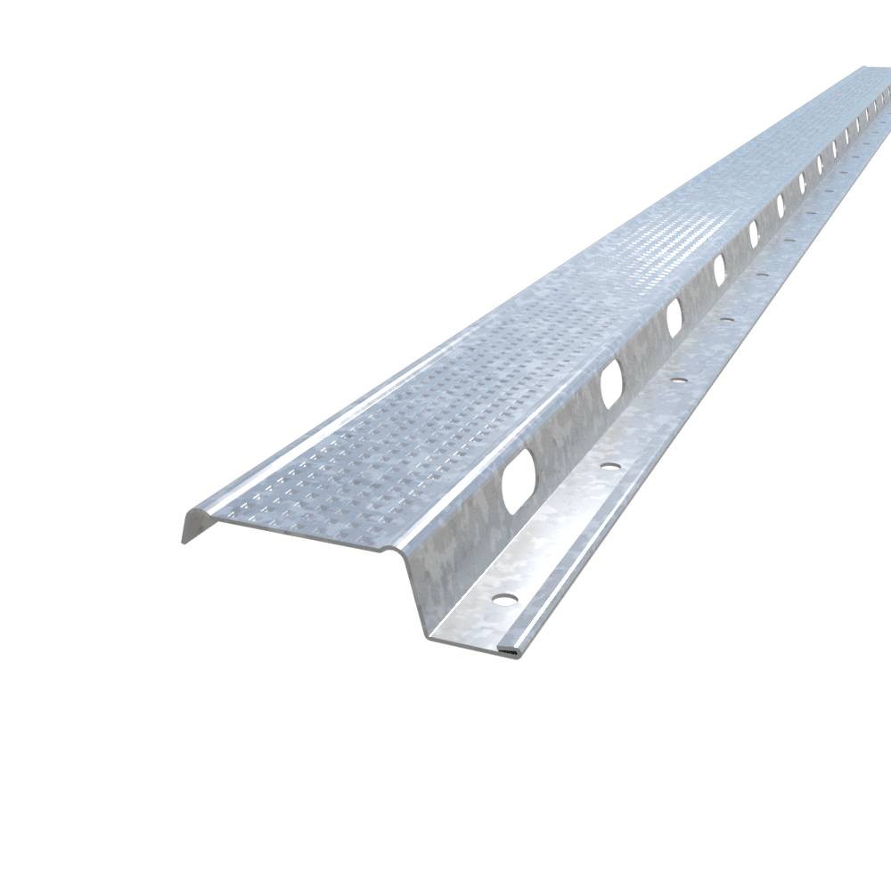

Good design. Just curious;
Did you use something on the back of the studs to hold the mineral wool in or just rely on a friction fit?
How much space was provided between stud walls?
Why didn't you use resilient channels?

RC-1 resilient channels are steel members designed to flex. They are attached to the studs and the gypsum board is fixed to the channels to increase the STC performance of the assembly.
Like all sound proofing construction detailing, they have to be installed carefully.
http://www.usg.com/content/dam/USG_...hed_assets/acoustical-assemblies-en-SA200.pdf
