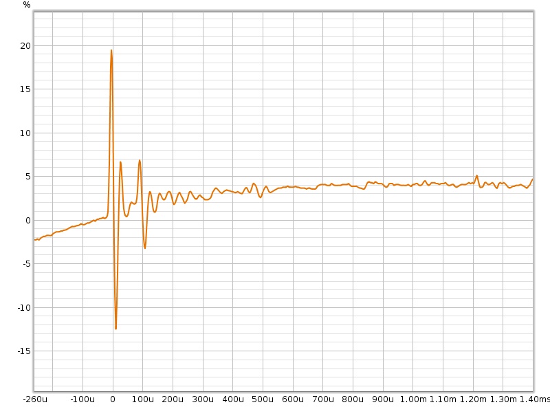

Here is the impulse response of that measurement.

I'm not sure what you mean by "set T=0 at the xkHz group" and you can't change the phase offset (you can only rotate it) by simply time shifting a signal. In any case here is what I got on the last thing you posted. This is peak at T=0 and +- 1 sample period. The phase change per sample shift is 45 degrees at 24kHz as it should be. From this a small sub-sample delay would make the phase almost perfectly flat out to 15kHz or so with a small shift beyond that as expected. I don't trust relying on what is going on at high frequencies for much of anything.

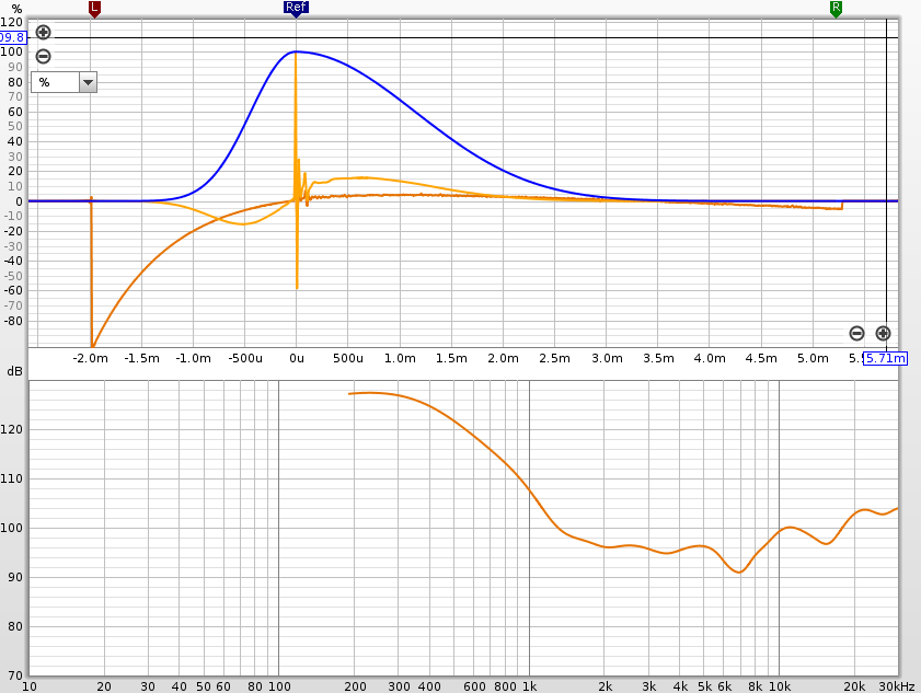

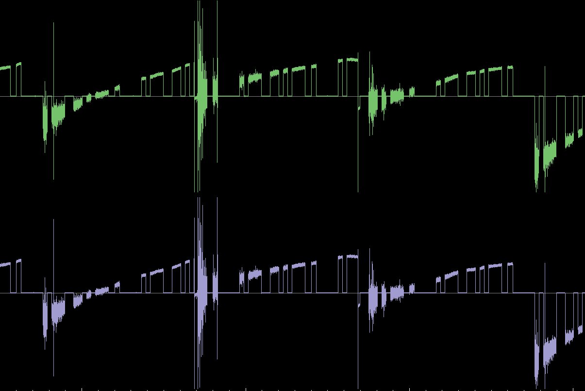

Your recording has a level of interference I've never seen. I don't see any acoustic overload which is good, but the interference leaves a DC drift which really limits the usable frequency range. Have you tried shorting the spark terminals and then seeing what the interference looks like?

This is the best I can get from that file. There is clearly something close to the spark causing comb filtering. Another possibility is that you are sparking twice as the coil driver opens and closes.

The gating effect on the audio seems like a driver bug though. Does it only happen while the sparker is running?

The waveform at the spark event looks like multiple discharges, when my setup is working well I just get one single blip. For that microphone the impulse response should be much cleaner.

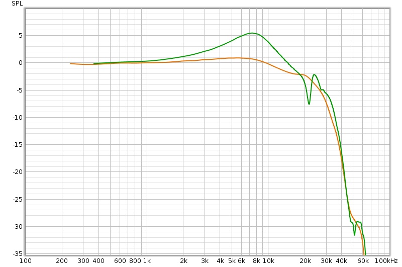

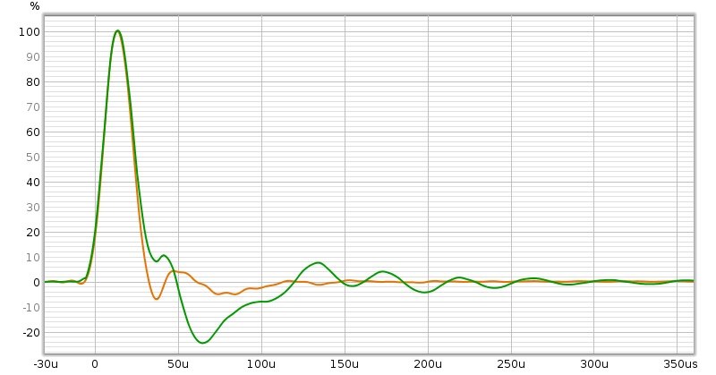

Attached is a comparison of an EM172 in a 22mm tube with a foam plug at the back, with the EM272 without the tube. I'm not sure whether the peak is part of the EM172's response or if it is a result of adding the tube or soldering, but I'm tending toward it just being the capsule's natural response.
