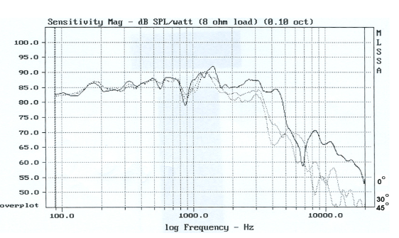

Morel does not show F3 value and their graph stops at 100Hz.
The box will have to be 12 inch wide or more. Based on our discussion last month, I will try those cross over points: 200, 400 and 800.

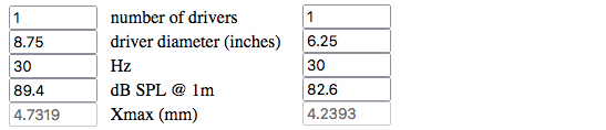

Walter,How can i see the performance differences based on specs only.
The one performance difference pertinent to choosing a subwoofer easily determined by specs only, when comparing those from one manufacturer is displacement, Sd x Xmax (linear excursion).
Morel uses a more conservative method to determine Xmax than some (many..) other manufacturers.
A quick estimate of usable linear displacement limited output levels for driver(s) in sealed enclosures can be found here:
http://www.baudline.com/erik/bass/xmaxer.html
You mentioned an 80 to 90 dB SPL level, the Morel 938 could reach near that level in it's linear range at 30Hz, while the smaller Sd 638 with less Xmax would have ~6.8 dB less clean output level.
A 5dB level change at 30Hz sounds about half as loud.
90dB at 30Hz sounds near equal loudness to 40dB at 1kHz.
Crossed at 200Hz at 90 dB, the Alpair 10.3 excursion would be a fraction of a millimeter.

Morel CAW 938
Rare in that it wants to be in a sealed box. 80 litres (or a bit smaller) will get you F6 30 Hz, F10 in the low 20s. If you have significant room gain you might want a larger box.
Strangly the spec sheet does not givew sensitivity.
The big divot at 900 Hz suggests XO below 400 Hz.

Very informative, thanks a lot.Walter,
Art

The 938 spec sheet gives a graphic representation of it's sensitivity, ranging from ~83 at 100Hz to 87 at 800Hz.

I can only guess at what would satisfy anyone else, why ask me ?How much air does it need to move to satisfy the OP?
If the OP wants 90dB at 30Hz, it would require ~9.5mm peak to peak excursion from a helper woofer with the Sd the Morel 938 has, as you can see in post #10.
That would be a displacement volume of 2080 cubic cm.
Any driver may be equalized to produce bass as low as one desires.The larger driver produces lower bass and has the displacement to back it up.
A larger driver with more excursion can produce more lower bass, as previously noted in post #10 .
Actually it does. 86 dB SPL @2.83v/1MStrangely the spec sheet does not give sensitivity.
