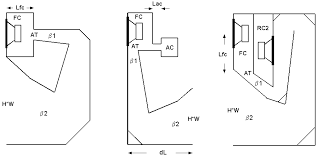

When using the type o boxplan, why is it that when loaded into hornresp the size of s2 goes to a crazy high number. thats when you have it in manual. If you click it and change it to auto, it changes to the same number as s1 or s3 etc. this also obviously changes the frequency response dramaticly. Should s2 be matching the size of s1? from my understanding it should with the given style of box. but then again im not sure what is being considered s2 and so on.
Ah, I suspect I know what it might be. Cone compensation. The model that BOXPLAN creates tries to emulate the impact of the volume of air in front of the driver's cone (and the cutout in the panel right in front of it) on the sim. Try putting an "o" instead of an "x" for the "Include Cone Compensation" option. That will turn the option off and S2 should be then equal to S1.

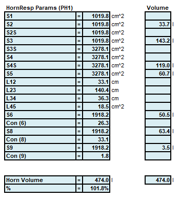

i did do that but it didnt change the problem. I justclick auto insteasd of manual and i would assume thats basically doing the same thing. Or is that not fully showing me an accuarate reslut? also question on changing the x and o, if i remove a panel and then export the boxplan with that panel removed. when i say removed i mean changing the x to an o. Is that just removing the panel in the picture or is that going to be removing the panel all together? basically if i remove the panel in boxplan then important it into hornresp are the results i get going to be the same with the panel removed in box plan that it would be if it was there?
Adding or removing the panels in the spreadsheet is only for identifying which panels are being referred to, when you're trying to figure out cutsheets and their locations. It won't change the corresponding Hornresp sim. Deselecting the cone compensation however WILL change the Hornresp sim.
e.g. these are the Hornresp sim parameters for a sample type O with cone compensation off...

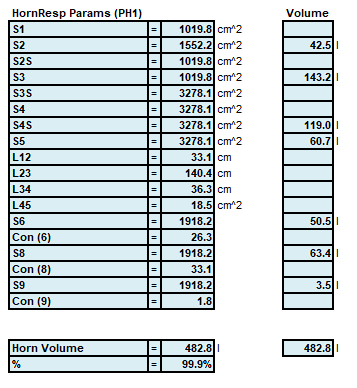

And there are the Hornresp sim parameters for the same box with the cone compensation on, nothing else changed. Note the change to S2.
The increase @s2 is an attempt to approximate the effects of the volume of air in front of the driver's cone that sits between it and the chamber that it faces into.

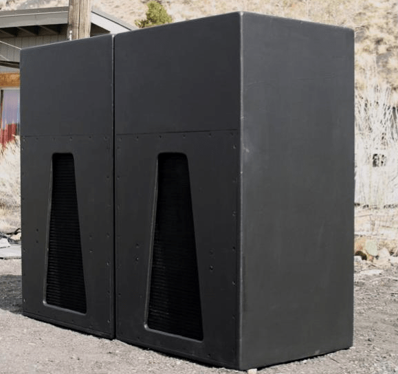

Hello, Brian. I request tapped horn design (especially SFTH style designs) spreadsheets allow for Art Welter style slot, at the horn exit, as an enable/disable feature. As long as exit velocity is within reasonable value, it can improve bass response, low pass filtering and directivity (to some extent).
