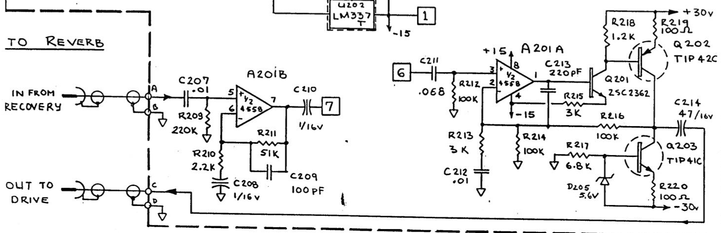

This Pearce G1 reverb driver and recovery (same designer as Gibson/Lab L5 but much simpler and doable) drives springs HARD: 60Vpp from a couple TO220 mid power transistors
The first kits were all through hole components and looked pretty straightforward to build, then they offered an assembled board of mostly SMD components. I like the one JM posted for the tank driver circuit, and it wouldn't be hard to put together a decent preamp and recovery stage using either op amps or jfets.Man, I missed the boat when they had these as kits for sale. Now their prebuilt units are going for 300-400 bucks. Ugh!

no, unfortunately I didn't. Anyway, I don't think that you need two tanks for your purpose. Many decades ago there were even units that would fit to your purpose. The most popular one probably was The Fisher Dynamic Space Expander K-10.
