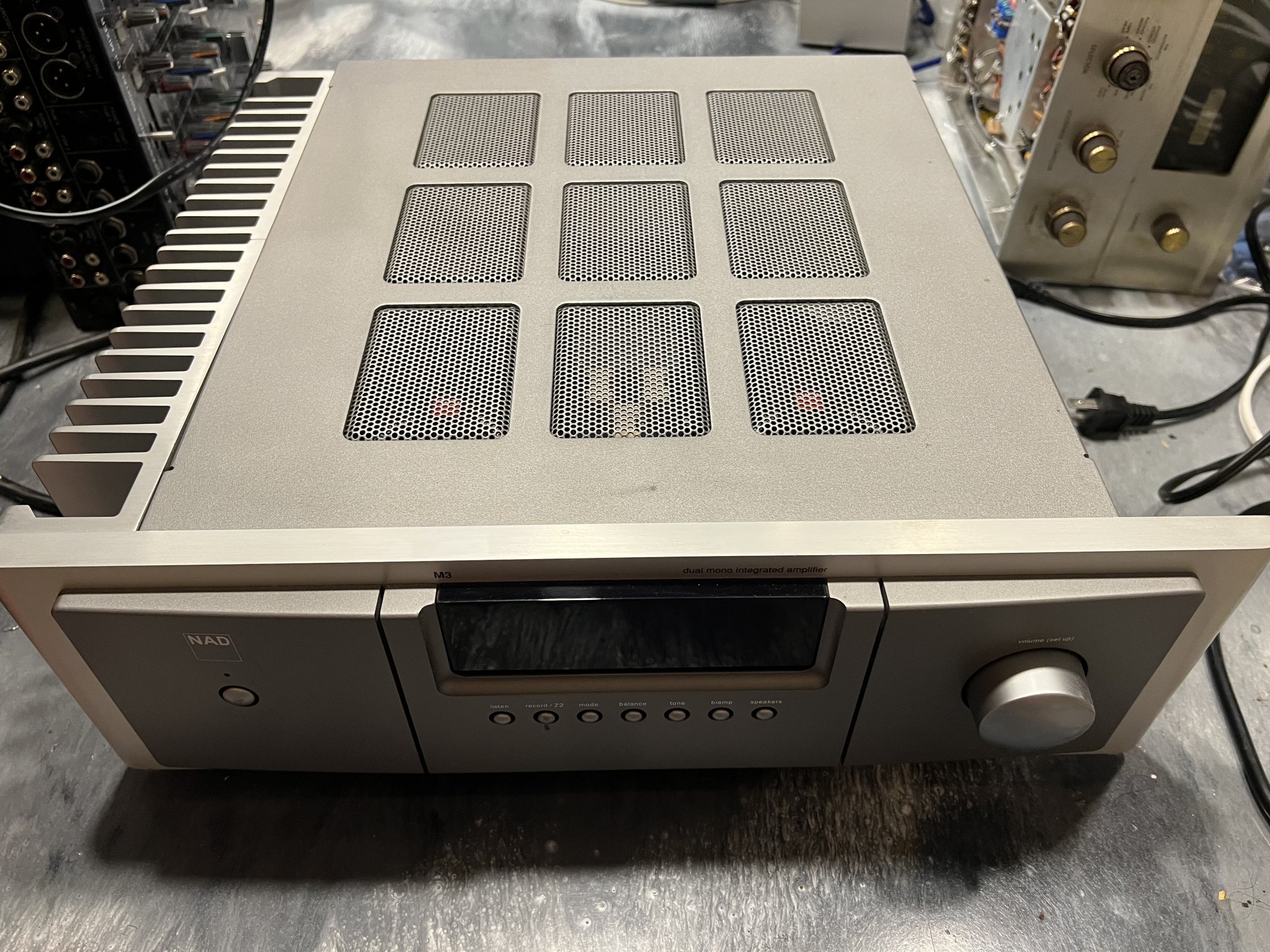

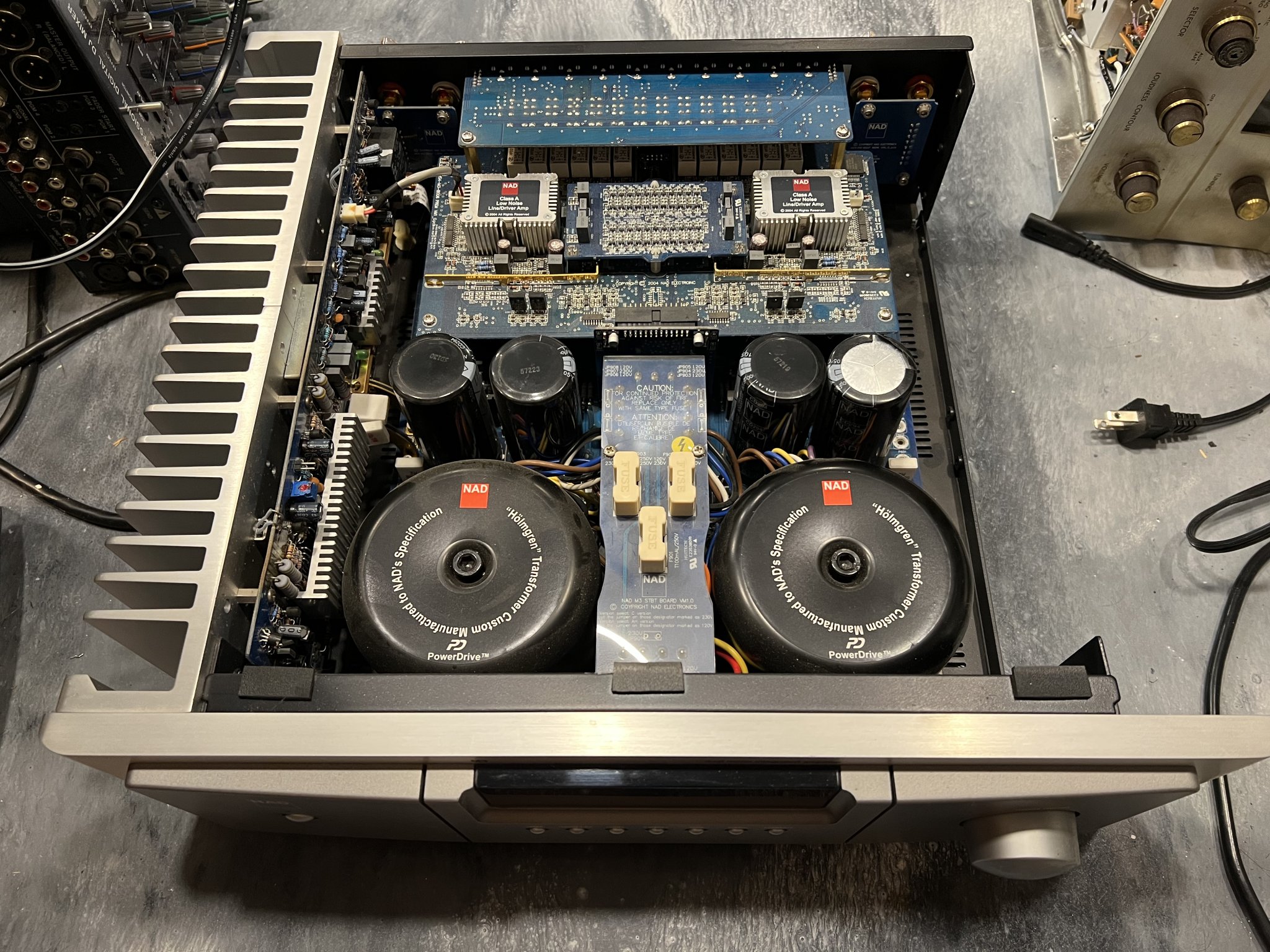

I received an NAD M3 in a small pile of broken gear. It is in mint condition otherwise, it powers up, but won’t come out if it’s protection mode. It isn’t very old, but seeing the four main filters all bulging I had an idea of what was wrong.

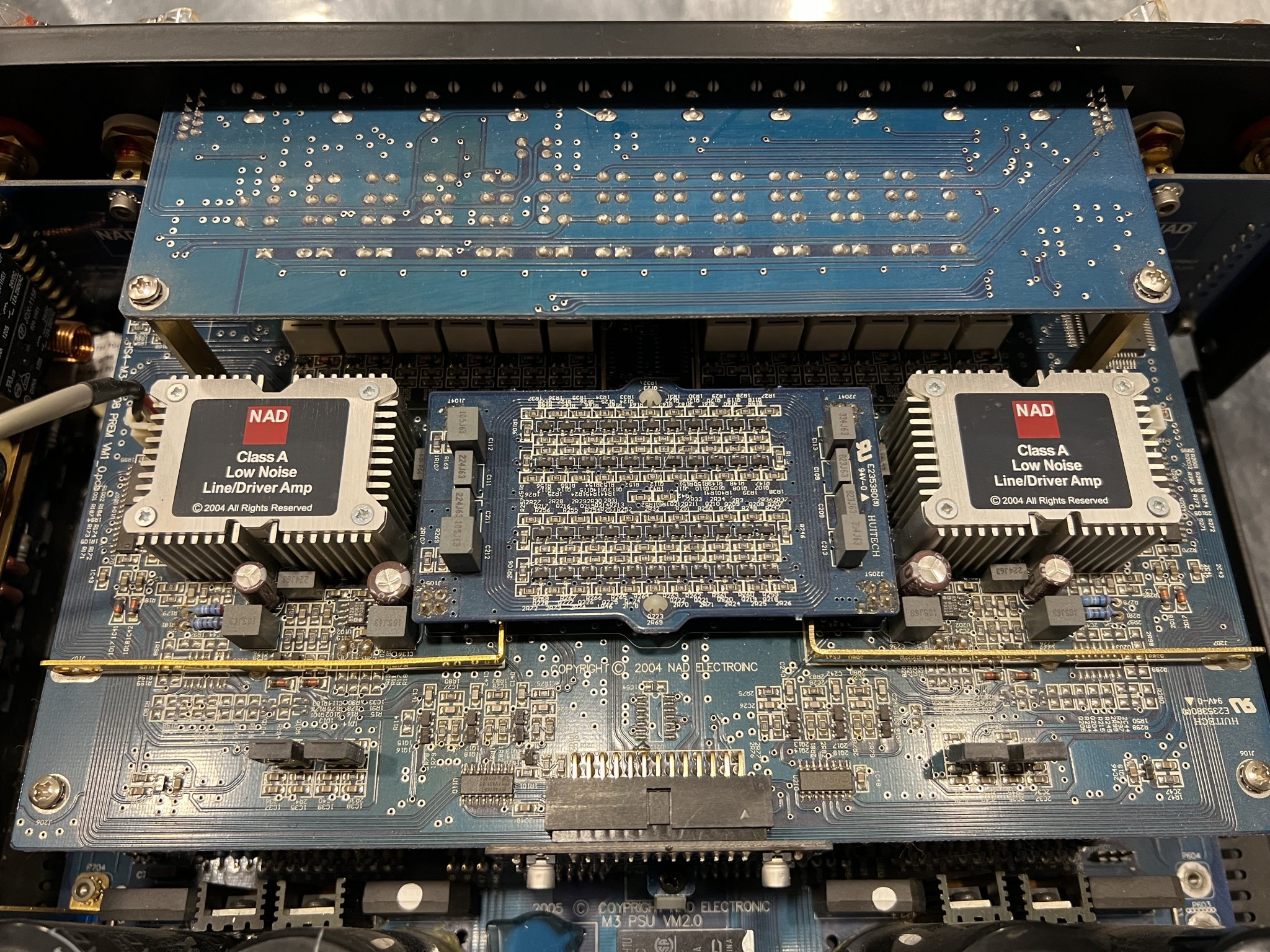

I disassembled it and am currently working on the two amplifier boards. Nearly every capacitor on the board has very high ESR, like a 330uF 16v with and ESR of 27 ohms. Not sure why they choose to use garbage caps, but I find more bad caps in NAD gear than anything else lol. Other than that it seems to be a really, really nice dual mono design.
I was thinking that while I had it apart that maybe I should do some modifications to it, see if I might be able to get some audible improvement.
First: transistors, it uses decent signal transistors throughout the board, mostly being 2SC2240, 2SA970 and 2SC1815, 2SA1015. It also has a pair of 2SA1360 and a pair of 2SC3423. For drivers it uses 2SC4793 and 2SA1837, which I’ve read are actually pretty decent and make good drivers for the outputs I’m thinking of swapping to.
So it originally came with 4 2SC5200 and 4 2SA1943 in each channel. When asking about a transistor sub I learned that while this pair is okay (would have been a downgrade from what I wanted to sub), that a far superior pair would be the MJL3281 and MJL1302. I have several of each from Onsemi/Fairchild. Would this be a worthwhile improvement? Would there be an audible change noticed? Or would I just be wasting money and parts?
Next would be the opamp on each board. Currently uses TL082CP and thinking of an upgrade to maybe a an OPA device like 2134, maybe a 5532, maybe if I’ve had a few too many to drink order the Muses02??? I’d love to hear some suggestions as to what people think would be the best replacement in the $20 or under per device would be. Unless you think of something that is worth more than it’s cost like a Muses02 or a Burson Audio. I wouldn’t mind trying one of these exotic as long as people think it’s worth it.

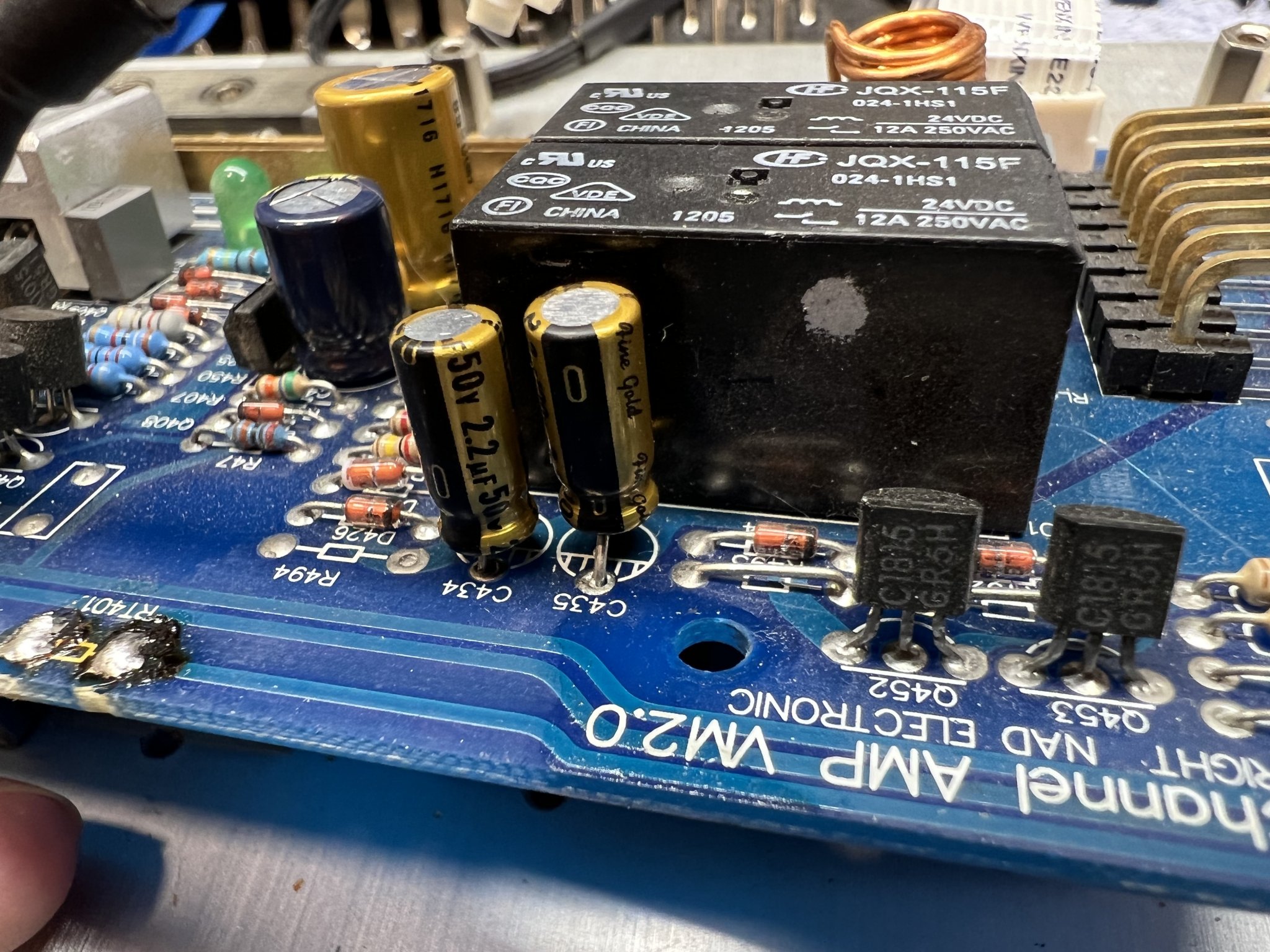

Oh, also wanted to ask this here. I asked over at audiokarma and nobody knows why they went this route.

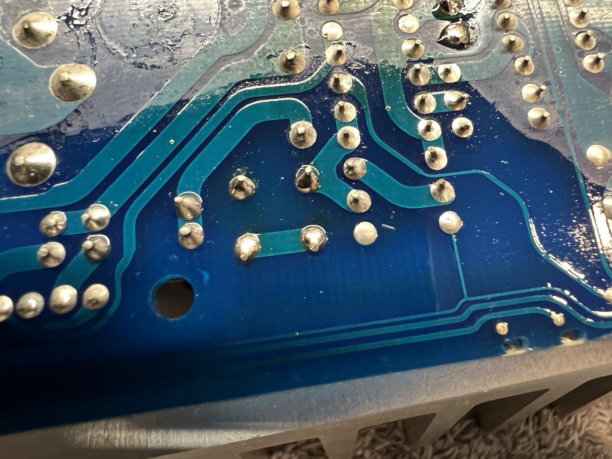

There are two 2.2uf 50v electrolytic caps on this board and they are wired in series, negatives connected together.
You can see the single trace there connecting the negatives, nothing else goes to that trace. Why would the choose to do it this way instead of using a single 1 uF 100v bipolar electrolytic or a film cap? There are already a few 1 uF 100v films on the board, so you know they had them. I’m confused on why they would choose this route, as I’m thinking of just throwing a 1uF 100v Wima polypropylene in there, but want to make sure I don’t mess anything up.

I would replace the bad electrolytic capacitors and whatever parts are needed to get amp back up and running and leave the rest alone. If you look at the schematic the opamp doesnt seem to be in the signal path so it will likely have no effect on the sound quality.
I would replace the series 2.2 uf electrolytic caps with a film cap if you can make it fit. I've tried back to back 10000 uf electrolytic caps as a speaker cap on a split supply amp, for speaker protection, and it made the sound a little funny on 1 vac output. That is where I listen to my amps most of the time, with 98 db 1w1m speakers. If you can't make the film cap fit I've used 1 uf 50 vac cog ceramic caps for the input cap without audible result. Input signals are < 2vac so the 50 volt rating straightens out some of the non-linearities of ceramic.
I would replace the electrolytic caps if you intend to keep the amp. I use industrial grade long life (>3000 hours service life) nichicon panasonic rubicon or kemet electrolytic caps, not pricey "audio" caps. See if that takes it out of protection mode. I find ebay prices are higher for NAD than some other brands, but selling old amps is not a real moneymaker if you value your time. Brands use short life electrolytic caps to trash the amp at a defined number of years and cause the owner to buy a new one. Lots of bad cap NADs on this forum, they apparently weren't designing for long life. I find Peavey design life to be about 20000 or up hours, tougher than most consumer market amps. If designers used epoxy seal electrolytic caps amps might last forever, which no marketing executive would want.
Film caps don't deteriorate so I'm not sure why a wima would be better than what is in there. Mylar film causes some minor distortion versus polyprophylene but there were hundreds of sources of polyprophylene besides wima.
Emitter follower output transistors don't really affect the sound so I would not replace the 2sa1943 2sc5200 if it didn't blow up the originals. With that huge heat sink would take a shorted wire to damage the output transistors.
Those driver & first stage transistors have enough Ft to not cause distortion, so I would leave them alone.
Agree op amp swapping is useful only for first stage in the sound path op amp. No benefit in the DC servo position. TL082 is slow and not prone to oscillate so modifications would be required to prevent oscillation in low noise substitutions like ST33078.
Resistors are not carbon comp so little benefit to swapping if they are metal film. If carbon film there is some slight benefit in thermal noise of metal film resistors 470 kohm or higher in value. Wirewound in the output stages is the standard technology and the slight inductance helps to prevent oscillations.

Wow, thank you, that covers pretty much everything. I’ll be swapping the back to back electrolytics with film.
As far as the film caps in there currently, concern comes from the possibility of them being garbage quality just as the electrolytics are. Only reason I suggest Wima is because I have a few thousand of various values.
No intentions of selling the amp, plan is to fix it and use it. When working it’s a wonderful sounding and powerful amplifier.
Overall sounds like it’s a properly designed amp and not really much I can do to improve on it.
