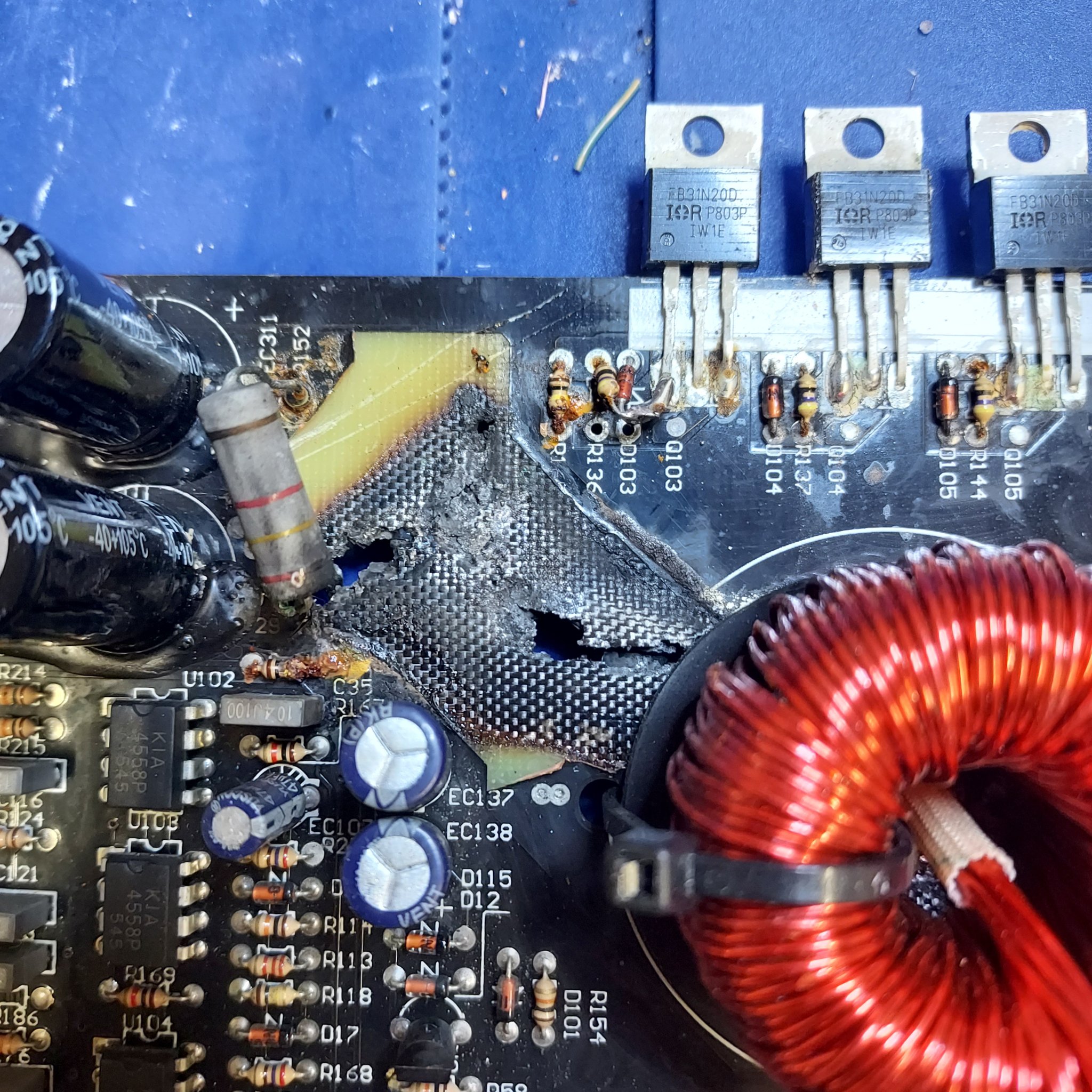

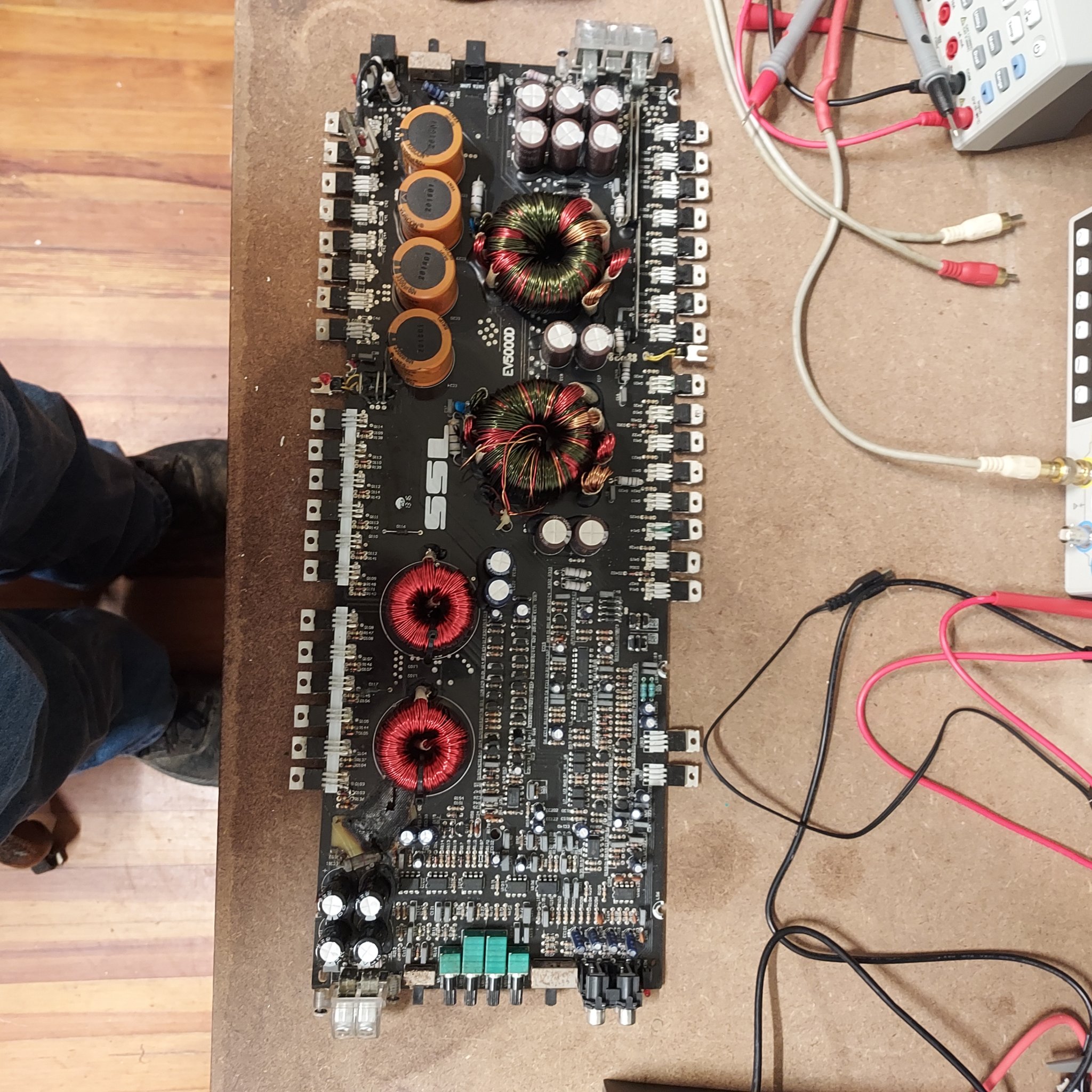

Does anyone have a schematic and/or good photos of the top and bottom of the PCB for this amp?
D Don Hathcock Member Joined 2021 2024-03-14 7:27 pm #1 2024-03-14 7:27 pm #1 Does anyone have a schematic and/or good photos of the top and bottom of the PCB for this amp? Attachments 20240311_162742.jpg 704.1 KB · Views: 45 20240312_123318.jpg 764.4 KB · Views: 45 ••• More options Share P Perry Babin Member Joined 2003 bcae1.com 2024-03-14 10:01 pm #2 2024-03-14 10:01 pm #2 This is a fairly generic amplifier. Multiple diagrams are likely good enough but before you can do anything, you will have to cut away 100% of the carbonized board. You have to cut back until you see clean white fiberglass. ••• More options Share D Don Hathcock Member Joined 2021 2024-03-15 5:00 pm #3 2024-03-15 5:00 pm #3 I have. What is the best epoxy to use to fill this? ••• More options Share P Perry Babin Member Joined 2003 bcae1.com 2024-03-15 5:15 pm #4 2024-03-15 5:15 pm #4 Why do you want to fill it? ••• More options Share Show hidden low quality content You must log in or register to reply here. Share: Facebook Twitter Reddit Pinterest Tumblr WhatsApp Email Share Link
