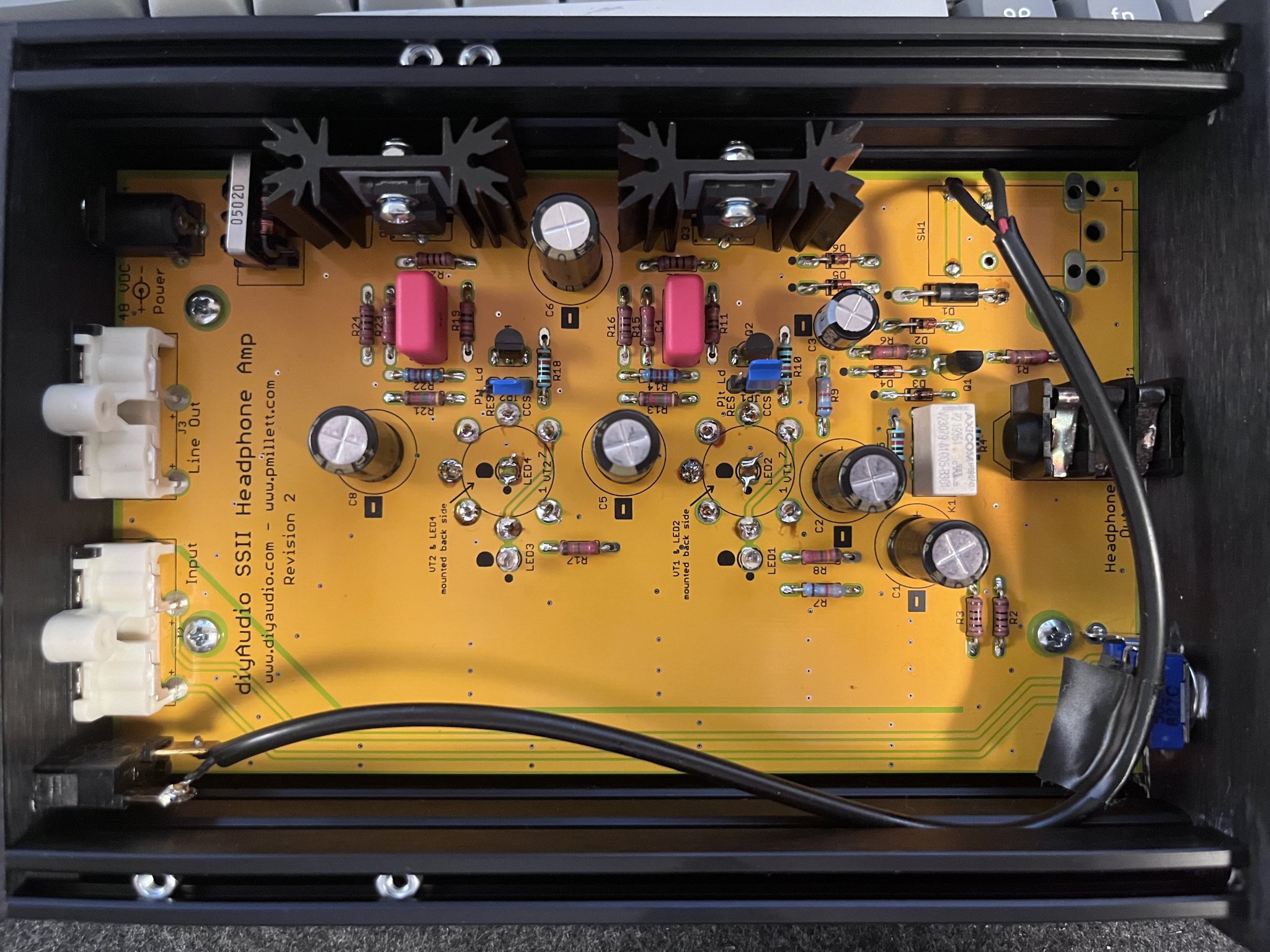

I am sad to say I have hit a wall.
I am currently getting 19.1V on VT1 and 19.0V on VT2. I was stoked, plugged up and no sound haha.
Read through the forms here and reflowed my diodes, as like others I do not hear my relay clicking after power has been turned on.
Wondering if someone could help me confirm some voltages?
Currently measuring across each device I have:
13.6V across D5 and D6
3.3V across D4
13.6 V across D2
20.4V across D3
3.2V across R6
3.2V across R1
I have no voltage to ground on any of my relay pins.
I am at a wall and would buy anyone who could lend a hand a coffee at this point haha.
Cheers gents and thanks for reading.
Edit 2:31 EST
Well boys...... like most things in life I fixed this one with a smoke break. Came back and stared at the board under the magnifying glass and I found a single pin I missed on the relay like a dunce haha. Turns our Pete's troubleshooting guide had my answer all along lol.
Going to case up and see how she runs. I was getting sound but it was hit or miss becuase my RCA cables were backing out,
Swapped RCA cables and struggled for a minute until I realized I did not have my jumper at JP1 and JP2 installed. Just a heads up to anyone else if you build it and get clear, but very quiet sound.
Super excited to have this one complete. Thanks Pete for the great documentation and thanks to everyone who commented on the forum. Reading all your discussions was a big help.
My first DIY down!

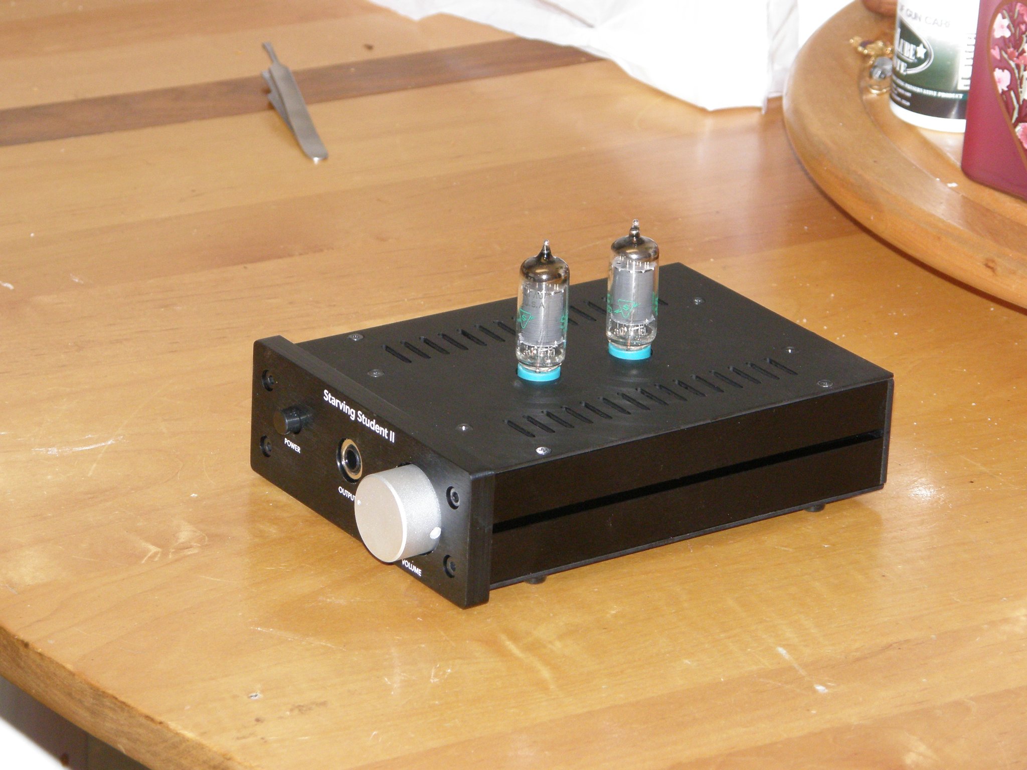

Shortly, I hope to be building a SS II for a friend. This isn't my first go at Pete Millett's designs, as I have bought numerous kits from him in the past. After recommending the Hi-Fi Man headphones as a good place to start, I then told my friend that this may not be the end of things as far as sound from the phones. That conversation quickly jumped to what sort of headphone amp 'would be best' with these headphones. I clench my teeth when people ask that kind of question about anything. Define best. Ok, so I said to him that it is also a good idea to let build this kit for him and see what happens. Of course, I expect that he will be thrilled with the results. As always, you can spend more and maybe get more, but at this price point, I bet this satisfies quite well.
Yah, I will be posting photos and possible questions as it all starts.
Well, I am only adding the photo as proof... so there's that. Let me say that I didn't refer to the build guide expect for the LEDs just to make sure. Wasn't going for a record either, but I built it in a couple of hours. That is all good and well, but the sound. Isn't that why we buy? Ok. I listened a short time and am honestly saying that my friend will fall down dead when he hears this. These damned little tubes all have that special sound to them, like it or not. Yes, of course, I am a huge fan of this sound. Listened to George Winston on piano, and immediately was struck by the harmonics in that recording. Then I went to a Bad Company CD and like it a little less. Went from there to using the preamp for its volume controlled output instead of using the tape out. This is important. The HI-FI Man 400SE phones that I have are really efficient and so the volume control on the SSII doesn't have much range at all. If on the other hand you use the preamp volume control to feed the SSII then of course you have a better chance. Overdriving this HP amp is well just like you would expect, nasty. When these tubes don't get blasted with signal they make their best sound. OOH OOH, I have to mention something cool. The tubes sent with the amp are Sylvania and not Raytheon. So, you can even tap the tubes themselves and nothing happens, like microphonics. Hmmm.
Next time around, I want to build the Whammy.
