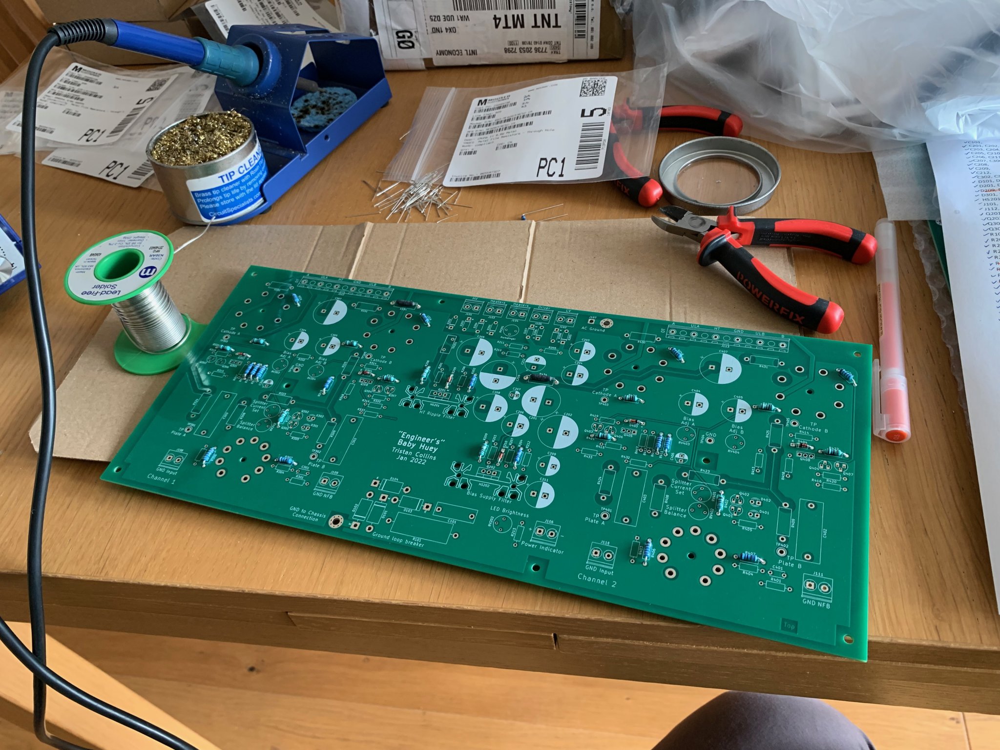

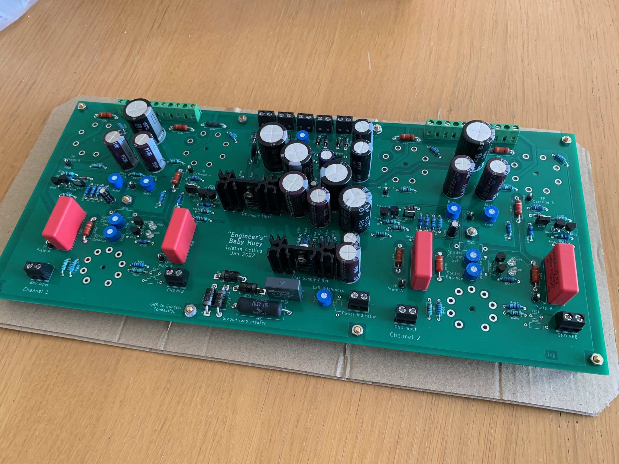

I started drawing a design in KiCad over 2 years ago, possibly 3 years ago! This morning I finally started assembly.
In 3 or 4 hours I was able to populate the PCB with all major components, starting with resistors and diodes, then moving to connectors, transistors and capacitors, in order of size. It was fairly simple. Photos attached.

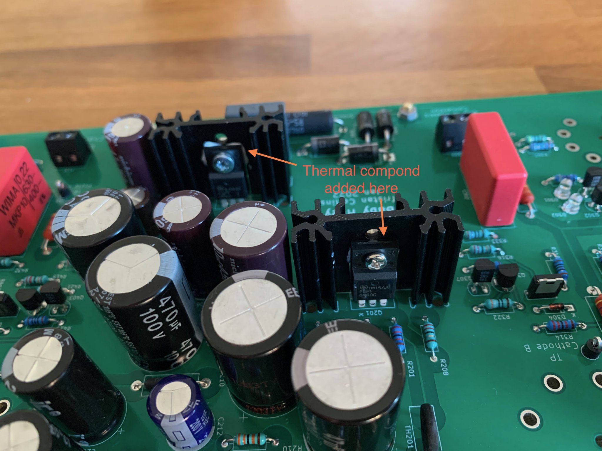

Adding a couple more details from yesterday's progress. I added thermal compound (a tiny amount) between Q201, Q202 and their heatsinks. The parts in the BoM are encapsulated in plastic so isolated from the heatsink. I used a couple of M3 screws and bolts

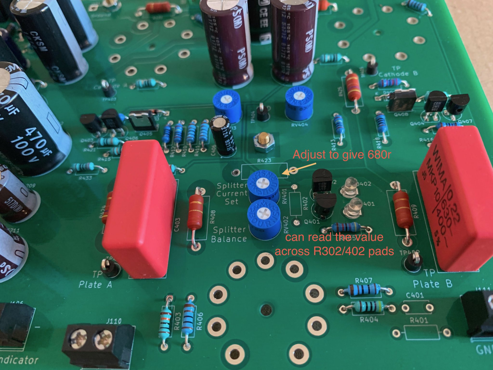

I also adjusted RV301/401 to read 680r - using the pads for R302/402 to take a reading. This brings the trim pot in to line with the schematic value - so in the ballpark of where it should be at first switch-on. Adjustments can be made from this point rather than at some (potentially random) point on the pot's travel.

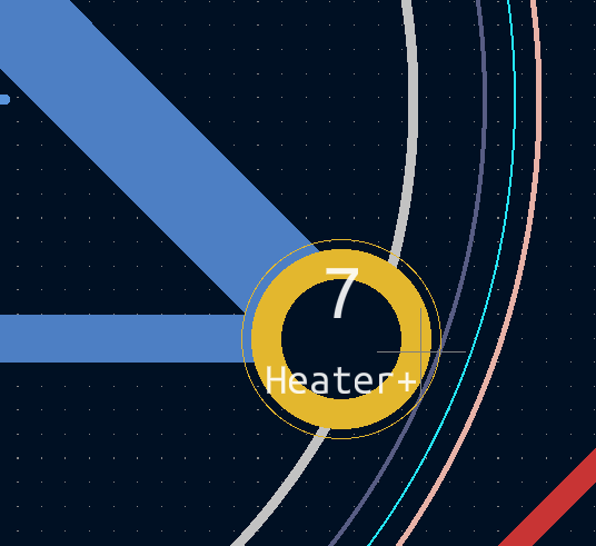

My only comment so far is to avoid acute angles like this because they may trap acid during the PCB etching process.
I've just ordered some EL84 BH PCBs after my group-buy ones accumulated too many mods. It's so cheap to get your own made and I really enjoy the design process so I wouldn't order group-buy boards again.
I believe acid traps aren't really an issue any more at fab houses. I agree it would be nicer to have wider angles - I'll add that to tweaks in a future version.

Juste a question, you use ground plane but without via stitching. Why ?
I had two options - a ground plane one side or a ground plane both sides. I couldn't get a good answer as to whether having a ground plane on both sides (potentially stitched together) was preferable. So I went with what Pete Millett does and have a single side ground plane.
I spoke to a few way, way more experienced EEs than me who basically said stitching wasn't worth it at audio frequencies. And looking around at other manufactured hifi PCBs I don't see many using the approach. Also, I'd be nervous if the via count hit a limit with the cheap PCB fabs (not sure if there is one?) given the size of the board.

You're right. It's rare to see PCB with via between ground planes. I don't understand why. Vias give lowest impedance ground plane and better EMC performance on 2 layers PCB.
There is no via count with JLCPCB.

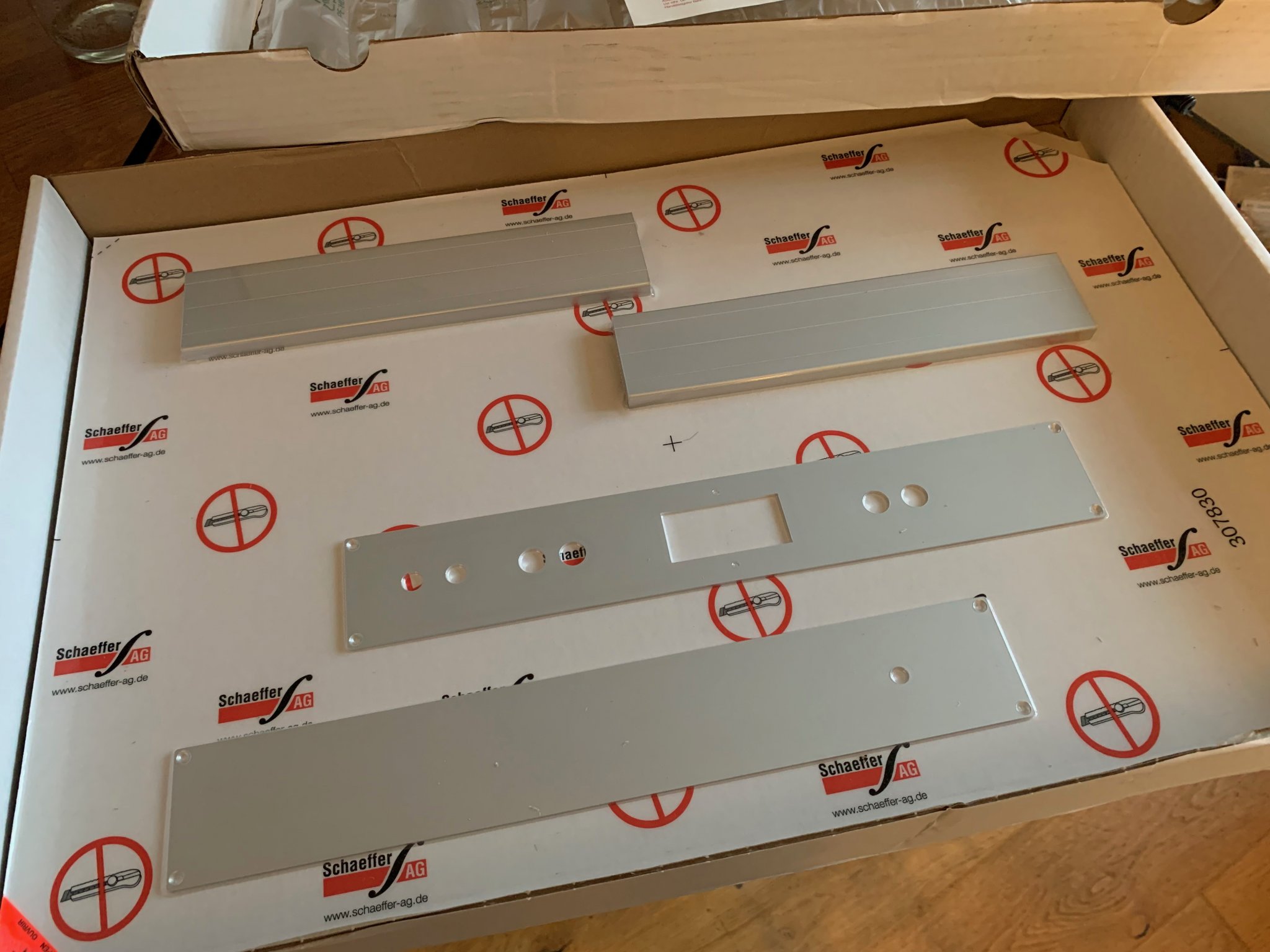

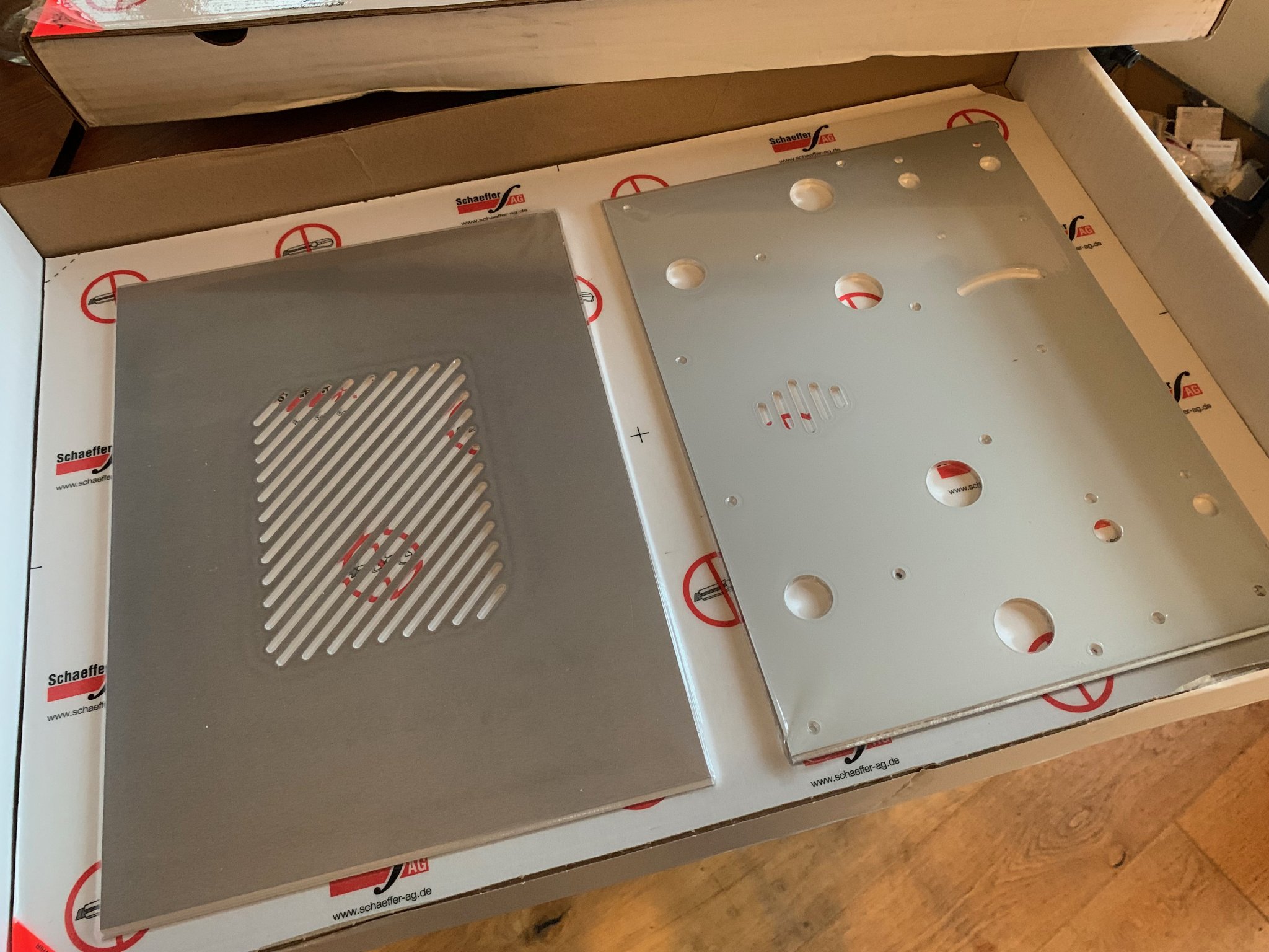

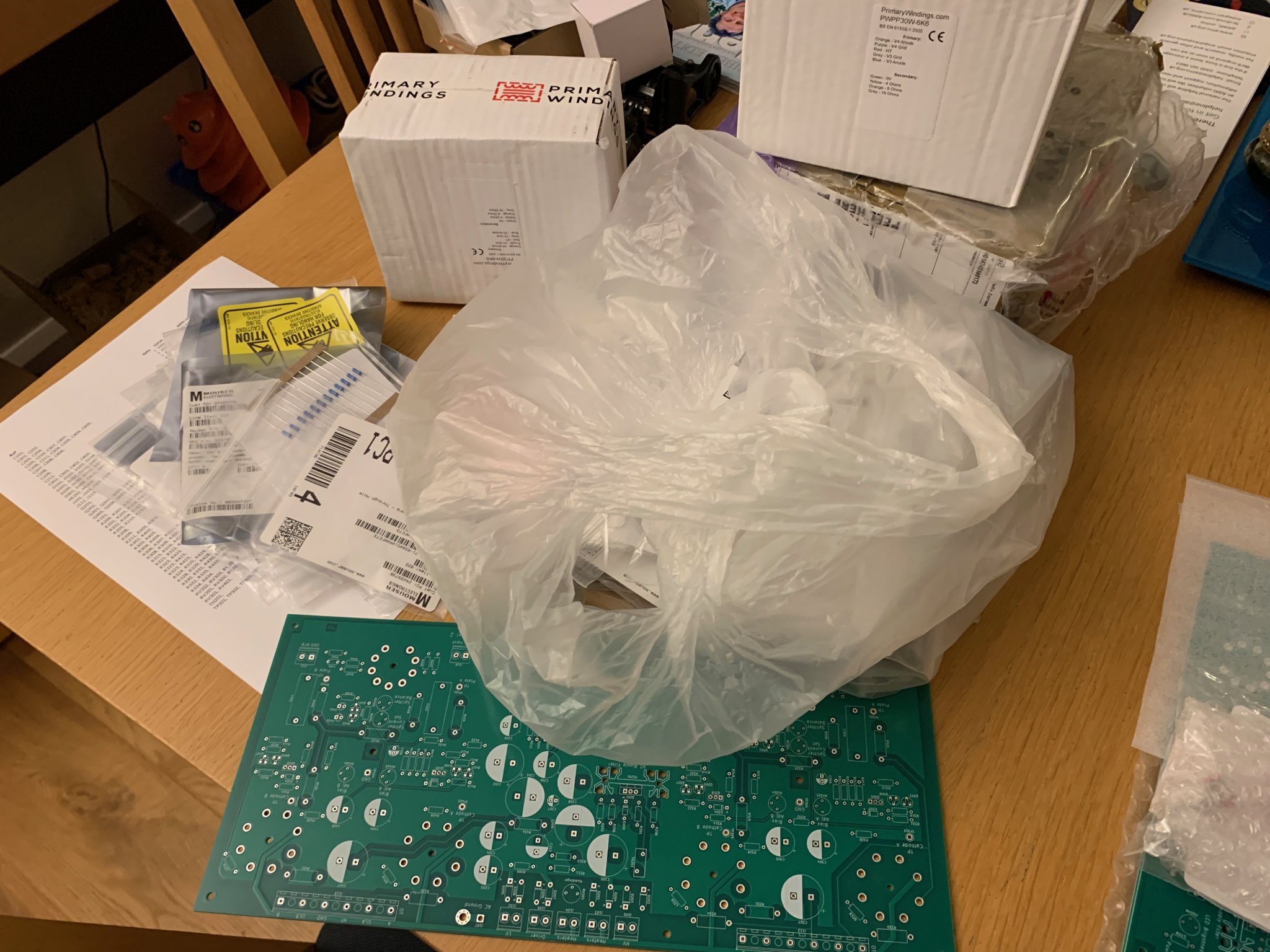

The chassis from Schaeffer arrived today.
Looking good apart from the holes for mounting the OT might be slightly too close together when I brought the two together for a quick test fit. A quick pass with a circular file should fix it if they are too tight.
I reckon I have all the parts needed to complete the build - just need a free day...

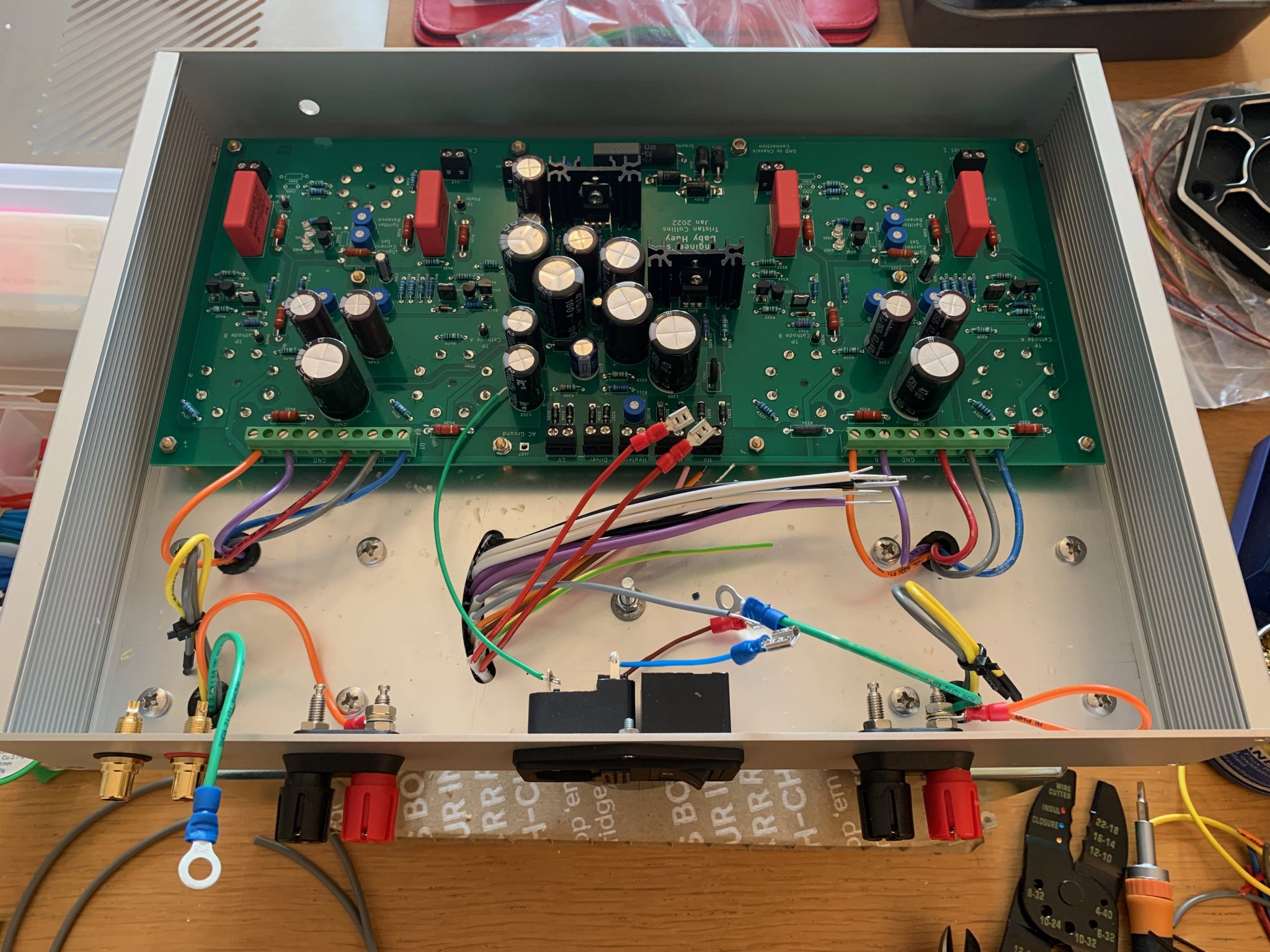

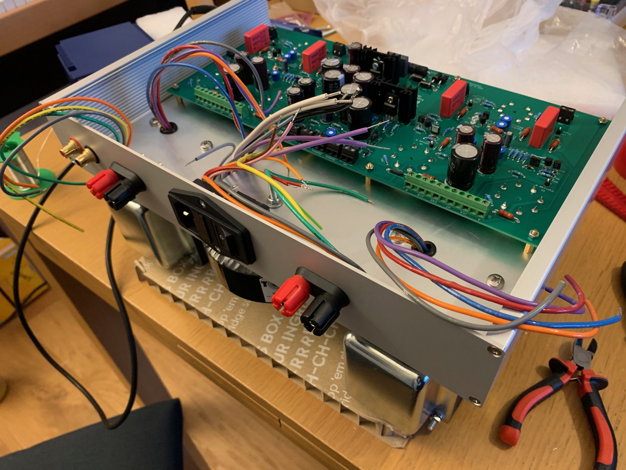

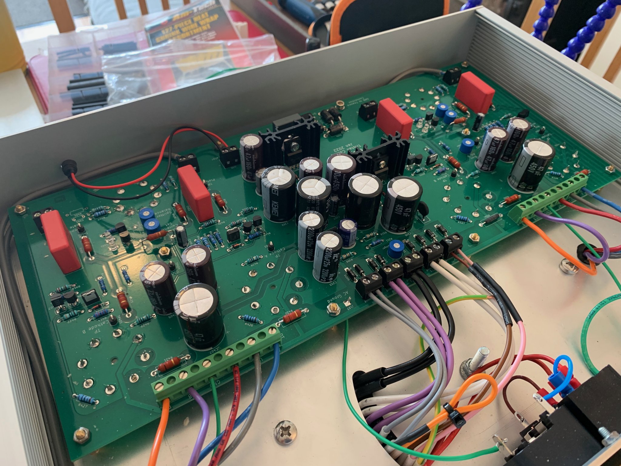

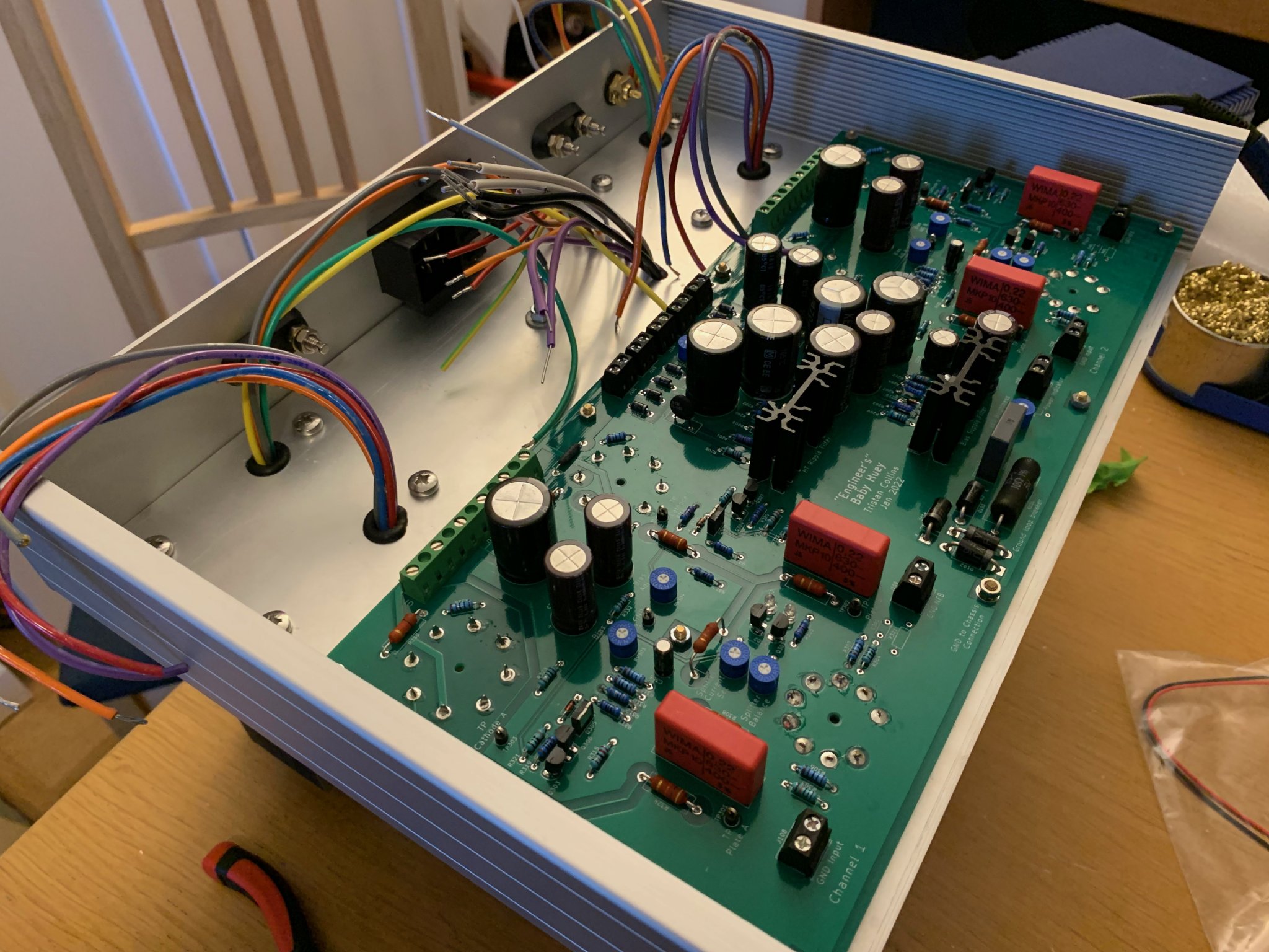

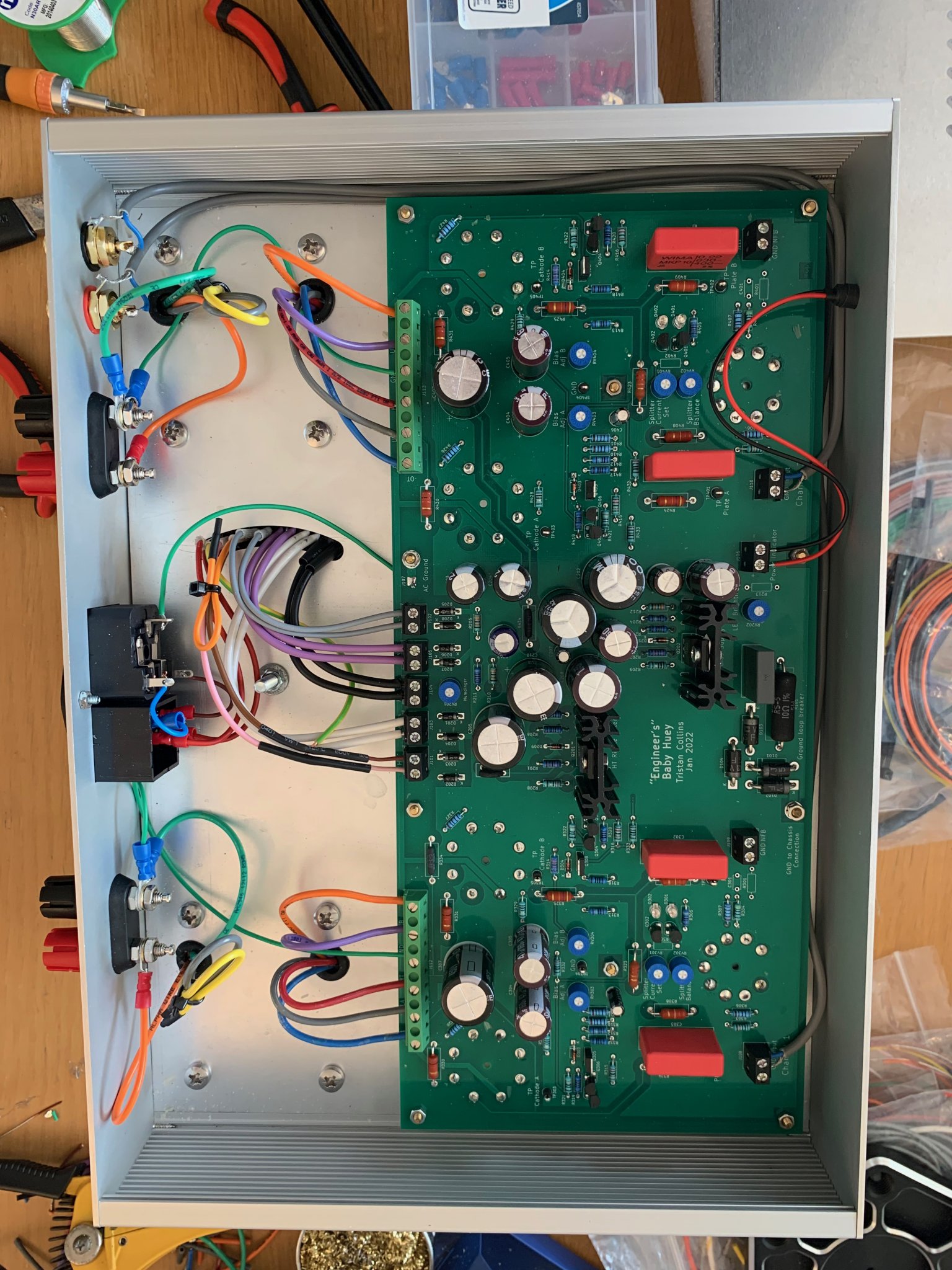

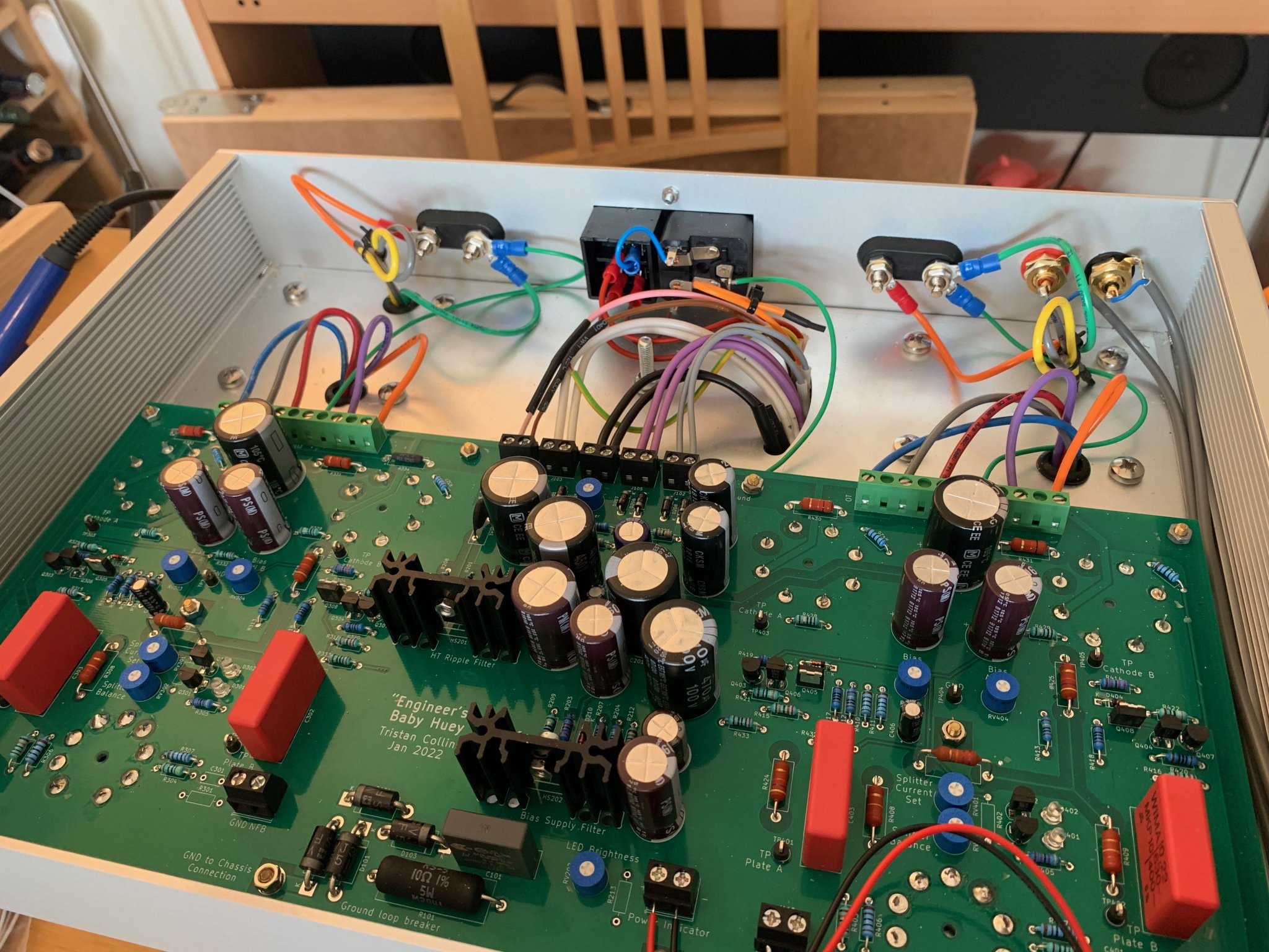

So I managed to grab a few hours over the weekend to get this progressed. Attached are a few pics along the way.
Here’s where it’s at now:

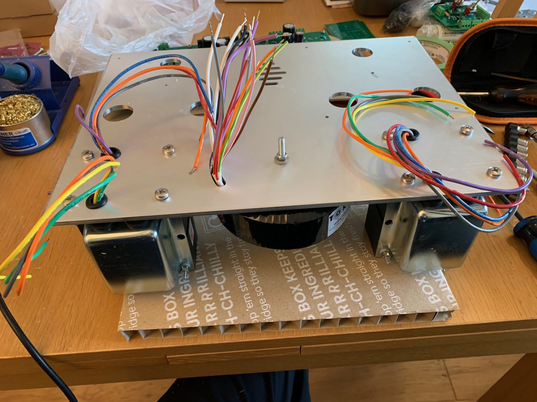

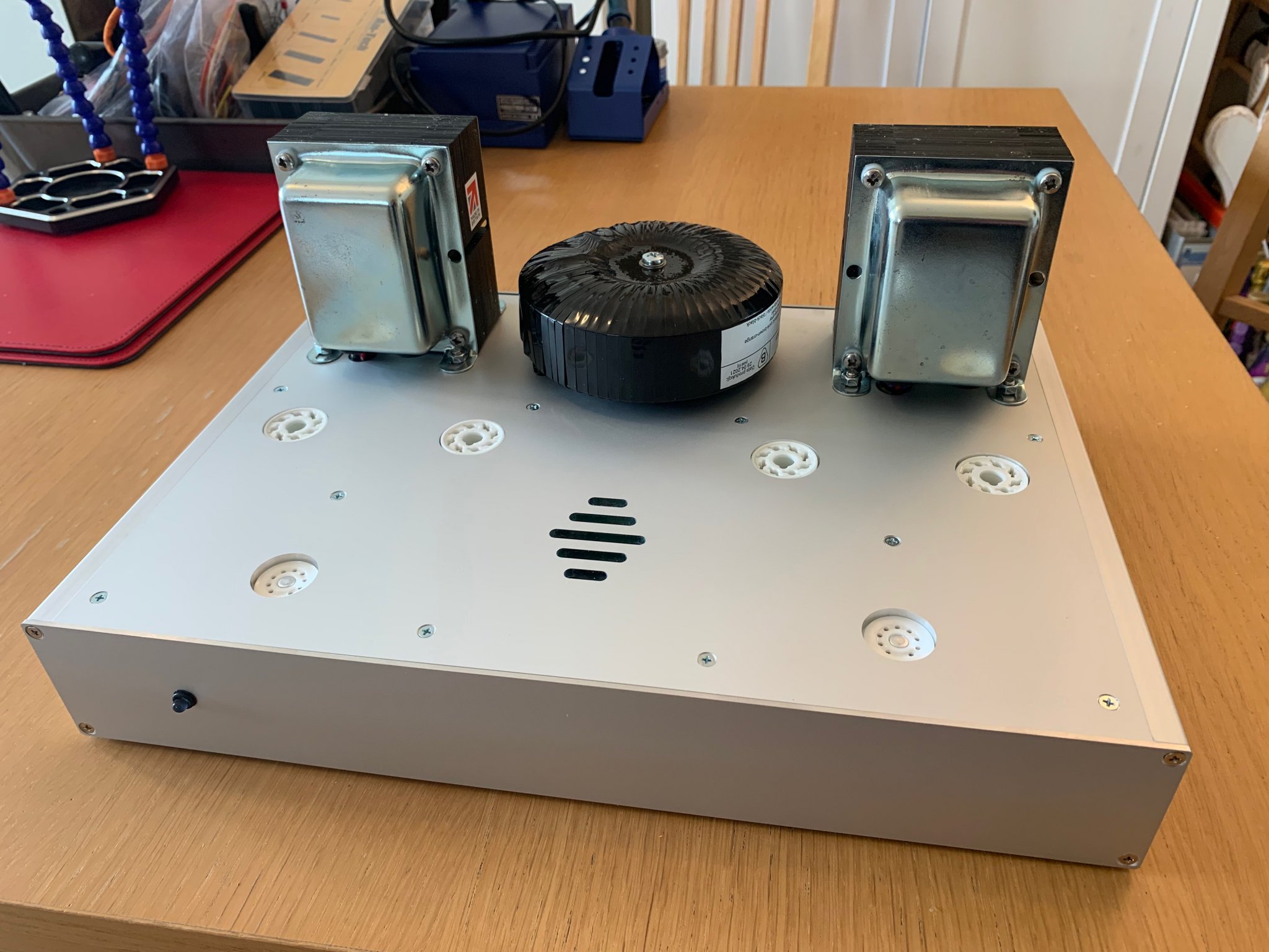

I started off afixing the transformers:
The output transformers fit, but it is very tight getting the bolts through.
Then I got stuck in with the wiring:
If I have an issue with the power supply for heaters and driver I’ll be checking the contact within the terminal connectors: I had to remove the enamel coating from the power transformer wires with sandpaper and a scalpel. Not sure I got 100% of it removed.
Next steps are to put a fuse in the IEC entry, insert the valves and power it up! I’ll take a few days to get there and will do some checks first in case I’ve missed something obvious. And I’d need to think about where to set the bias trim pots to ensure nothing gets too toasty before I have time to adjust.
I’ll do the 1st power up in to dummy loads - and whilst I’m at it I’ll take some voltage readings through the circuit after adjusting for appropriate bias. I’ll also take Bode plots and an FFT / basic distortion reading (using a picoscope) and share them here.

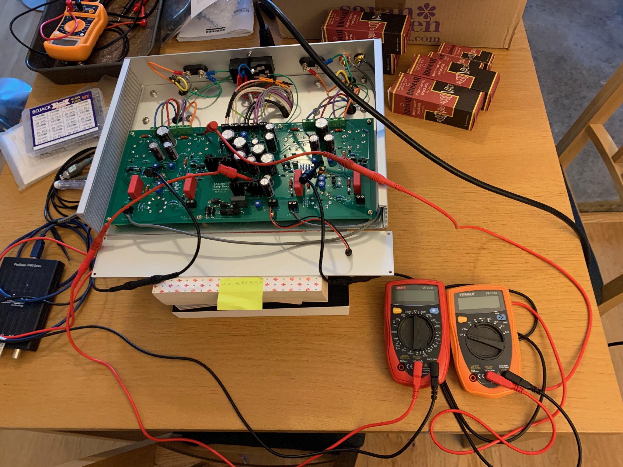

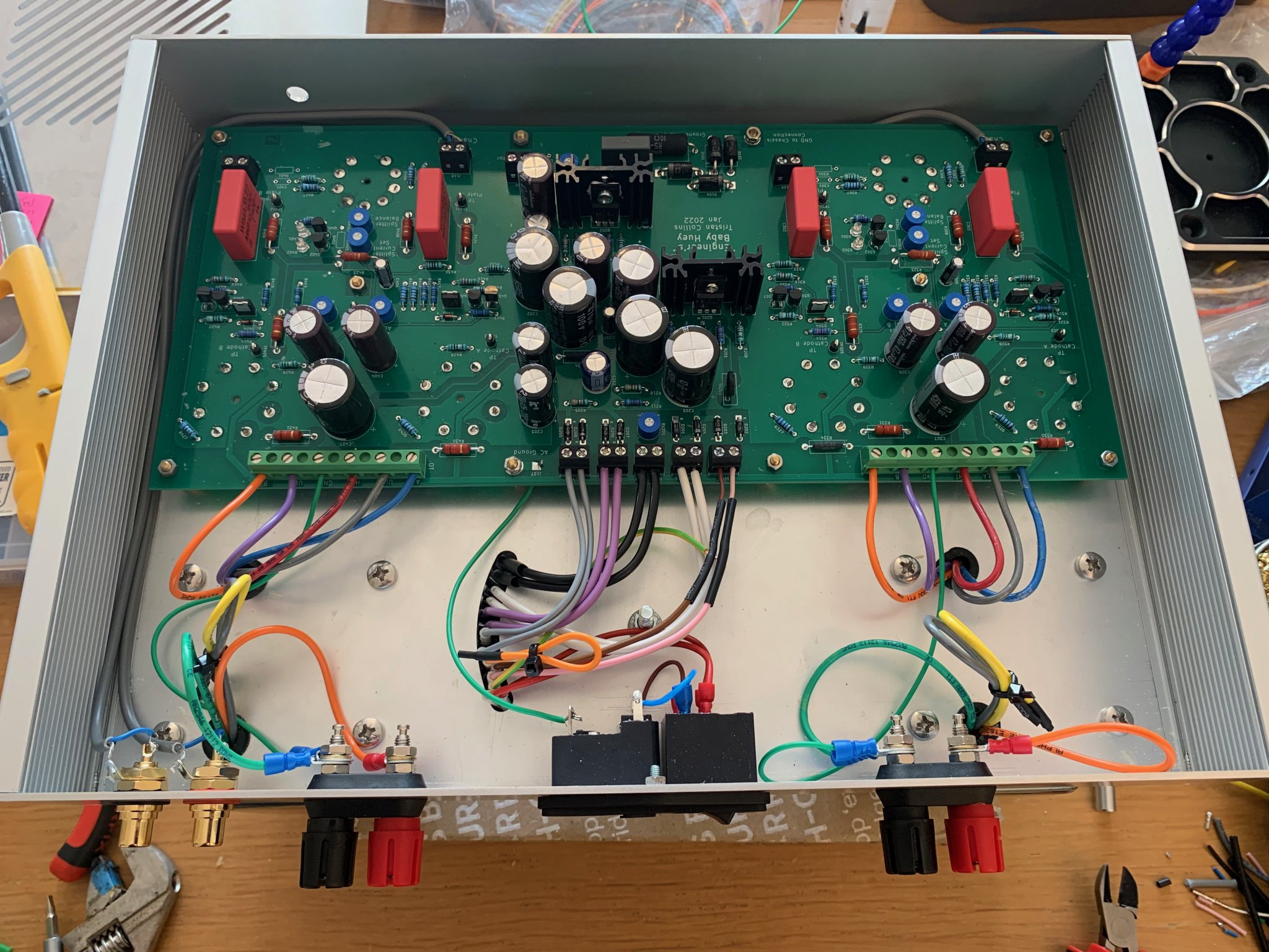

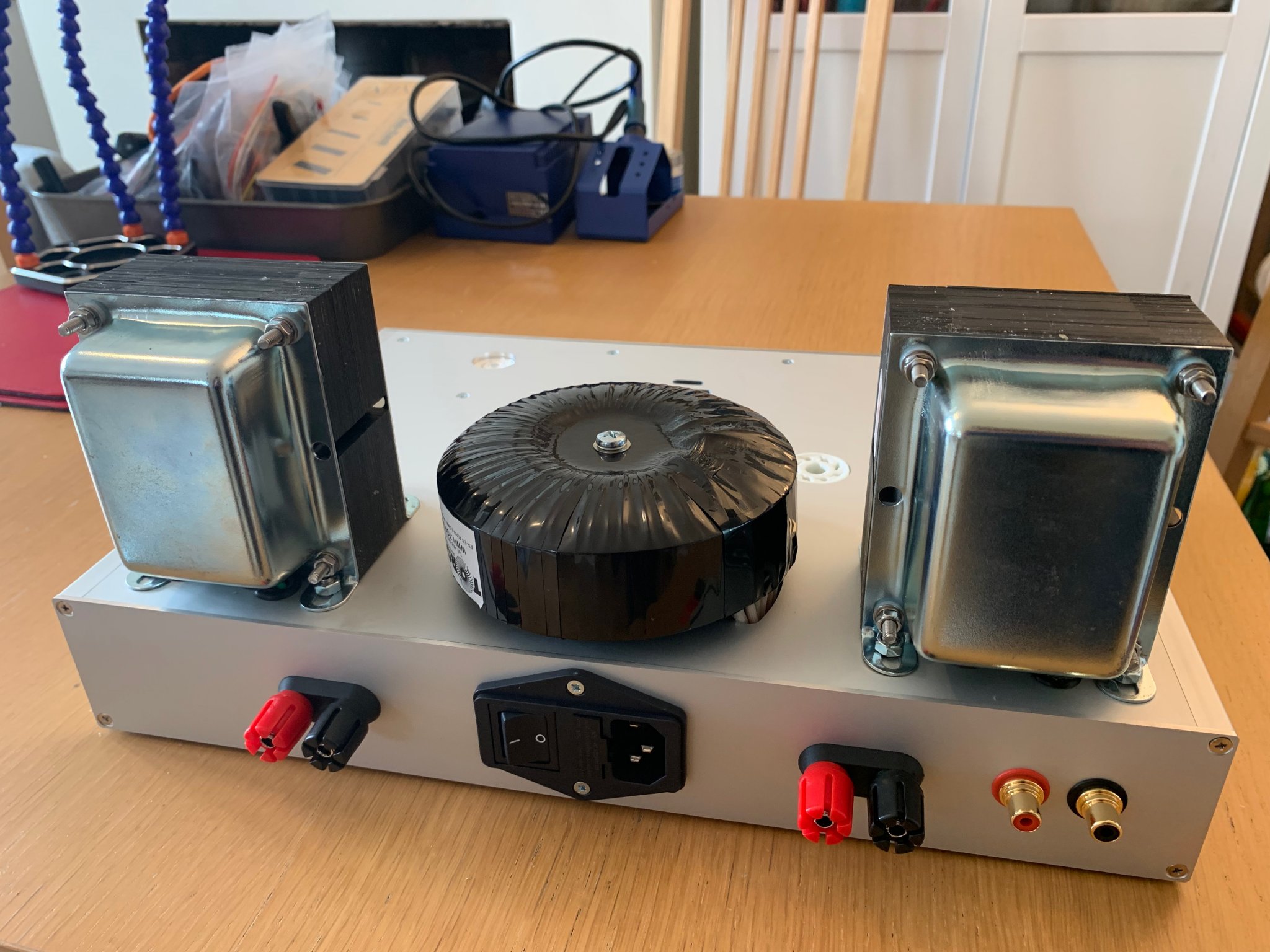

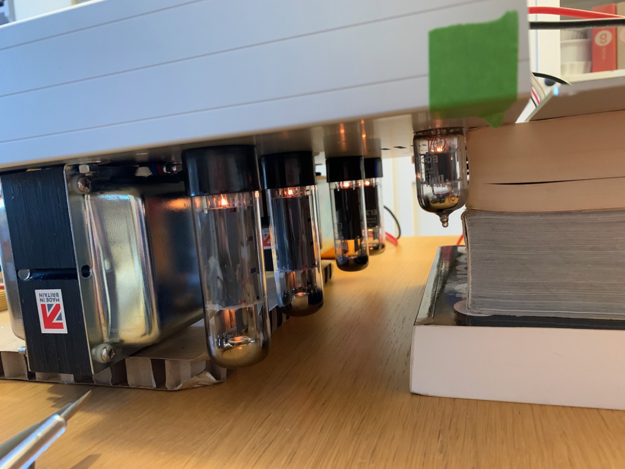

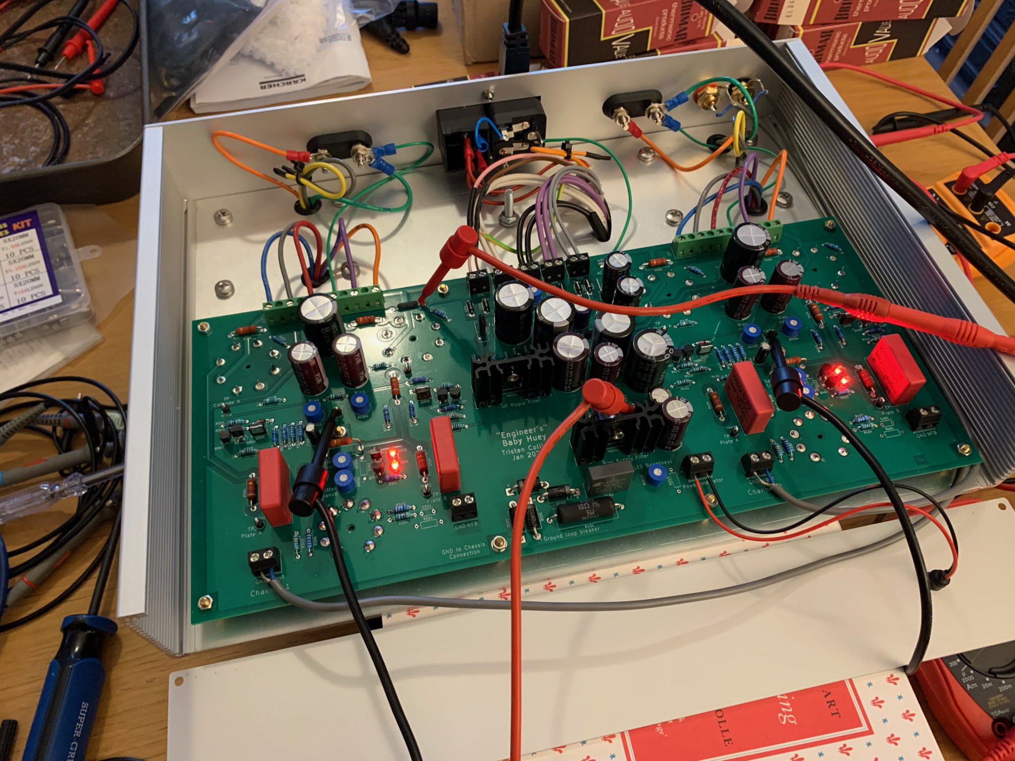

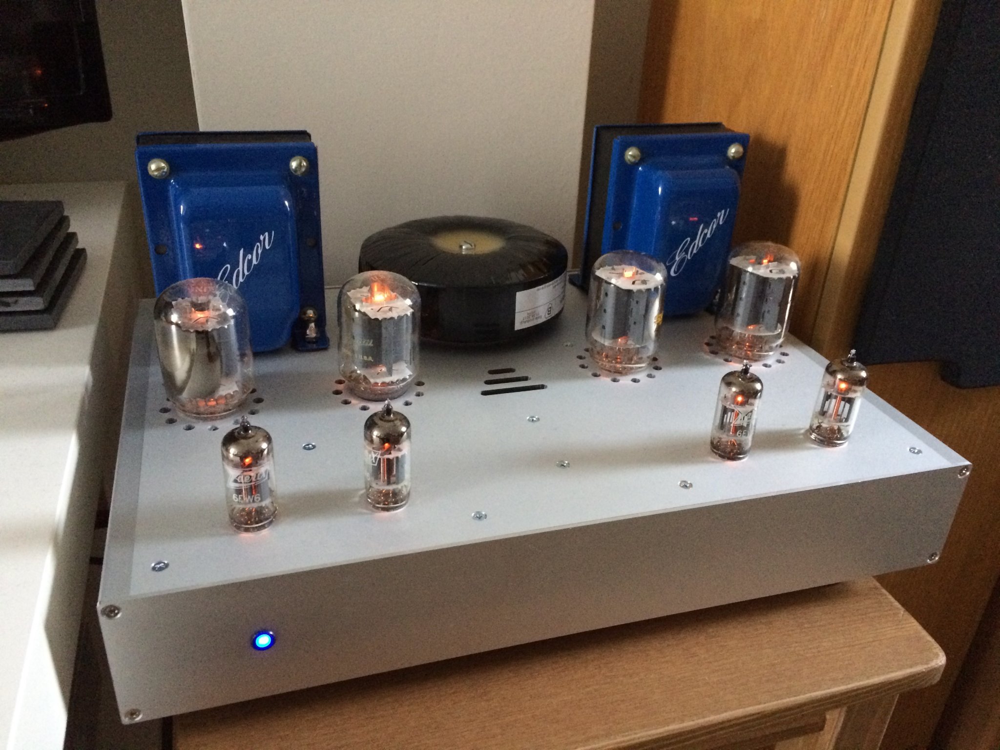

It is! I couldn't hold back. Just quickly this evening I powered it up.
Firstly with no valves installed - everything looked good. So I installed the valves:
And they lit up!
Voltages are higher than thought:
B+ is 400V
Bias is -127V
Driver is 16.5V
The CCS LEDs sure are bright - this pic doesn't do it justice.
I biased the EL34s to 40mA per side after things warmed up - it's a bit fiddly to get the balance so a bit of back and forth was needed between channels to get things balanced right. Then I adjusted the 12AX7 sides to match anode voltage (160V) - which was even more fiddly. There's about 0.9mA per side.

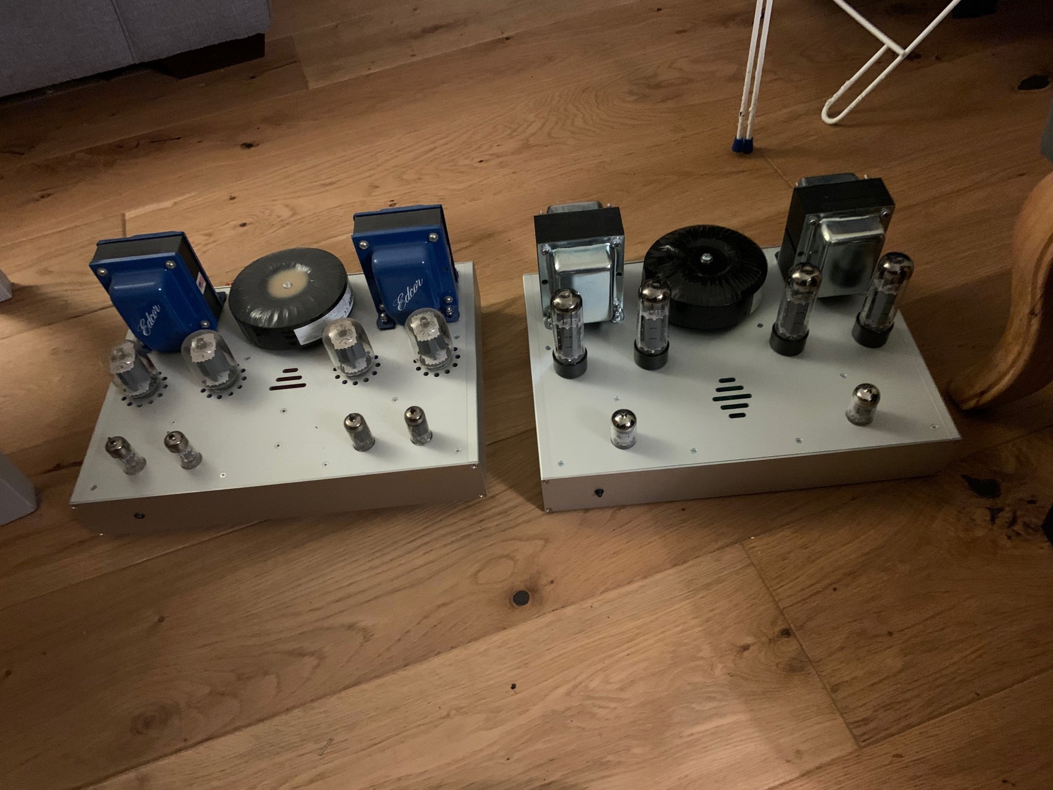

Here it is buttoned up:
And next to the DCPP:
I quickly hooked up the scope. I think there is quite a bit of adjustment to do to get distortion down (as judged from the FFT) and there is ringing on a 1kHz square wave at 1W output. I noticed a bit of a difference in output between channels too. Didn't have time to generate a Bode plot. There also might be a slight hum coming through, but I've yet to adjust the humdinger. So a few things on the to-do list.
I'm sat listening to it now. Immediate impression (compared to the DCPP) was slightly louder bass (I had to check if my preamp was set to have a slight bass boost!) but all good so far. Other than my ears playing tricks on channel imbalance perhaps.
