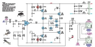

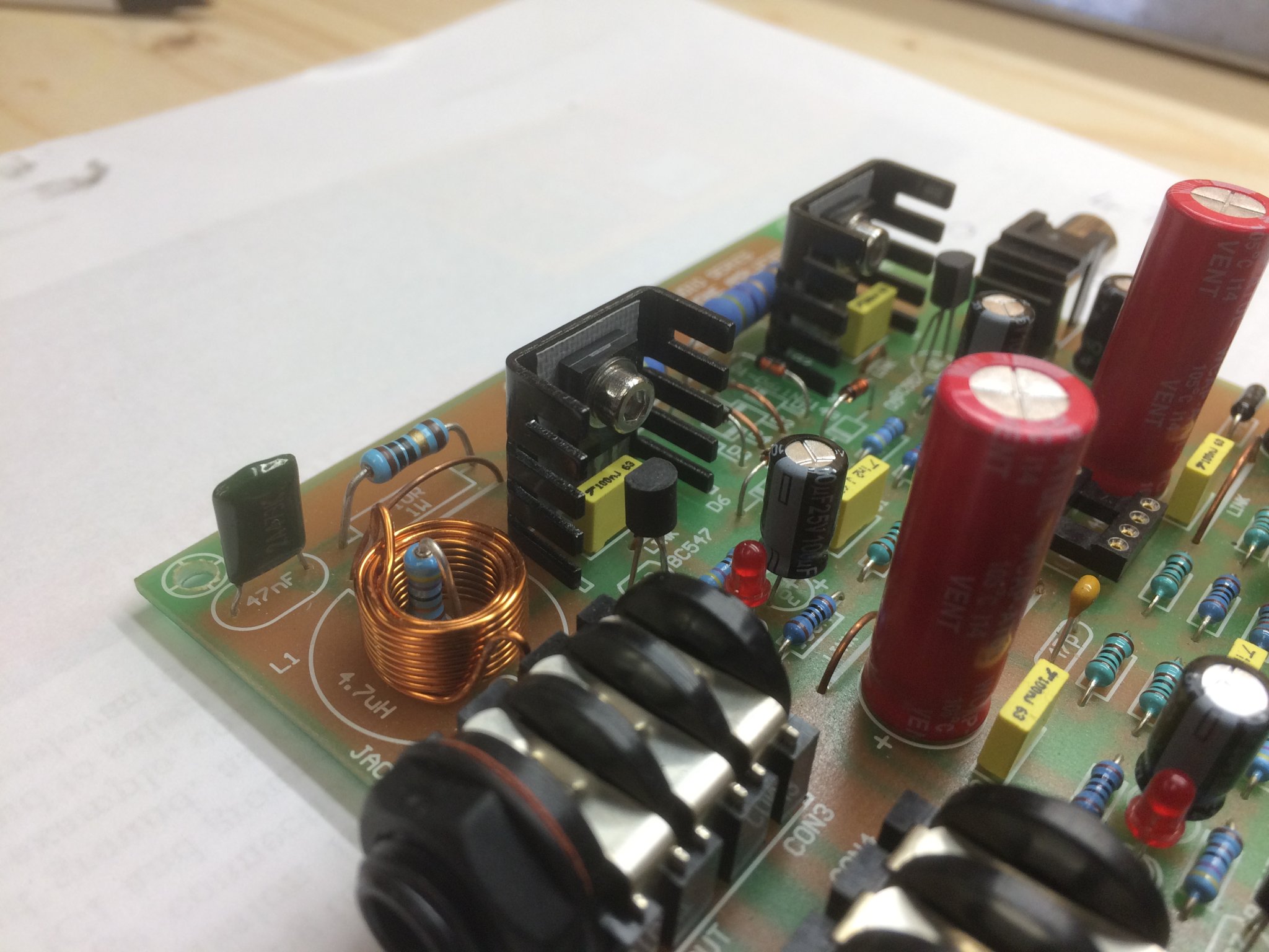

I know there are numerous headphone amplifier designs (very nice ones in the DIY audio store) plus I am a big fan of the JLH single ended Class A design but I have become very fond of this design and the PCB layout (no surface mount and big solder pads for us oldies)
Also to my ears sounds very nice, I have decided to make a test bed for tweaks and document on this wonderful forum
I decided to make my 1st module with good quality budget components with a few notes below

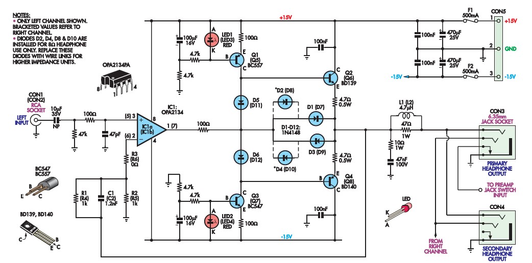

1. The op amp is a OPA2134 ( I have used an OPA2134 audio op amp here for best budget performance) but will try other op amps once completed
2. Matched all the transistors 1st time I have done this
3. Used Jantzen output inductors ( from HiFi collective UK based online company ) 0.005mH Jantzen Air Core Wire Coil AWG20, 0.8mm diameter wire
4. Cardas`s quad eutectic solder in the build
I think this is a very good sounding headphone amplifier sure there are better designs but thought its worth a mention and would be fun to see once built how it compares with other designs

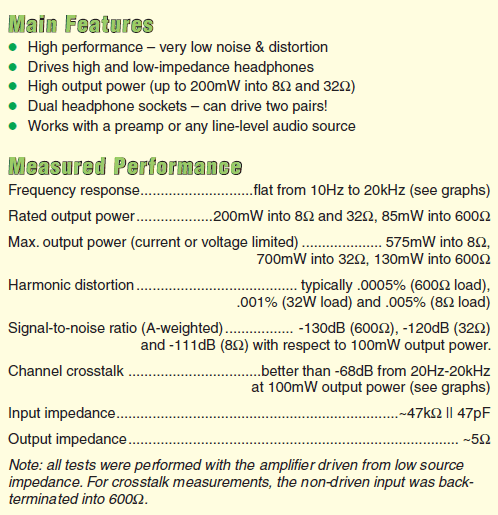

Spec Below

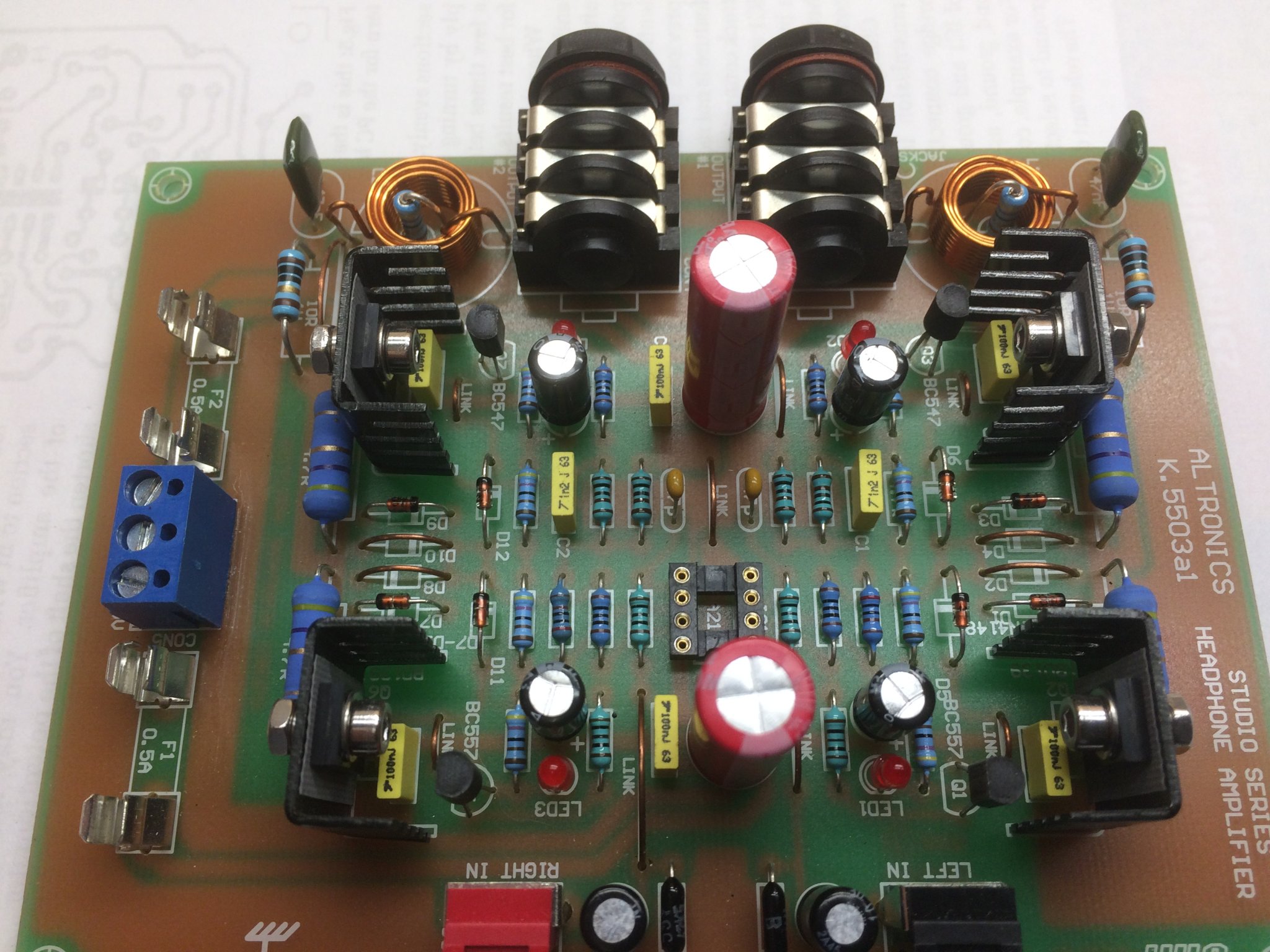

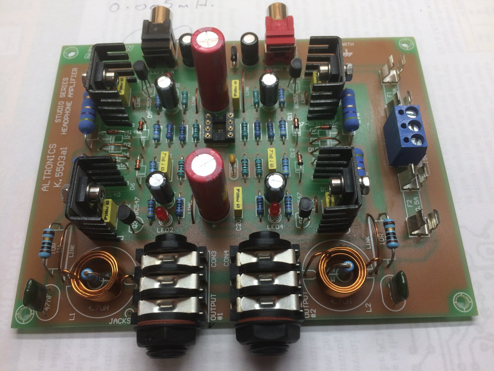

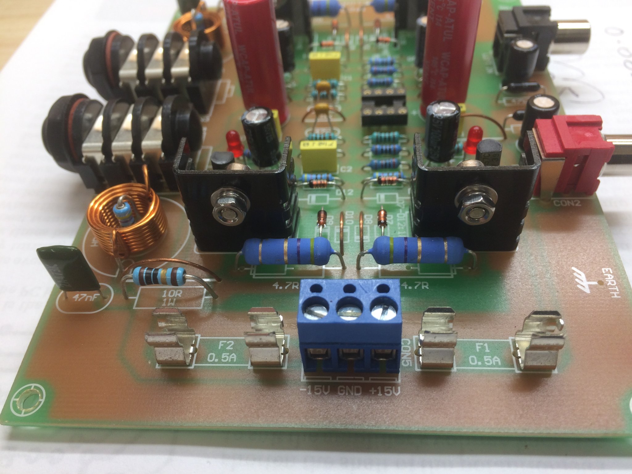

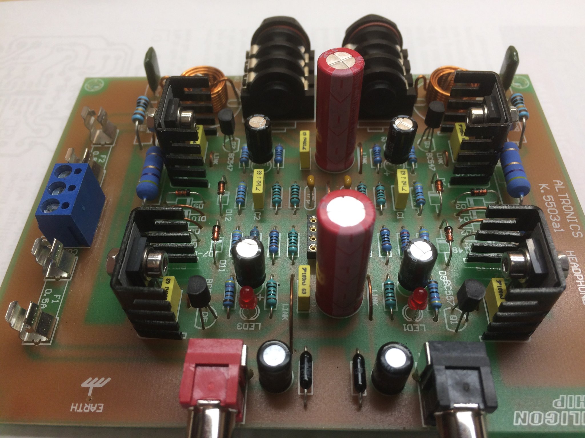

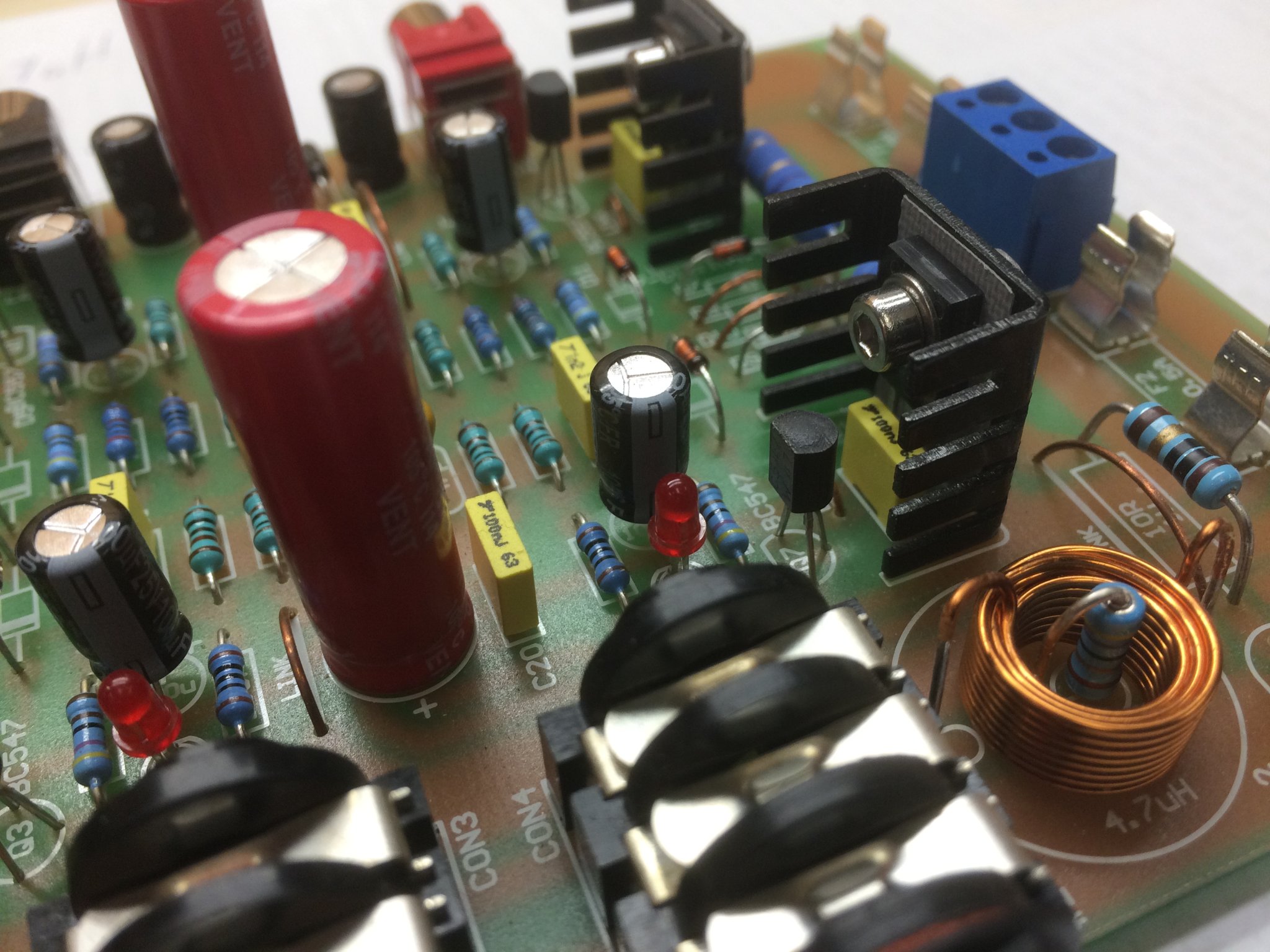

Ok have completed the PCB, Just need to add the op amp / Earth Tag and PSU fuse
few pictures ..

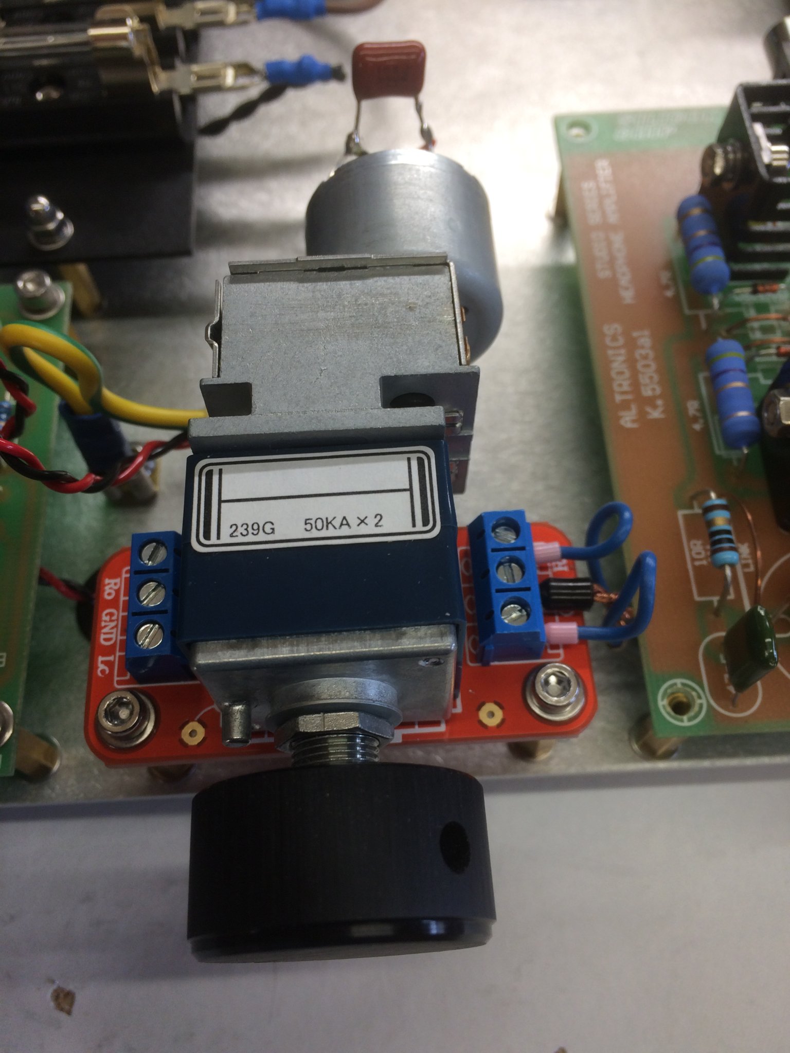

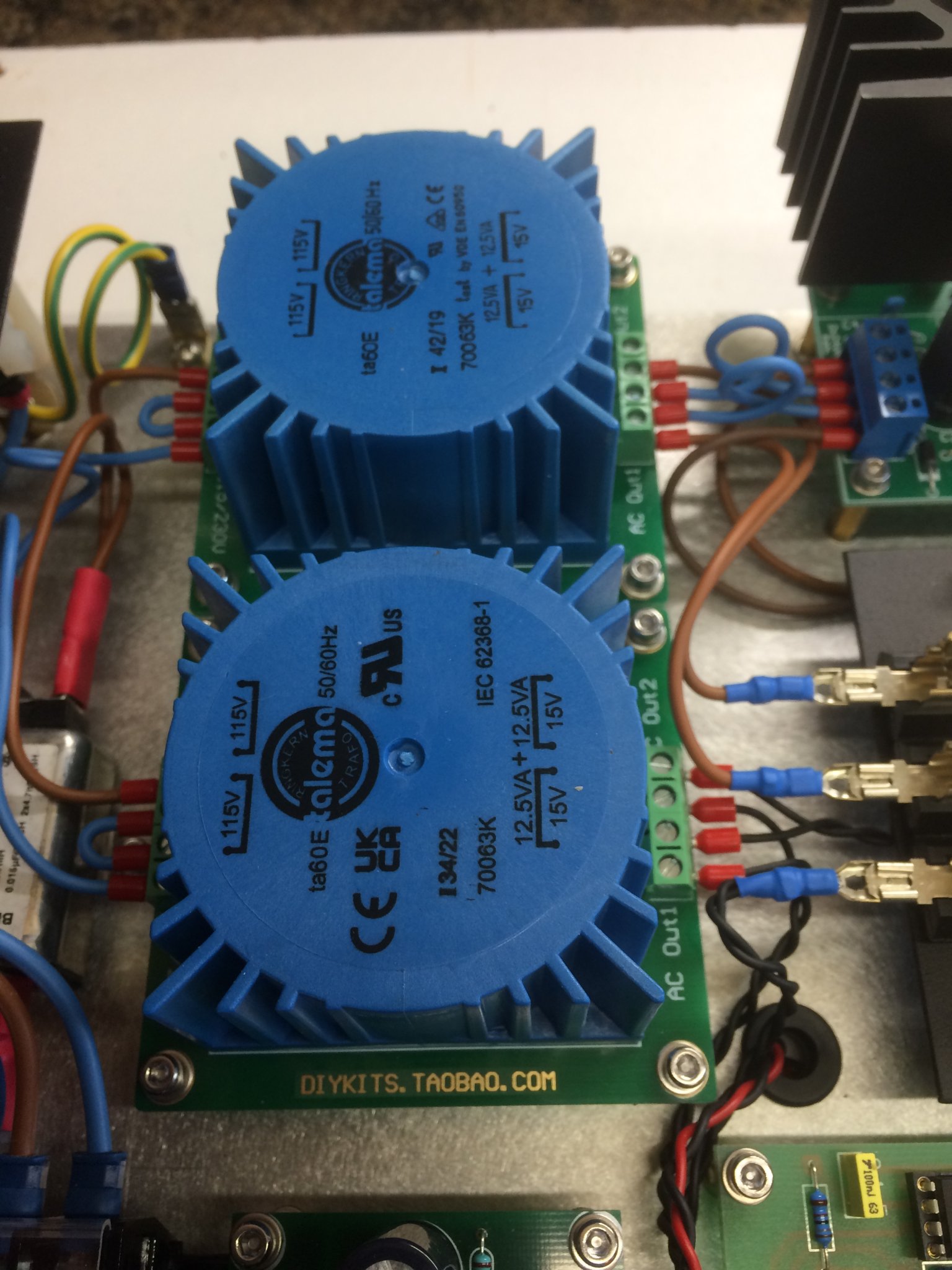

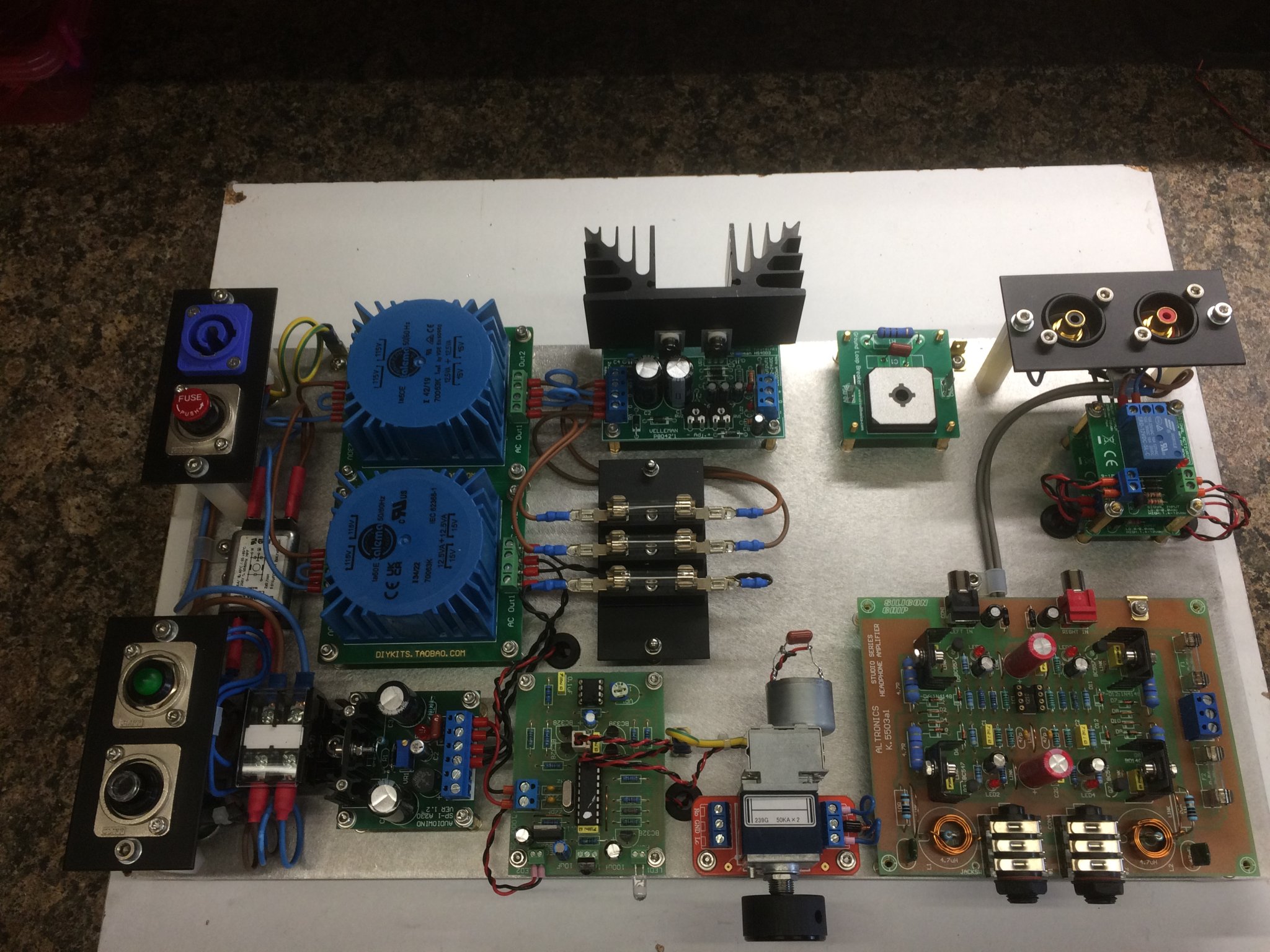

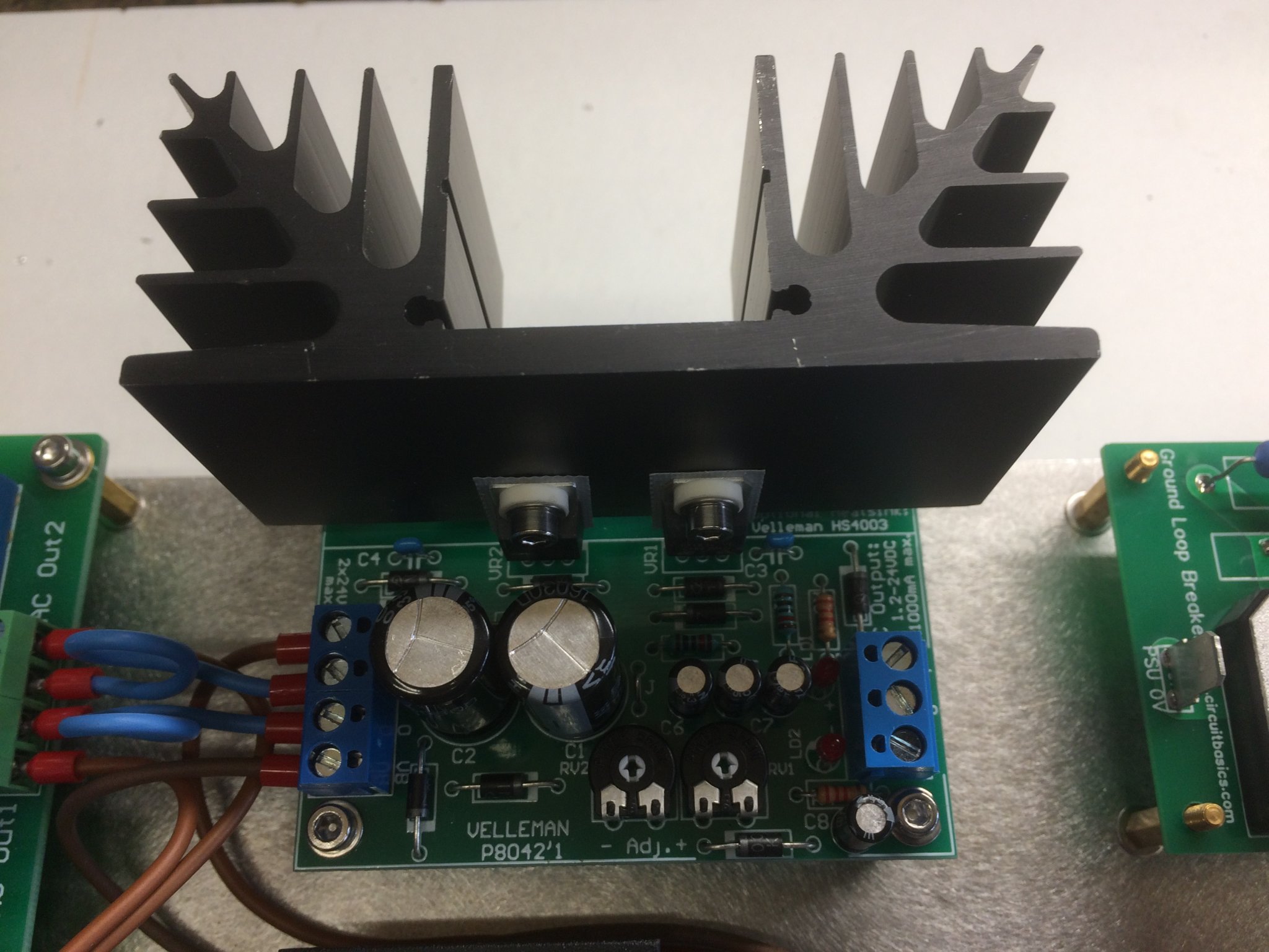

So this is a pic of my test bench (still not 100% finished) this comprises of the following?
1- mains inlet with power switch plus power indicator & fuse
2- 2 power transformers (one dedicated to the headphone amplifier and the other for remote control and muting relays) make Talema
3- remote control PCB

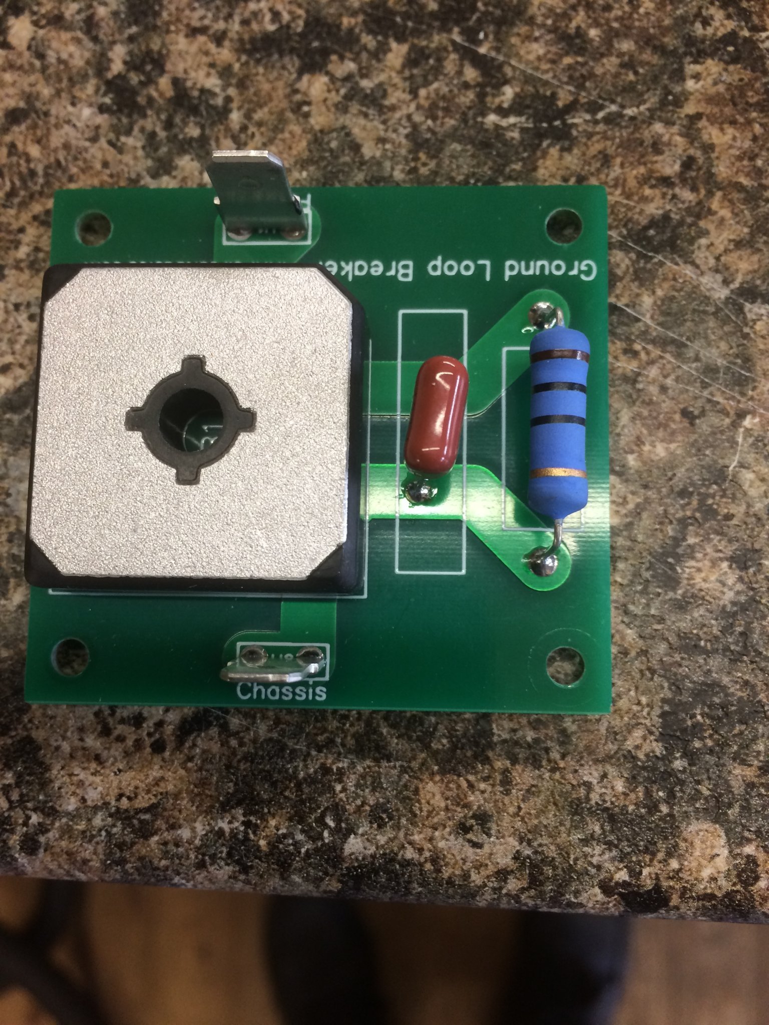

4- ground loop break PCB

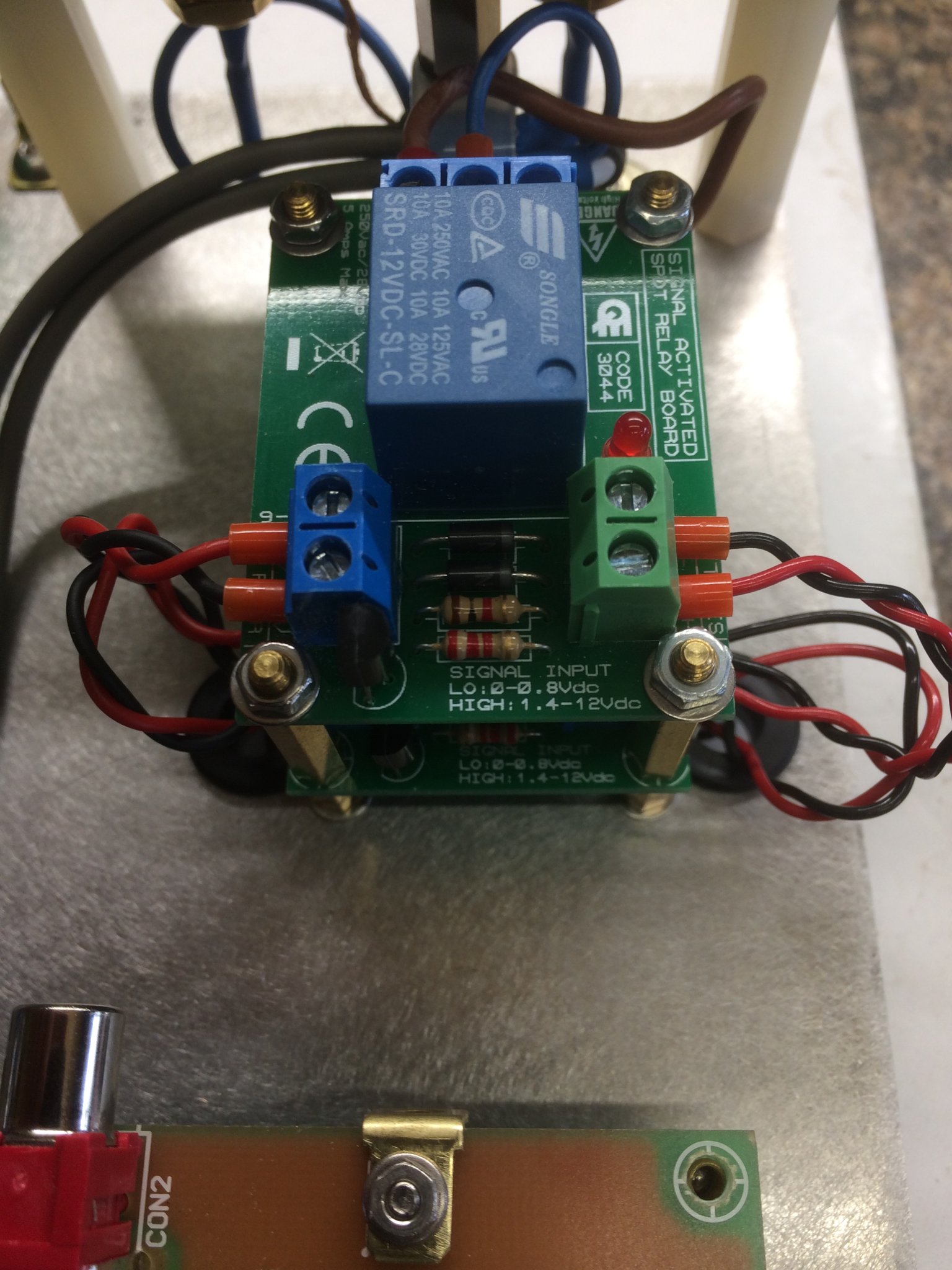

5- Two independent muting relay boards

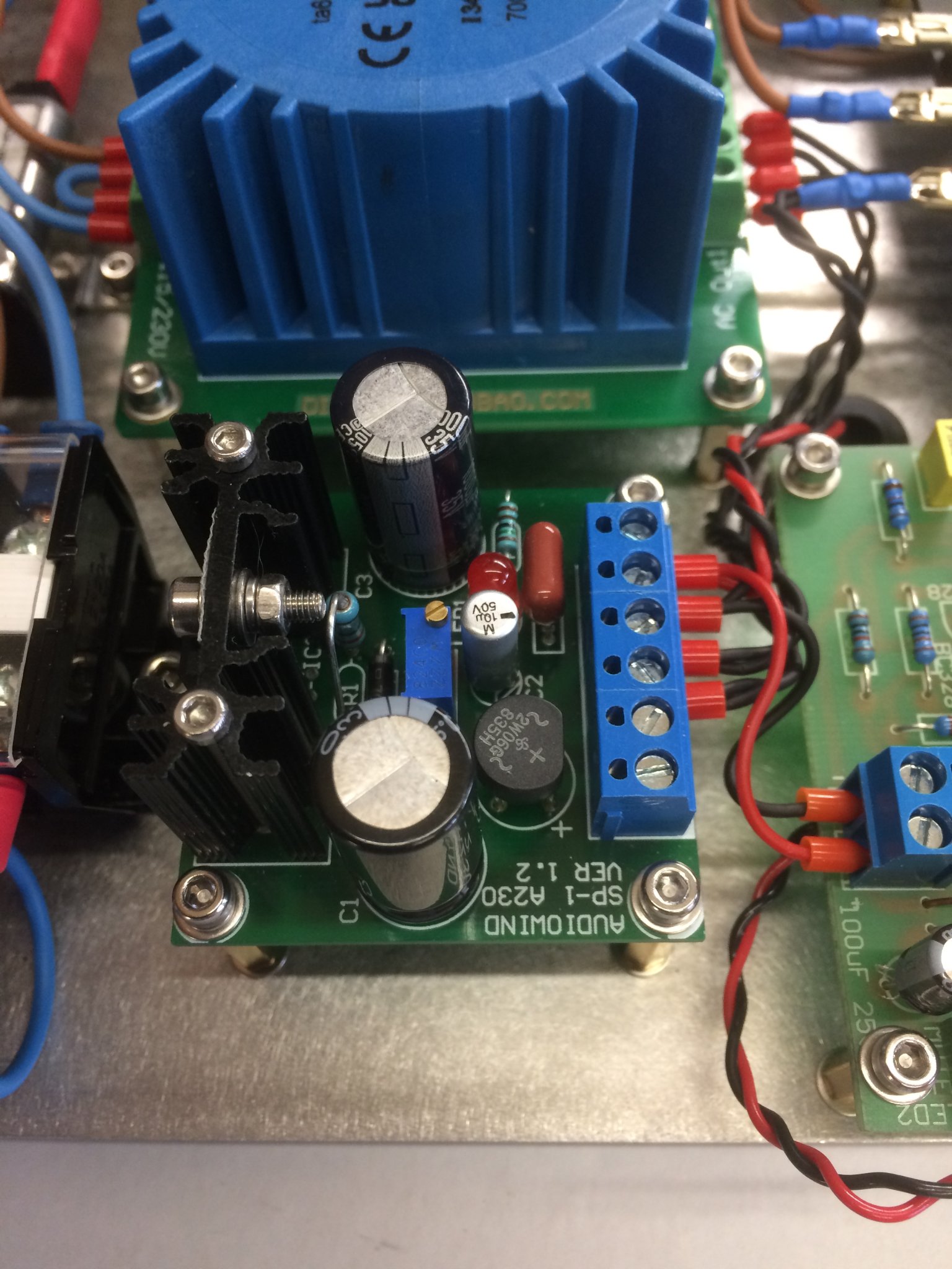

6- Aux control PSU (12v Audiowind SR-1 / A230 ver 1.2 PCB)
7- updated PSU with better components - P8042-1 PSU
8- 50k log volume pot
I currently have 4 head phone amplifiers to compare against each other
1 - This one in this thread (Studio series headphone amplifier)
2 - JLH Class A single ended Headphone amplifier (currently my favourite)
3 - The Whammy (DIY Audio store)
4 - High-Performance Stereo Headphone Amplifier (SC magazine sept 2011 vol24 number 9)

hello Mandu
this design was published in the Australian electronics magazine (Silicon Chip)
Nov 2005 - for some reason years ago I purchased loads of PCB's at a good price and have always been pleased with the sound quality also the op amp can be replaced like the 627 as an example
regards
regards
