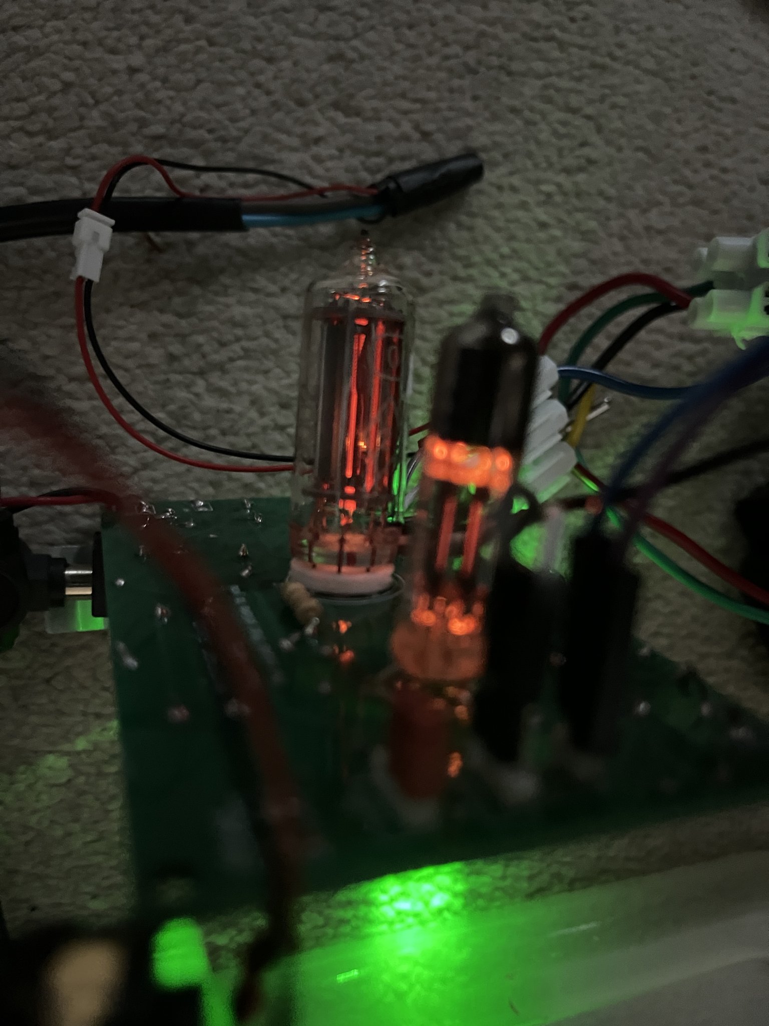

Hi
The amp sounds very loud and muddy. No treble at all, just bass and mids.
The bias control is doing nothing, I go from one end to the other and doesn't change a bit.
I looked at the valves and they seem a bit to red for me. Are they red-plating ? I am afraid that I am pushing them too hard.
Please check the picture attached.
Pedro

It's always hard to troubleshoot from a distance.
First it's wise to measure the DC current goings through the tubes.
Do this with a shorted input.
Second thought would be if the transformer is connected the right way?
If not, it's in feed forward mode, which might also describe the bad sound.
Next I would just disconnect the feedback resistor for now. See if it's still oscillating. Keep in mind that this will make the gain go much higher!
Do you mean, to short both pins of the guitar input, that is, short the input signal to ground?
I think so. Does the order of the pins matter?
When I have the feedback resistor there, it oscillates from a given level of volume upwards.
Without the feedback resistor it oscillates heavily at, let's say, 80% of volume and then from that point upwards the oscillation decreases.!??! :-|
Regarding the pictures, do they look ok or are the valves too red ?
Pedro
@pcardoso73
I mean the input of the guitar amp.
So connector signal input to GND. (or just short RLEAK1)
What do you mean with "order of pins" ?
But to explain in general, transformers can be connected in a different way yes.
One way it will give a non-inverter output, the other way will give an inverter output.
That being said, if you get oscillations without the 22kOhm feedback resistor, something else is going on.
What kind of oscillation frequency are we talking about?
Is it also oscillation without any signal (so signal input connected to GND)?
I think the bias bypass circuit is not implemented correctly btw.
Usually the bypass capacitor is just being switched, to control the amount of gain.
In this case just the bias (load lines) is being changed.
With such a low input signal, I doubt if you would hear much difference.

I've returned to this project and everything is working. Believe it or not, replacing cables, soldering everything into the pcb solved all the oscillation problems.
I had thin cables connected to thicker cables and then connected to something else. Reducing the length of the cables and using solid core AWG24 did the trick.
The volume potentiometer died during the several experiments I did (I don't how I killed it, but I did). I tend to solder and desolder over and over again the same components project after project and maybe because of this the components start failing. So, I've replaced both volume and tone pots by Alpha pots and the amp is now working as it should. The feel of the pots is so much better. No noise, vibration or any other problem that I had with the others.
The only thing I would like to tackle is to get rid of much of the bass. The amp is really bassy. I am feeling tempted to experiment a bit and put a very small cap across the feedback resistor and the degeneration resistor of the first stage. Let's say 470pF (just because I have those).
I had an idea (stupid maybe): what if I put a potentiometer connected as variable resistor, between the first stage (after the output cap) and the grid of the second and across it a 470pF capacitor. Wouldn't this help me reducing the bass? I have a 500kΩ pot around, so it should be enough for this...
Bottom line the amp works flawlessly, doesn't oscillate (even a max volume) and when cranked I get sweet distortion. It's loud for it's size (around 2W into a 12''Eminence speaker driver). On the negative side, it is too bassy.
