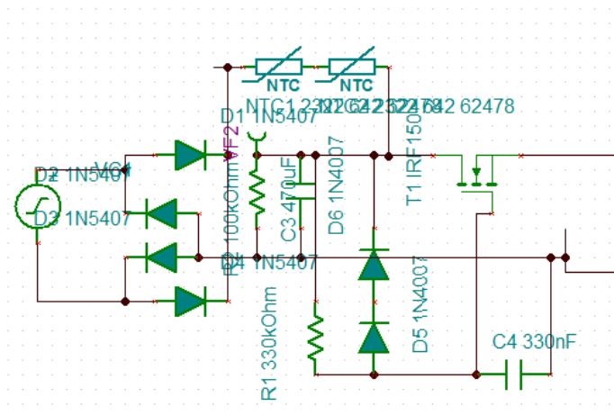

I used the 36v 7A from the same manufacture,$8 no any audible noise. These new generation of smps run at 500khz and the output has LCL filter. Just 15cm wire and 2200uF at arrival destroys all HF components.
What you don't see is the 100hz component which exhibits at power. This is best eliminated by driving the smps with DC and ripple eliminated by a mosfet. I have a working circuit if you want. On Ali you find various AC treatment modules. This how you put your money where is needed.

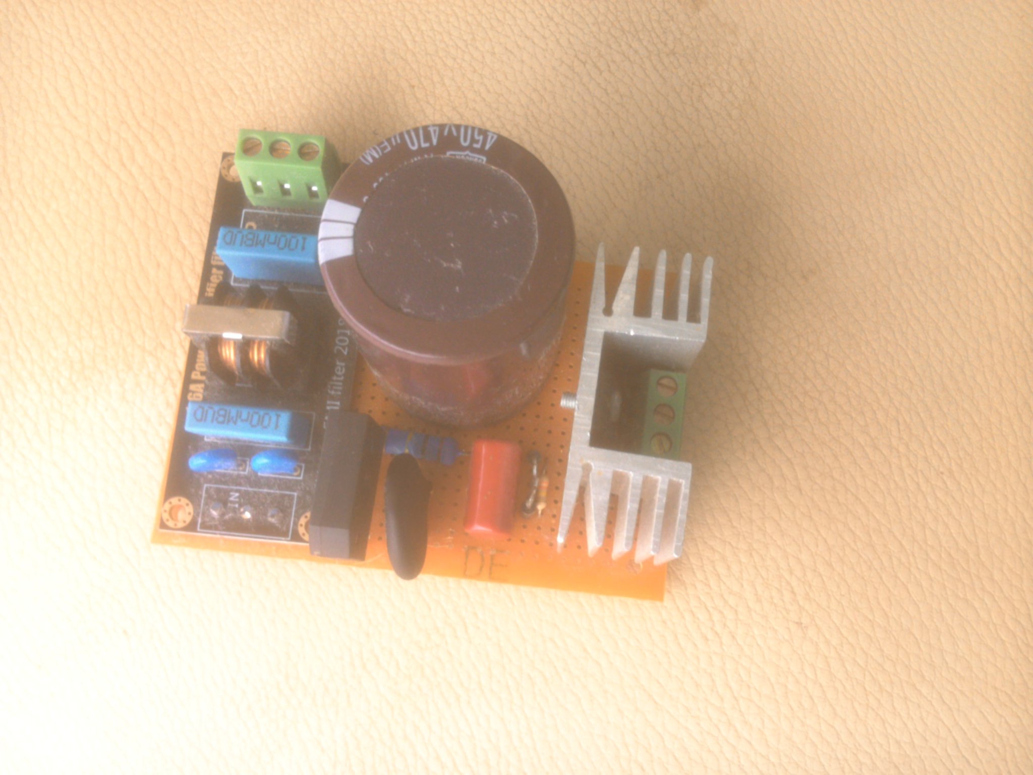

This is my 150w ripple rejector. I use it for an amp under development which has only 40db PSRR.
The mosfet can be any >600v >2A isolated.
