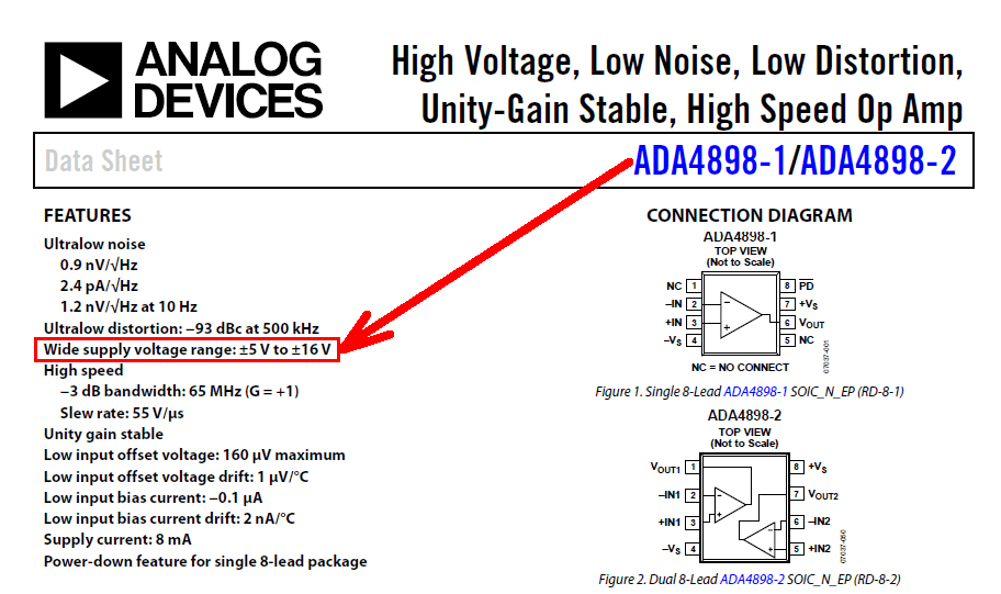

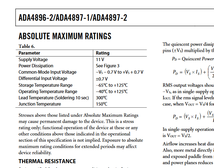

So far I still do not have figured out this ADA4897 issue. With OPA1641 I have output 17 volts (I can change output value) and when I but ADA4897 then output is 6.5 volts. I am using variable resistor for R6. Changing resistor R6 value it does not change voltage. Any thoughts about this?
ADA4897 has 11V max supply voltage, that's why it doesn't work properly.
ADA4897 is a great choice for 5V output reg.

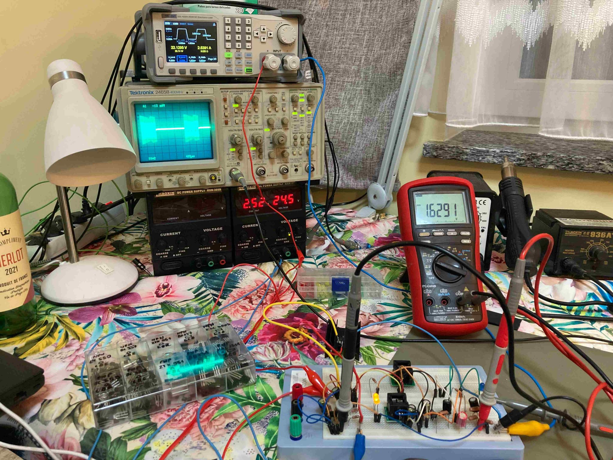

i must report, that op-amp ADA 4898-1 gave me excellent results with standard schematic from Jan. I found this op amp on other forum, where somebody described them as "AD797 done right". Noise figures on datasheet are as good as AD797, but gain curve shows even higher OLG at higher frequencies than OPA1611 or AD797. Internal compensation cares for phase margin, and my prototype board REFUSED to oscillate with pulling every capacitor out, till i took out the last cap across 4 and 7 of the op amp itself. Then i saw on the scope a short burst of violent oscillation, and shortly after ADA4898-1 in soic to dip adapter exploded melting the adapter. 🙃

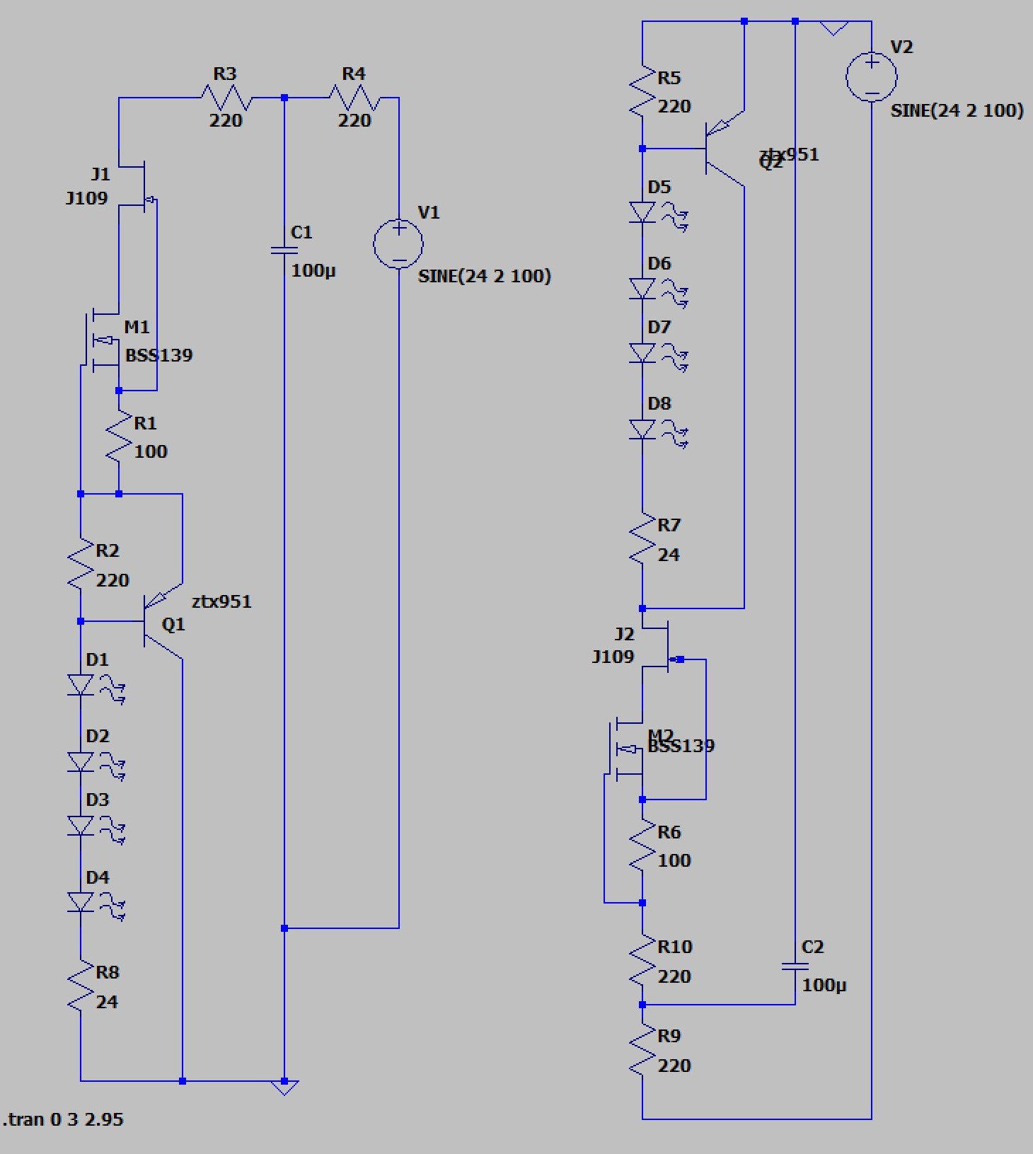

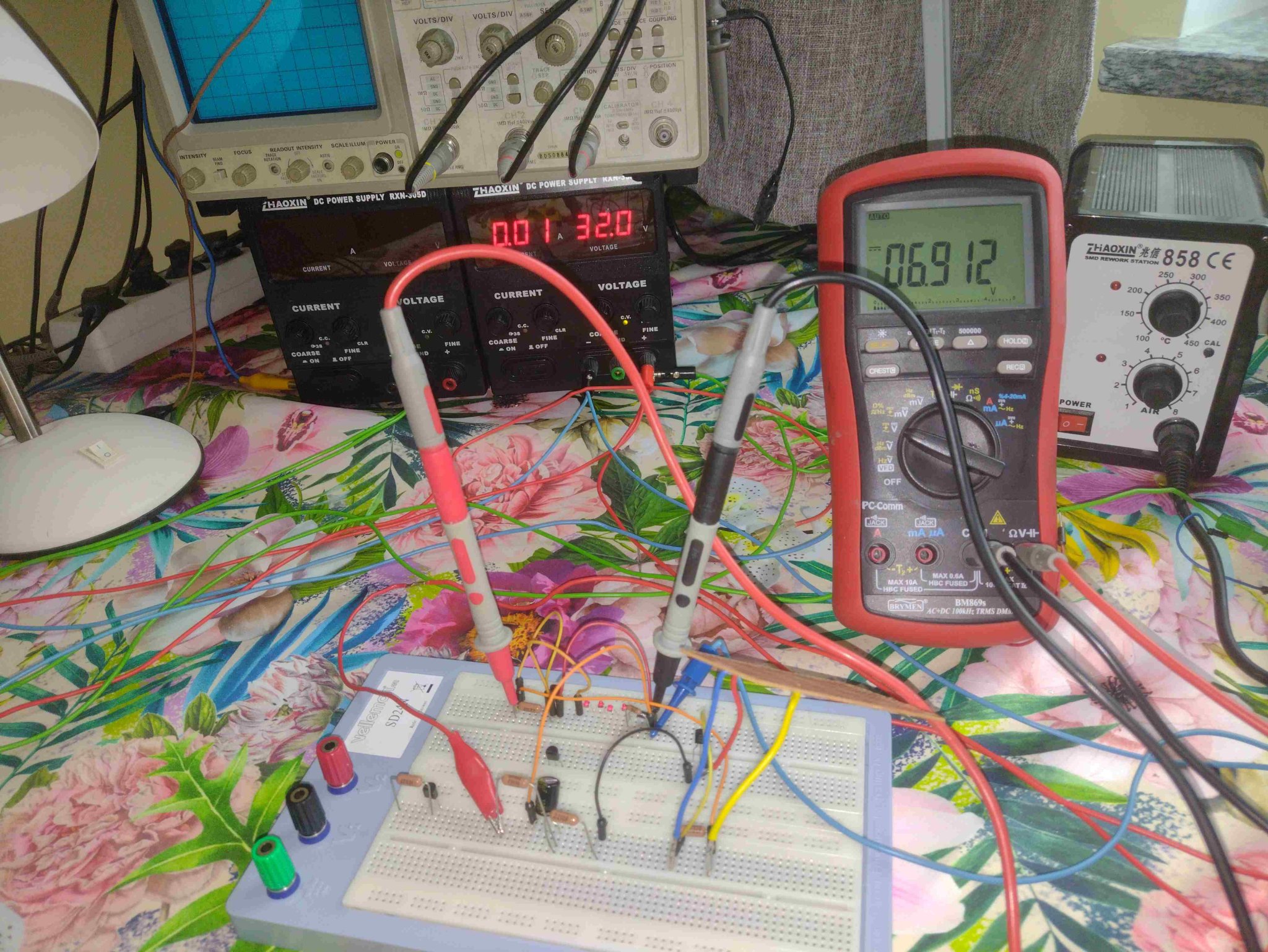

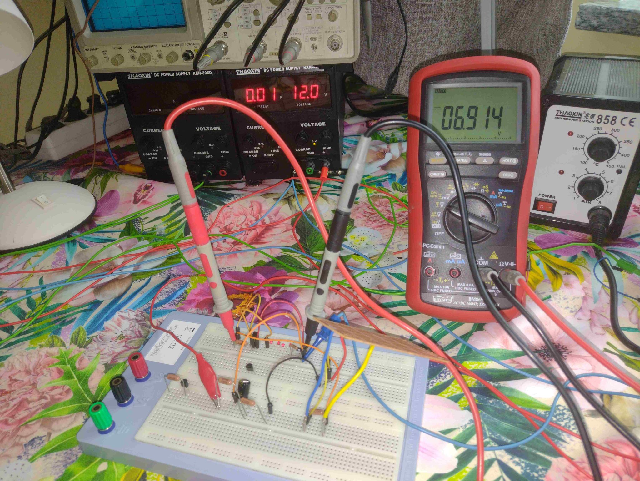

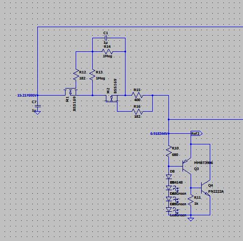

As for GLED431, in my case a series of four HLMP 6000 with 24 Ohm trimmer resistor plus ZTX951 with 220 Ohm E to B, show me 6,912V on my Brymen 869s. 20 Ohm resistor would be closer to the lm329. I measure around 2,6 mA in the LED branch, and 5,1mA in the ZTX951 branch from BSS139 biased with 100 Ohm (7,76mA CCS, 100R is convenient point for measurements as well). Vref stays very stable with Vin from 12 to 32V, more harm causes just waving my hand over board than changing Vin by 20volts. Rising the temperature with hot gun lowers Vout, which gives a weak temperature negative feedback effect for my class A amplifier.
What a surprise. Nobody here did not mentioned that max op amp voltage for this ADA 4898-1 is 11 volts. My input voltage is higher than that. Does that mean that I have to say goodbye to this ADA 4898-1 and to buy new after I have tested it with a higher voltage like 20 volts? :oops:
Ada 4897 and ada4898 are two different parts, and i found it a good practice to simulate first in ltspice every new idea, check the nodes for voltages and elements for power dissipation, checking simulated values against max values in datasheet, then building on prototype board, measuring and comparing prototype to simulation, and only then ordering new PCBs. It's is advisible to stay in a healthy distance from max declared values. And pay attention to every little count in part number, as sometimes it becomes something entirely different and stops your PCB from working entirely, even though 4897 and 4898 may seem similar numbers. I aim for 22vout and 4897 will be destroyed here. For lower vout 4897 may be better.
addendum to GLED431 from post 3426.
Bypassing the j109 and letting bss139 run on it's own, makes no difference to the Vref stability, i.e. it changes 2mV / 20V. Nmos sees higher VDS change, but is in higher more stable VDS region from the start, so net effect is the same, with one part for cascode spared. CCS stability without cascode is worse by 0,2mA / 20Vin, and it can be pure thermal effect of higher power dissipation bss139, but it doesn't seem to bother the GLED431. I don't expect any AC voltage from super regulator output, and 2x220R+100uF on the Vref input is paranoidal enough.
Changing the 24Ohm R that i had at hand to 20 Ohm, made Vref 6.905, comparing to lm329 sample 6.901, which allows me to make direct swap comparisons after Christmas, without worrying that a miniscule change of rail voltage would turn my sound impressions upside down.

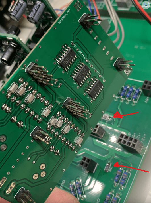

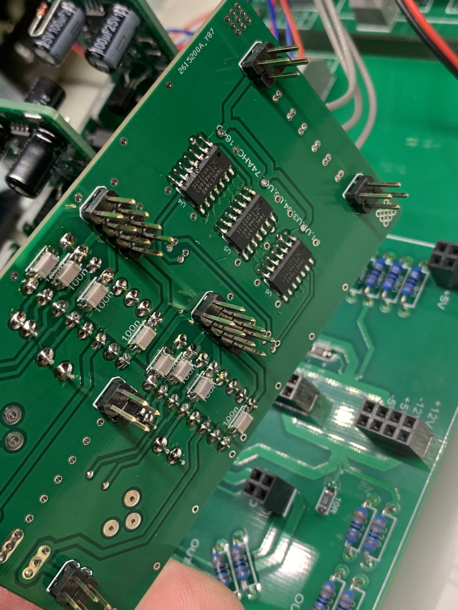

Small question before cutting traces on my pcb.

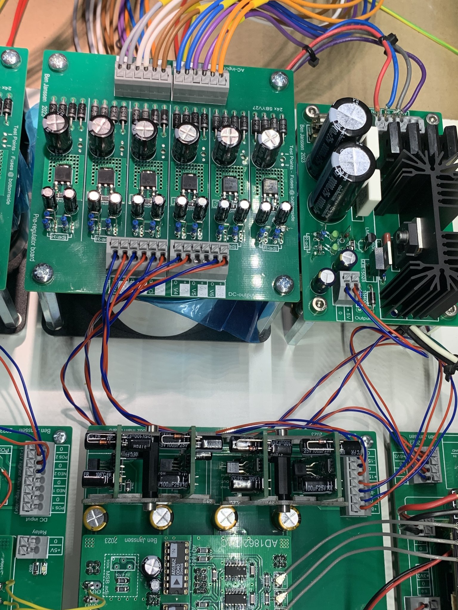

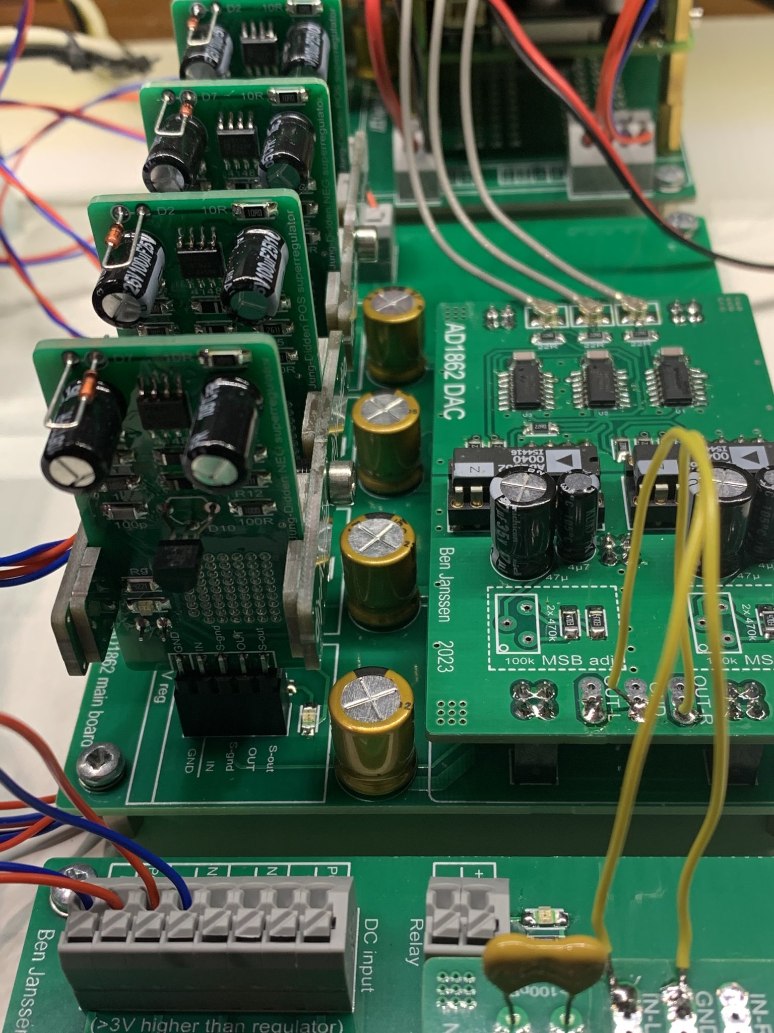

I’m feeding my ad1862 DAC (all 4 voltages) with Jung-Didden supperregulators. Worst case oscillation I measured, on one voltage was 40mvPP @ 1.x MHz. I’m using the sense option including the 10R + 10n trick.
question: does is make sense to add an inductor in the output trace of the regulator BUT before the sense connection, this to compensate for the dcr losses in the inductor?
Dag Jan,
Ok, thanks for the feedback.
My situation:
1. LM317 preregulator with output 18V for the 12V JD regulator.
2. +- 10cm of wiring to PCB on which Jung-Didden superreg's are placed on using pin connectors.
3. Superreg's output voltages: +5V -5V, +12V, -12V. AD825 opamp for 12V and AD817 for 5V, output cap = tantal (Mouser 80-T491A475K025AT) followed by a Nichicon FG 35V 100µF. Both not low ESR in my understanding.
4. AD1862 pcb stacked on the above mentioned PCB. 100nf COG's decoupling direct on DAC pins.
Other info.
The same Jung-Didden reg's are used on the IV-stage. Probing here shows a flat line on the scope. (visual no difference when probing the ground).
Oscillation on the +12V and -12V is a factor of 2 higher in amplitude than the +5 and -5V. -12V = 100mVpp @1.04MHz (rechecked today.
Regards

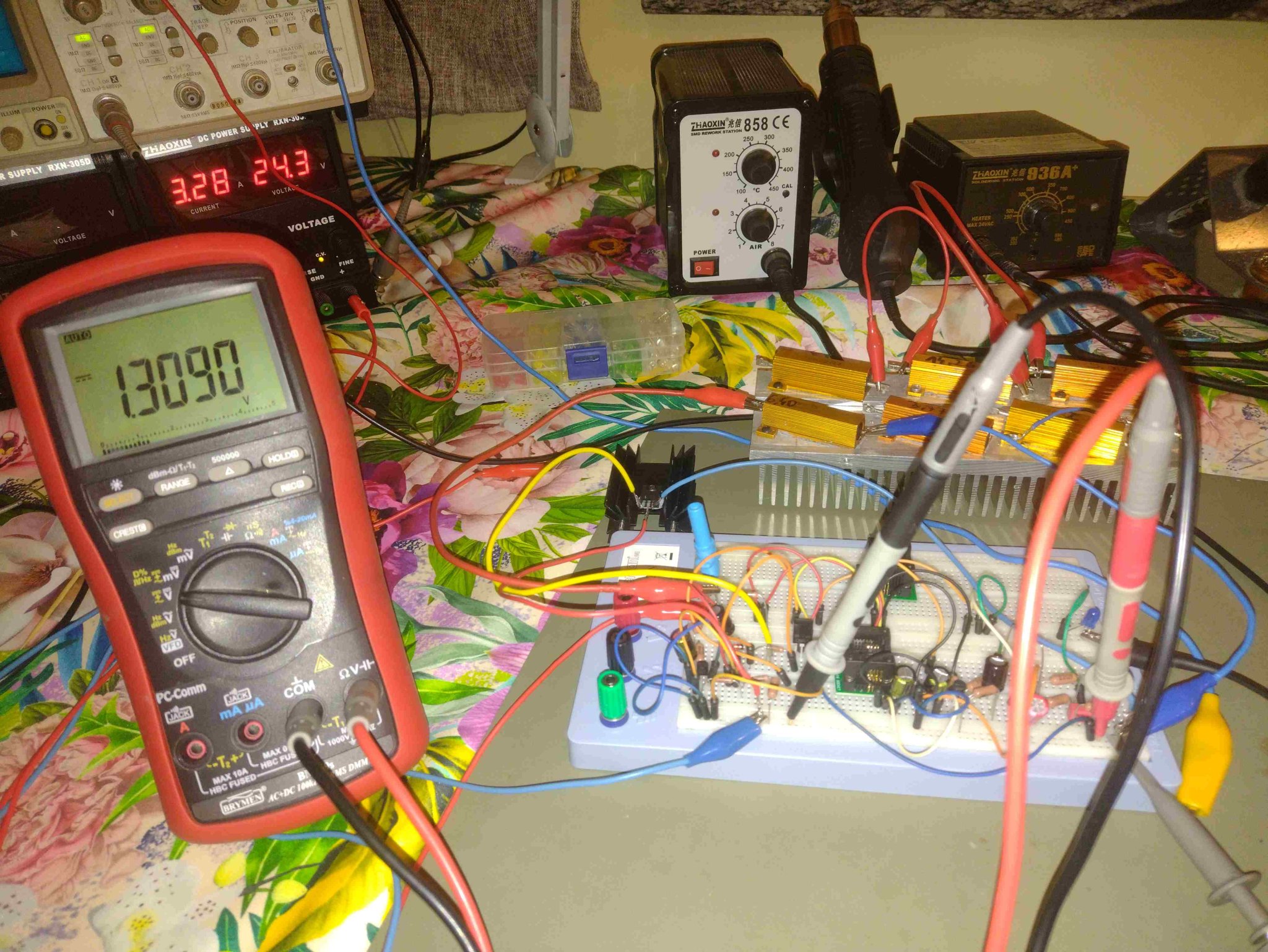

when i played with diffrent LED colors on input CCS, I noticed it had affected the minimal voltage offset.
I decided to use ANF CCS type with dual BC337-40 from Onsemi on the input in hope to minimize the offset for high current class A.
Active load gives me some messy measurements, i had to switch to non inductive power resistors.
With dual BC337 I can go down to 1,31V minimum voltage offset under heavy load, i.e. i can go from 0 to 3.3A with no detectable change of output voltage.
With 20 Ohm CCS programming resistor i see 30mA input current, which with the 2SA2222SG allows for max 4.9A regulation. Max Dissipation 4.9x1.31 = 6,42 Watts, the TO220F package on small Avid heat sink reaches 60 Celsius at the screw, well below max allowable ratings for this relatively small pass transistor.

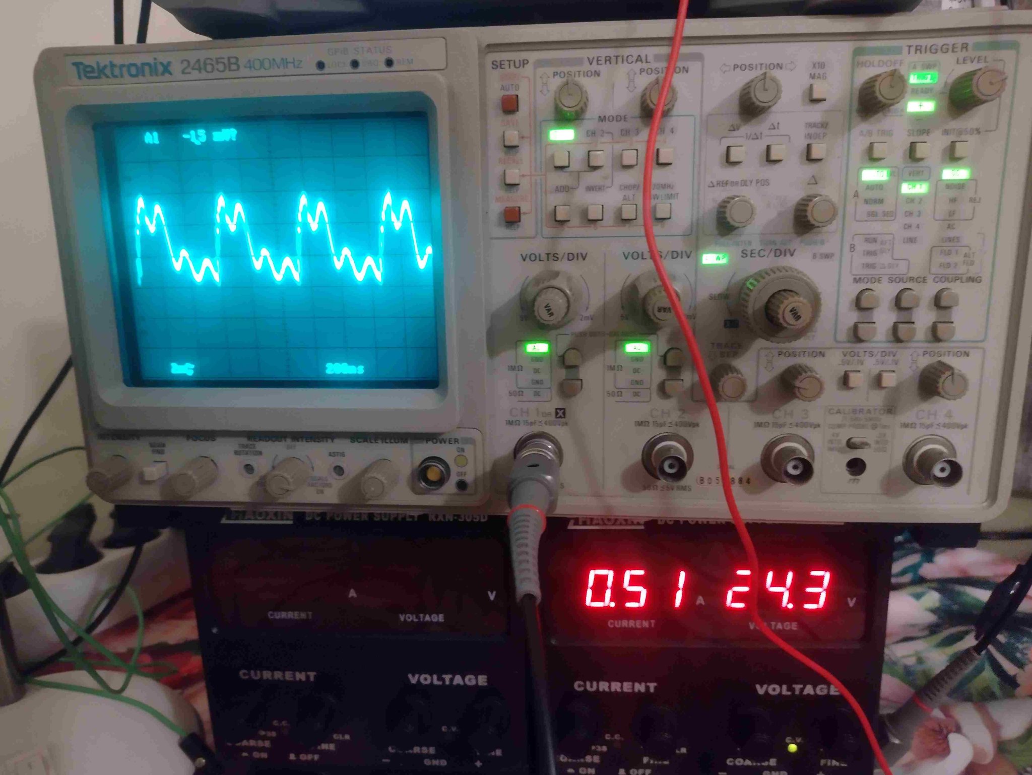

The only thing that worries me is that i see some very small "oscillations" all the time, like 6mV pp of some irregular shape, i don`t know if it is even an oscillation, or i just pick up some wifi with this cable salad.
One more important thing i noticed is, that counterintuitively, low ESR at the input of superregulator makes response to square wave load worse and oscillatory, but again it can be the fault of Zhaoxin PSU and long cables. I`ll try tomorrow with an SMPS from MeanWell that will be used in the endproject, as it showed a better transient regulation than all other sources, and then again how it all fares with CLC filter in between.

That's hard one. So many variables with multiple units interconnected.
How/where did you connect the sense connections?
Jan
The sense connections are made on the bottom board, on which the DAC is stacked. 10R sense resistor is connected to point where PSU trace is splitted towards Left and Right DAC.
2sense resitors are on the top side, the other 2 are located on the bottom side of this PCB.
This morning I bypasses both the 10R sense resistors and the 10n cap ==> oscillation amplitude decreased slightly (-30%) on +12V, -5V and +5V. ON -12V the 100mVpp remained at about 1MHz.
