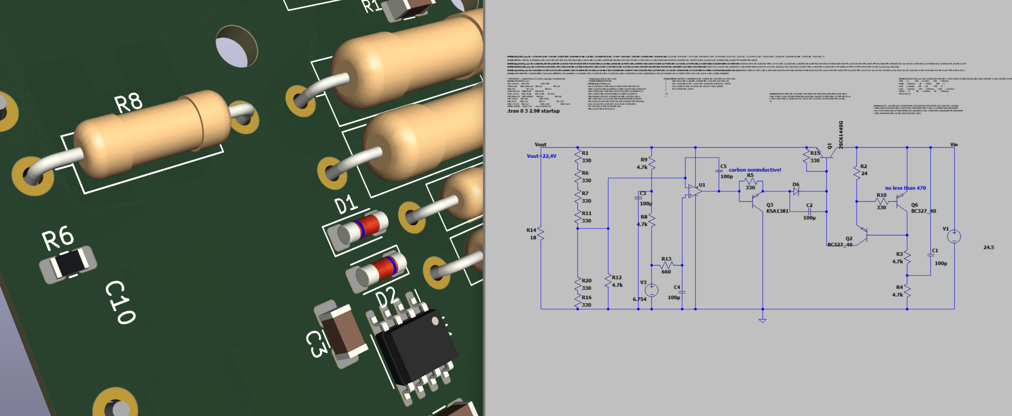

I redraw schematic for GLED431 without 20 R trimmer resistor (6,76V from 4xLED), and for 22,5 Vout, to use two types resistors only, e.g. 330R and 4.7k , max dissipation i see is ca 50mW so it`s not an issue.
On KiCad visualisation an R6 0805 is compared to R8 Vishay RN65D and indeed allows much smaller pcb even with multiple resistors in series. SMD on it`s own allows for more efficient use of PCB space as it does not collide with elements on the other side.
I`m torn between single non inductive non magnetic carbon films, Vishay RN65D or to try Vishay Melf or Susumu RG.
Still, more important question, what do the C3/C7 capacitors by feedback voltage divider on original schematic ?

GLED431 needs more than 5mA, according to your calculation it turns out that the current through GLED431 will be only 1.6mA which is enough only for LEDs
My GLED431s work at much higher currents up to 28mA but that's a bit of a different beast.
yes you are right, i did the GLED431 simulation on other file, with BSS139 biased to 7,8mA and ZTX, and here just used old schematic from LM329 with actualised reference value without trimmer resistor. It is not a full drawn version.
What are C3/C7 100uF on feedback voltage divider for? What would be the best resistors in feedback loop ?

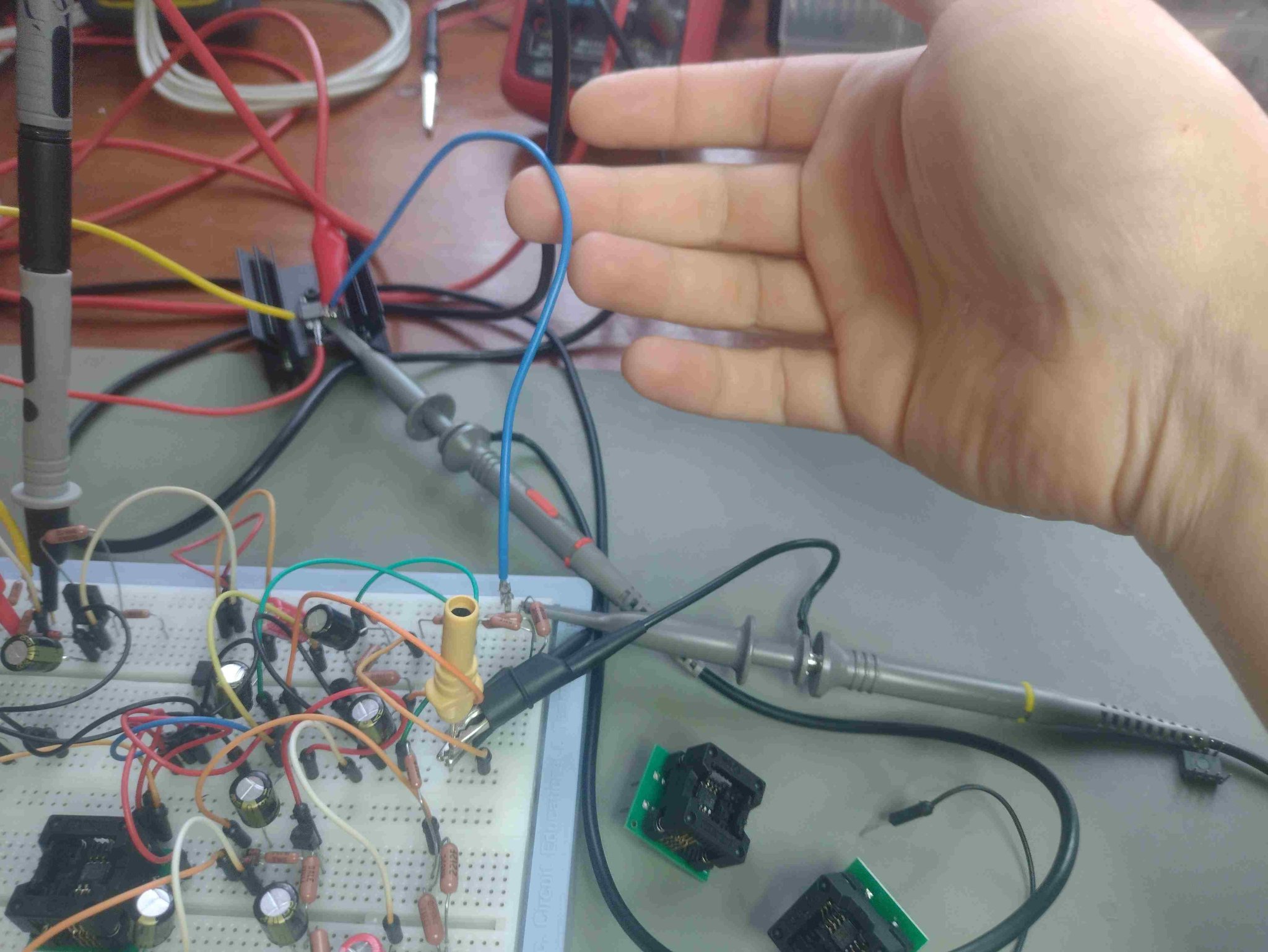

upper trace is taken from pass transistor leg, lower trace from first feedback resistor leg. Diffrence is only 15 cm of wire between, but it is clear to see that lower is much better. We hear much more than we can see on the scope.

R6/R7 divides the output for comparison with the ref. But that means it also decreases the loop gain because the 'error voltage' to the opamp is also divided.
C3/C7 short R6/R13 for AC so the AC feedback is not divided down, and thus does not decrease the loop gain. Result is a bit more AC loop gain and thus a bit better performance.
To be more precise: the Rout, for instance, is decreased by the feedback divider ratio compared to the situation without C3/C7.
Jan
If i understand properly, this capacitors increase loop gain at higher frequencies and make thus the superreg better (as long as it is stable),
so they should stay there if i care for sound quality ? Kind of increases the gain, i.e. supresses the error better at high frequencies.

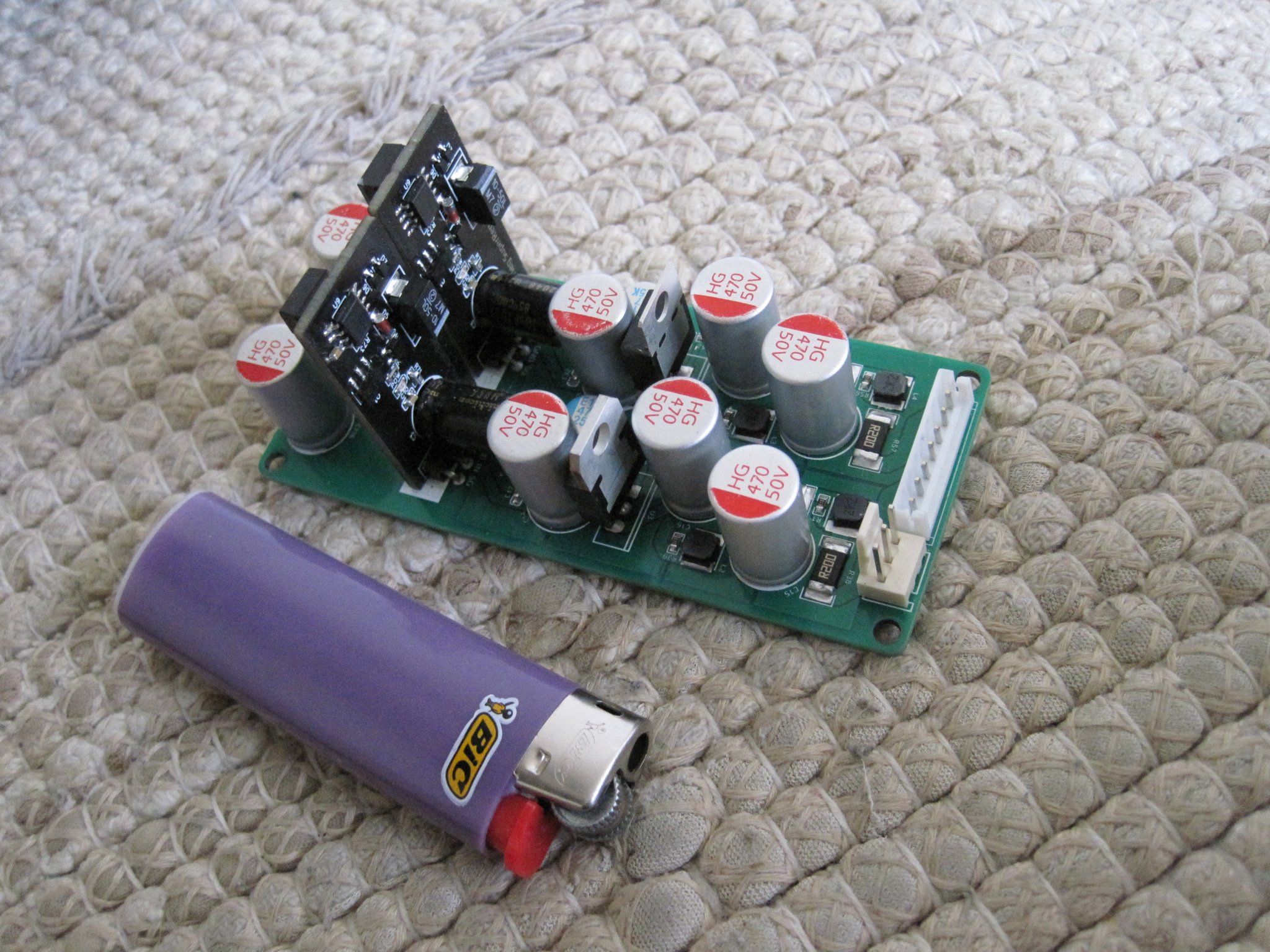

I bought a pair of these boards a couple years ago and finally deciding to dig in and use them. I would like to set them up for 15V or 18V output to use with a headphone amp (15V) or a Pearl 3 Phono (18V).
I plan to buy the exact parts from the BOM and use 6.9V Zeneer, AD817, and a 1.07k resistor for R6 to get approximately 15V.
From what I understand, I need a PSU before the Super Reg. What is the simplest form of PSU I can use? I understand I need my toroidal, bridge rectifiers, some filtering, and what else?
Also, what does my voltage need to be BEFORE the Super Reg? I understand my rectified DC voltage needs to be higher than my desired voltage, correct?
I am hoping to get some feedback of what others have used and get more ideas for my build.
Stock voltage for the Pearl 3 is also +/- 15V. With 18V you will be at or over the limit of some opamps used in the Pearl3. I built super regs for my Pearl3. 1k07 is correct for 15V. I used OPA1611 opamps in the SR (less noise than the AD817). They are smd parts though.

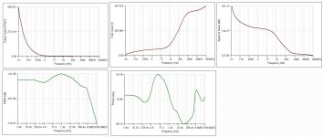

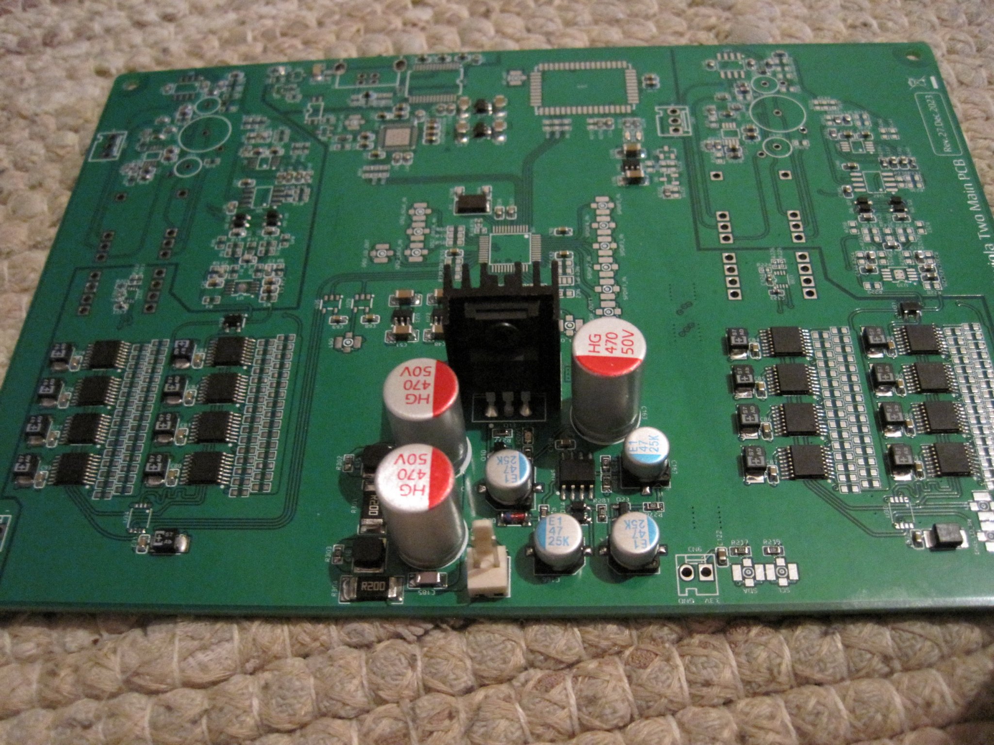

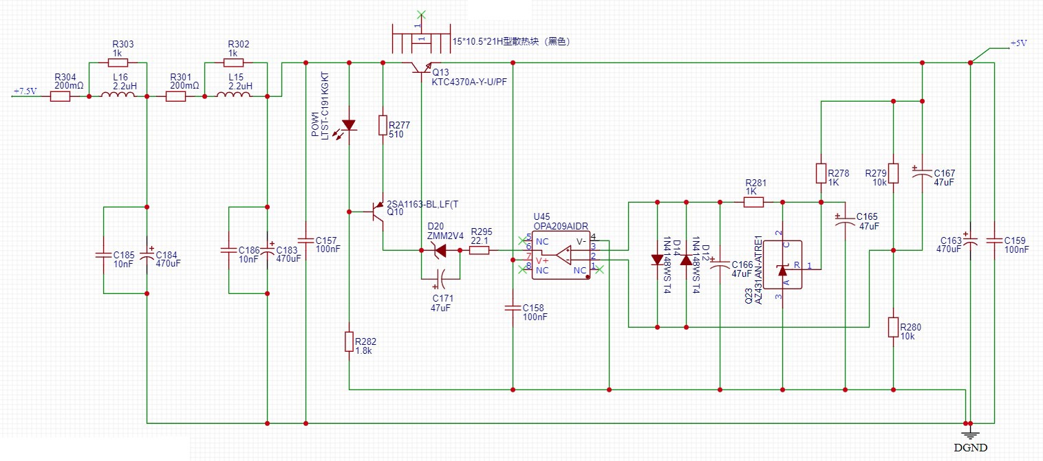

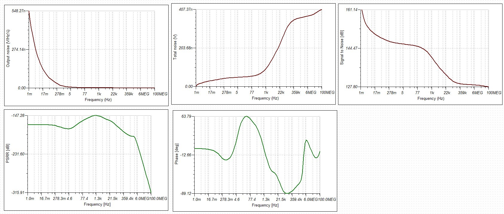

Yet another +5V J.D successor. Implemented in my next project, it work very nice, rersult was expected as Tina simulation show an nice regulator. Implemented an inline dc-dc filter at the input, and removed 330nH output inductor, had some oscilation with them but in simulation those inductor helped to linearise some characteristic but in real circuit it oscilated and gaved 0.5V more than what simulation showed, probably my bad inductor choice, so I removed them and regulator is stable and work nice : )

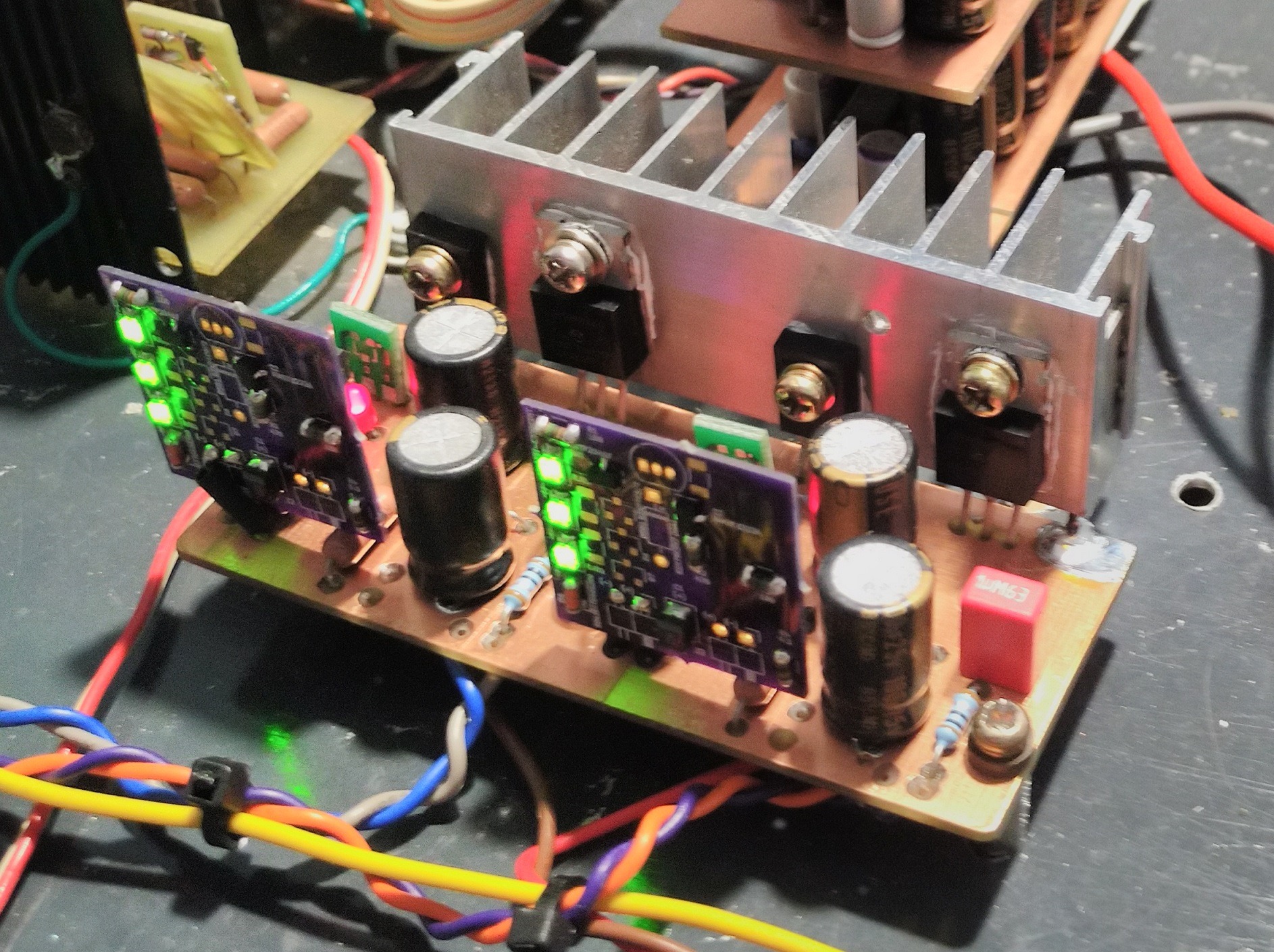

This one curently untested, +-15V for preamp supply, powered from SMPS400A180 aux, contain inline dc-dc filter, lm317/337 predregulators and micro J.D. regulators, microregulators gerber and bom I have posted in one of my earliers posts, good results with those micro J.D. who want to builld. : )
