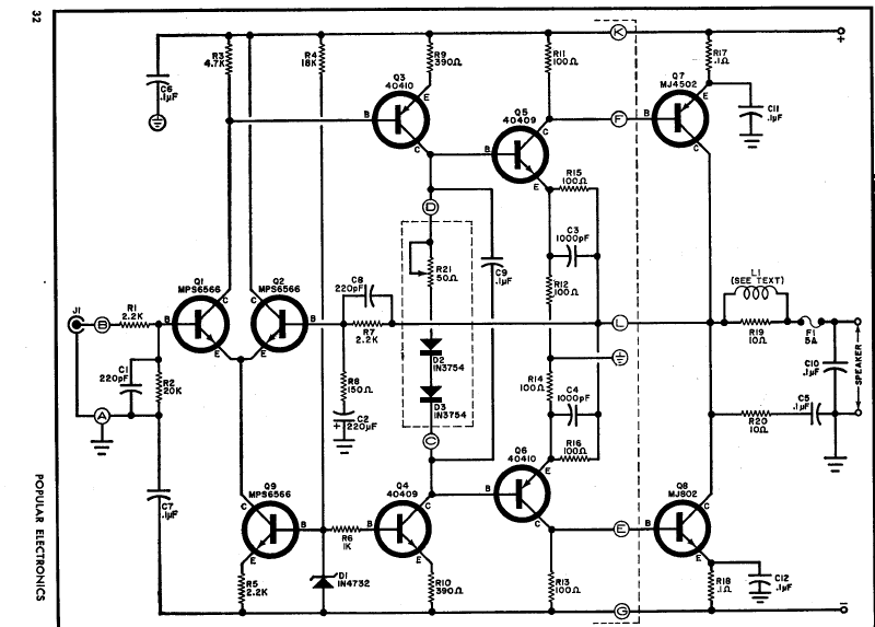

Schematic: https://www.diyaudio.com/forums/att...096758143-universal-tiger-universal-tiger-gif

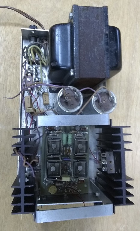

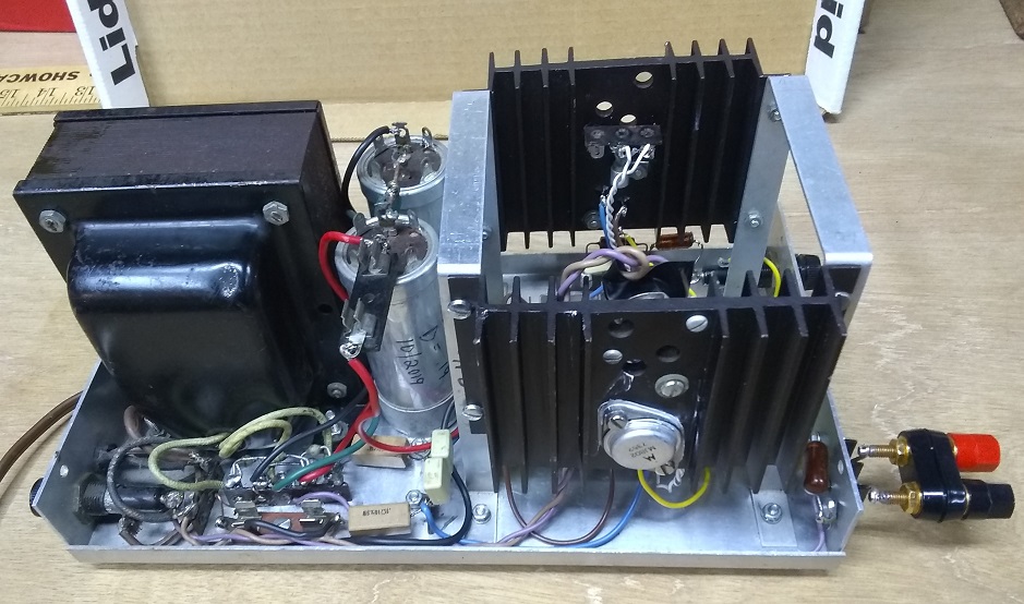

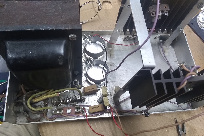

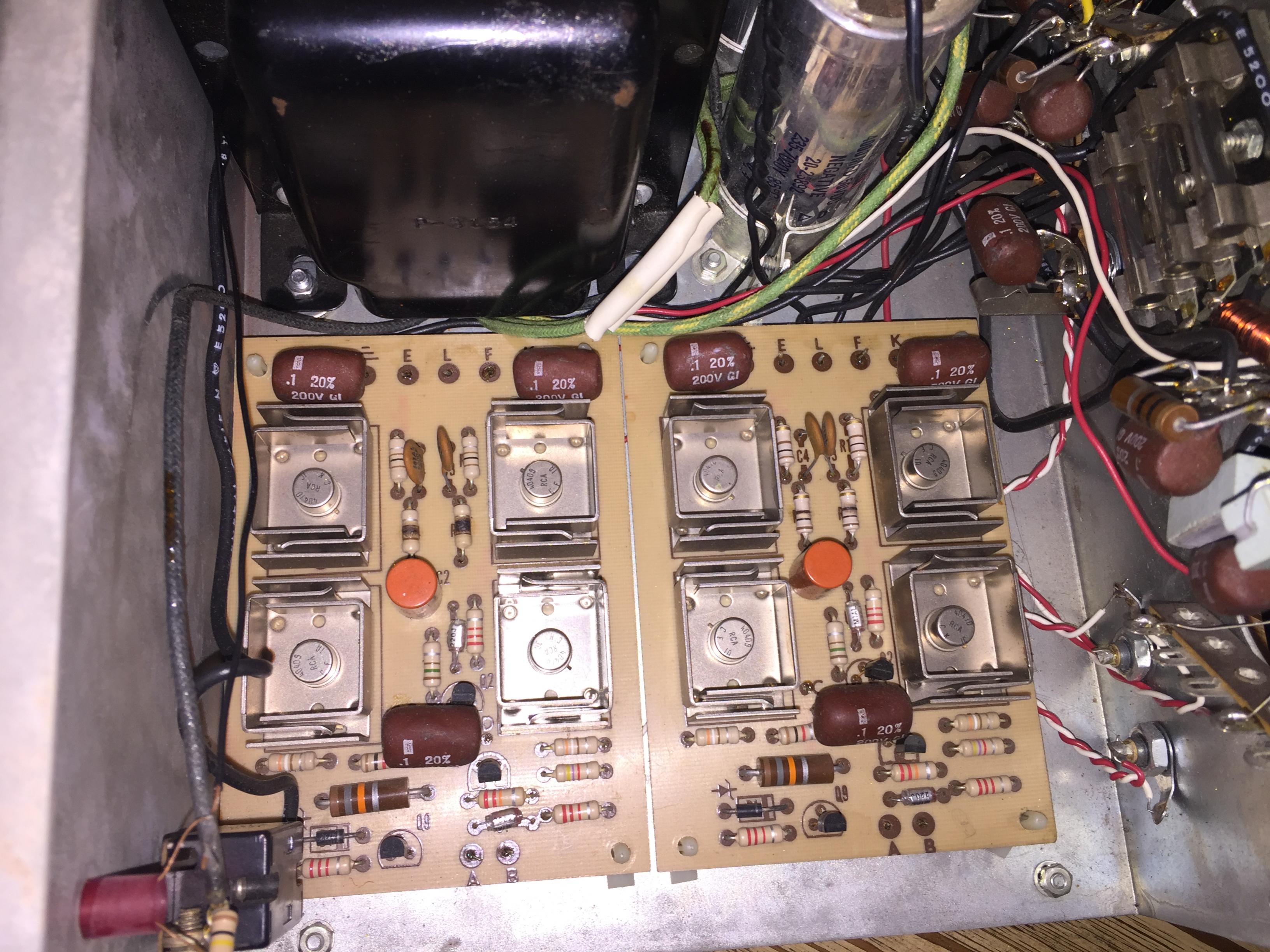

BEFORE PICTURES

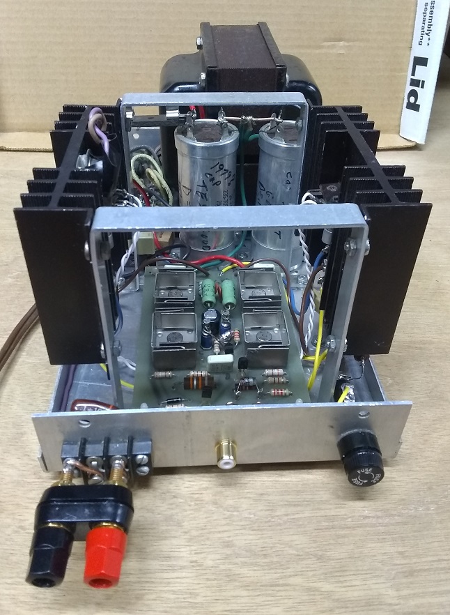

This is the before picture of the amp that I'm rebuilding:
Part way into it:
https://www.diyaudio.com/forums/att...pc-universal-tiger-rebuild-analysis-utr-2-jpg
AFTER PICTURES

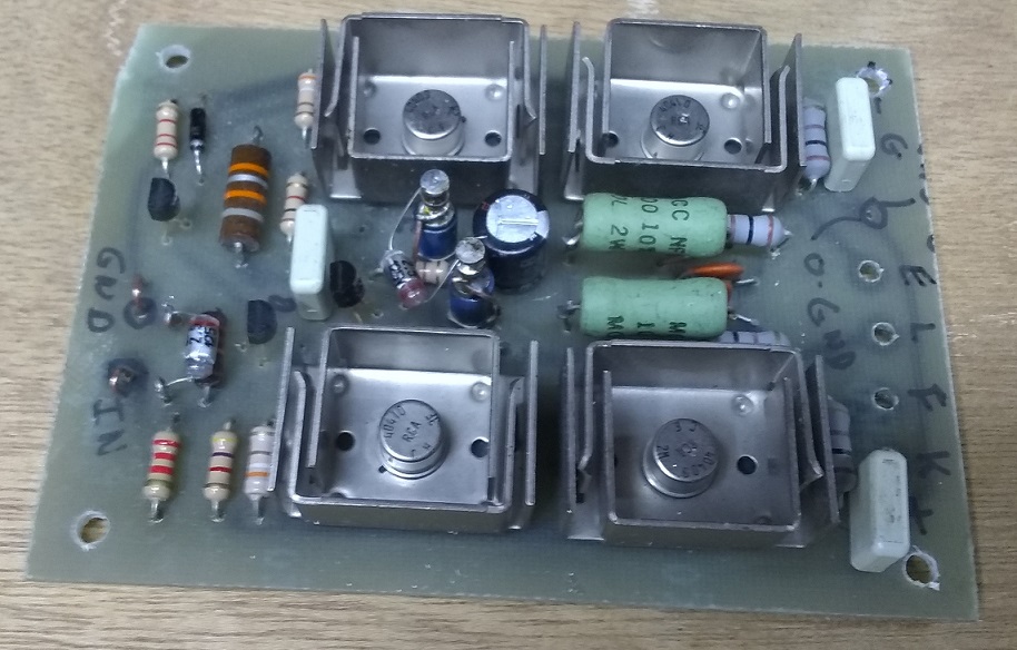

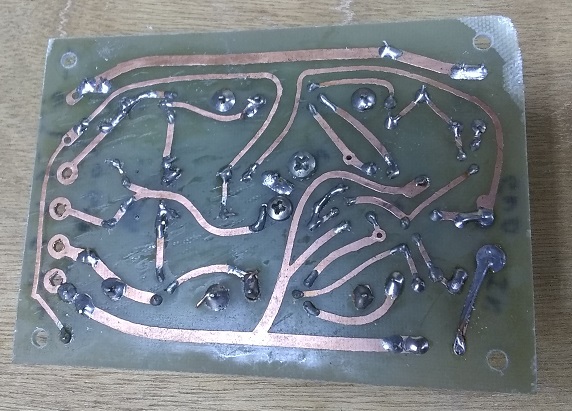

This was the MKII version but I want to start with the original version since they all need
fixes to cure the oscillation problem. I'm using a home made board, by Tubelab, that has
never been powered up with all new parts. I diode tested all the semis and caps and tried
to use SWTPC parts as much as possible. This is built completely stock but R12 and R14
are upsized to 2W and the rest of the 100 ohm resistors to 1W flameproof since we don't
want the amp burning up during test. Polystyrene caps C3 and C4 are repaced with
ceramic disk so that they will not melt. The feedback cap and input filter cap are on stand
offs so that they can be easily changed for experimentation:

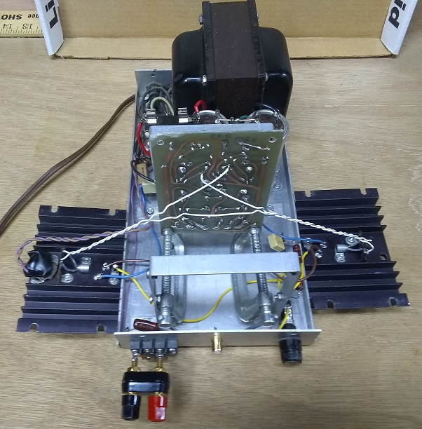

https://www.diyaudio.com/forums/att...pc-universal-tiger-rebuild-analysis-utr-3-jpg
Backside:
https://www.diyaudio.com/forums/att...pc-universal-tiger-rebuild-analysis-utr-4-jpg

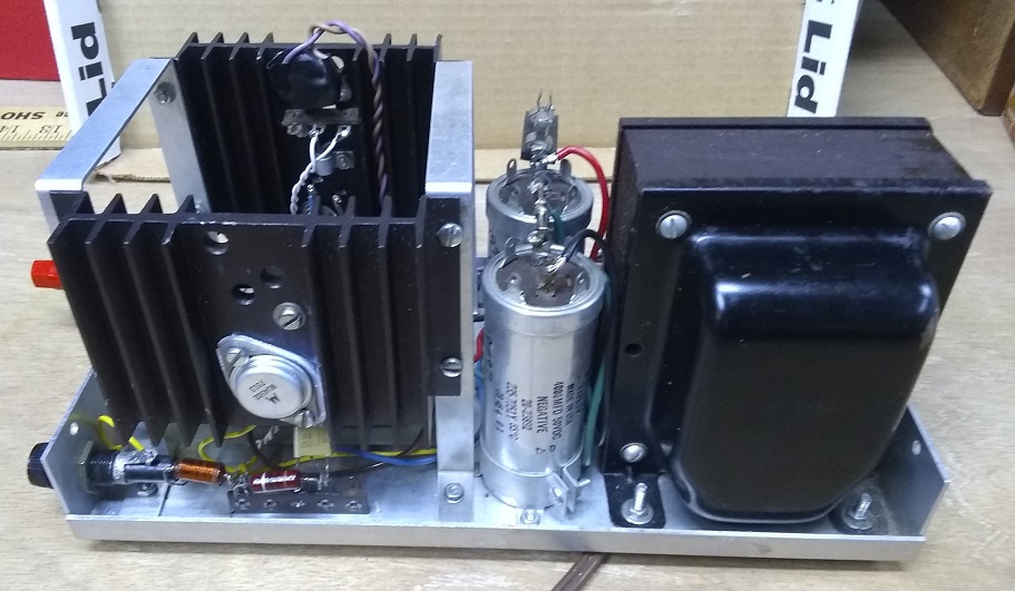

Completed amp:

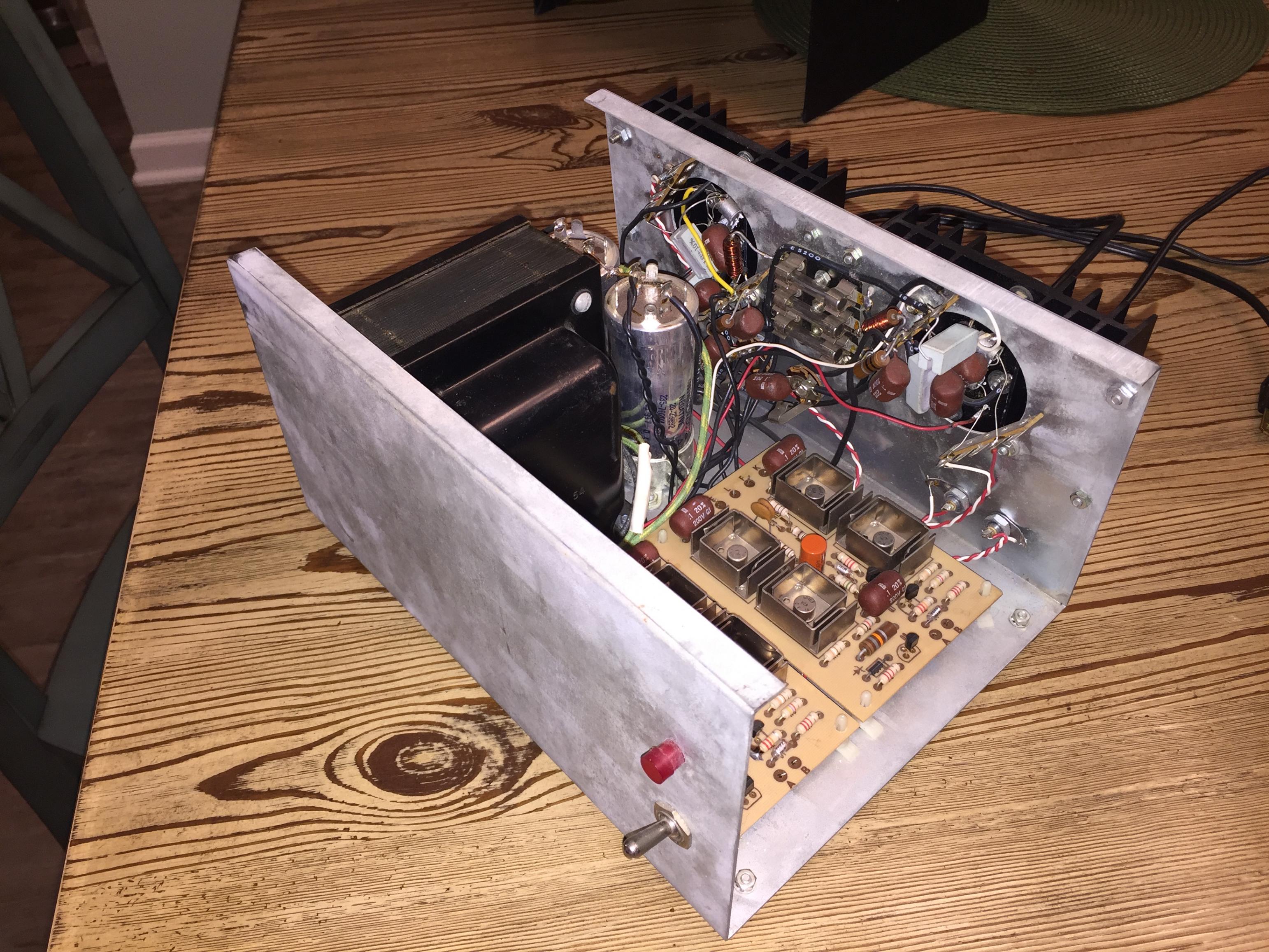

Wires are long enough to lay heatsinks flat and raise PC board up for easy access to both
sides. Small C-clamps are used to stand up the PC board:
A few more pictures:
I color coded the wiring:
red B+
black B-
green ground
white Bias
yellow input/ output
https://www.diyaudio.com/forums/att...wtpc-universal-tiger-rebuild-analysis-utr-jpg
https://www.diyaudio.com/forums/att...universal-tiger-rebuild-analysis-utr-left-jpg

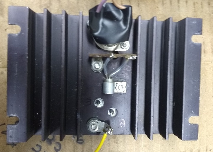

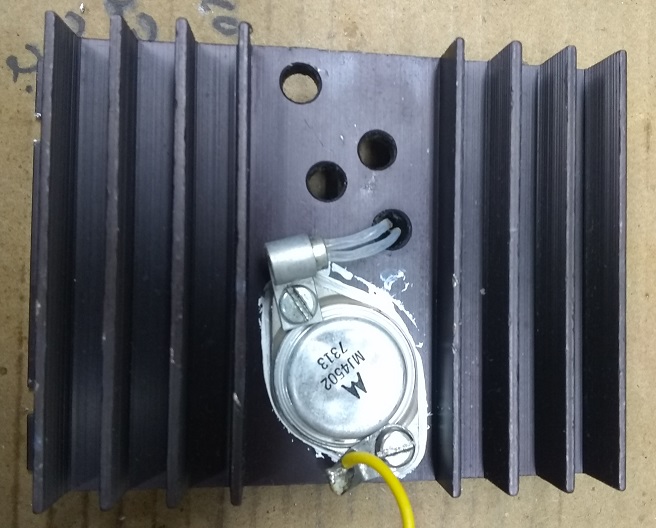

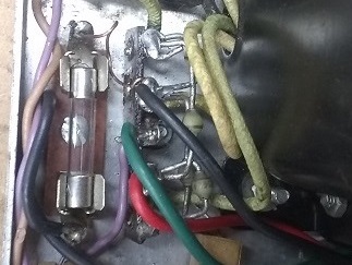

4. Simple improvement to the heat sink assembly that my brother and I noticed back in the 70s:
The stock assembly is shown here where it can be seen that the thermal sensor diode and
collector connection are made on the back side where both heat and electrical current
have to pass through the screw and nuts holding in the transistors. The screw head to
transistor, screw to nut, and nut to terminal lug are all non-gas tight connections:
https://www.diyaudio.com/forums/att...ersal-tiger-rebuild-analysis-utr-hs-stock-jpg
We concluded that moving the thermal sensor and collector terminal to under the screw
head was a much better way to conduct both heat and electrical current:
https://www.diyaudio.com/forums/att...iversal-tiger-rebuild-analysis-utr-hs-mod-jpg
I've not done this mod to this test amp but will do it with any other rebuilds that I do.

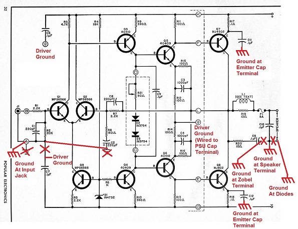

GROUNDING:
The grounding is somewhat convoluted in the Tiger amps and documentation
is provided below for others to follow along.

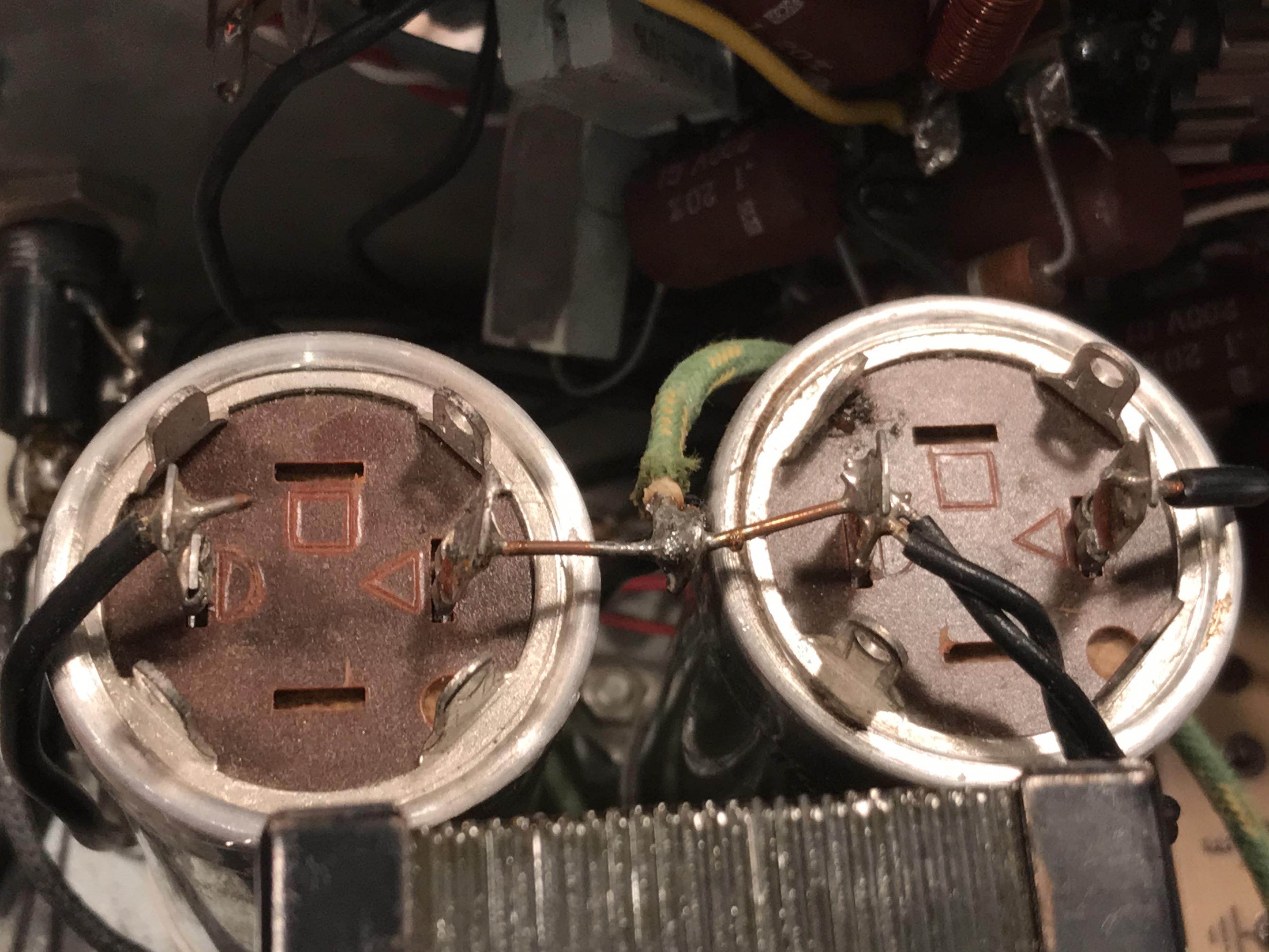

There are 5 terminal points that use chassis ground in the UT mono
block version, the stereo version is very similar:
1. Diode Term Ground:
This is at the bridge diode terminal strip on the mounting terminal
that grounds the transformer center tap and the speaker terminal gnd:
https://www.diyaudio.com/forums/attachment.php?attachmentid=798553&d=1575055539

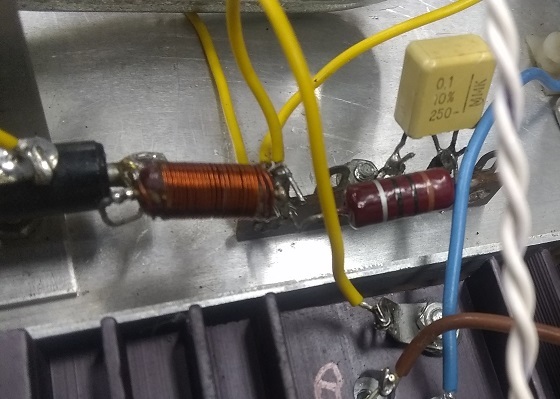

2. Emitter Term Ground:
This grounds the output transistor emitters through .1uF bypass caps:
https://www.diyaudio.com/forums/attachment.php?attachmentid=798554&d=1575055539
3. Zobel Term Ground:
This grounds the Zobel:
https://www.diyaudio.com/forums/attachment.php?attachmentid=798555&d=1575055539

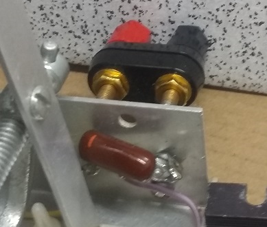

4. Speaker Term Ground:
This is a chassis terminal lug at the speaker output that grounds the .1uF
across the speaker output:
https://www.diyaudio.com/forums/attachment.php?attachmentid=798556&d=1575055539
5. Input Terminal Lug:
The input RCA jack is not an insulated type and the input circuit, hole A,
is grounding to this lug.
No picture
The published schematic freely uses the ground symbol without making any
distinction between chassis ground and other grounds such as the traces
on the circuit board. There are two traces on the circuit board that I'll
call input ground and driver ground. The input ground includes base bias
for the input transistor, RF filter cap (C1), and feedback network ground (C2)
and connects to hole A on the circuit board. Driver ground goes to the hole
with a ground symbol rather than a letter identifying it. There are some
errors on the schematic where, for example, one bypass cap (C7) goes to the
input ground when in reality it connects to the driver ground.
I corrected the schematic to correctly show input ground, driver ground, and
all the chassis tie points as shown below:

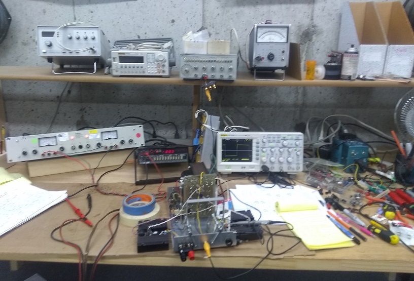

Here's the amp under test, HP lab power supply, HP function generator, Rigol Scope:
https://www.diyaudio.com/forums/att...-universal-tiger-rebuild-analysis-utm-lab-jpg
GROUNDING:
No picture

For an amp that oscillates in mhz range under certain conditions, I would think a little self inductance from a wirewound resistor would be a good thing. We're not building radios here. I'm guessing these are the emitter resistors on the drivers?We've come to the conclusion that 5W is even better, but the largest non-wirewound
resistors commonly available are 3W so I plan to suggest a pair of 200 ohm 3W in
parallel.
That dingy RCR network around R12 R14 C3 C4 doesn't work to prevent oscillation, maybe it would be better do remove C3 C4 less they make a RLC oscillator with inductive emitter resistors.
SWTC was the amp kit price leader about 1975, he didn't dare spend $.05 more for resistors. I thought about buying one but saved up for a starter for my car and a recap tire instead. Walked to work a couple of months in 1975.
parallel, elevated above the board just above the metal heat sinks for the drivers.
If you turn up the amp with music those resistors will get very hot and that is what
it looks like happened there. Full oscillation causes smoke.
You have ceramic disk caps there - that's good since the poly caps melted.
That is the stereo version like the one I worked on as a kid, brings back memories.
Will be ordering a handful of 3W 200's right away and will be following this religiously for health tips for my two UT kids.
I've had a 207/a amp for many years that never had the least problem aside from the power supply caps finally going bad. Replaced a lot of carbon resistors with metal film and better quality electrolytics throughout and finally installed much faster MJ21193/94 devices with no apparent problems. Easily meets distortion specs. It's the only amplifier I've ever had with a CFP output stage.
However, that bias diode is mounted the same way. I ought to fix that.
Hi Ian,
Sorry I missed this post, yes they are the driver emitter resistors and the associated
feedback resistors. You might be right about inductance helping but I want to keep it
similar to the original design for cases where people do not change the resistors. C3/4
drop the output stage gain to unity at HF and I doubt that they do much for stability.
I'm thinking that they might help to keep the output stage out of saturation by dropping
the gain at say 100KHz but I've not yet checked the -3dB frequency.
Looking for help with determining best options for replacing my SWTPC Universal Tiger two power supply caps.
Data on can:
Mallory Type FP
50 V 4000 uf
20-23892
235-7020Y 85c (7020 supposedly means 1970 year and 20th week of manufacture)
What's puzzling is when reading through one of Mallory's data sheets listing various types, it says that the FP with two solder terminals with D and ▽ next to them indicates a dual section cap but I was under the impression this had to be a single section 4000 uf cap.
Would be grateful if anyone can point me to a more recent vintage replacement cap that would have the same specs and footprint and if not possible, is rebuilding the caps a viable option?
Allen
Data on can:
Mallory Type FP
50 V 4000 uf
20-23892
Allen
Amps tend to burst into flames if poorly protected.
There should be a primary winding fuse before the mains switch and transformer.
There should be a fuse in each leg of the secondaries.
Some amps even have a fuse on the output.
If any of these are wrong value or missing the only outcome will be a disaster.

In response to abartee I would think a 3900 uf 63 or 80 v capacitor would be adequate. To adapt in snap in caps to these old boards, usually requires a transistion board of insulation. Strain reliefs holes for the wires keep them from being pulled around. I use NEMA CE material from mcmaster. 1/8" or 1/16". A 90 deg angle bracket of scrap metal with 2 holes can usually screw the adapter board down to some safe surface. I use #6 screws and elastic stop nuts so they don't come unscrewed.
There are a +40 and a -40 rail. If there are not two capacitors, then that is the explanation for the 2 section cap. Replace with two caps. Make sure - goes to the - rail and plus goes to the + rail. The two other terminals tie together and go to speaker ground.
Thanks for the replies. In further looking at the mallory terminal designations chart, the section with negative case was showing two terminals with half moon and triangle were two section duals but the section of the chart with floating case and two symbols is not a dual and triangle is negative.
The amp in question (stereo version of universal tiger) has two caps as in photo
Well the green wire is obviously speaker ground. As to whether the half circle or the triangle is + or -, + goes to the emitters of the pnp output transistor and - goes to the emitters of the npn.
Sounds right to me. Pulled the fuses that were existing when I purchased the stereo version universal tiger amp (2S-175). For some reason I can't locate the mains fuse after pulling it a while back and didn't get a look at the amp rating! The other fuses are:
