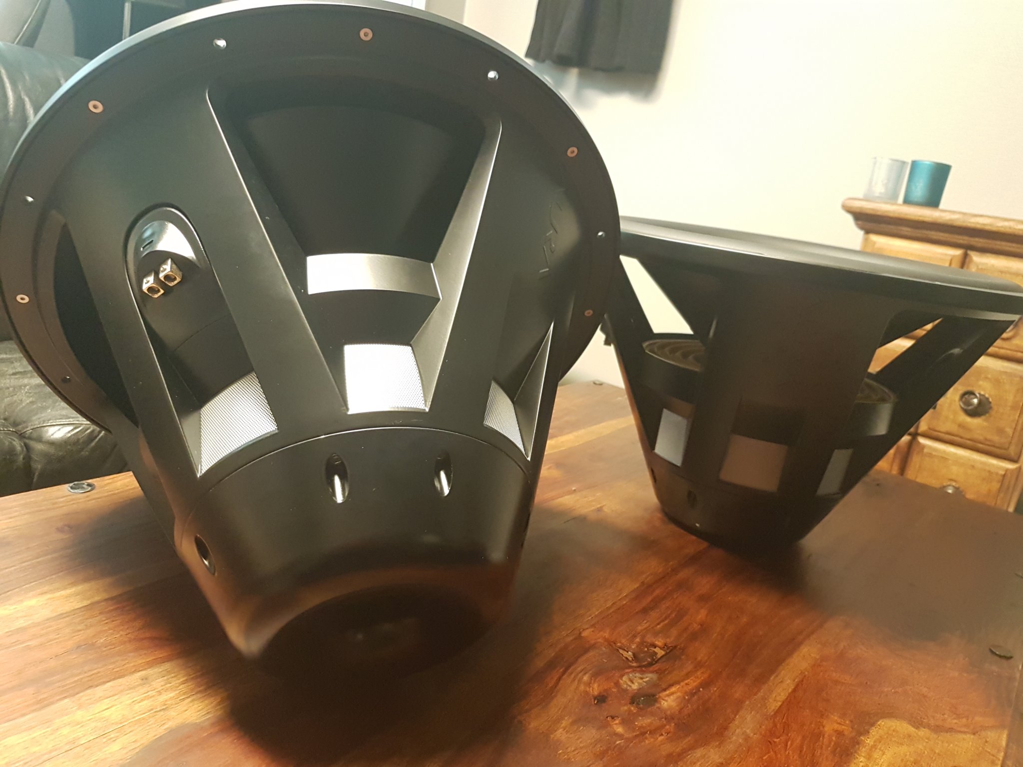

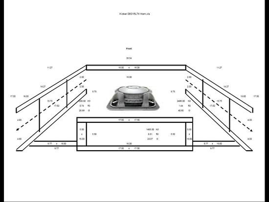

For reference to the truck sub.
Same sub that's in the T-TQWT.
Truck = 2009. Mancave = 2012.
The Kicker 08S15L74 is a BEAST.

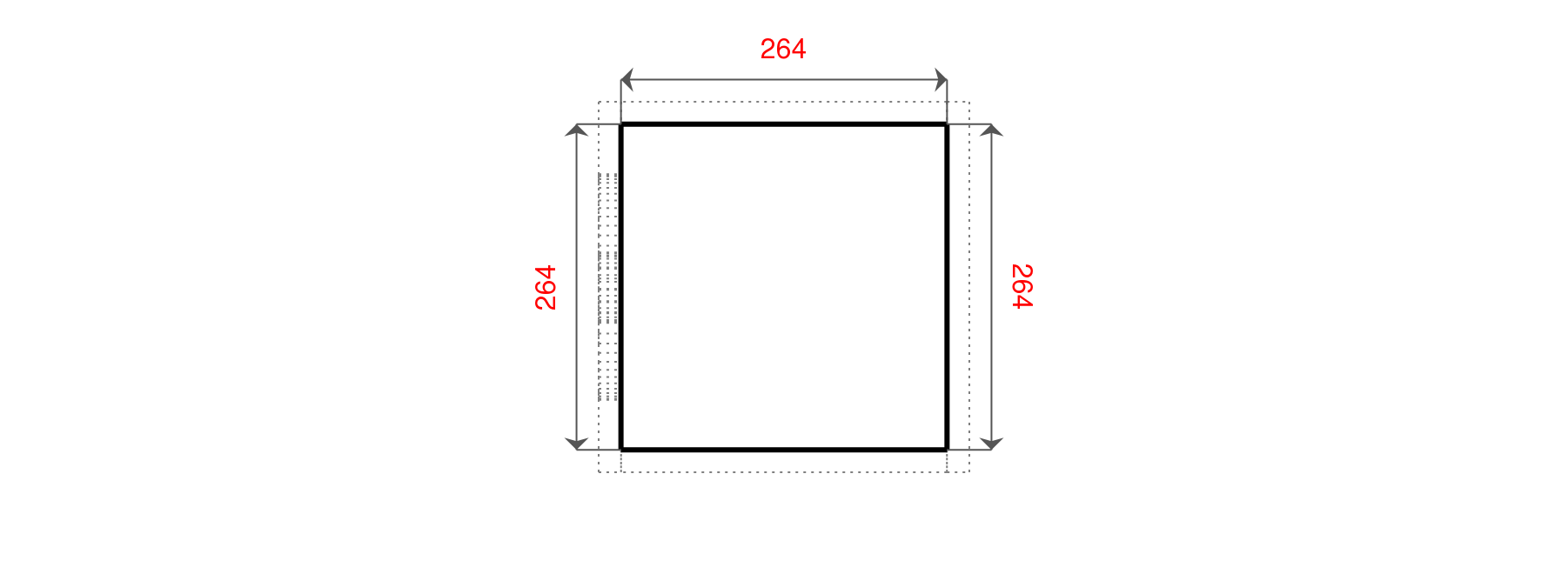

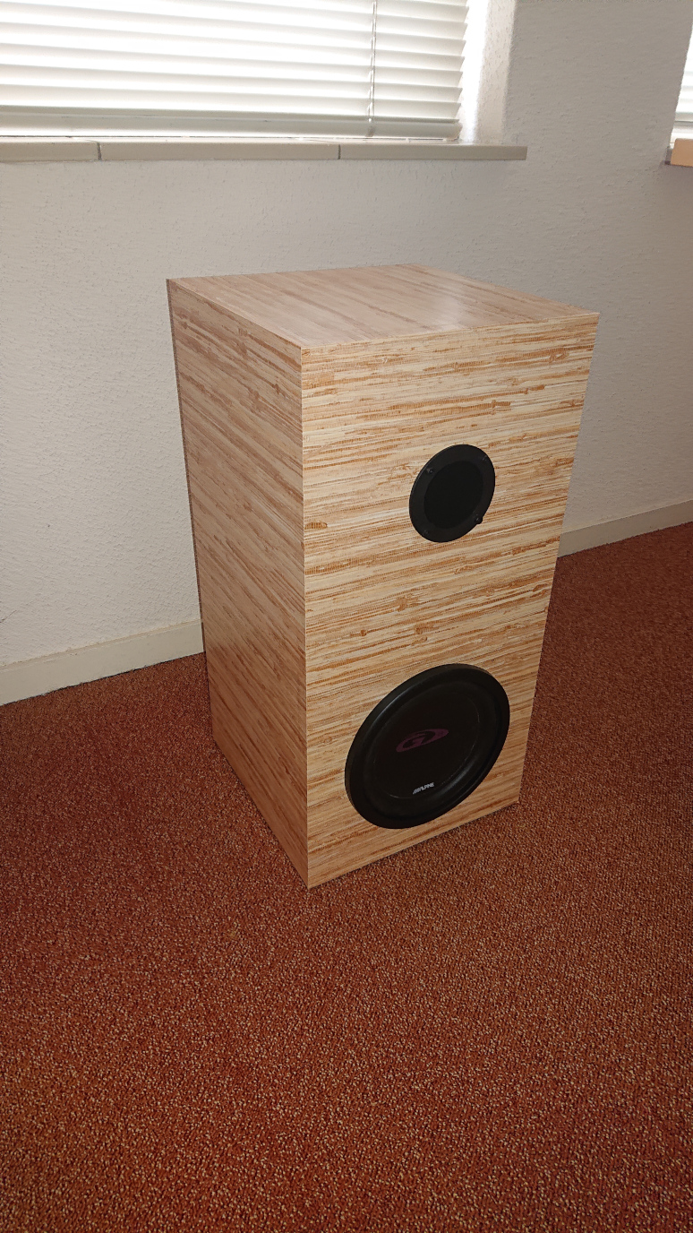

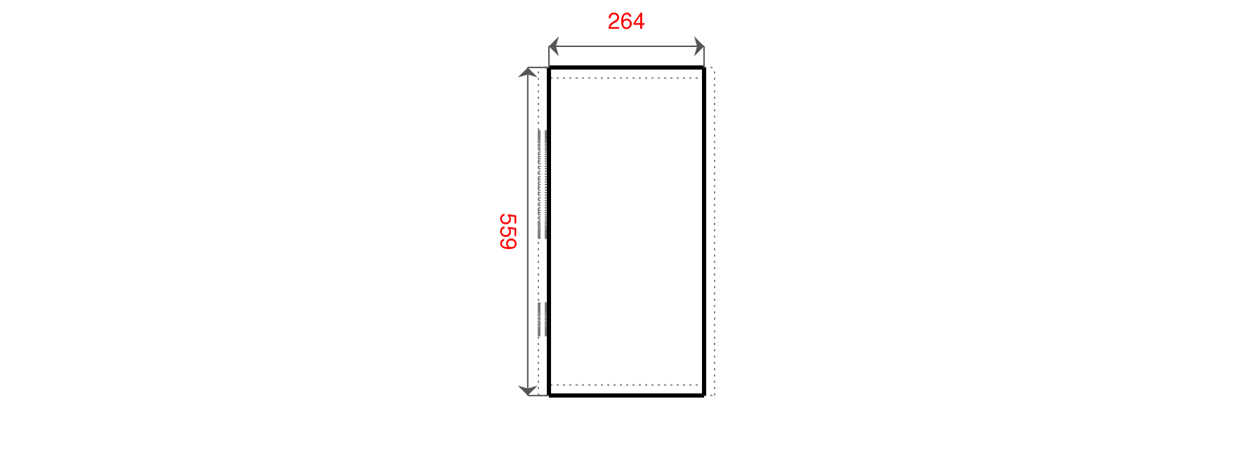

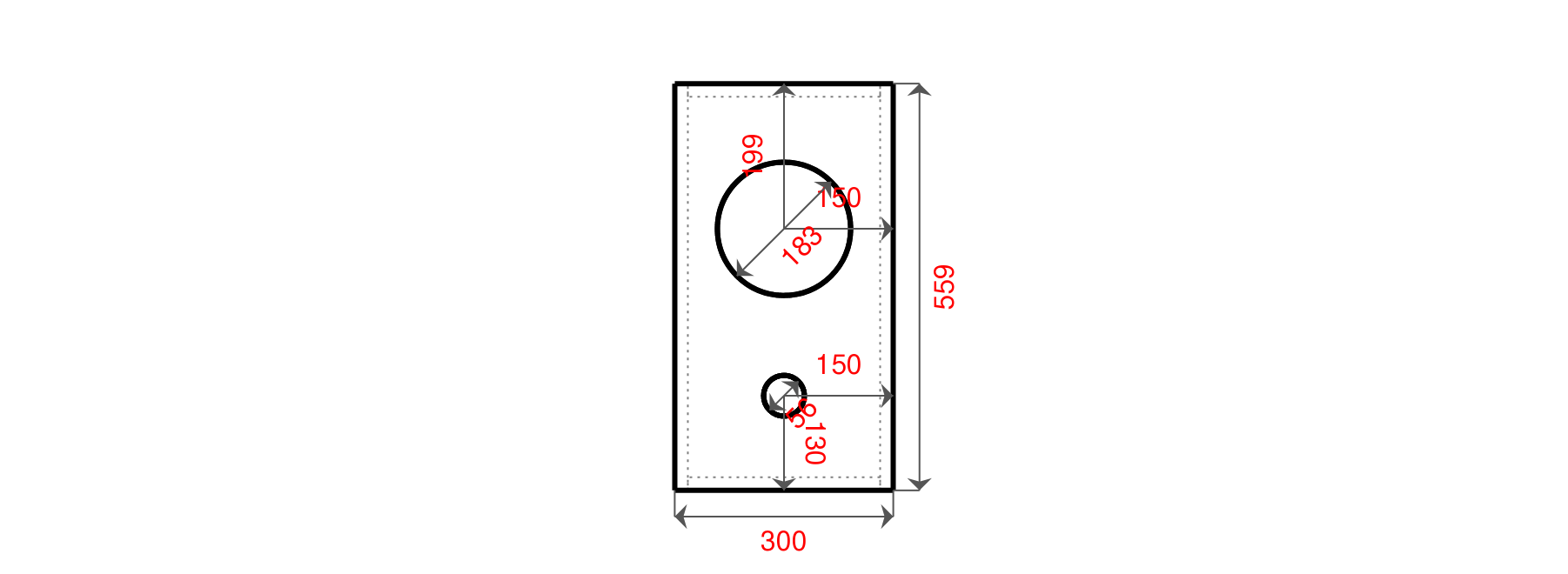

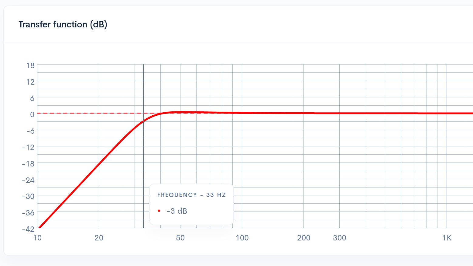

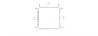

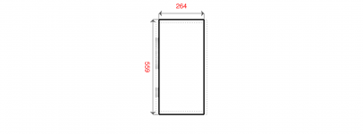

Alpine SWG-844 in 35 liter bassreflex, designed with SpeakerBoxLite. Subwoofer box calculator, Sub box calculator
Made from 18mm MDF, with one square MDF piece in the middle between the driver and the port for bracing.
The cabinet is wrapped in vinyl, in 3 separate pieces. First piece is wrapped from the bottom, up the left side, over the top, down the right side and back to the bottom, the protruding vinyl is cut at 45 degree angles and folded over the front and back.
Next the front and back are wrapped separately and trimmed to the edge.

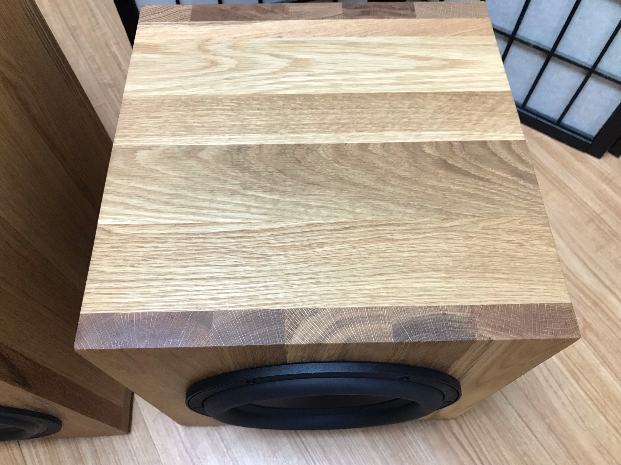

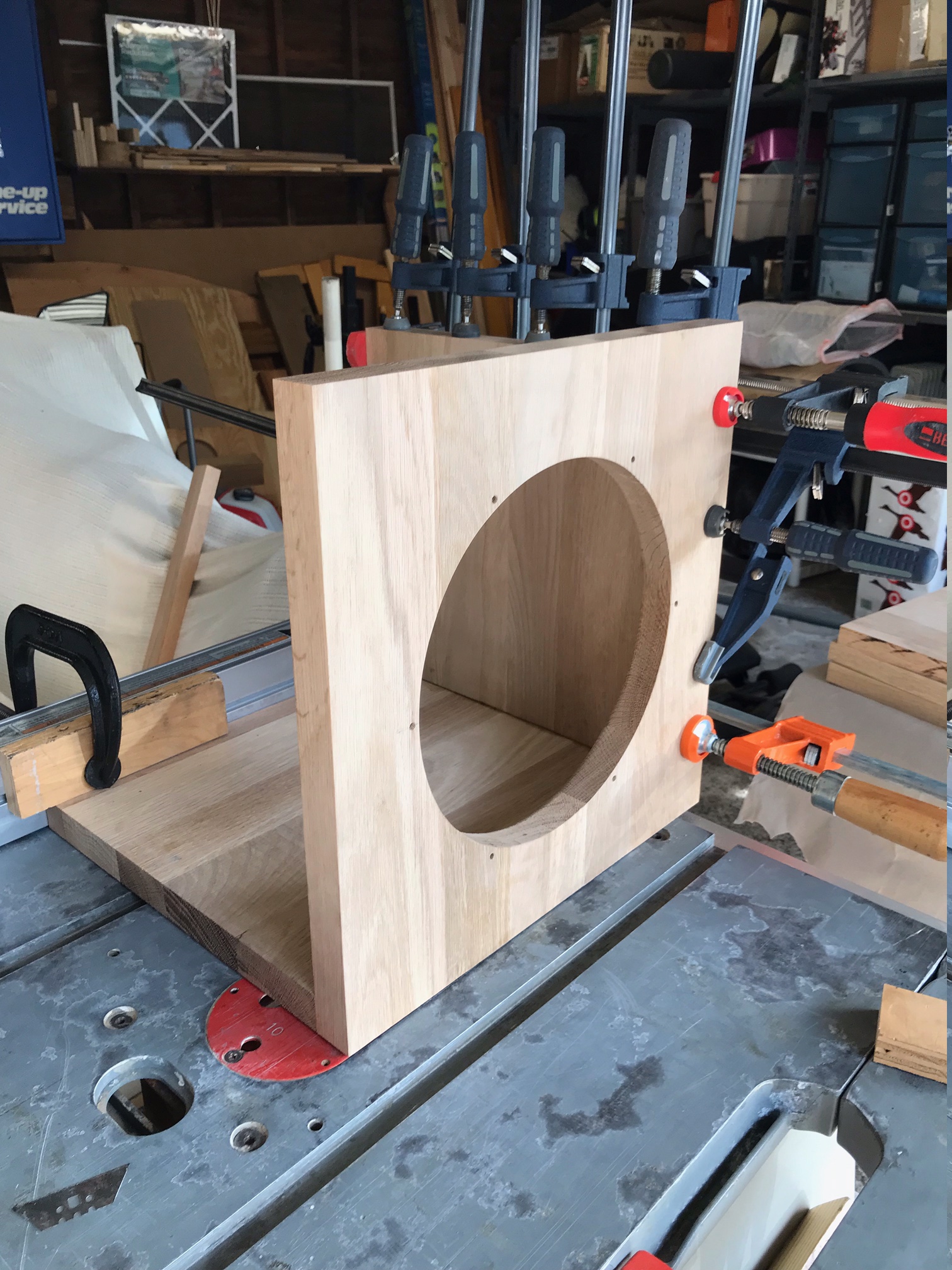

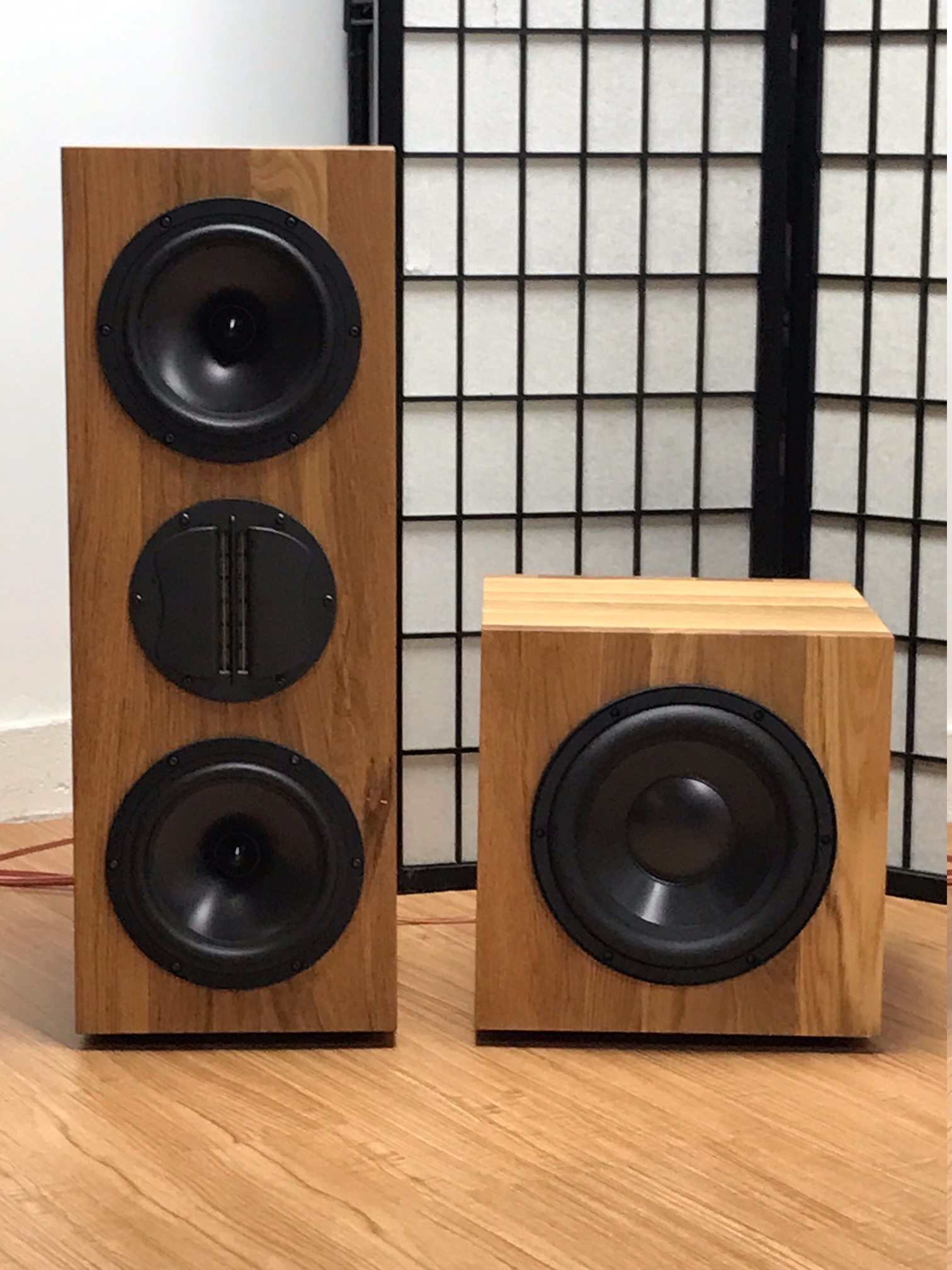

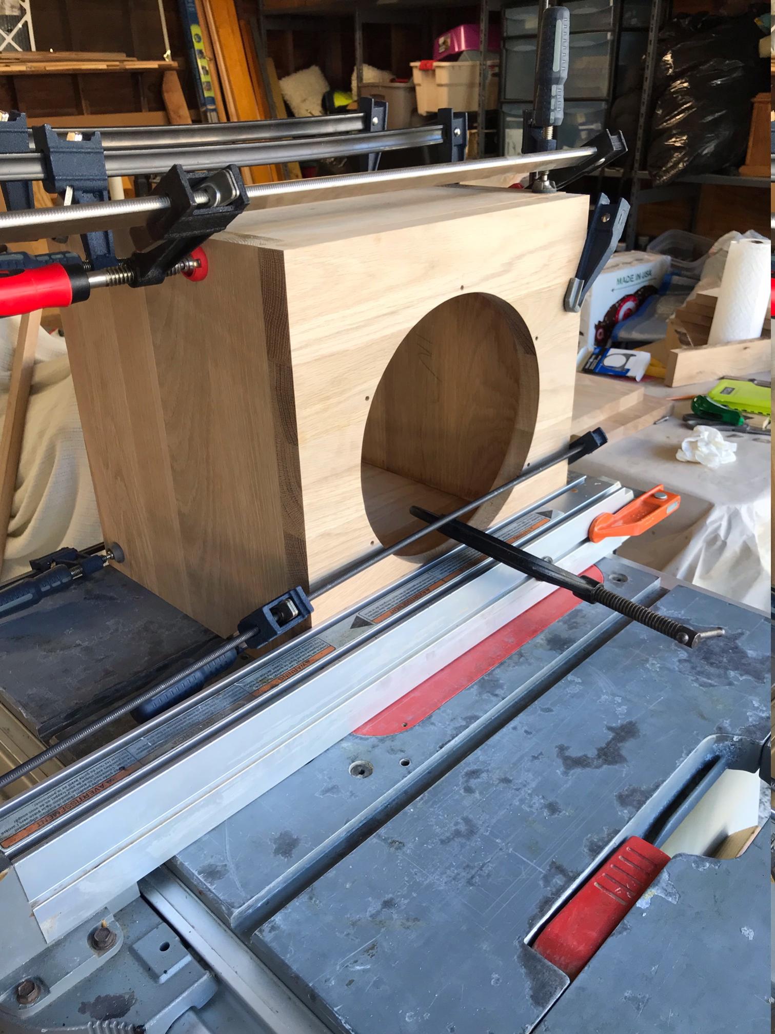

Here’s a recently completed sub project. Sealed passive units with the Dayton Audio Reference series 10” driver RSS265HF-4. These are the companions to the MTM cabinets I built last July (Post # 3343, page 345 in Speakers/Multi-way/System Pics & Descriptions). The same construction using 1” thick laminated oak boards. I built two subs, with one positioned as shown and the other closer to the listening position. This seems to even out the bass distribution in the room more than having both up front. These are part of a fully active system and each is driven by a dedicated 125W amp channel. Been listening for a few weeks now and I’m quite pleased with the results. Thanks for checking.

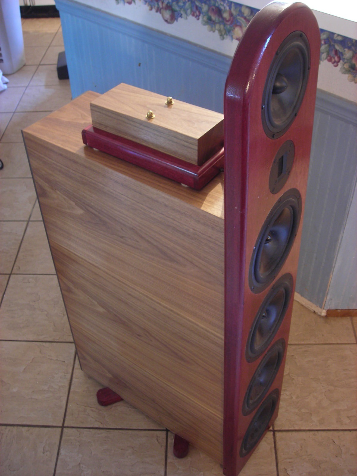

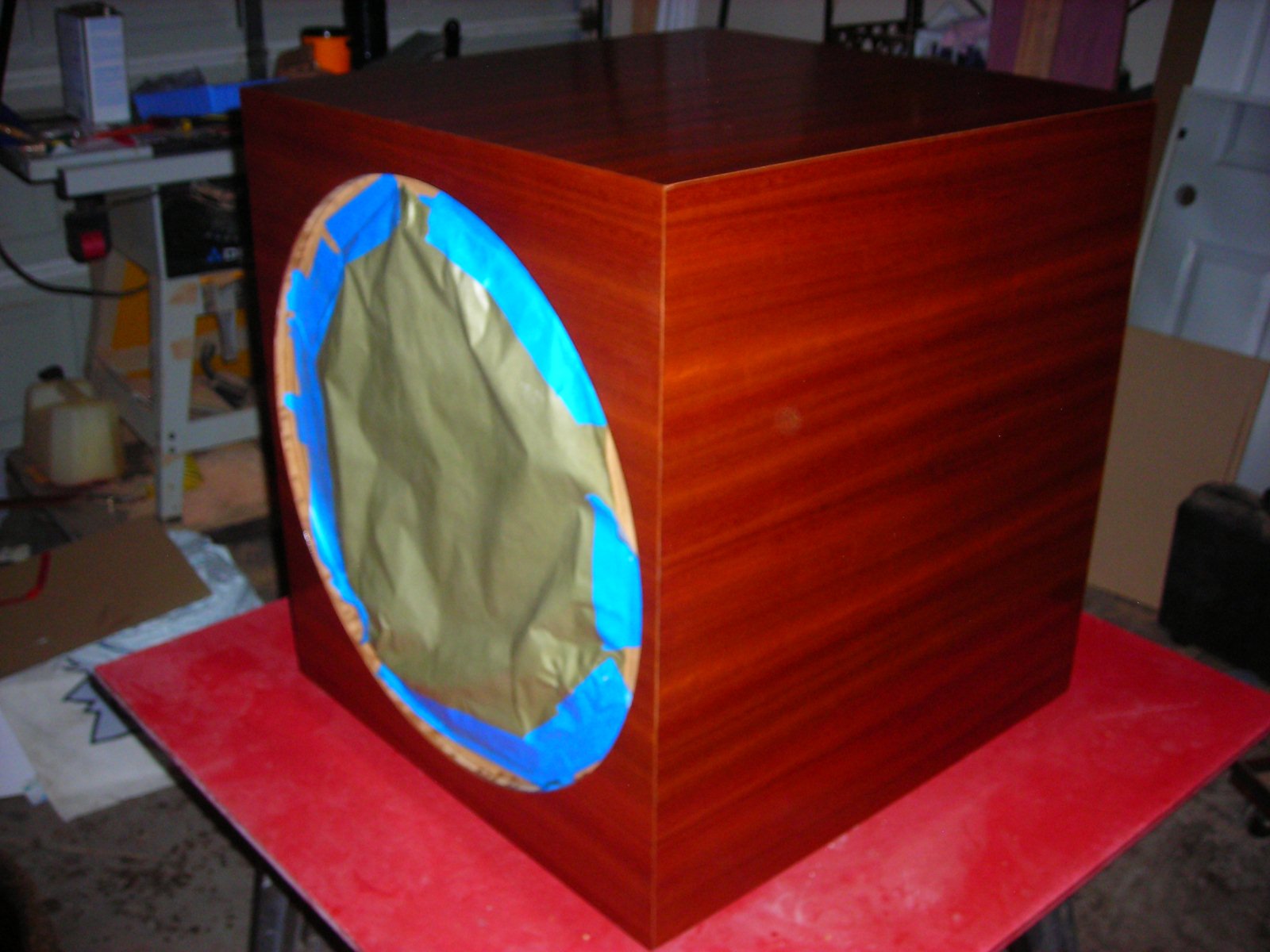

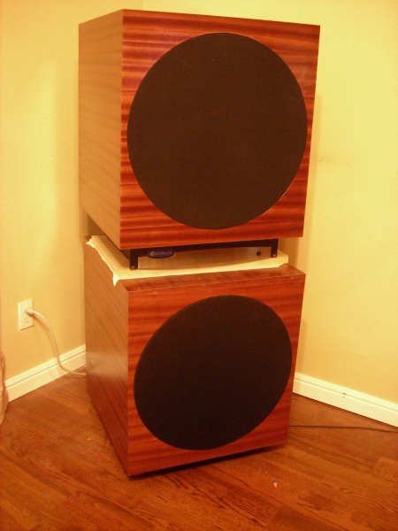

Two passive 18" Dayton with 1/4 sawn Sapele Veneer. Lots of poly. Did these 10 years ago. Gave them to my Son now I am in an apartment. Built a couple monoblocks each with dual LM3886 boards and snubber power supplies. I now use my MTWWWW towers Seas Prestige, NEO CD1 Fountek and four 8" Dayton Reference towers.
