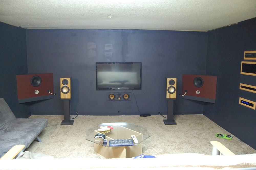

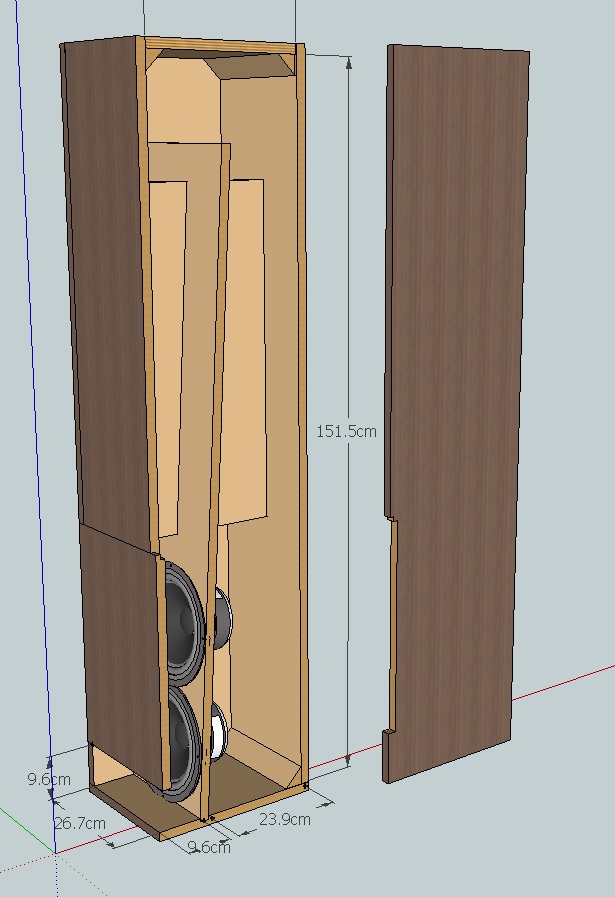

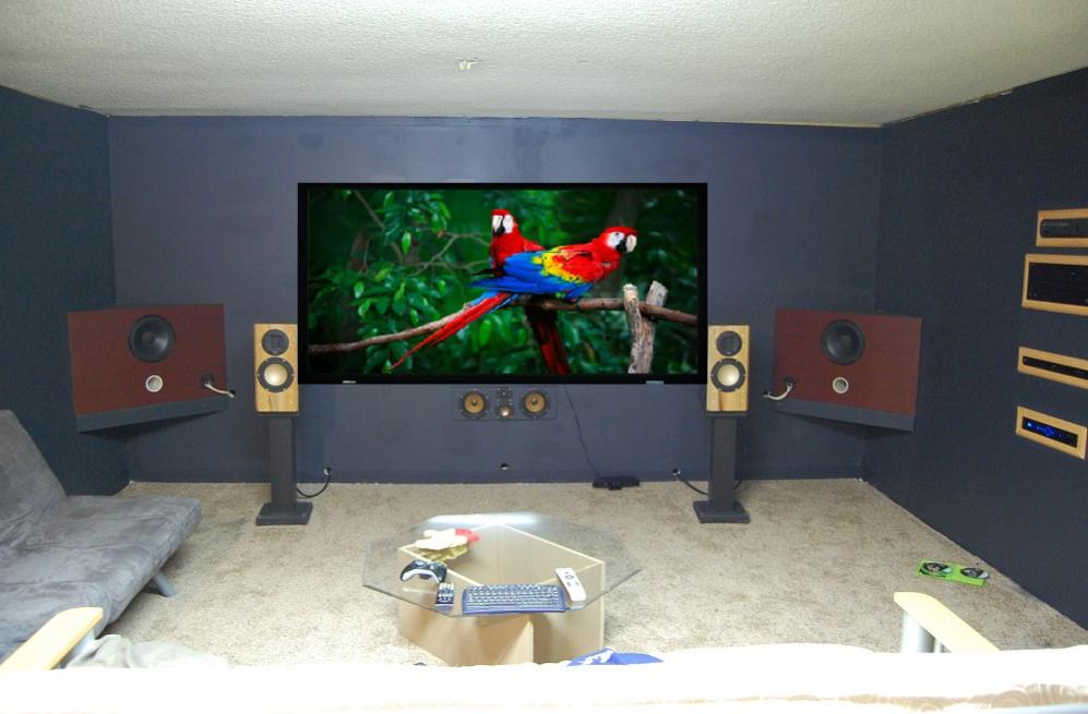

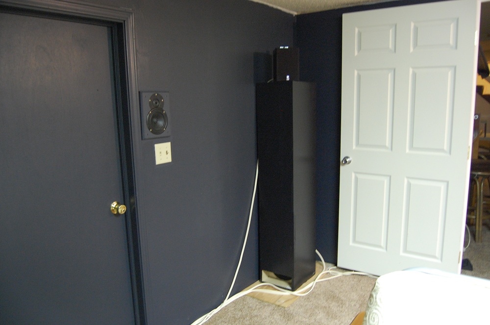

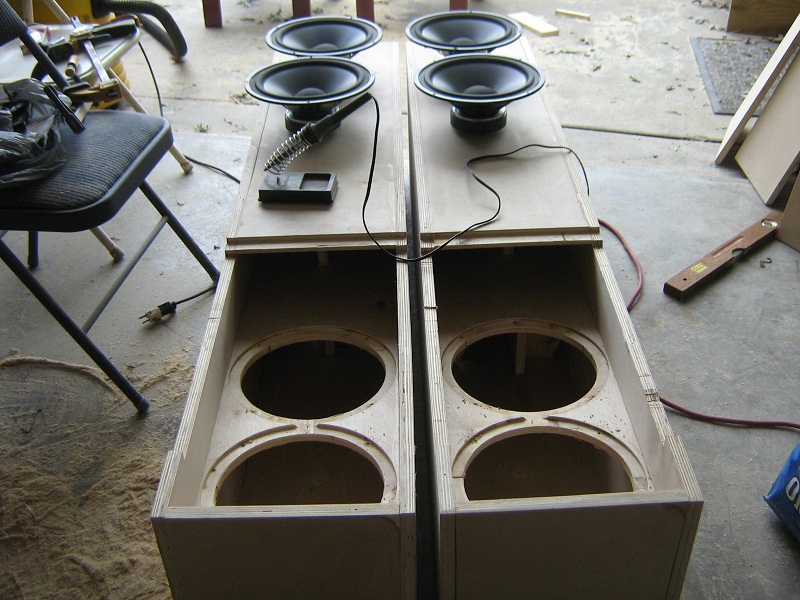

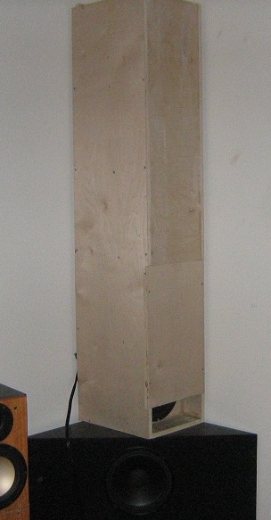

Here's a few pics of mine, some under construction and sketches of my t-tqwt subs and my corner loaders. Peerless 831759s.
Some of the pics are from the room that I'm still in the process of building.
