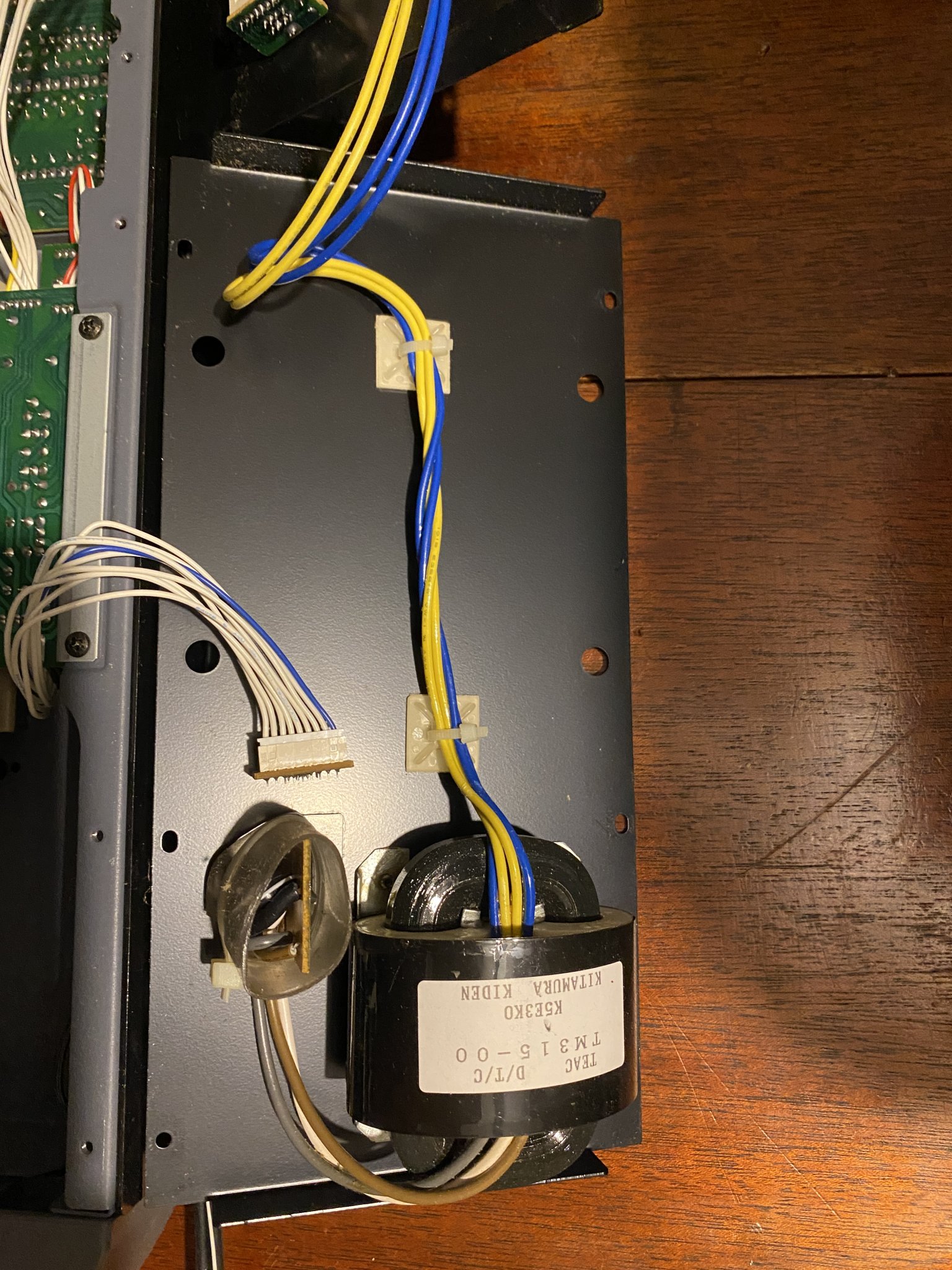

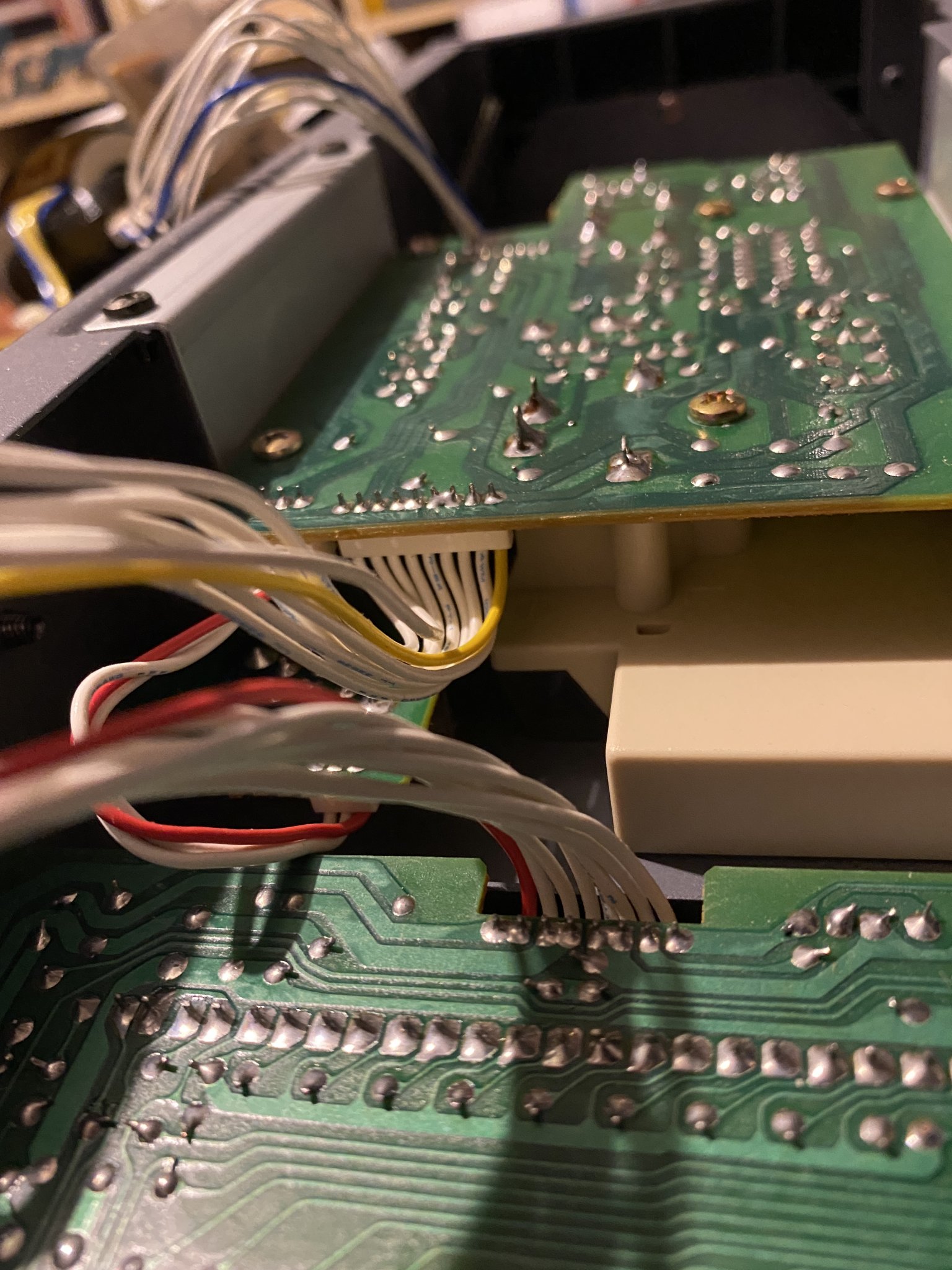

Apologies for delay, life stuff.

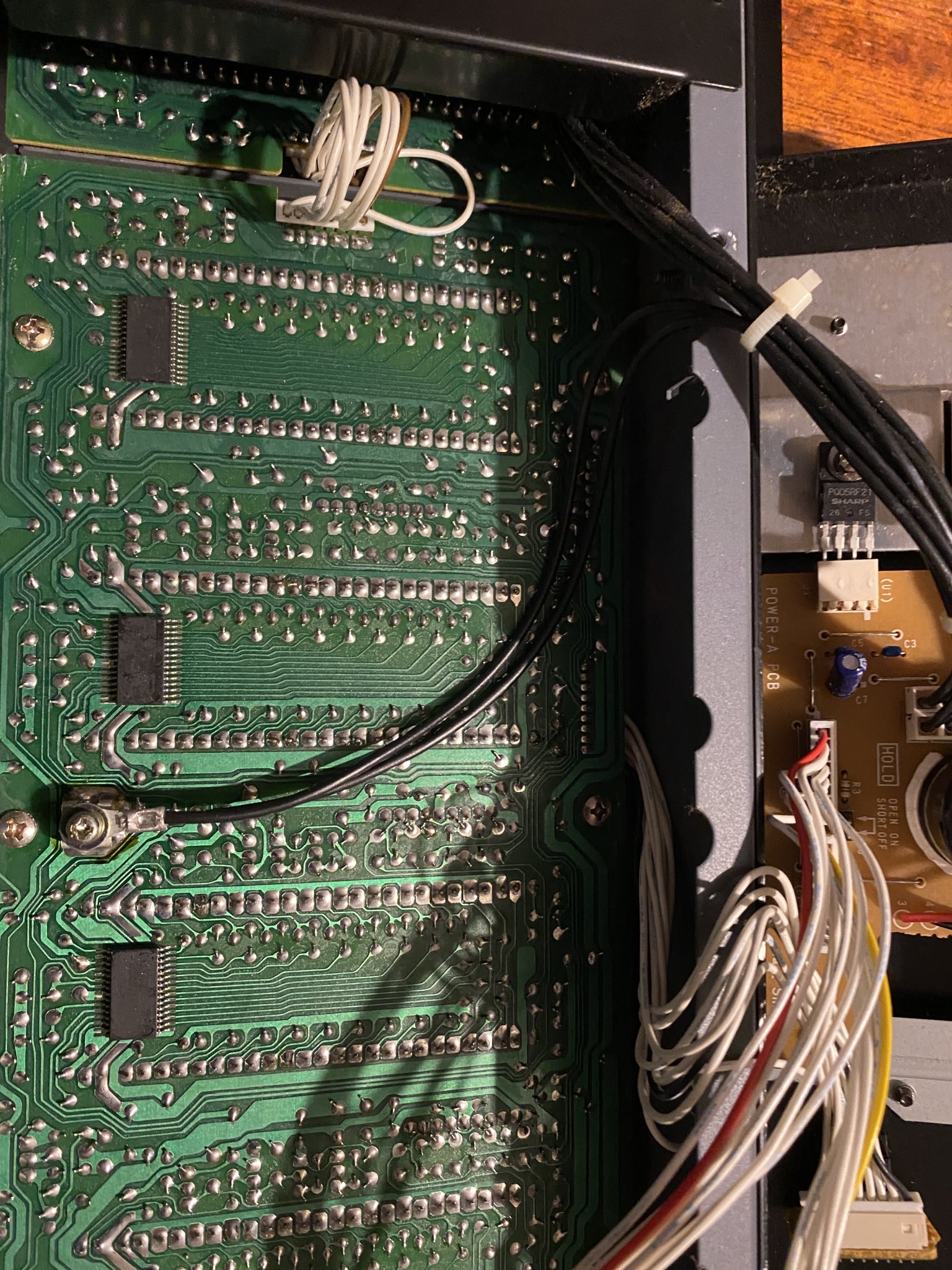

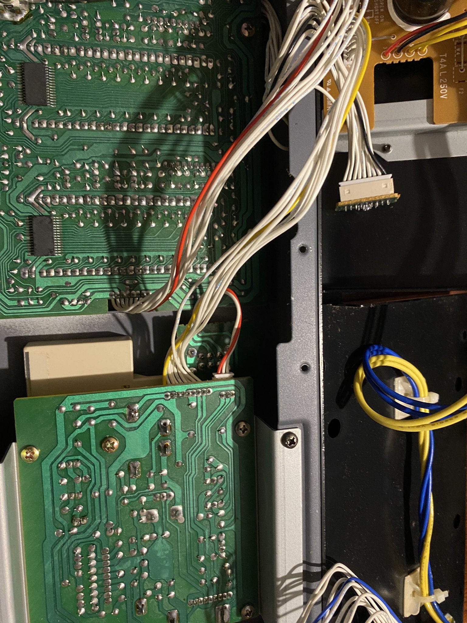

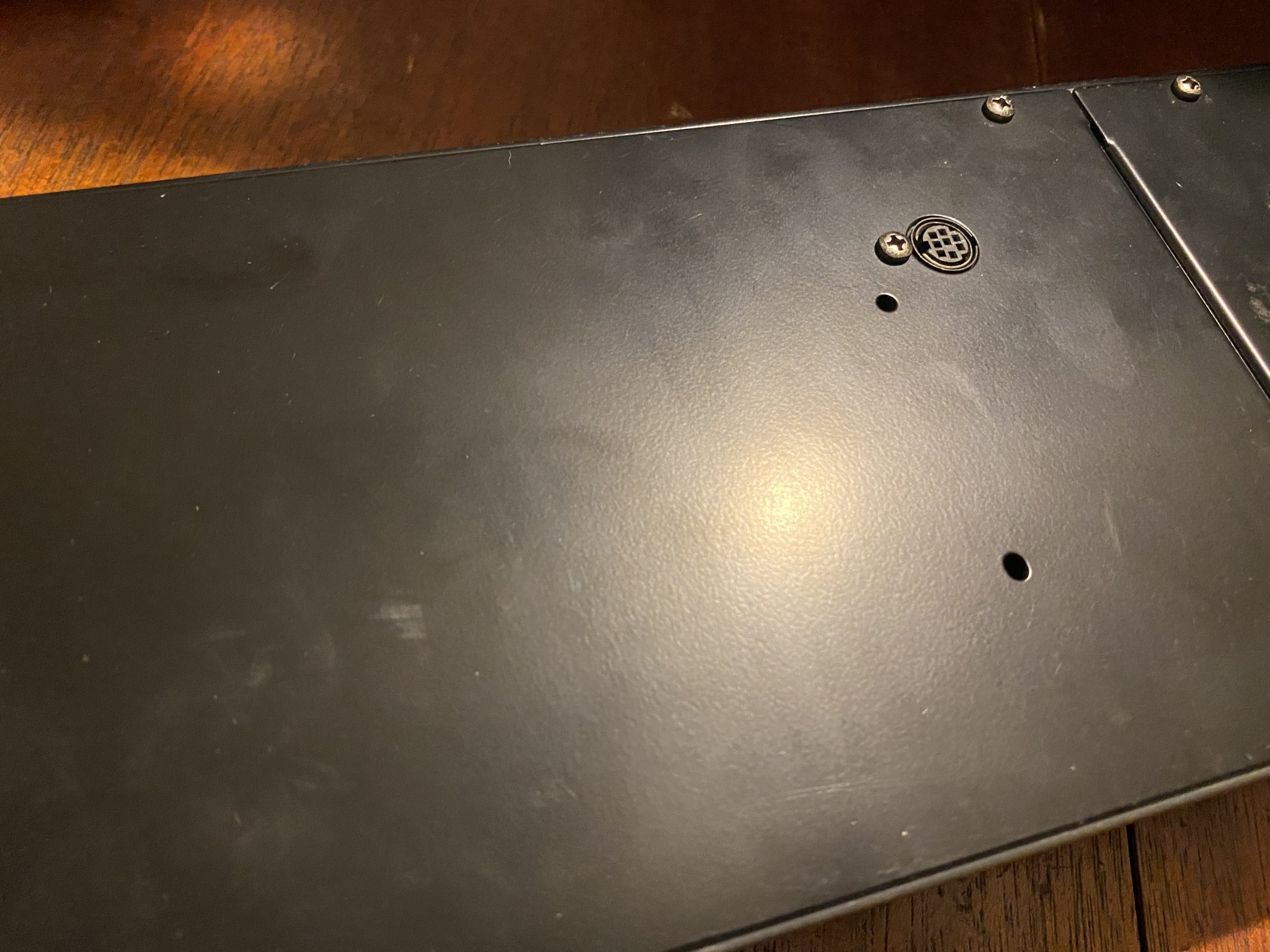

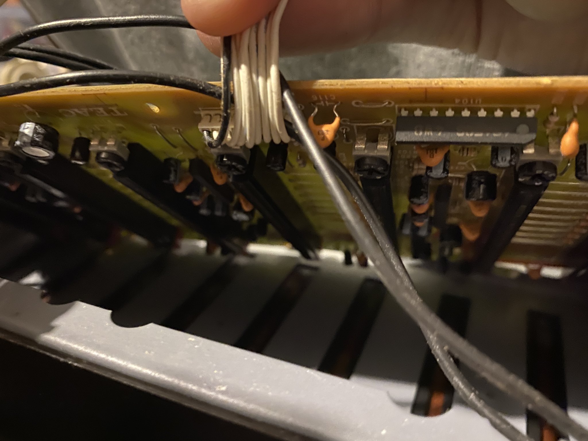

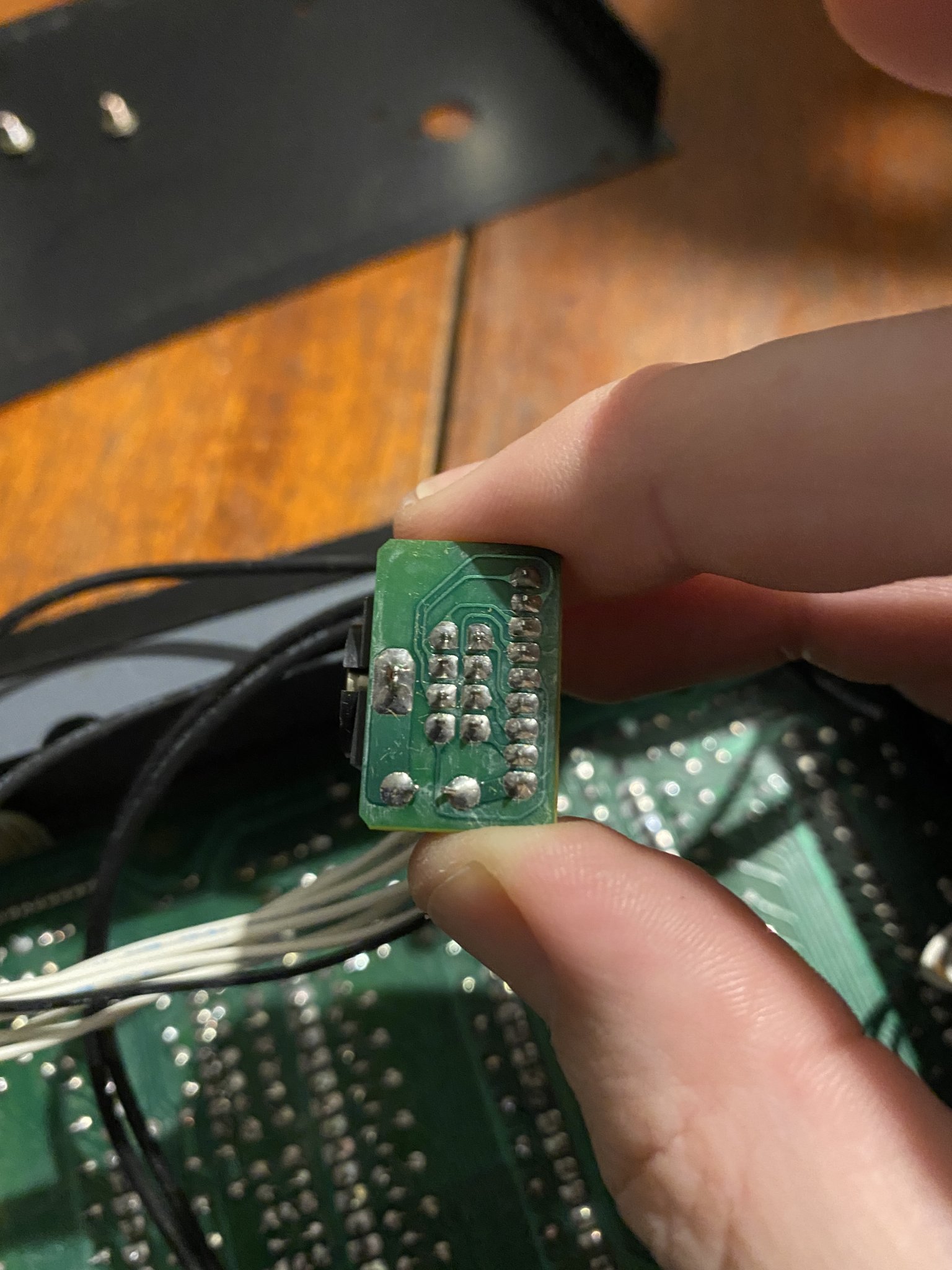

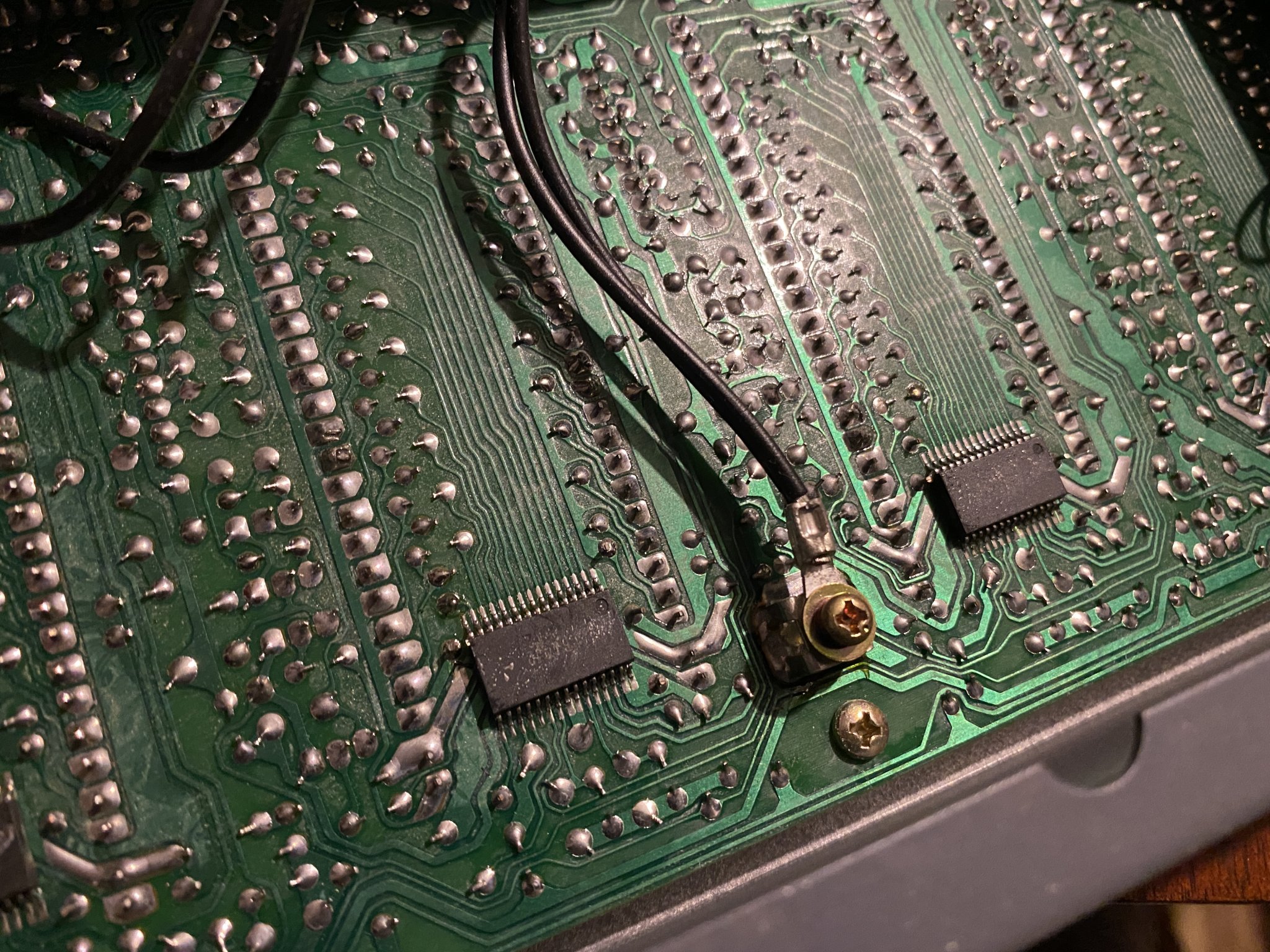

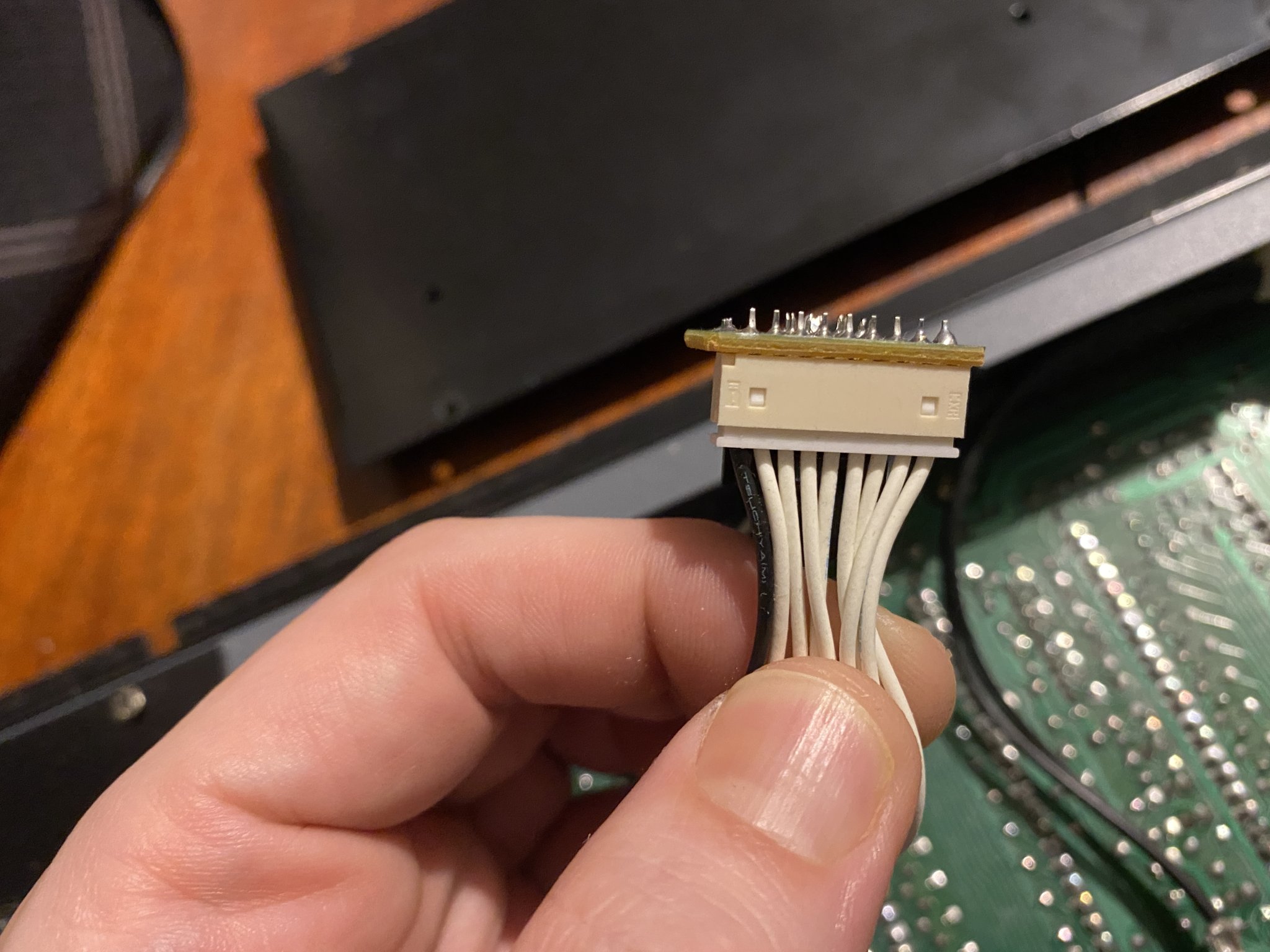

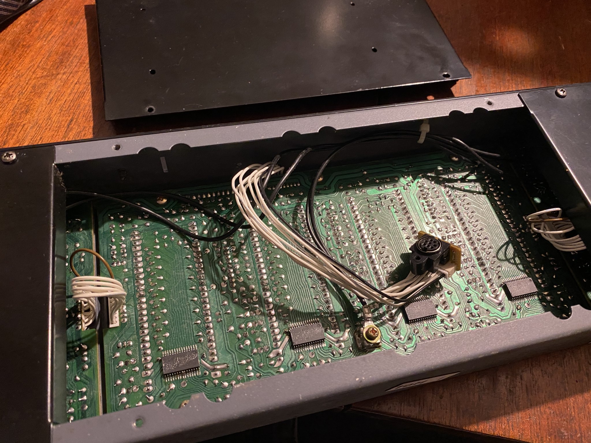

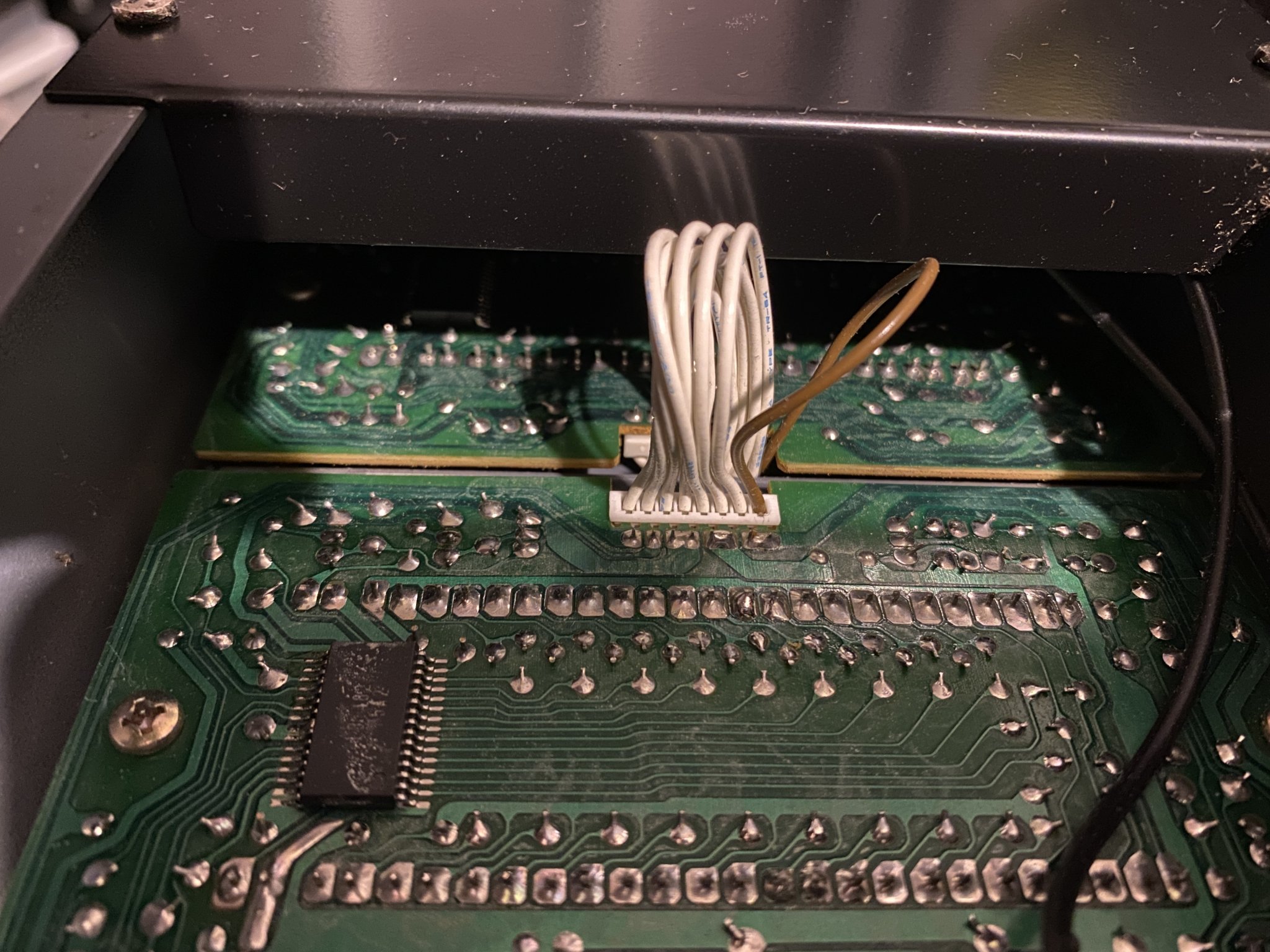

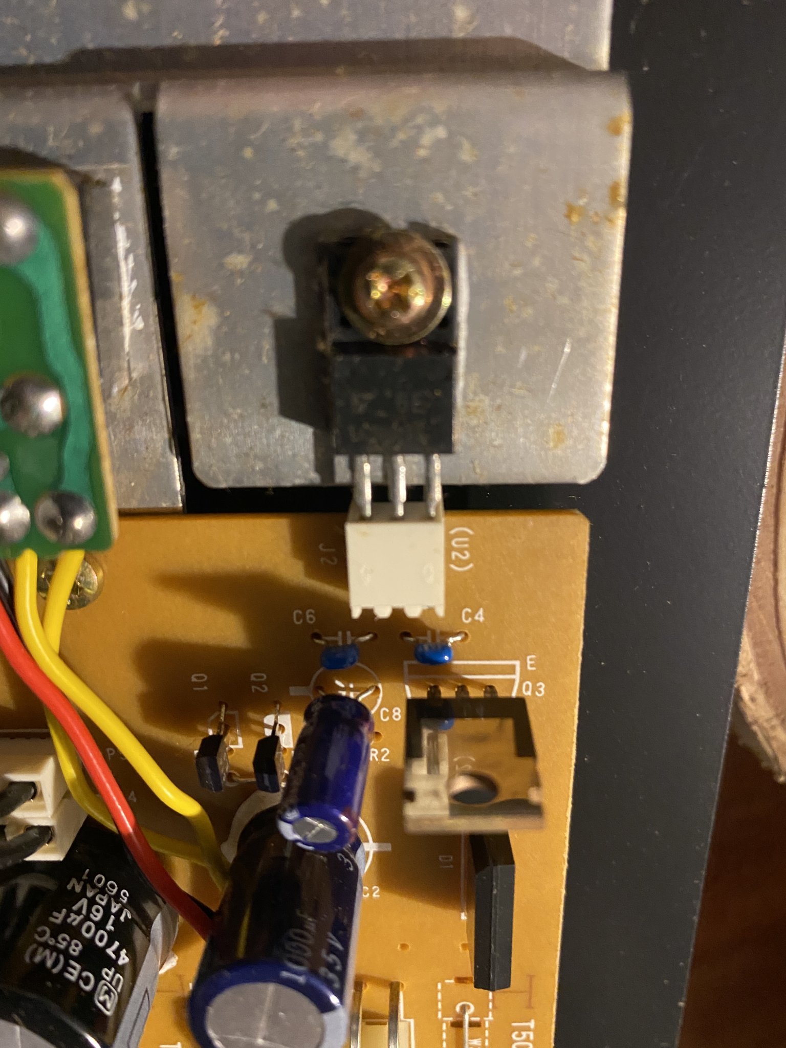

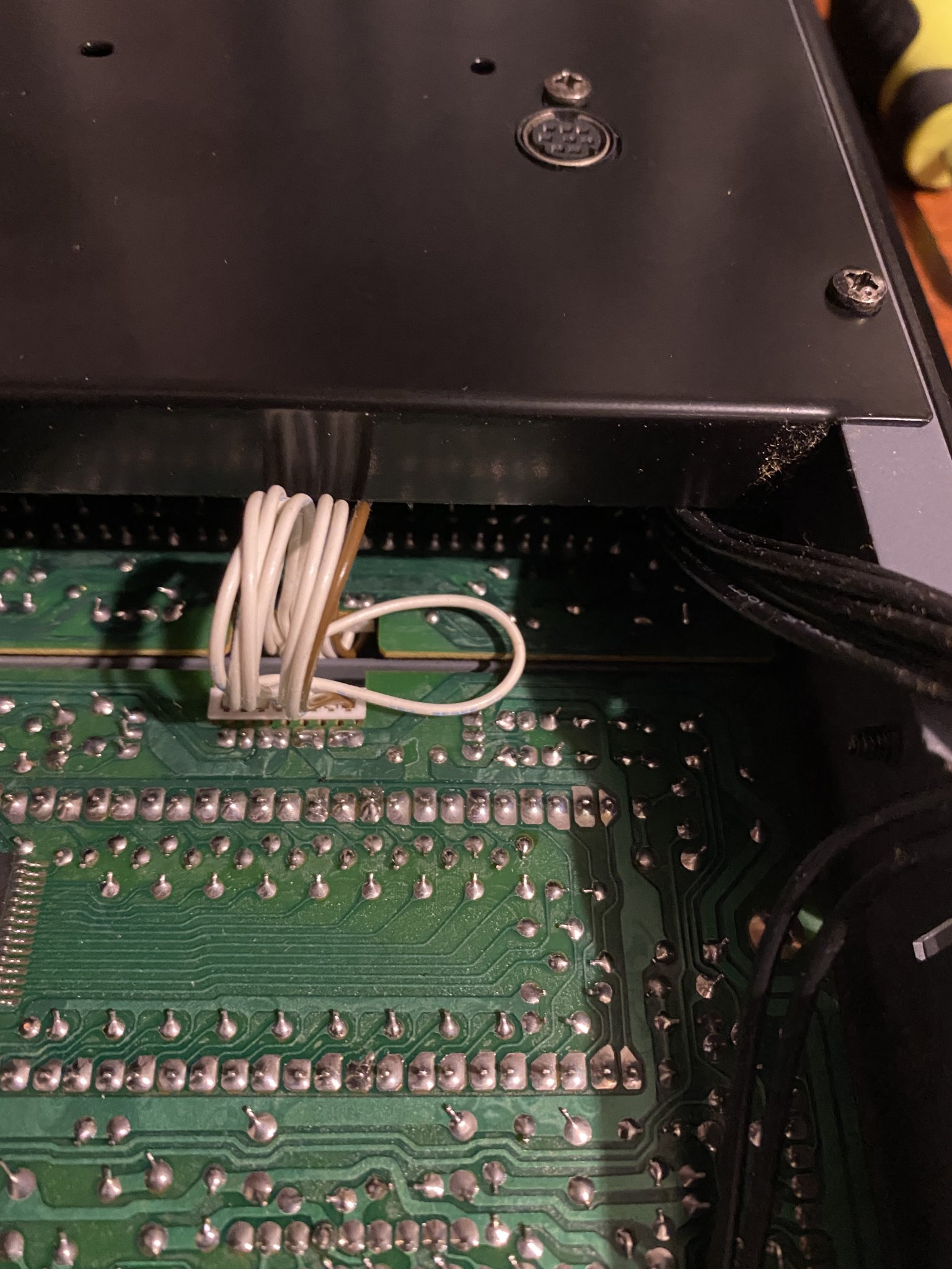

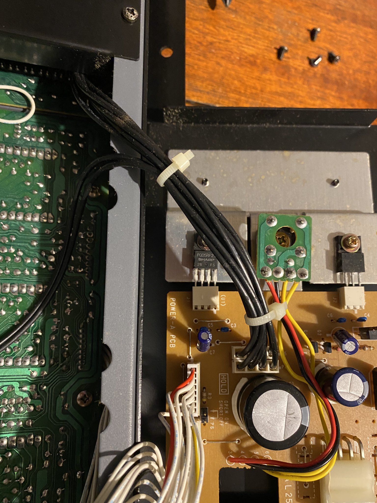

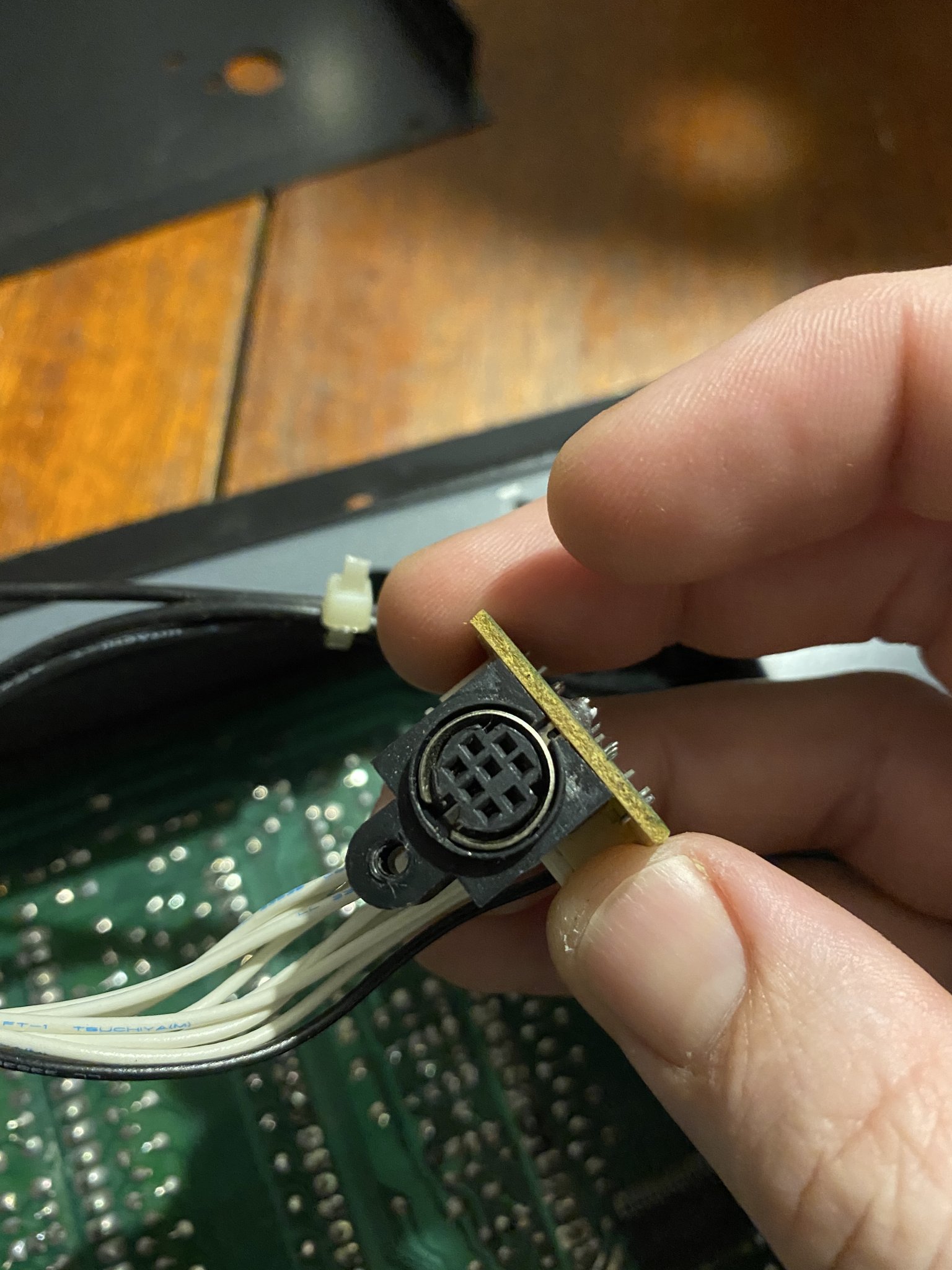

So I had an opportunity to open the strip up this evening, and I’m unsure of how useful these will be. All but one of the wires connected to each DIN connector is white, with one being black. Images attached. Let me know thoughts on how to progress next and I’ll do some more inspection!
Oh, there are 5 DIN connectors, one per meter x 4, and 1 for the two (L and R) VU meters.

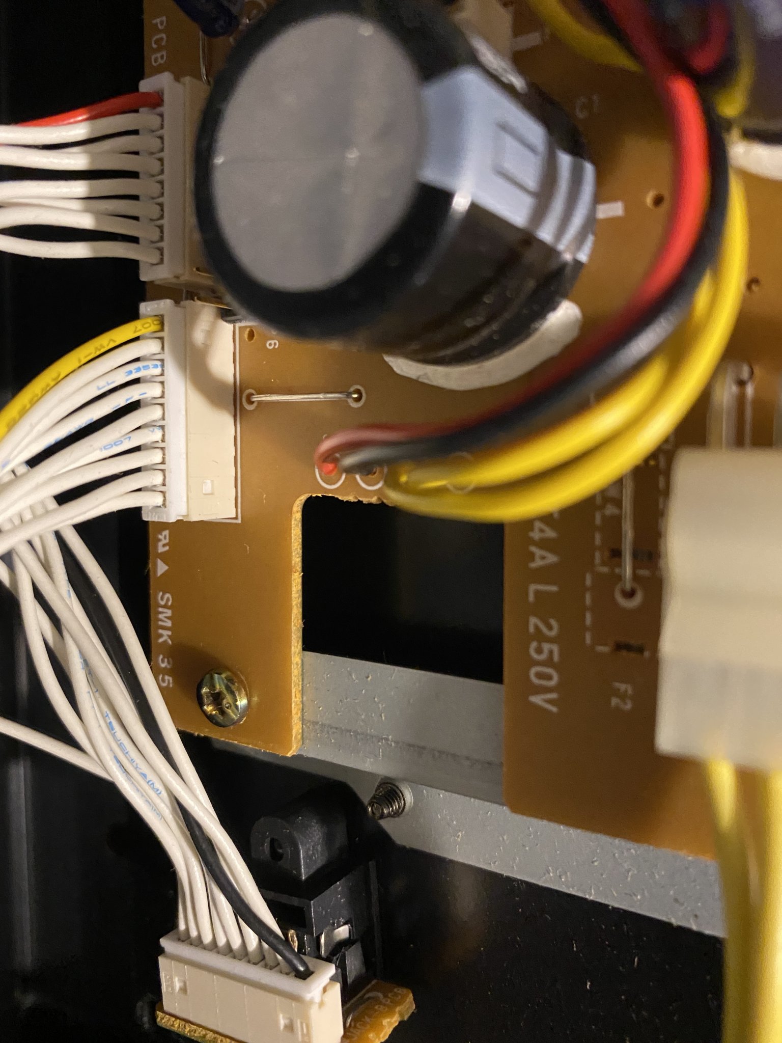

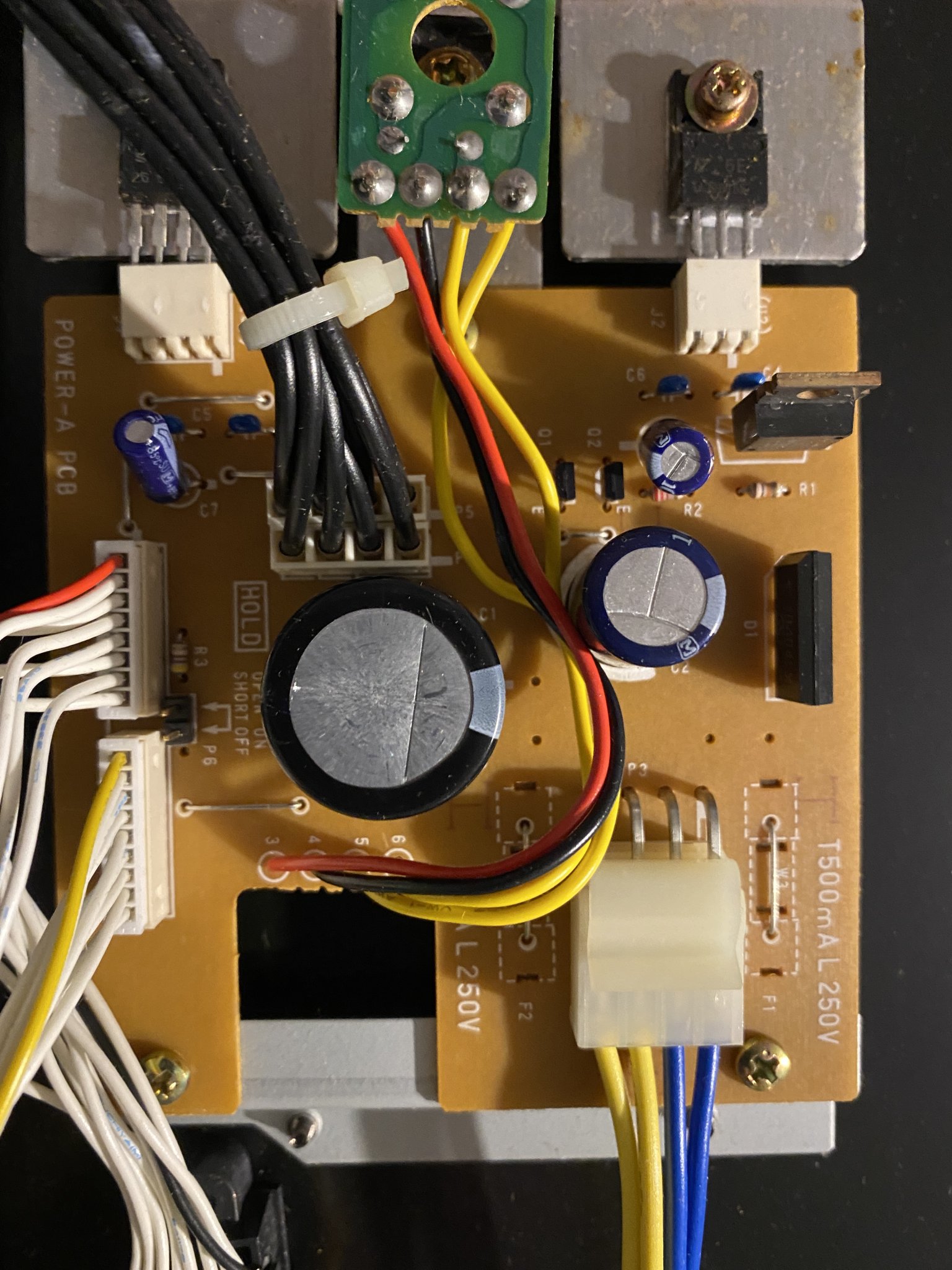

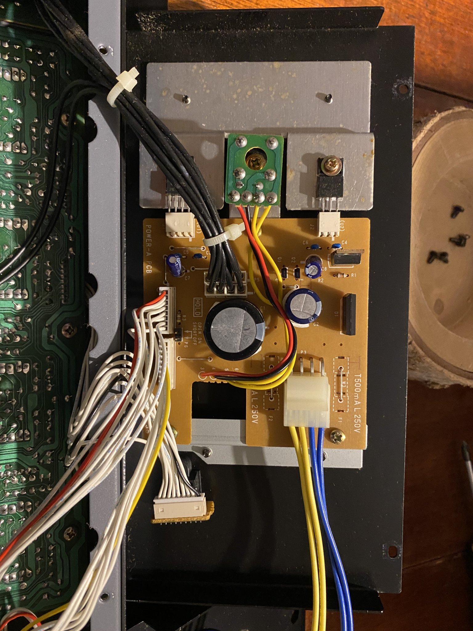

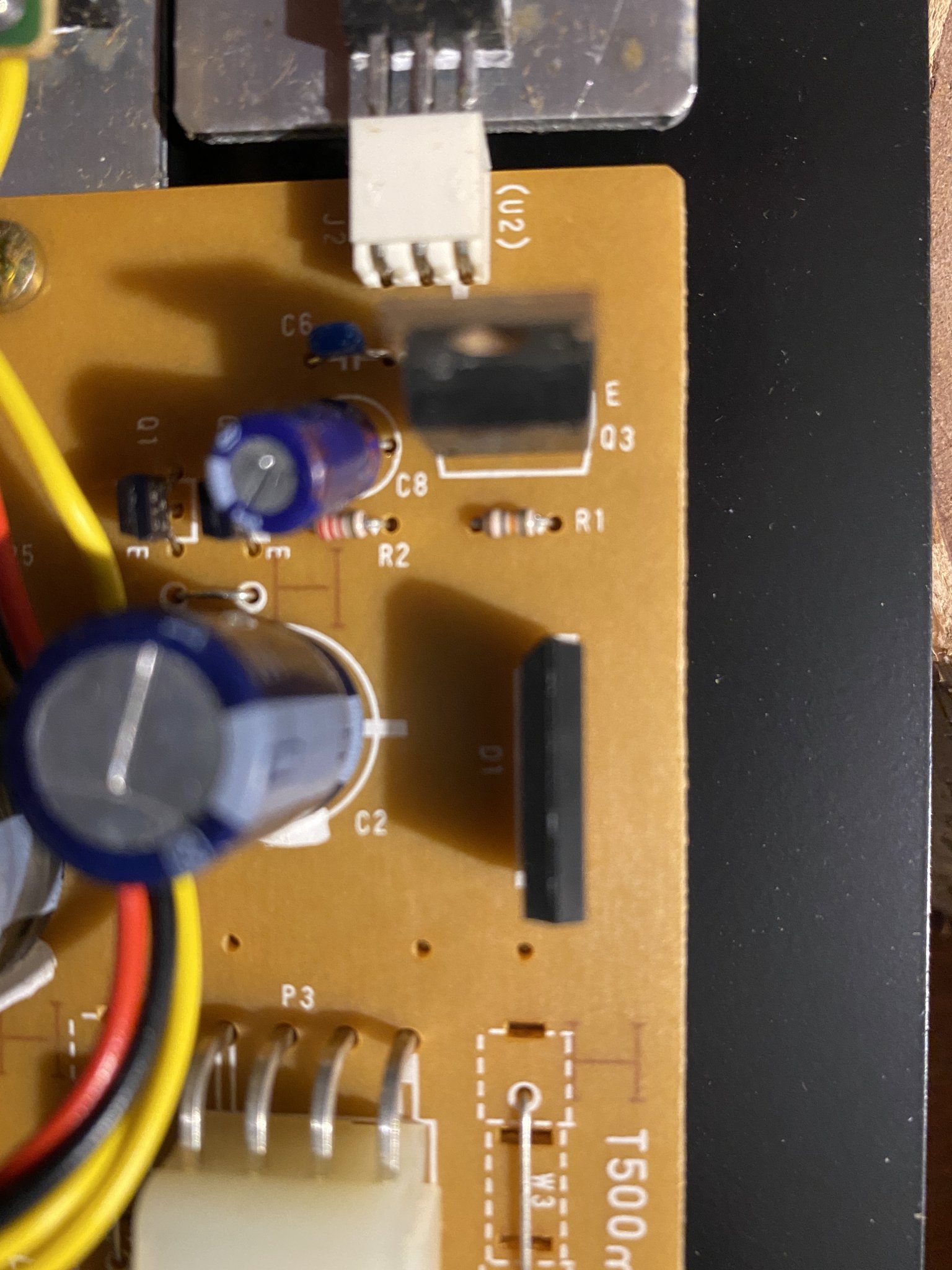

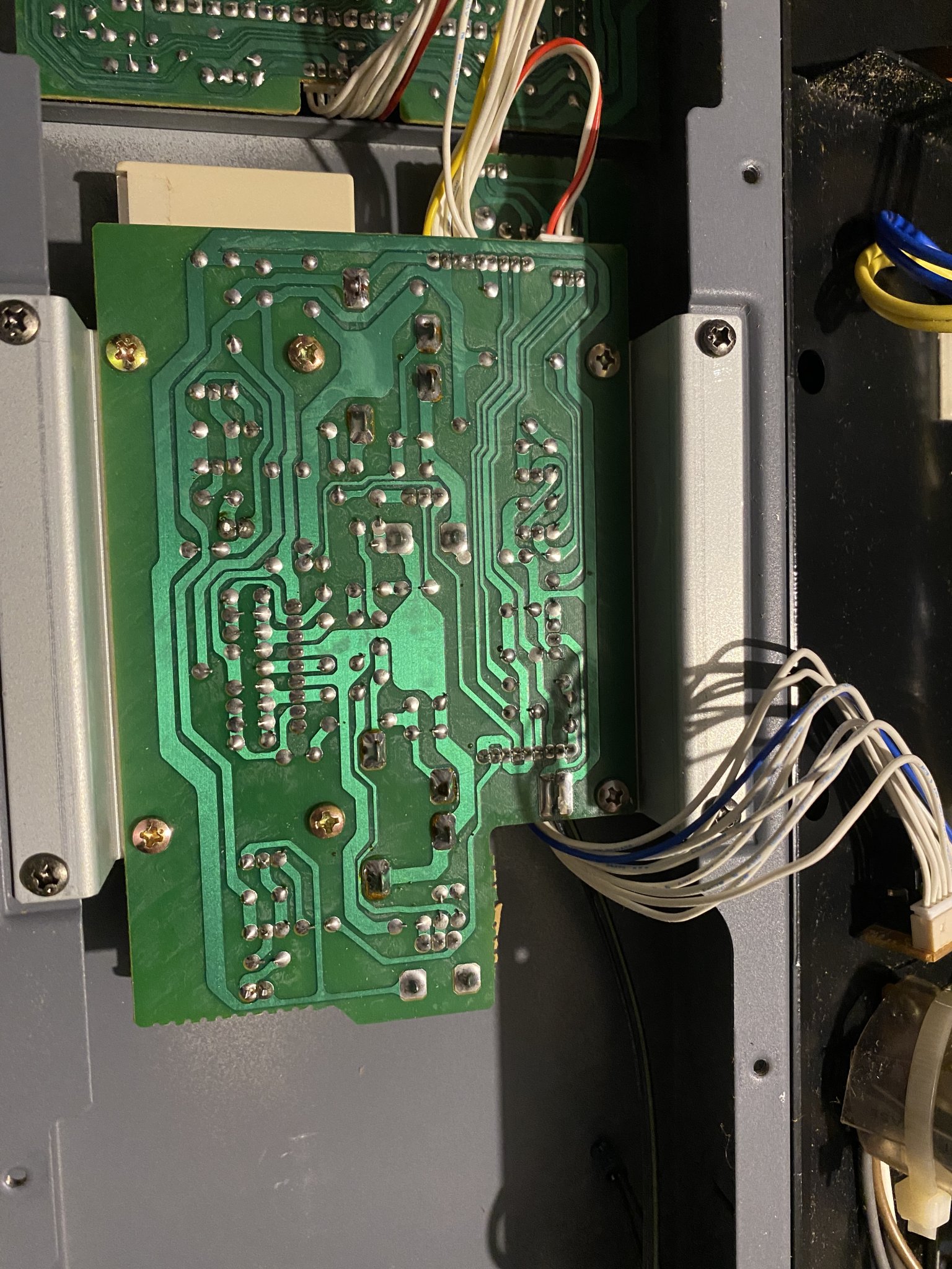

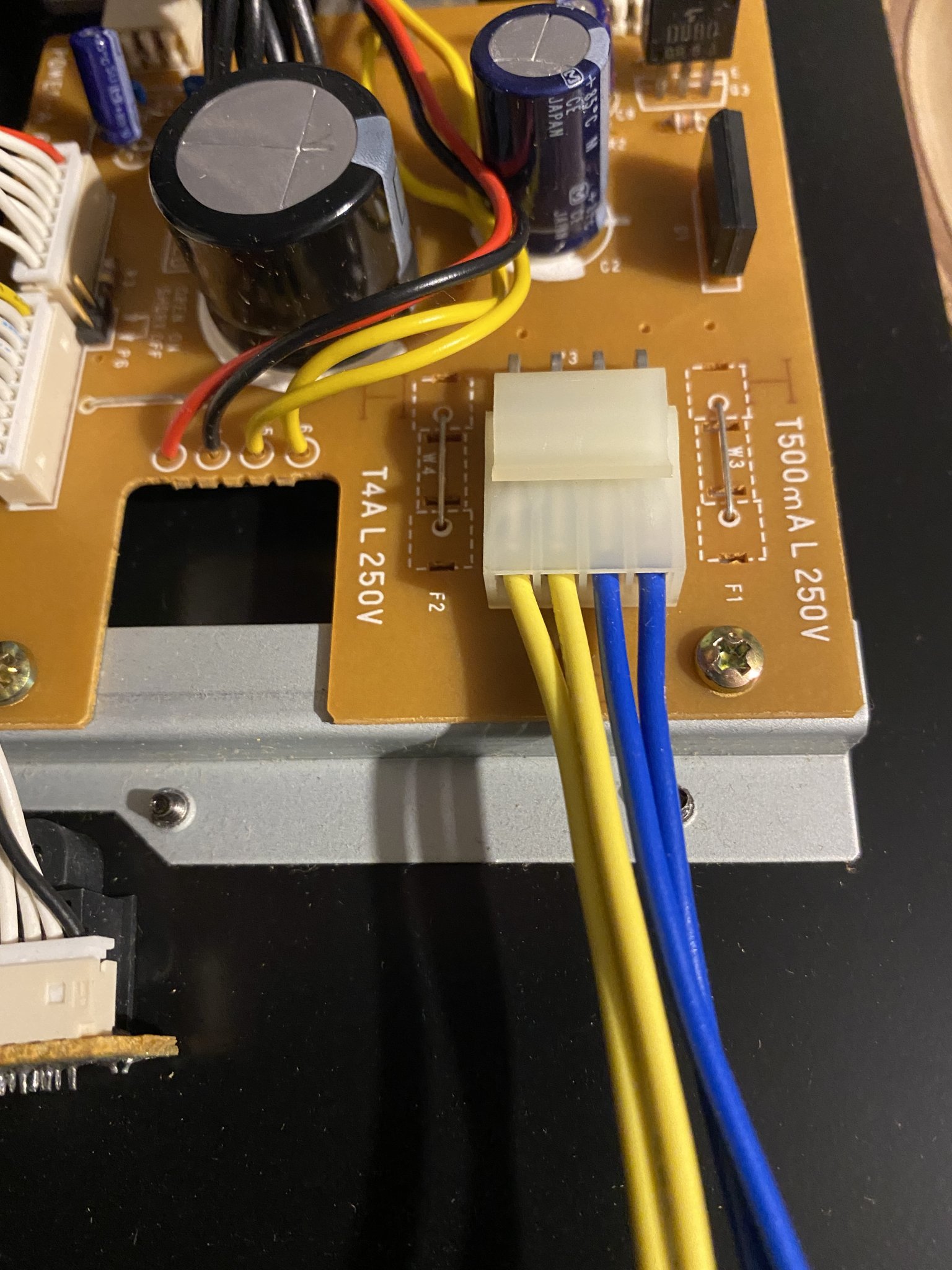

I decided to open the end with the VU meters as well as that’s where the power supply comes in. Turns out there’s also a circuit that sits in section 2 (I guess I’m numbering from power supply/VU meters being 1).

so it appears that each din carries 8 channels and a ground.
just how many din connectors in total (i would assume 4 to cover 32 channels in total)?
just what are the chip numbers?
with it appearing to not power on , have you insured that all connectors are place and no loose components or boards are shorting?
