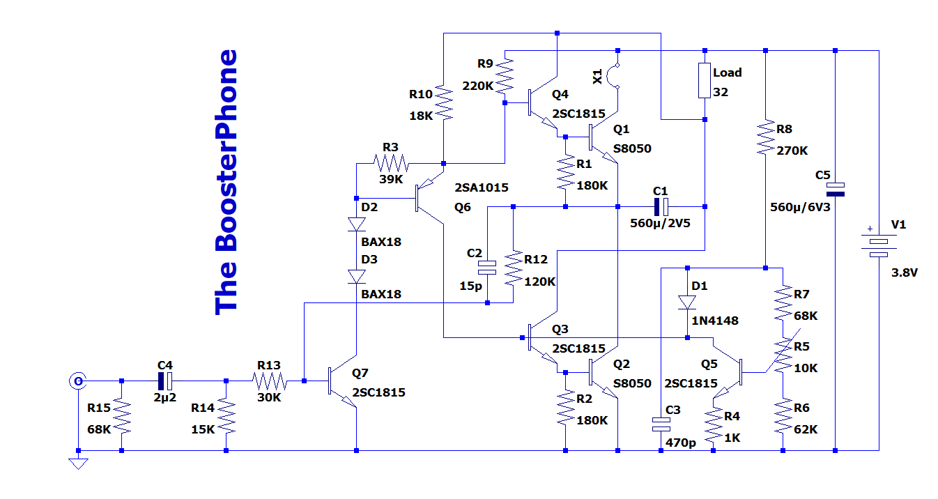

Basically, the BoosterPhone is a 4x gain-block (12dB), having an input impedance of ~10K, and an output impedance of a fraction of an ohm.
It is a class-B amplifier, inspired from the TracerPhone, but beefed-up to 7 transistor, and capable of operating at extremely low quiescent currents (80µA for the OP, 160µA for the whole amplifier) whilst offering a rail-to-rail capability driving a low-impedance load: with a 3.5V supply, it clips at 3.3Vpp.
As usual with my projects, it uses exclusively the most common, jelly-bean type transistors: 2SC1815 and 2SA1015 for the signal part, and S8050 for the OP, all from the cheapest Chinese sources.
The output configuration is circlo-like, and uses same sex transistors.
The nominal supply voltage can be 3.5V to 4V, making it compatible with 3 NiMh cells, or a single Li-ion cell, which I opted for. I also included a BMS suite for the Lithium, to take care of the charging and voltage monitoring.
This is the schematic of the amplifier:

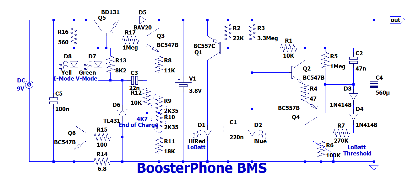

Do not be too impatient, here it is:
The charging section has all the features to safely charge a Li-Ion cell, since the consequences of an inadequate charging could be catastrophic.
The discharge monitoring is simplified, it does not cut off the supply, it just flashes a red LED when the threshold limit is reached. Because of the very low current drain, the battery lasts for thousands of hours, meaning you have plenty of time to react: weeks at least. Even if you don't react, you will simply hurt the capacity of the cell.

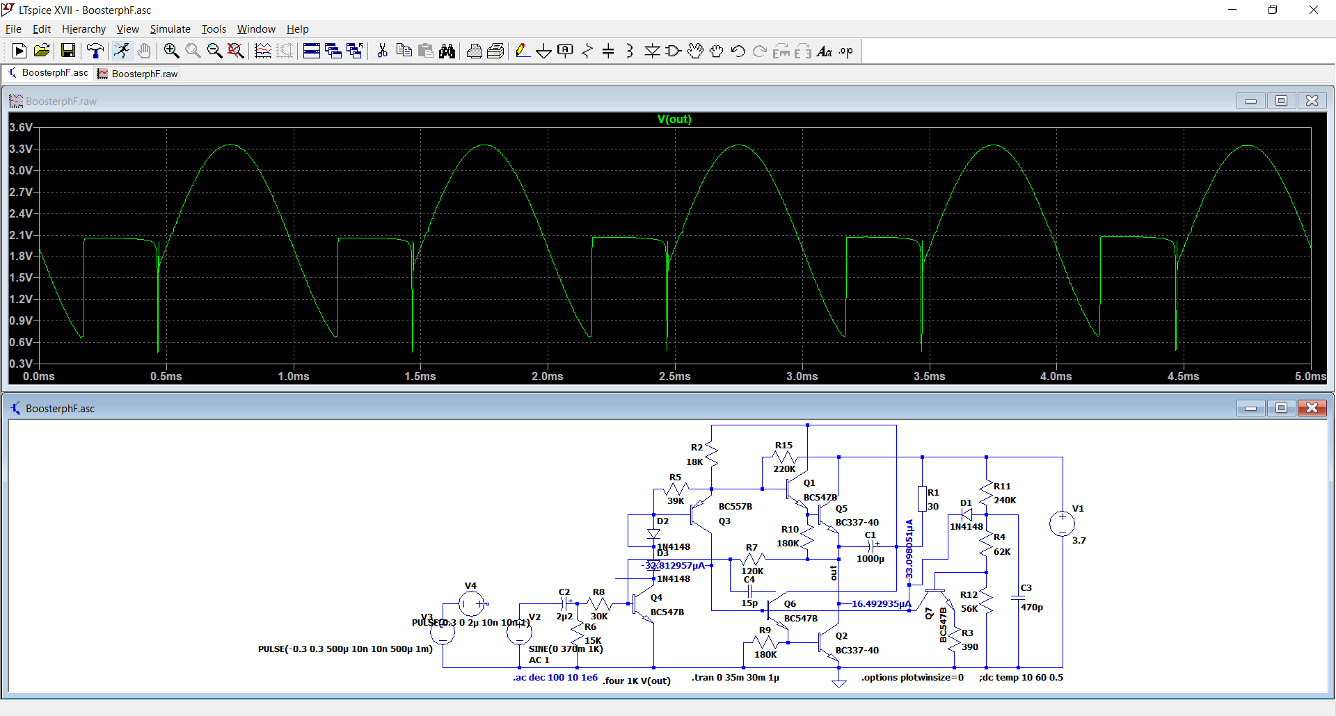

-The peculiar totem-pole configuration of the output makes it susceptible to latchup when it clips on the negative side: the phase-shifter driver/becomes saturated and the input transistor steals all the drive current from the OP, making it go tristate, which is extremely violent and requires countermeasures: I have opted for D2 and D3, but other methods are also usable.
This sim shows the phenomenon and its violence; the reality is exactly identical:

Here is a description of the amplifier section. I repost the schematic for an easy reference:
Q7 is the input stage and the VAS. D2 and D3 limit the negative swing, to avoid saturating Q6 and the latching-up of the OP stage. Ordinary 1N4148's also work there, but their forward drop is collectively a few hundreds of mV higher than strictly required, leading to an output swing curtailed by 300mV. Not a lot, but with a 3~4V supply, every mV counts. BAX18 have a higher conductance and optimum drop.
Many other types would be suitable. If Vf is too low, the latchup will manifest itself.
Q6 is the phase-splitter, steering the drive current to the suitable output transistor.
With this topology, the current derived by Q6 would normally be ~half the drive current provided by R18, and most of it would be dumped into a B-E resistor; the same would happen with the upper transistor.
Here, this textbook approach would be wasteful and difficult to compensate against temperature and supply voltage variations, which is why I used an alternative method: there are no B-E resistors, and Q5 shunts the quasi-totality of the current sent by Q6, and Q6 itself takes almost the totality of the current provided by R18.
The tiny remainder serves to bias the OP's under quiescent conditions. The symmetry is respected, since both B-E impedances are now ~infinity, and the quiescent behaviour can be controlled by R4 and the adjustable base divider. Many combinations result in the same CCS current, but the voltage and temperature behaviour can be very different. With a suitable selection, it is possible to compensate almost perfectly the temperature or voltage variation, but not at the same time: some tradeoffs are required
A problem remains: for the negative swing, Q6 needs to send more current into the lower half of the PP, but it already sends all the current it has available, save the quiescent base current of Q4, which is insufficient. The bootstrap arrangement is not a perfect CCS, and leaks some additional current too, but it remains marginal.
R9 is added to provide the 10µA or so required to properly drive the lower half.
The VAS loading resistor is returned to the boostrapped voltage to maximise the output swing.
The OP stage uses darlingtons, because the drive current required to reach the peak output current would be incompatible with the low quiescent power requirement.
Unfortunately, darlingtons suffer from a Vcesat>Vbe, which is unacceptable for a low-voltage amplifier. The workaround is to also tie the collectors of the drivers to the boostrapped voltage.
Lots of components return to the bootstrapped voltage, but the total current doesn't exceed a few tens of µA which has no effect on the heaadphones
The compensating CCS works well under static conditions, but when the upper half is active, its voltage collapses completely, leading to artefacts, especially when it needs to wake up again.
To avoid or reduce these Xover artefacts, an antisaturation diode D1 is included. C3 adds a final touch to smooth out the result, which is relatively convincing when you look at the triangle wave I posted earlier.
The quiescent output voltage is determined by the Vbe of Q7 and the resistors R12 to 14, forming a Vbe multiplier. It is not optimal, as it doesn't track the supply voltage, but improving on that would add complications.
The jumper can be used to adjust the quiescent current. I have used 80µA, but any other value could be chosen: the higher the current, the better the linearity, but the downside is a reduced autonomy.

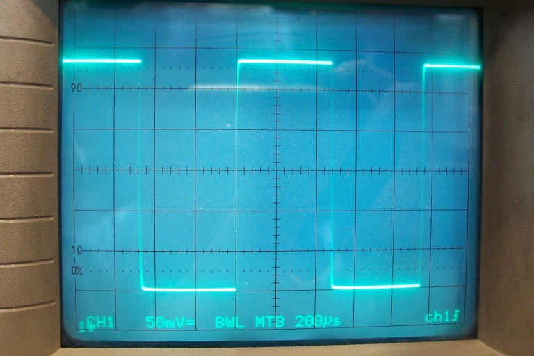

Here are some more oscillograms.
The first is a 1kHz squarewave:

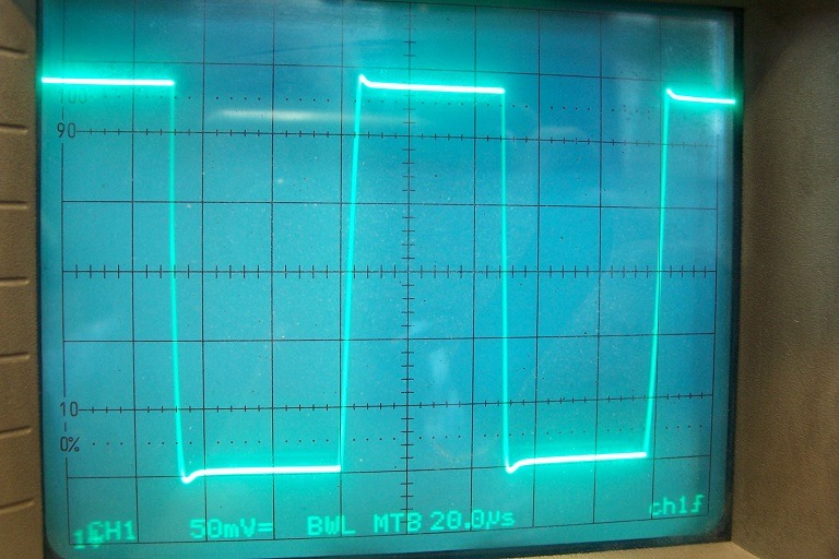

This one is a 10kHz squarewave:

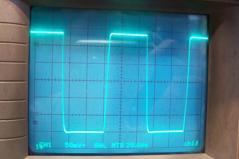

Now, 10kHz without the feedback capacitor:
10kHz with a 2.7pF feedback capacitor:
Here is a short description of the BMS section.
The charging part is just a conventional constant I/V supply based on a TL431. The voltage accuracy needs to be good, to avoid any risk with the lithium cell. The one I used has a maximum voltage of 4.2V, but I adjusted the charger at 4.1V, to be on the safe side and minimize the stress. Other types/chemistries may need slightly different voltages, and the adjustment range should cover them.
The constant-current part is defined by R14 at 100mA. The cell tolerates a much higher current, but I do not need a fast charging, and I wanted to avoid a big supply and heat dissipation with this linear charger.
Each mode is indicated by a dedicated LED.
To prevent the cell from discharging into the charger, D5 and Q3 block any possible reverse flow. Q3 disconnects the measuring resistive divider when the charger is disconnected, as it would consume a non-negligible current compared to the amplifiers.
The low-voltage detection is based on a relaxation oscillator built around Q2 and Q4. On its own, the oscillator can oscillate freely for a wide range of supply voltages, but the blue LED D2 limits the charging voltage of the timing capacitor C1, and if the supply is high enough, it blocks the oscillations.
The discharge pulse is amplified by Q1 which drives the indication LED. The Hfe of the transistor limits the current, the LED has no limiting resistor.
The result is a very visible, short (~1ms) and powerful flash at 1.5Hz, but the average consumption remains very low.
When the circuit is inactive, the consumption is governed by the 3.3 meg resistor, and is also very low.
D3 and D4 compensate the numerous junctions of the circuit and the temperature behaviour of the lithium cell.
I have adjusted the indication at 3.5V, but the cell can tolerate 3.2V without damage

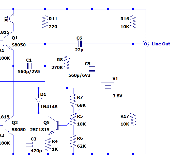

You can use it as a line-level booster too: that was the main goal of Danny, at the origin of this project.
You need a dummy load to simulate the headphones: something between 100ohm and 1K is OK and will greatly improve the linearity. Ideally, you would need to connect the output ground to the + side because the load is referenced there, but if it is not possible (multiple ground interconnections) and if the supply is clean and stiff (like a good rechargeable battery), you can use the - rail too.
This schematic of the output outlines both options. C6 needs to be reversed if you use the +GND option:

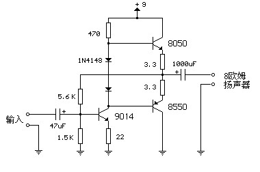

Did not catch this until I was looking at S8050 lately.
Wouldn't this be even simpler ?
(Not mine, from a Chinese site.)
Gain of ~5, 30mA bias, can drive 8 ohms.
And of course can all be changed easily.
For a portable headphone amp project, I have had great experience with MCP73831 to charge Li batteries.
Very simple, and low cost.
And an IC charger has no sonic signature. 🙂
