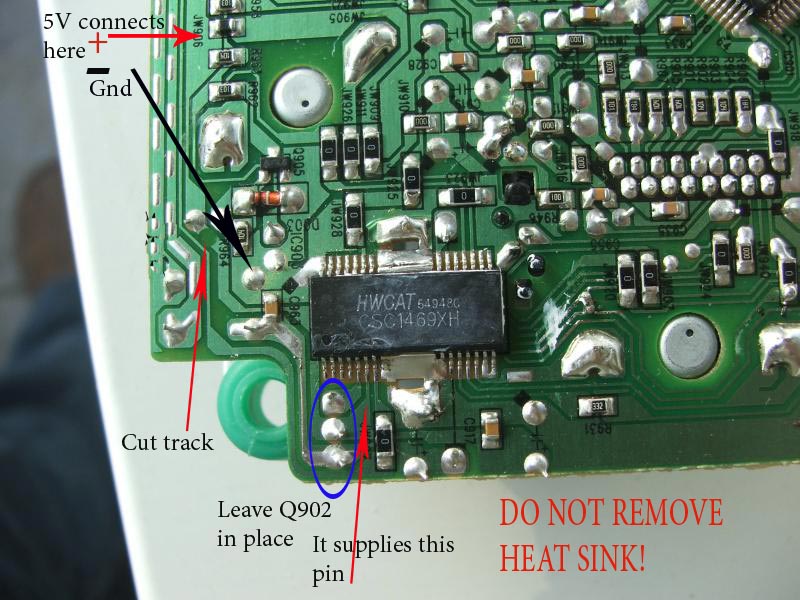

The schematic show external PS. Two wires from PS are connected to the pads where choke was. Since BG FK is hard to find these days, I use BG STD with BG N 4.7uF bypass.
I add two output resistors: 300/100 Dale (you may also consider S102/Caddock) and in place of C916 I instal BG N, either 47/50 or 33/16 depending on availability.

Hi Uncle_leon,
I read from Peter's post that the 5V can be added by tap into the L901 after removing it.
Does it also mean you have to put 2 jumper wire there to reconnect the trace line? What is the best way of feeding a separated regulated 5V to the the Shigaclone?
When removing L901, connect the voltage and ground directly to L901 secondary pads, no need for any jumpers.
Best way to feed separate reg 5V is from a separate transformer.
Attachment shows how to connect external 5V supply.
