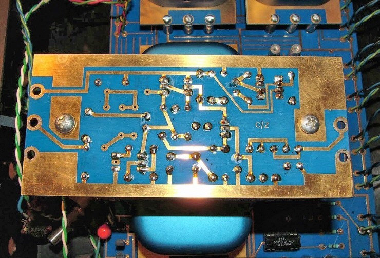

why did you chose to use screws but not the usual board connectors
A long time ago, a young designer (*) made a preamp with modules that sat above the main PCB and secured with bolts that also made the electrical connections as shown here -
We figured that M3 hardware is common enough to find, sturdy, and if it was good enough for that guy working at Threshold way back when, it's a time-tested solution.

If there were a large number of signals communicating back and forth between the daughter board and the mother board, then a connector might have been more advantageous. But the M2x daughterboard has only four I/O terminals -- one fewer than the Threshold NS10 daughter board below. I happen to really like the solidity / ruggedness of bolts + star washers + threadlocker fluid / Loctite (or nail polish), especially when transporting the amplifier. So that's what I lobbied for and that's what we ended up using. Yep, it's a little different. Maybe that's a feature instead of a bug.

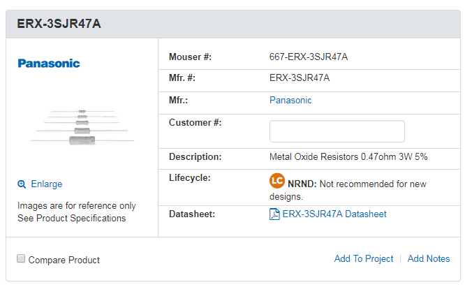

i have used the Panasonic resistors in my Pass clone amps but will try the 0.47 Ohm resistors, but the Xicon metal oxide resistors have somewhat lower ESL (for those worrying about performance above 1MHz).
I bought 50 pieces of Panasonic 0R47 3W resistors back in January, and since then they have become Not Recommended for New Designs. If you look very VERY closely at 6L6's photographs of the amp main boards, you can see these. They are the blue resistors with the M-in-circle (Matsushita) logo of Panasonic, that I sent to him to assemble the Build Guide amplifier. I have found another vendor of 3W 0R47 resistors and listed it in the BOM. Luckily the inductance is not terribly important; remember that many not-designed-by-Nelson-Pass amplifiers have explicit series inductors in the output leg, with 100X greater inductance than a wirewound resistor.
