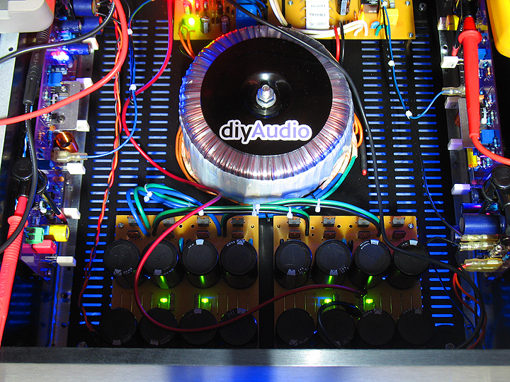

Hi James,
Here's the HB Amp in the 5U chassis with dual PSU and an 800VA toroidal transformer.

Not sure if I should post here or in the BA-3b thread....I would love to use the 5U for a BA-3b monoblock with either the SE or PP output. I see that the chassis is pre-drilled for the output boards. I am wondering about the ability to dissipate the heat. I see from the first post that the chassis is 0.28C/W. Is that per Chassis or per heatsink?
Just above the spec they describe the big chassis as:
"A 5U, 400mm deep “Big *** Chassis” with towering walls of heatsinking to cool demanding class A projects such as F-5 Turbos, Burning Amps, multichannel amps for biamping and home theater, and amps with elaborate power supplies and other components that that require a lot of internal space"
The Rth = Tr/Ph = 25C/300W = .083C/W. The BA articles generally state that a stereo chassis may draw as much as 300W from the wall.

Iirc, the spec was per heatsink, per side. But to be honest, I am not quite sure of the thermal resistance rating. All I can tell you right now is that the 5U's heatsinks are, aside from being big and all that, ribbed to increase surface area. It's always a good sign for use with demanding systems.
5U for BA-3b
Upon further inspection....it seems the each heat sink is .28C/W. I took the rough dimensions an plugged them into Rod Elliott's heat-sink calculator and they came out at about that Rth.
So...300/4 = 75W per sink. 75W x .28C/W = 21 C over ambient. Should be OK.

and then apply the deltaT De-rating Factor (DF)
For a deltaT of 21Cdegrees expect the de-rating to be around 1.3 **
Temp rise = Pq * Rth s-a * DF = 75 * 0.28 * 1.3 ~ 27Cdegrees.
** The De-rating Factor should be given by the manufacturer. They usually have a datasheet showing how to apply it.
