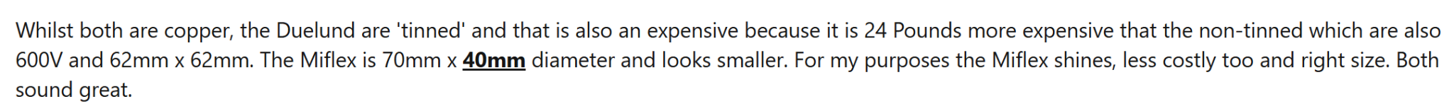

So I preordered my 1.8uF Duelund 100v tinned copper caps from Parts Connexion. I played with a Miflex copper cap on an output position of a DAC that I have and have been pleasantly surprised as to how it sounds. In this position I previously had a REL cap... Which are known to be very good. So I am excited to see what happens with the the Duelunds in the tweeter position on the Elsinores.
The Miflex caps I tried on the DAC are built very solid. The outer shell is extremely dense as is the filling. They are very heavy for their size. the pictures do not do them justice. Once you hold them and see them in person, you understand why they are not cheap... They are like pieces of jewlry compared to your typical film capacitor. I assume the Duelunds are the same way.
They do take a while to break in... On the DAC, at first they sounded pretty good. Miflex notes about 150 hour breakin time which seems crazy. I have been able to go back and forth listening to them and the REL caps. After about 20 hours, the sound has really opened up and things are working great. The Miflex are much more refined with a more liquid mid range and a clearer top end. The REL Caps are less liquid with more emphesis on the top end giving the perception of detail... But the Miflex actually have more detail. I have played with a lot of film caps and the differences in sound tends to be very small. However, the copper caps just do something different.
Parts Connexion is ordering the 100v Duelund caps for the Elsinore project. They also talked to Frederick (Founder of Duelund) who heavily suggested the 100v over the 600v. This makes sense as the 100v is both smaller and cheaper...
Here are the sizes for the Duelund Caps:
600v Ø62xH62mm
100v Ø39mmxH62mm
And here is Joe's post talking about the size and fitment:
Joe had mentioned that liked the Duelund but that they were too large to fit on the boards. It looks like since we are going for the 100v, we should be able to have our cake and eat it too. I didn't think to ask if they are radial or axial but never-the-less, even if they are radial with a little creativity, we can still mount them to the PCB.

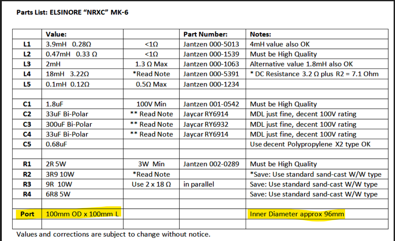

Question. I kept seeing 90mm for the port diameter on the port size on the Elsinores. Well, A BOM that I had for the NRXC said 100mm by 100mm. I am wanting to know if I should make a plug that will accomodate the 90mm smaller port. I used a 4" PVC made slightly longer to accomodate for the slightly larger than 100mm diameter. I thought it was odd that the 100mm port just barely fit between the two verticle back braces. I had to finess it in quite a bit.
I can go pick up a couple of these:
https://www.homedepot.com/p/Charlot...-Hub-Repair-Coupling-PVC001301000HD/203393300

Question. I kept seeing 90mm for the port diameter on the port size on the Elsinores...

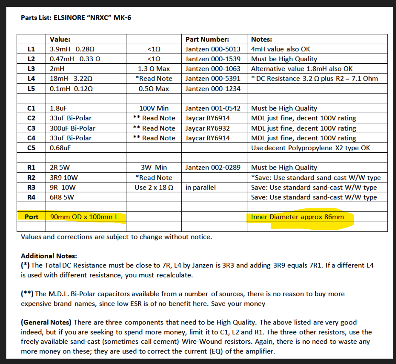

You have spotted a typo, in both instances it should be 86mm and not 96mm. And yes, if a bit larger diameter port is used, the proportionally increase the length.
But on the matter of ports, the PVC pipes available here are 90mm OD and around 86-87mm ID. Over time I have decided to use 100mm length for that ID for all NRX, MFC and ULD versions of the Elsinores. So some of you may have seen 75-80mm elsewhere, but you need not to worry about it.
But I owe an explanation and I knew this it would eventually come up and that I would have to deal with it.
This is also related to something unusual about the Elsinore box design, that is that normally you pick the driver and then design a box for it. A driver is either acceptable or it is not.
The Elsinores started out the normal way too with the original Peerless drivers chosen way back in 2004 and then the box design came from that.
Yes, the Elsinore Project is now more than twenty years old, but the first actual working design appeared early 2006 with Peerless drivers. It got its premiere on diyaudio.com February 2007. Then something happened, new drivers were considered on the basis if they would work with the already existing box design? That was different, but it worked, just find the drivers and we could redesign accordingly. Would they all have the exact same alignment? The answer would be no, so there are differences, subtle as they may be.
Now we come to the fact that the driver Qts, and particularly the electrical Qes, which in turn is in parallel with the mechanical Qms of the driver. But these in turn are in parallel to the box QL (yes, all four are in parallel), and we get a value is far lower than normally lined enclosure, but the Elsinores use a large amount of fill and that bring the QL below 3. Normal is typically 7 and can be as high as 15. This sub 3 (maybe getting close to 2) is common with all the drivers used. It is also the key to what drivers will work even if the don't have the exact same Q damping.
The use of the Purifi ULD drivers as they are a bit more damped than the other SB and Peerless drivers. After much thought, I decided to go for it.
The question was, with a bit more heavily damped drivers like the ULD version, these might benefit from a higher box tuning by reducing the length of the port which is 90mm OD and 86mm ID (inner diameter). But over time, looking further into it, going from a length of 75mm and 100mm the difference was very slight indeed in the 50-100Hz range and this was my greatest worry; it proved largely unfounded. But the ULD higher damping is slightly less curtailed below 50 Hertz, but not much. This has been confirmed by listening by those who have built both MFC (or NRX) and ULD versions.
Bottom line, decreasing the length of the port to 75-80mm did not prove to have any real benefit, so I have stuck with 100mm with all drivers from now on. But if you have already built boxes with slightly short port, I would not lose any sleep over it.
Any comments?

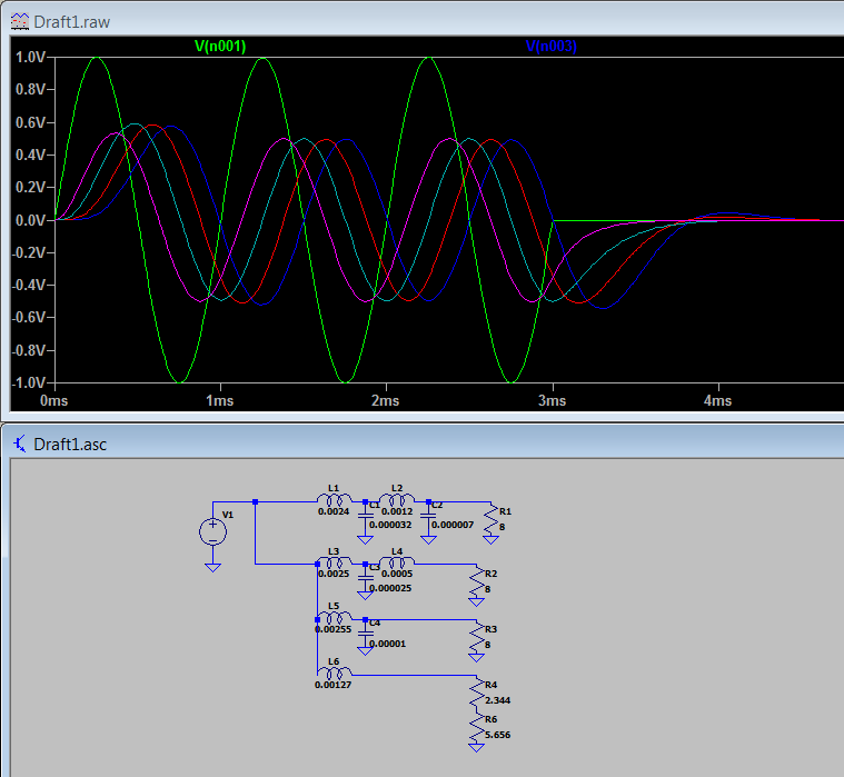

Q is how a system responds to energy input. In speaker enclosures, it refers to how much the system "rings" or oscillates before the energy dissipates. In other words how the system dampens these behaviors.
Just being curious, did you get this info or is it your own summation? Reason I ask is the "rings" part and that there is some kind of uncontrolled oscillations, this is something I would dispute. Damping and Q is quite real, no doubt about it. But ringing? I have seen bass drivers that are poorly designed, especially the suspension, and there I have seen some really bad behaviour that looks like "doubling" and yet the Q of the driver was suitably low. They were just bad drivers.
So what do you mean that they are parallel?
For example, if there are two that have a Q=1 then becomes Q=0.5 or half.
In Thiele-Small Parameter, the Qts is is combining in parallel the electrical Qes and the mechanical (as in suspension) Qms:
If Qes is 0.4 and Qms is 3, then do the calculation and you get total Q or Qts=0.353 and similarly with the box, the fill is also additional damping in parallel. This is of course a relatively simple explanation. But anybody here is welcome to air their views.
Yes, it does affect the frequency response. But then so does a lot of things.
I've seen that suggested, but ringing is a normal part of resonance and is subject to damping, usually under our control.Reason I ask is the "rings" part and that there is some kind of uncontrolled oscillations,
Not saying that ringing can't happen. Oh well, maybe we have a different understanding of what ringing in loudspeakers is. At LF, if the right current turns up at the right frequency, the shape of the response can be controlled that way, irrespective of source impedance. It won't be ringing, that's for sure. But does a Q of 0.707 ring less than a Q of 1 - I'd be interested in your answer on that one.
No, just ring was a term that I had read a while back. I think this was more in regards to talking about physics in general. Not specifically speakers.
Alright, that makes sense. I get it now. Thanks!
Fair enough. Ringing is a real thing all right, but the Elsinores don't ring. That would be gross LF distortion. But the Q absolutely affects the FR and once measured, pick a frequency, any change in SPL obeys the current through the voice coil. Using this idea you can get a sealed box using a current source and dial in any Q you like - not theoretical, been able to confirm that. The Elsinores are vented but above 30Hz approx the idea of controlling the current is applied to make the source impedance effectively cancelled out. I am still wondering about the fact that no commercial speakers are doing this. But, oh well.
