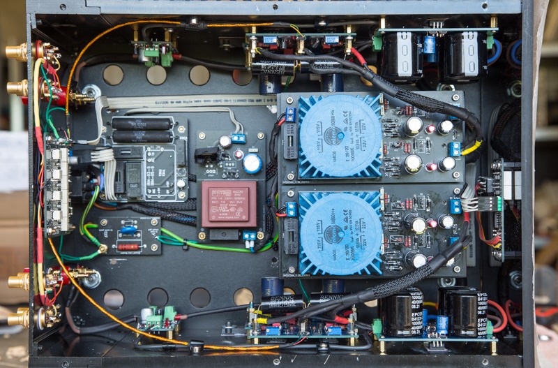

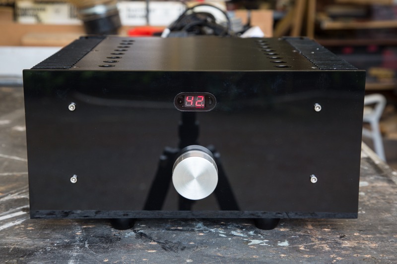

This weekend, I have substantially finished the build of an F5Pi using USA mosfets as provided in the recent group buy, while varying a little from the current group buys for F5Pi PCBs.
I used the relaixed system from Jos von Eijndhoven for source selection and attenuation, along with separate supplies for front end and output stage. The chassis is made from sheet alu cut to make the individual panels, as I had some damaged heatsinks of the appropriate size, I pressed those into service rather than see them go to waste. The front panel is 8mm black acrylic.

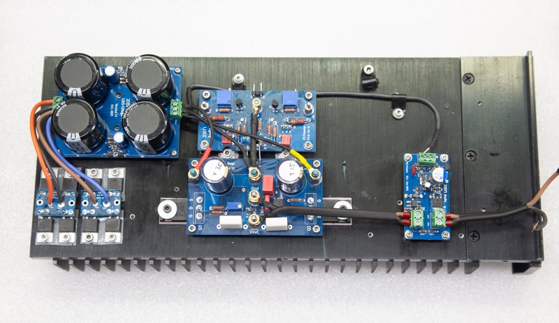

I mounted most of the "amplifier" parts on each heatsink - output stage power supplies, front end and power boards, and the speaker protection keeping cable runs as short as possible. It also helps with thermal management for the regulated output stage supply. The floor of the amplifier then has the aux power supply, relaixed soft start module, an earthing circuit breaker, transformer (hidden under the platform with front end supplies) and the front end supplies themselves (the ones with the blue talema transformers). The source select and attenuator board is mounted on the rear panel to keep lines as short as possible.
The amplifier both measures well, handles reactive loads well, and sounds great. For those who might be planning a build using the group buy boards, you will find there is a significant amount of work in the build, but you will be very well rewarded at the end. I would also say my work was increased because of the extra metalwork.
Modules mounted on the heatsink:
Internal view of the completed amp. Transformer is under the platform at the front of the chassis under the smaller front end transformers.
Finished front view - excuse the tripod showing the photo, its hard to avoid reflections in what is really a mirror!

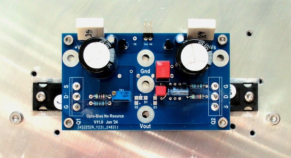

Earlier at another thread, we posted an experimental output stage based loosely on the M2OPS, but without R_source.
https://www.diyaudio.com/community/threads/the-holy-grail-follower-output-stage.406850/post-7671867
This is a modified version of :
https://www.diyaudio.com/community/threads/the-holy-grail-follower-output-stage.406850/post-7544067
with 10,000µF caps added between the MOSFET drains and Gnd.
Also the current sensing resistors are changed to 1R 5W (MPC74), and additional diodes (1N4148) between the rails and the BJT emitters.
This will then result in 1.2A bias, and the 1R_10,000µF will give a LP corner frequency of ~16Hz.

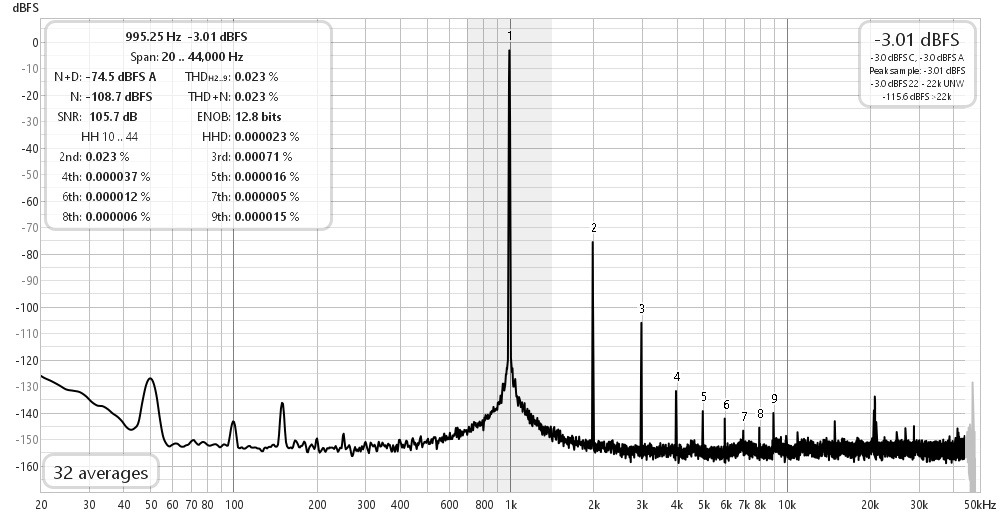

Distortion measurements have been done using unmatched pairs of the following MOSFET combinations :
Vishay IRFP240/9240
Fairchild FQA10N80C/9P25
Fairchild FQA28N15/36P15
The results are as follows :
MOSFET__ H2______H3
IRFP_______-73_____-103
FQ1009___-71_____-103
FQ2836___-71_____-99
One can compare this to earlier results on the (standard) M2OPS measured by Twitchie :
https://www.diyaudio.com/community/threads/complementary-power-mosfets.378024/post-6888301
https://www.diyaudio.com/community/threads/complementary-power-mosfets.378024/post-6889027
MOSFET__ H2______H3
IRFP_______-82_____-88
FQ1009___-80_____-89
FQ2836___-71_____-91
One can see a noticeable improvement in H3, as expected when not using source degeneration.
Output impedance (Zout) is around 0.2R for all 3 pairings, also lower than with source degeneration, as expected.
As mentioned before, one can reduce H2 by trimming with the aid of a distortion analyser, at the expense of slight increase in Zout :
https://www.diyaudio.com/community/threads/the-holy-grail-follower-output-stage.406850/post-7656574
In both cases, the -3dB bandwidth is beyond 2MHz.
Credit to Fran for performing all the measurements. 🙏🙏
Patrick

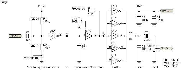

But if you do want to test yourself, I guess you are looking for something low cost.
I can only suggest you take a look at ICL8038 or XR2206 based solutions.
Actually in this particular case, you really only need an analogue square wave generator, say around 1kHz, to look for any ringing.
Elliott has one (near the bottom of the page), with all details how to build.
https://sound-au.com/articles/squarewave.htm
And 9V battery supply is more than plenty.
You are more likely to need output <2Vpp.
Patrick

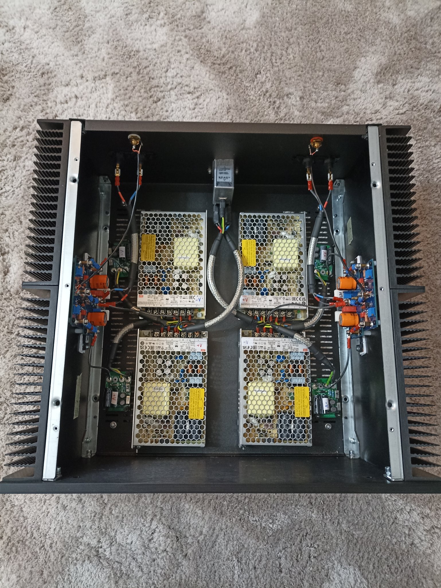

thanks for your hint Patrick,
i refere to this statement - but I will measure it also.......amp sections are measured and OK---- 22W/8R; 38W/4R......
"After some experimental tinkering, the circuit schematic in Figure 1 took shape. It has two stages of LC filtering, built 100% with through-hole components for easy soldering. Noise attenuation at 50 kHz is about 40dB (i.e. 100x); while at 200 kHz, noise attenuation is about 65dB (1700x). Input to output DC resistance is about 100 milliohms on the PCB. Then we need to add the resistance of external wiring (about 16 milliohms per foot for AWG-22)."
here: https://www.diyaudio.com/community/...all-warts-preamps-hpa-korg-nutube-etc.354213/
so why smps....
I never used smps and usually I am fan of transformers......but I have not done the decision how to solve the Power supply with cap x... to get the prefered 24V.
with this filter smps solution I got a cheap one ...and a new experience 🙂

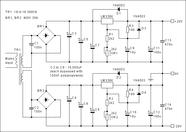

Re powersupply… I’m still struggling which path to take: capacitance multiplier or voltage-regulators...
Fran, do you have any experience or recommendation that you could share with this regard?
Initially I have designed a voltage regulator board with paralleled LT3081 and LT3091, but it came out that the LT3091 does not work as described in the datasheet. I made a complain at Analog Devices but it was more or less ignored. So don’t use LT3091 for higher output voltages - it will most likely oscillate!
Cheers, Boris
Reactions: EUVL
In principle we usually prefer to use open loop supplies.
Closed loop regulators are not always stable with fast amps, as they are inductive at HF.
But to use cap multipliers, you need MOSFETs with low Vgs.
Now that 2SK3497/2SJ618 become too expensive, we can't recommend them for regulators.
Which is why we recommended 317/337/338, etc.
