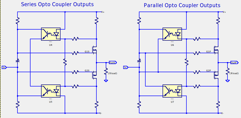

The basic idea of the circuits is to integrate (via. a capacitor) the voltage across the drain sense resistors of the FETs. Optocouplers are used to totally isolate the inputs (LEDs) from the outputs (phototransistors). How should one combine the outputs from the NFET and the PFET? The first image below shows series, and parallel connection phototransistor outputs.
The problem with these circuits is that the bias current is not stable as the output power level is increased. The series connection results in a large increase bias current. The parallel connection results in large decrease in bias current.

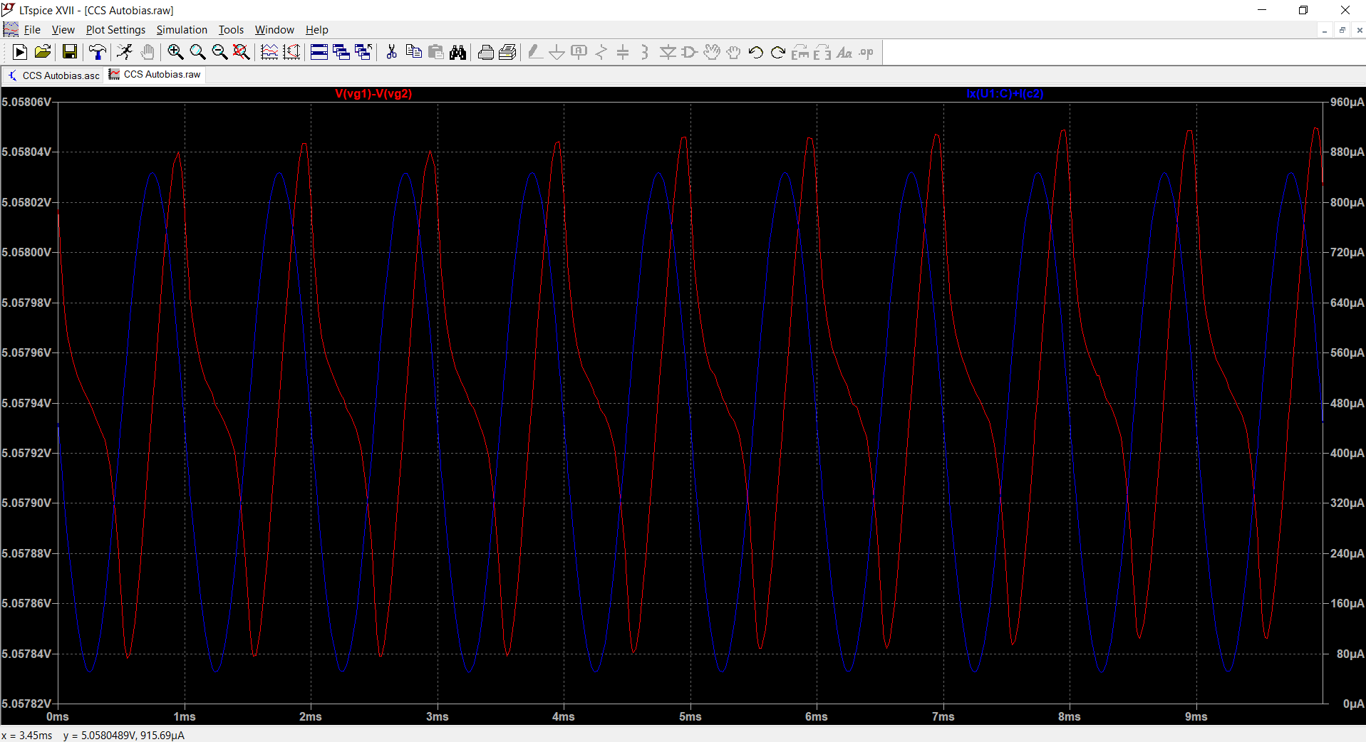

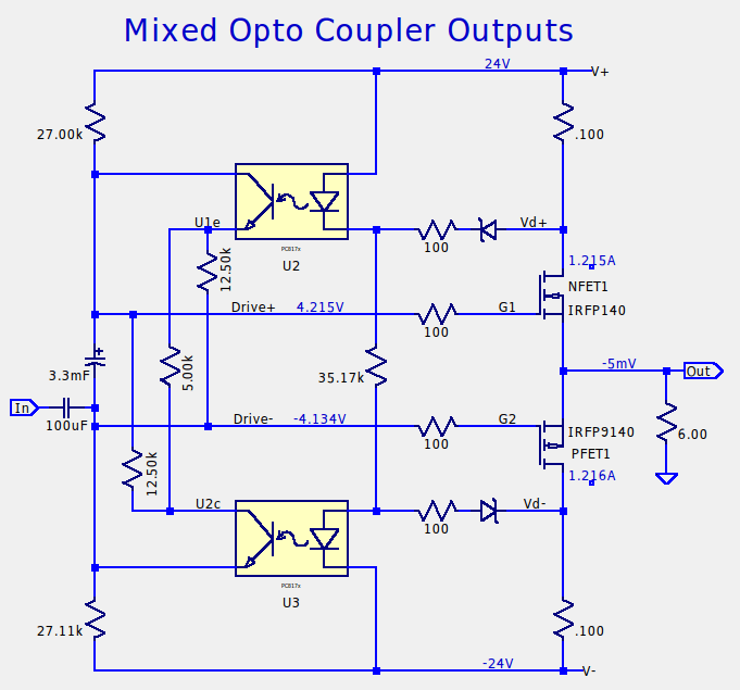

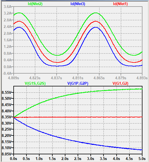

What I discovered today (Dec 20 2023) was a circuit variation that allows the continuous choice of constant, rising, or falling bias current with power level, requiring only 3 additional resistors. The second image below show the circuit and the output for a 16 Watt, 20Hz sine wave into a 6 Ohm load for each of the bias circuit topologies. The plots in the third image shows the current waveforms into the NFET after 4.8 seconds have elapsed. The plots in the fourth image show the difference in the FET gate voltages for the entire 5 seconds of the output. Green=series, Blue=parallel, Red=mixed topology.
By adjusting the 3 added resistors, the red curve can be an arbitrary mix of the green and blue curves.

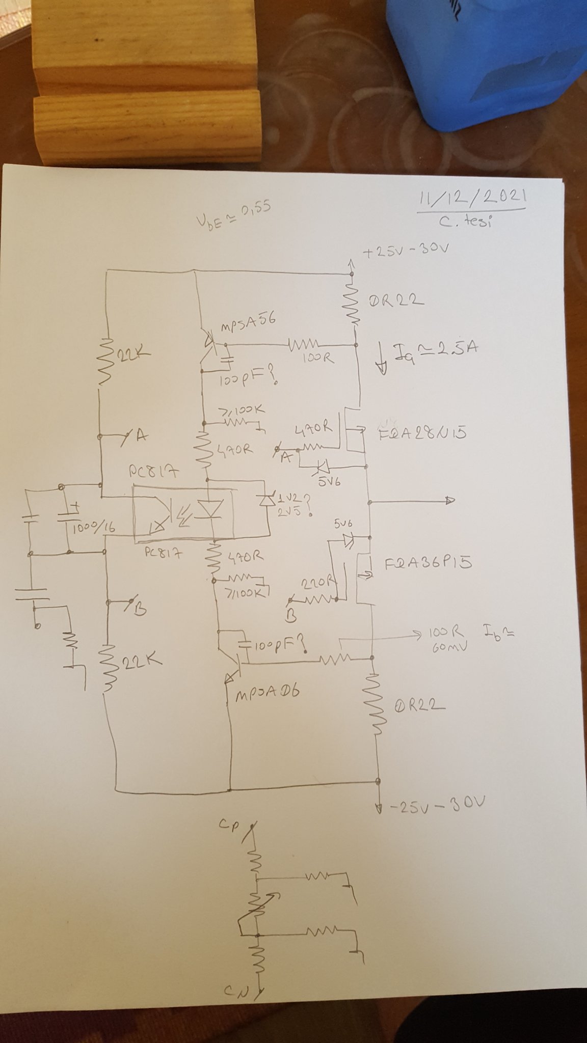

How to include the Class AB feature of the M2OPS (with the LM385s) with this ?
https://www.diyaudio.com/community/...in-class-a-b-and-maybe-a-power-whammy.390636/

Yes.Are the resistor values shown in the schematic appropriate for constant bias-current operation?

According to spice, post #16 works quite well in DC.
But when a large signal of +/-20V 1kHz is applied, one can see that the sum of the two gate voltages is not quite constant.
And distortion is also not small, even at lower amplitudes.
I think I need some more investigation.
