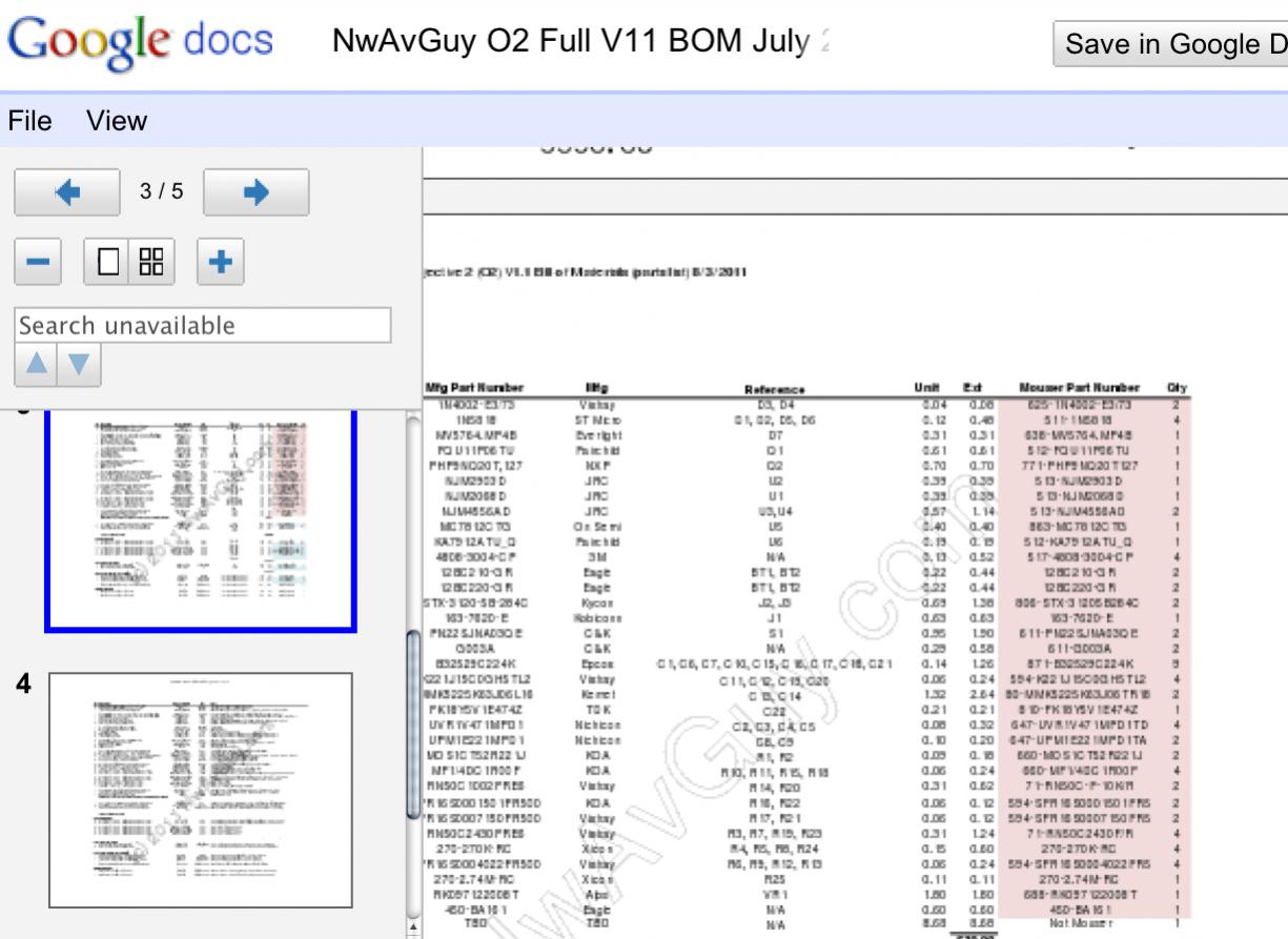

one thing, i havent looked up the part numbers for the opamps, because actually its not that easy to read them in the parts list linked to the google docs (pita to navigate too with no quick keys, even space bar doesnt work to create a hand to move the page when zoomed in) but just wondering, i assume the opamps you have used are limited in bandwidth? having a pretty cheap pot in the middle of the feedback loop for volume control doesnt cause any issues with stability?

There should be a "-" and "+" button on the left side of the Google Docs viewer. Click the "+" button to zoom in as much as you want. Unless you're using some really weird browser it should work fine.
You can also just download the PDF and use whatever PDF viewer you want.

cool ok, fair enough, at a glance thats how it looked, maybe there is something up with either the pdf, or the viewer on google docs at my end because it wouldnt redraw when i zoomed in, just remained kinda half blurry and aliased, thus not being able to read part numbers or have any patience at all haha. i'll download it and have a look tomorrow. yeah was just asking, given your history i couldnt picture you publishing anything unstable for public scrutiny, but given the inability to read it i thought id ask.

I can't seem to access the documentation package. Google reports "This service is not available"
Hmmm... way to go Google! I've had random problems with Google Docs which is sort of amazing when you consider they want companies to run their entire businesses on Google Docs and Google Apps.
But, that said, I just checked and it works for me. Here's the link:
https://docs.google.com/viewer?a=v&pid=explorer&chrome=true&srcid=0B52Awjeyc5zKNjQyOTlhMjAtZTNmOS00ZTNlLWEyMzgtZTQ0YzUwN2ViOTc4&hl=en_US
yeah its being really buggy, could be safari or something, dunno, this is what it looks like here and it doesnt improve when i zoom

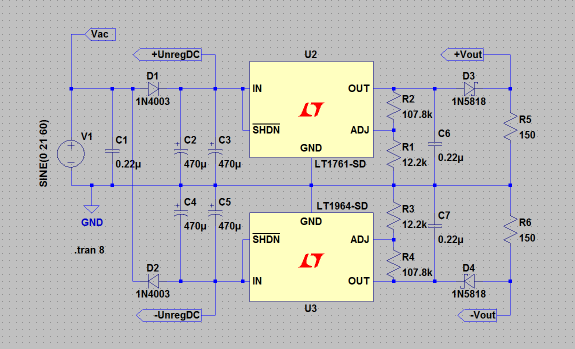

And the half-wave AC supply might seem "cheap and dirty" but properly engineered it works as well as any other AC power supply in this application.

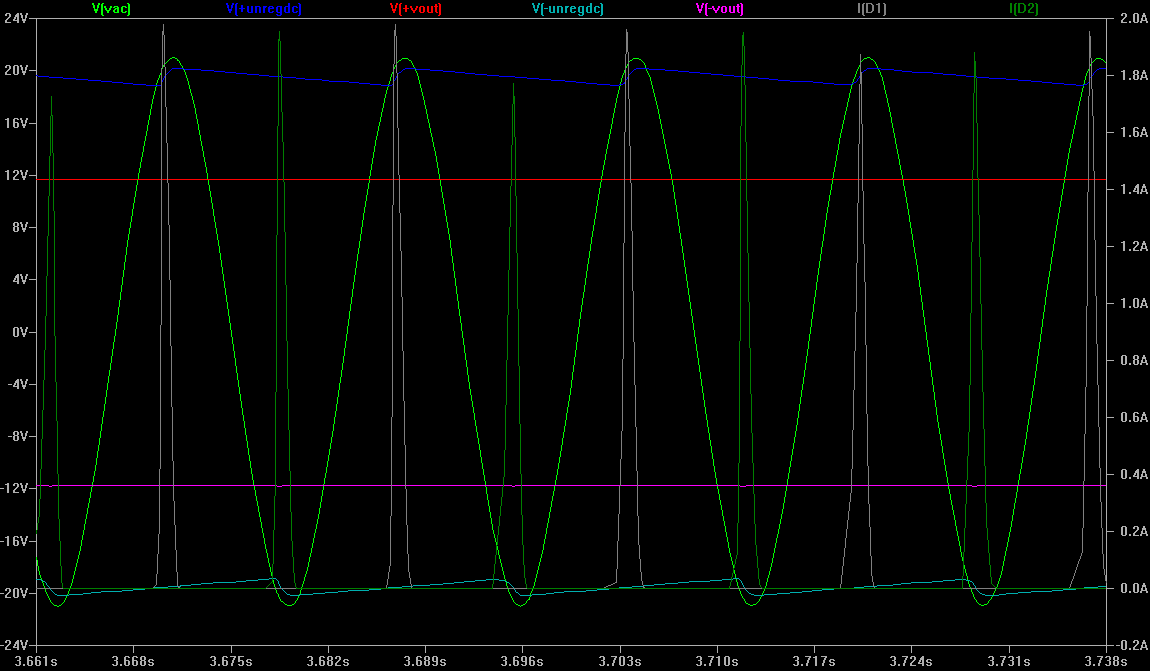

I was wondering about that and just (LT) Spiced it. Linear Tech's model base is pretty devoid of negative regulators so I've substituted in a couple of 100mA units and lowered the load.
Looks good, but 1.9A diode charging current and that's with reduced load... would 1N5402 be more appropriate or am I missing something?
Looks good, but 1.9A diode charging current and that's with reduced load... would 1N5204 be more appropriate or am I missing something?
The 1N400x diodes are rated at 30 A of peak current for a half wave cycle (8.3 mS) and don't even get lukewarm in this application under worst case conditions. I don't think it's a problem unless I'm missing something? The diodes are running at 1.9/30 or 6% of their rated current.
