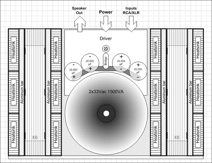

As extreme as it gets
Well, I don't seem to be able to get that Aleph 2 out of my head.
I have rethought every millimeter of that amp to have that 1500VA transformer fiited.
I have added a section of heatsink above X6 boards. This way I get 240in² of heatsink surface which is very close to WaneyS' 260in². I just hope that my good heat distribution and a massive covers (top and bottom) venting will make heat acceptable (I'm very confident ). As Mr. Pass say, the worst that could happen is that it will run hotter, one think that I don't really mind.

Transistor mounting to Heatsink(s)
It looks like you are using aluminium bar to mount the MOSFETs to and using that to spread heat across the row of heatsinks.
This would result in reduced heat transfer as you are introducing another thermal interface into the equation - better to mount each MOSFET directly to the heatsink as this will reduce the junction temperatures of the devices - Each thermal interface is most likely going to cost you about 1 degree Celcius/w.
Copper would be better than aluminium at spreading the heat, but it's still far from ideal and will also cost you loss of efficiency.

The aluminium bar is used in case I have one heatsink per MOSFET because the chassis wouldn't be rigid enough otherwise. However, adding the bar would decrease the heat transfer but could add heat absorption...is this relevant?
The best would be to find full length heatsink with enough base thickness to bolt bottom and cover...

Ok, it sounds like you're going for the 100w no matter what!
Go for it!!!! I can relate...
A couple of thoughts on your revised design...
a) Rather than mounting the fets to the aluminum bar that you show, why not instead run a piece of 20mm square stock as "rails" along the top and bottom edges of the heatsinks with heatsink compound between. Your drawing would look the same but the bar wouldn't be one big piece...but instead two smaller ones... This would allow the rigidity that you're looking for as well as solid mounting for the heatsinks themselves. It would also allow for mounting the fets directly to the heatsinks themselves - this would be much more thermally efficient...
b) Suggest using 6 - 10mm plate for the bottom (and perhaps top) of the amps. This would make the amps much more ridged as well as increase the thermal sinking...use heatsink compound between the above mentioned "rails" and the tops and bottoms of the cases... Attach the "rails" to the chassis in several places along their lengths to create good thermal transition...
c) Be sure to design your venting in the tops and bottoms for lots of airflow... I figure you've already taken this into account but I figured that I'd mention it anyway...
d) Based on your drawing, it looks to me like you still have a bit of available space between the heatsinks. What about locating or fabricating heatsinks with deeper fins? This should improve the dissipation factor a bit...

Actually I meant to comment on this bit before. Someone correct me, but my "rule-of-thumb" for transformer VA rating is at least 2x the constant current draw for the amplifier.
The Aleph 2 dissipates a little over 300W/channel, so 600VA would be acceptable and as Grey suggests 750VA would be fine.
I don't disagree with Grey's comments on power/clipping either .... simply, if you do have relatively inefficient speakers and like it LOUD, then you are better off in the X600 territory than going from 60 to 100W.
