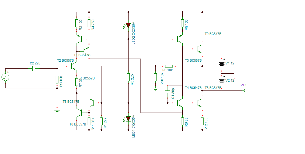

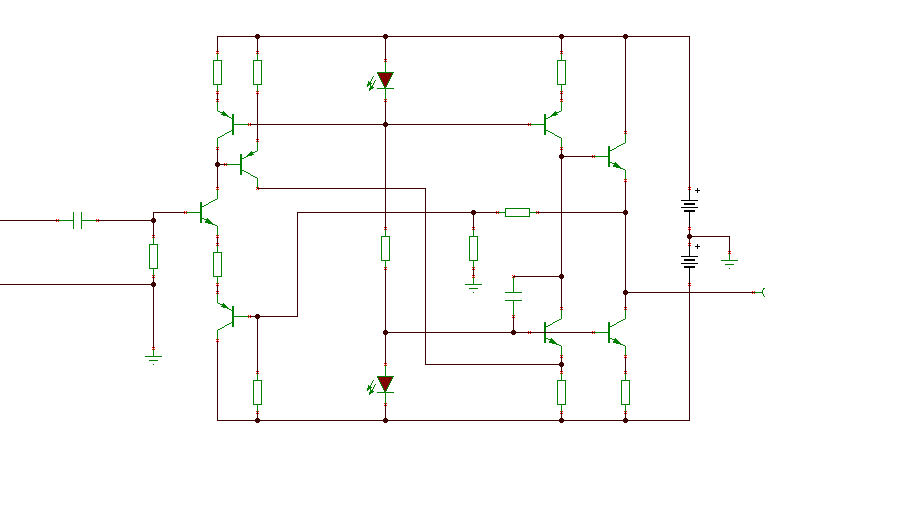

The-simpliest and lowest distortion discrete op-amp
max supply voltage: +-12V
Actually, is not the simplest because the 1st CCS is not required. Resistor does the job too.

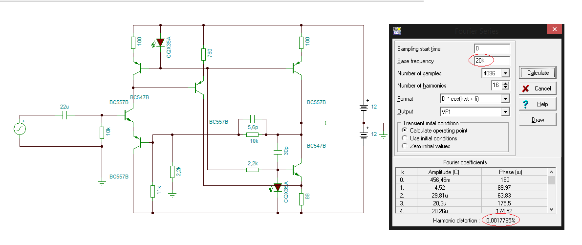

Gives 0.002% @ 20khz and perfect square waves.
