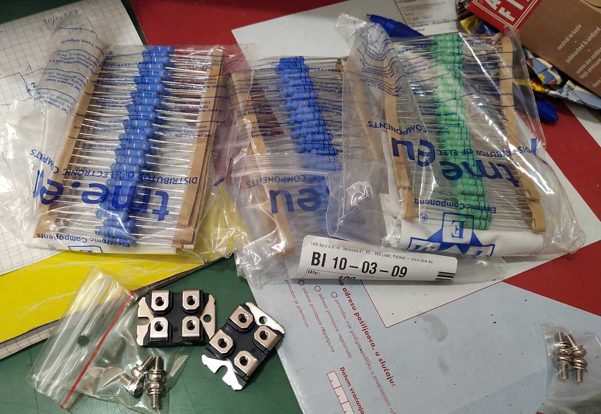

so - result is - I came back home with pair of 2SK77B Tokins , being so damn lucky that Pa didn't count them in da Shoe-box , prior to packing me in Variac's car .... ( he drove me to Snoopy Airport)
anyway , what to do with just a pair of them ...... I can't make just one Digital Domain channel ...... still using stereo in my systems ; have no money left for another Pilgrimage so fast and , besides , Pa would say "we are not home!!" even without counting what's left of Tokins in shoe-box...
so , must be some SE ........

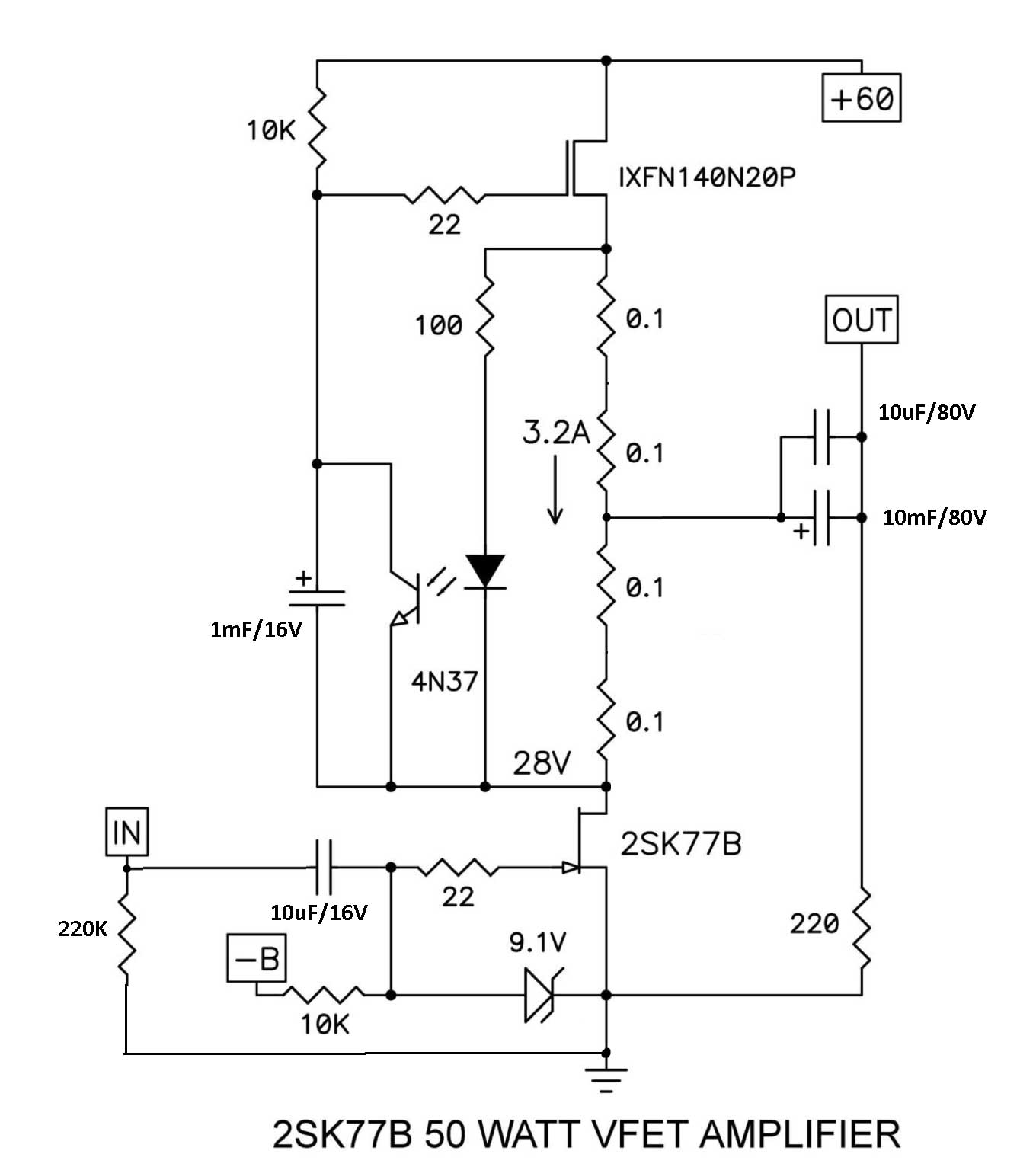

see , ZM's 50W SE Amp , as Papa kindly constructed it ......
it's clever to watch entire vid I linked in previous post ....... you can learn few things , especially about heat

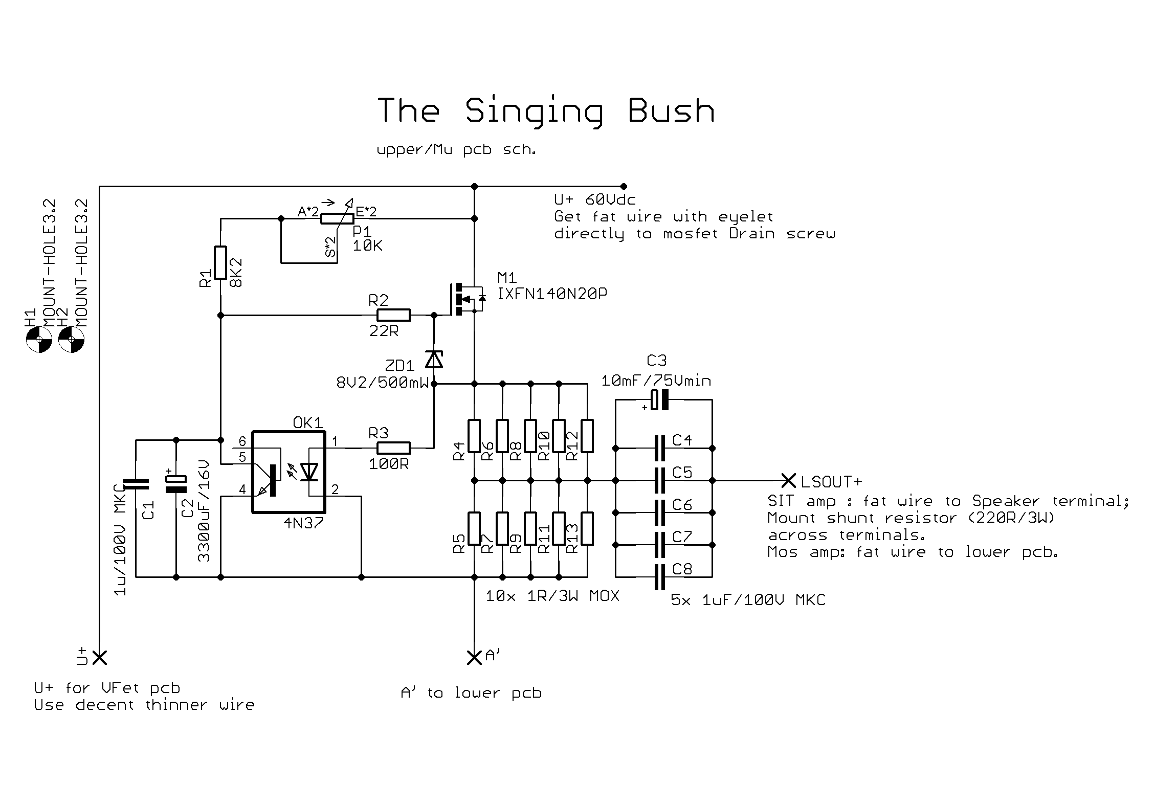

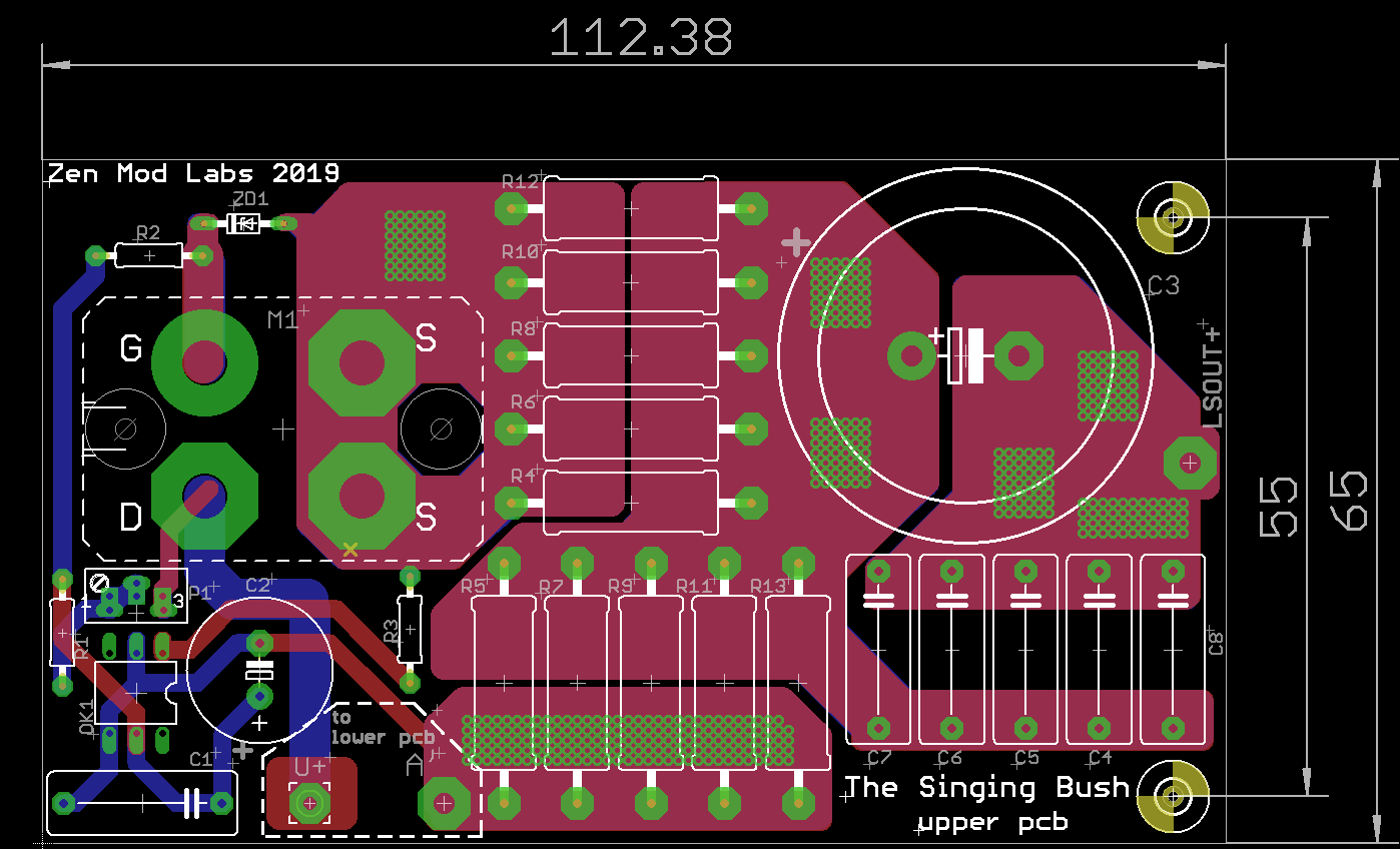

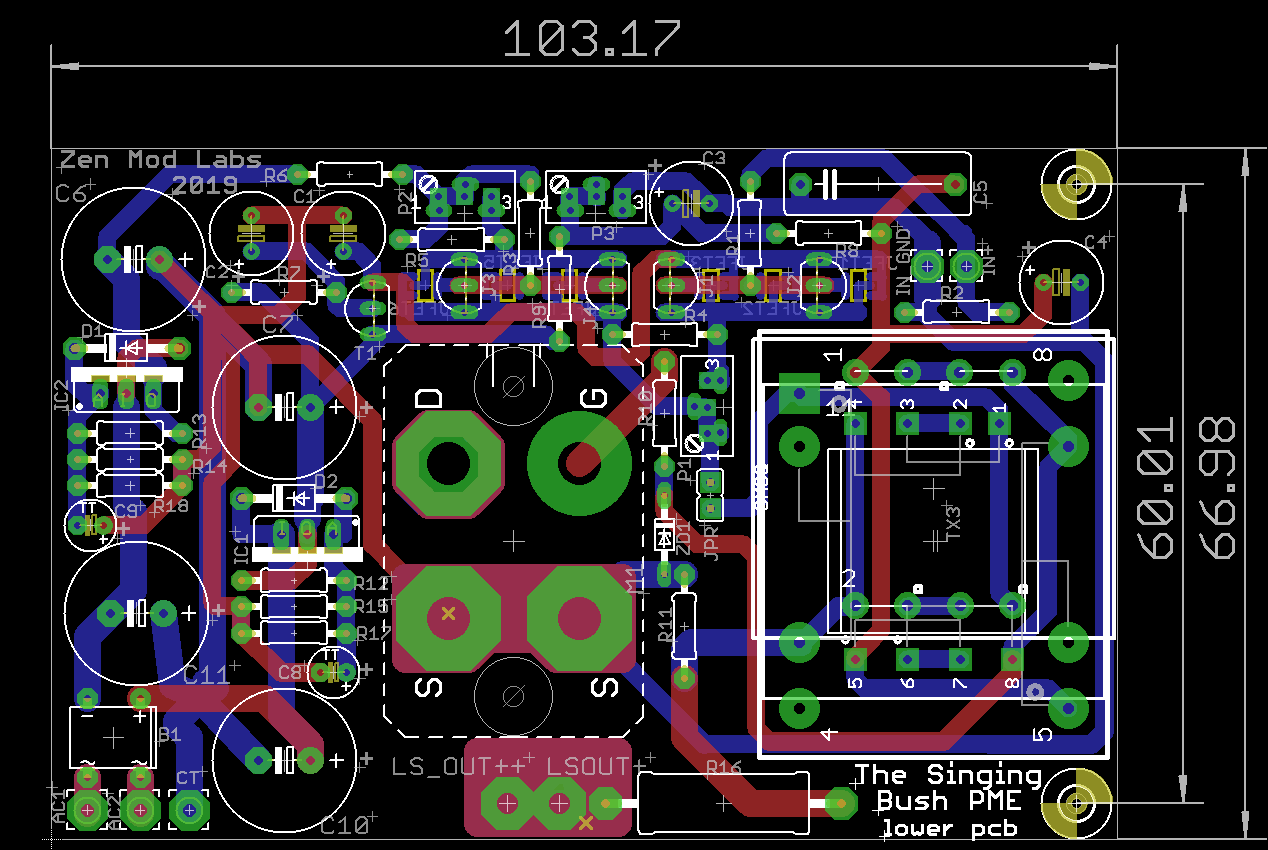

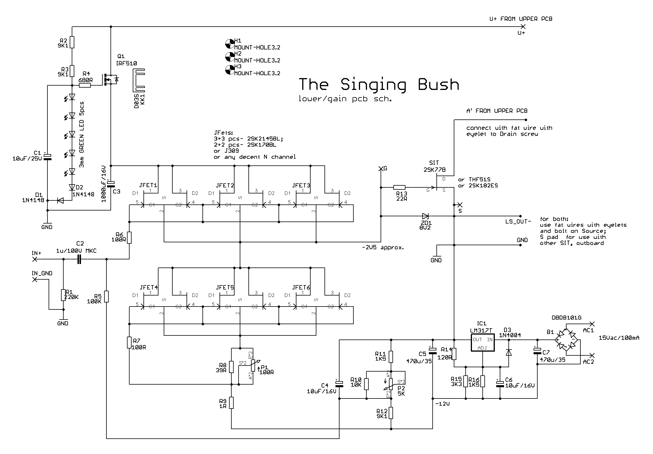

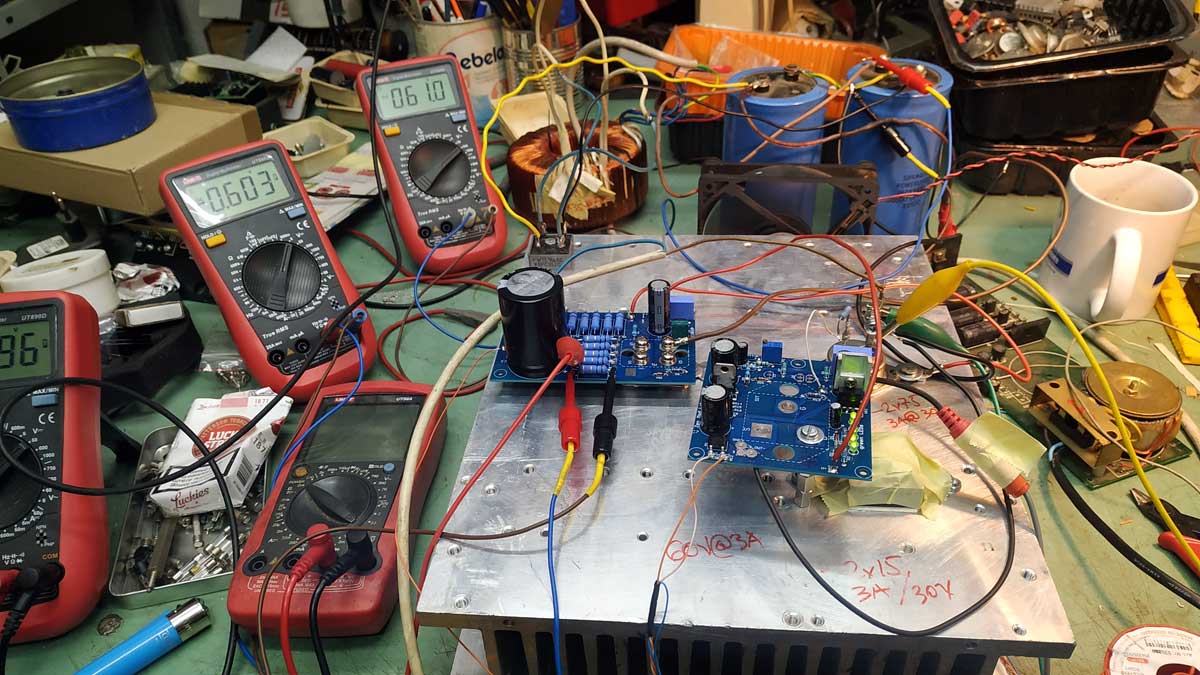

making amps simply by schematic ( even drawn by Papa ) is boring ....... while making it absolutely and utterly unnecessary more complicated is ......fun ; besides , there is just one M2 amp , which (we all know) is best amp ever made and sole one which is sacrilege to change

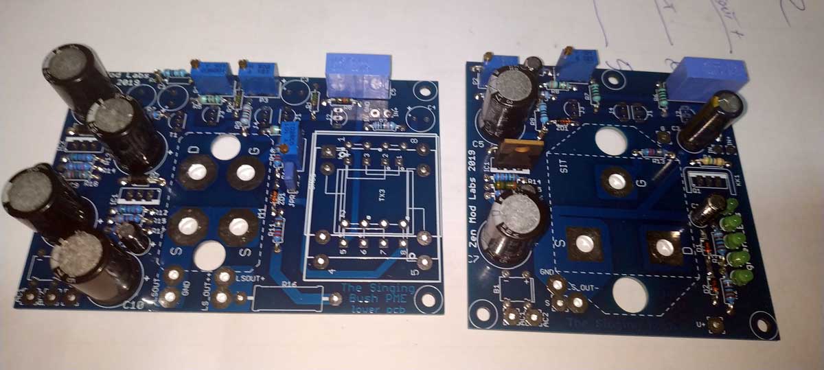

so , what I concocted is something as this (broken in two halves, upper and lower , so easier to combine common upper Mu-block with different lower halves)
so , Mu first
so , Mu first

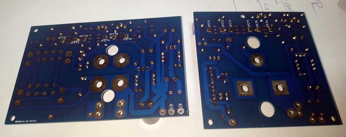

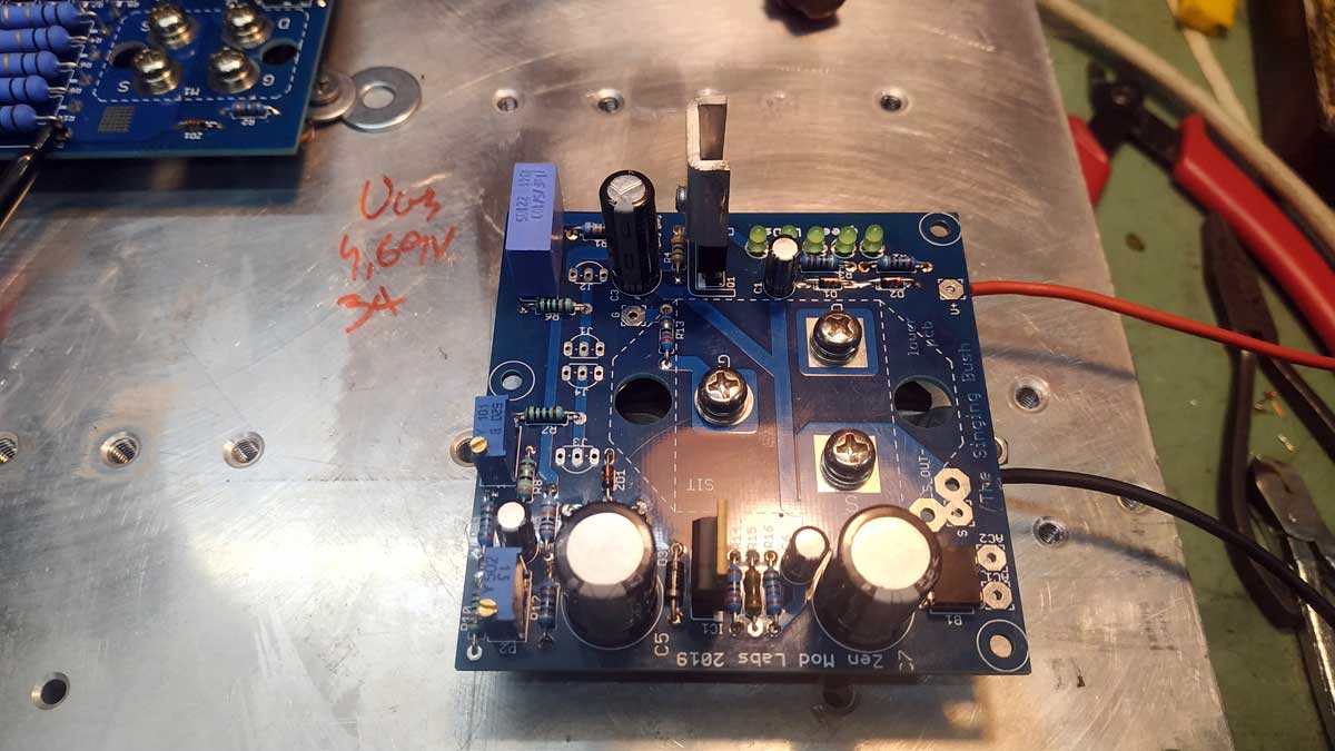

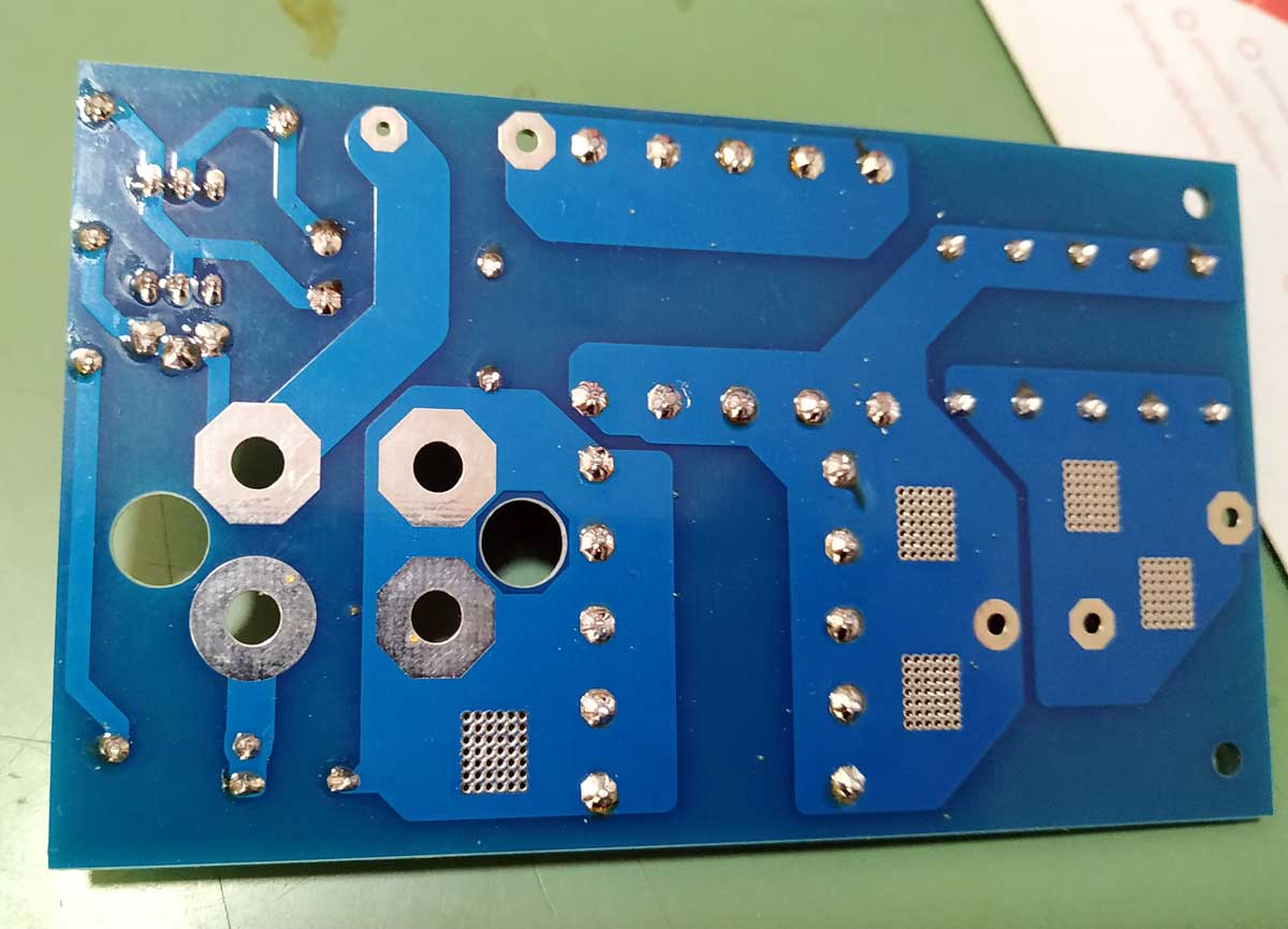

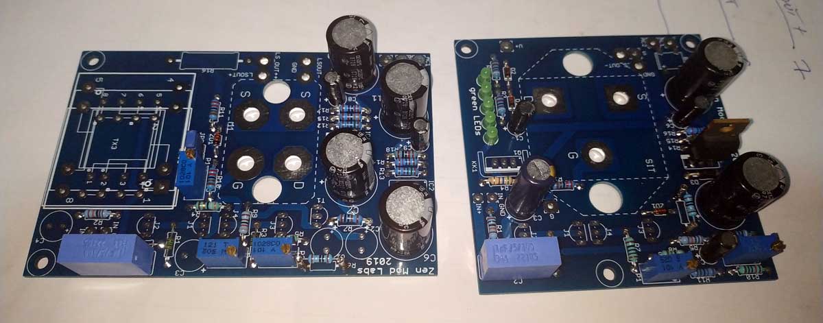

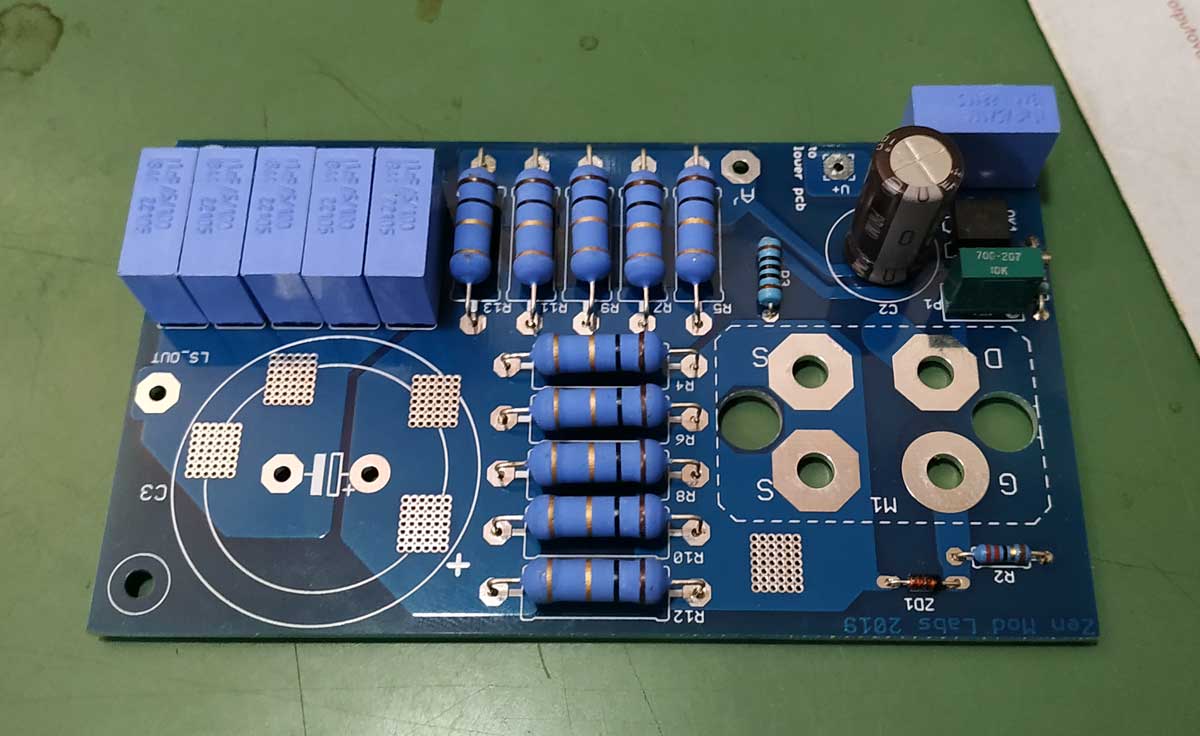

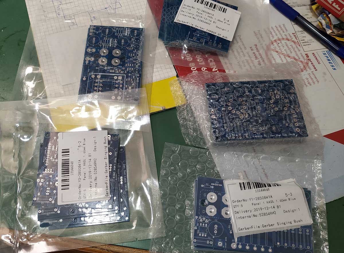

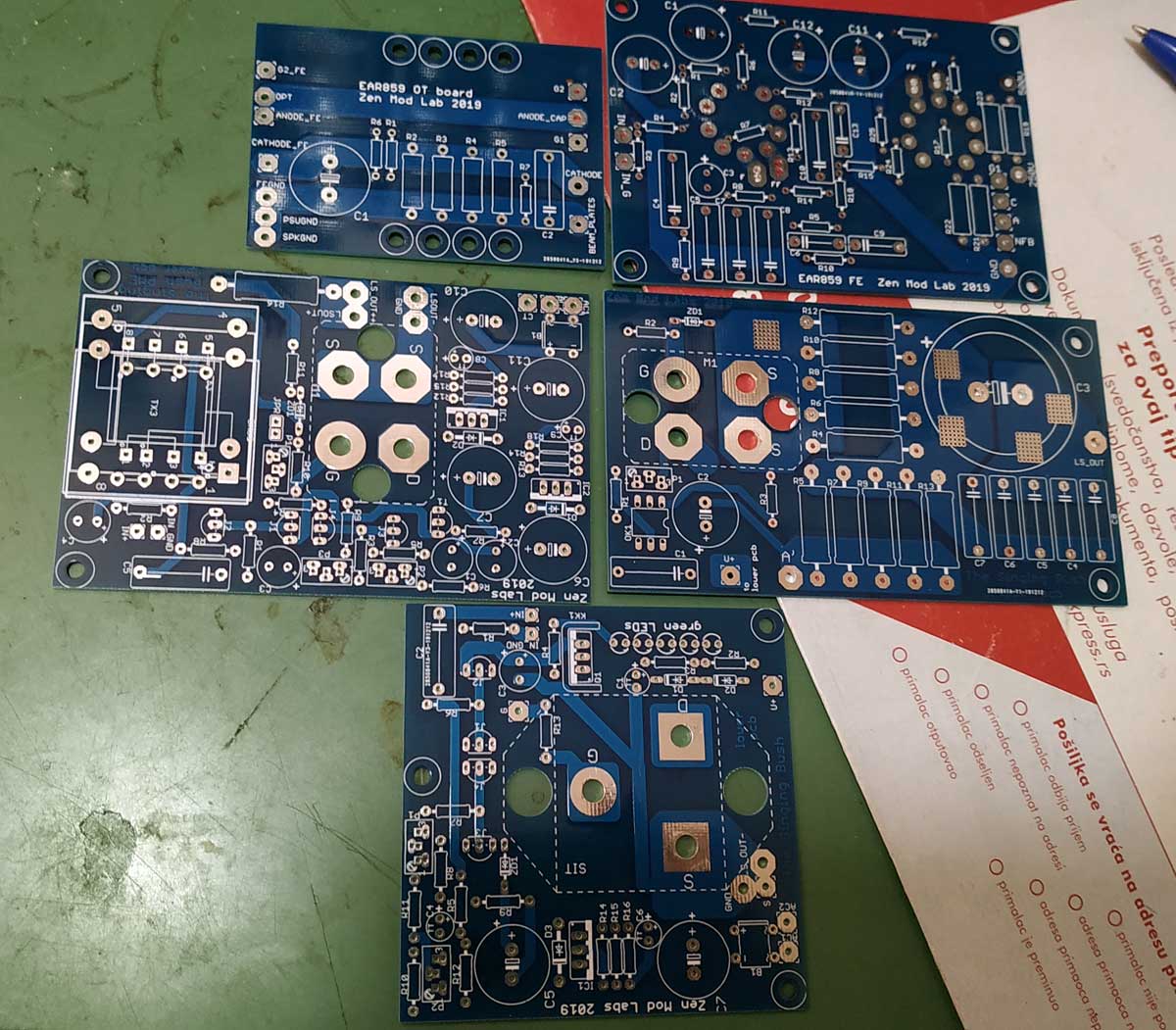

I started populating pcbs probably a week ago

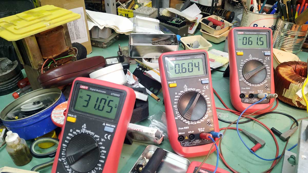

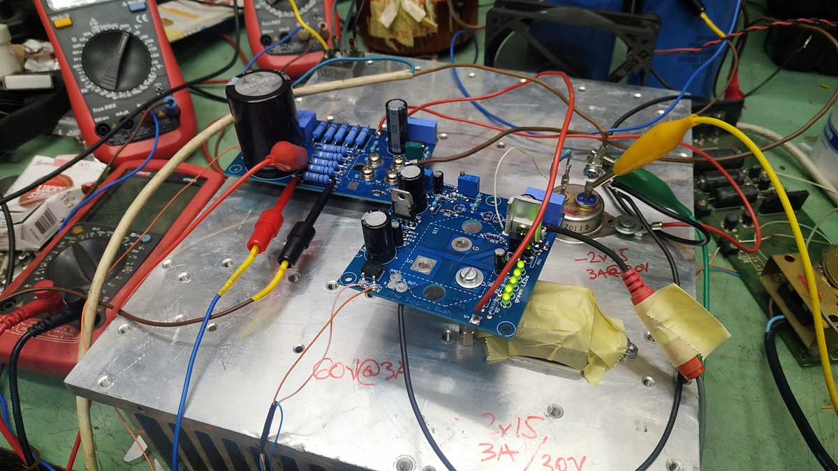

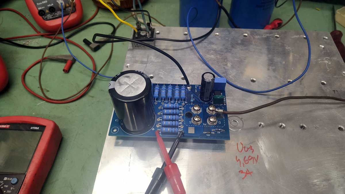

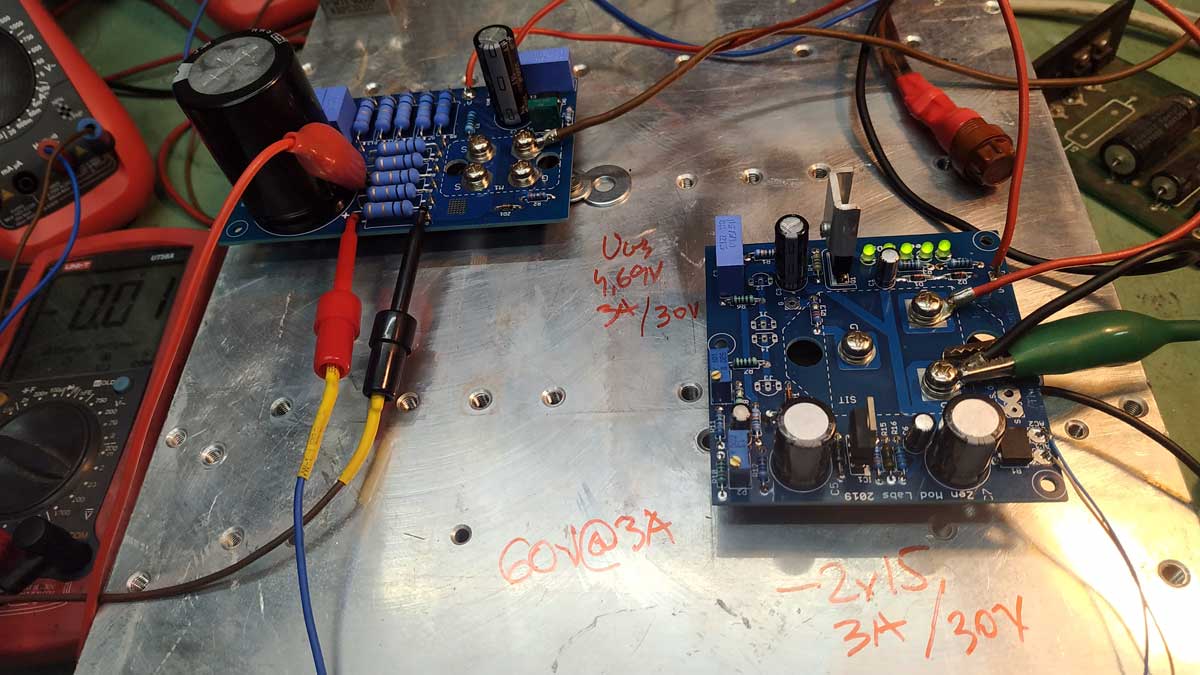

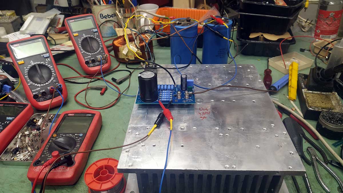

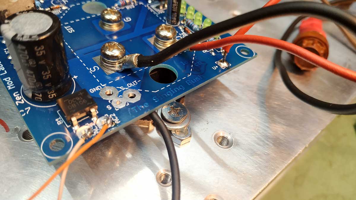

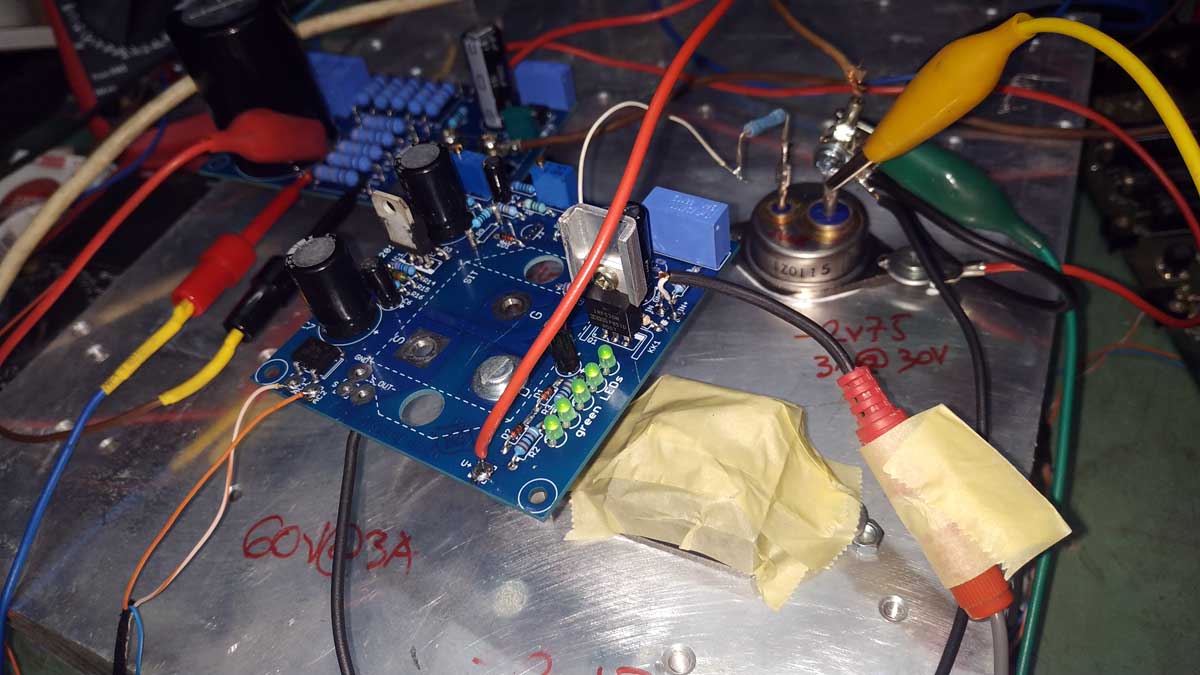

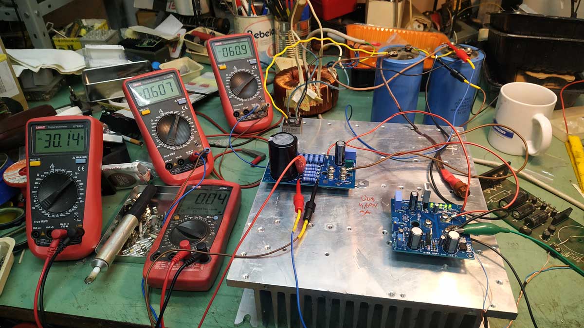

then few days ago , finally did first thing - testing in vivo Mu block
it behaves , Iq set at 30V (half of rail in amp) , steady 3A , behaving nicely .... no hiccups and surprises
10K trimpot enabling fine setting of Iq
observe fuse holder
T4A , keeper of good mood
observe fuse holder

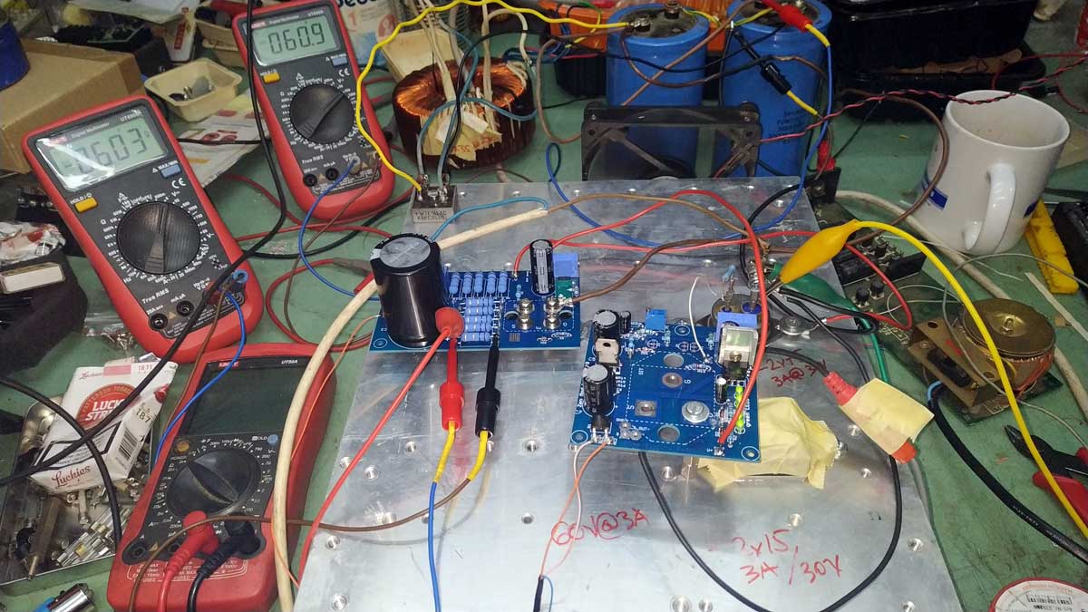

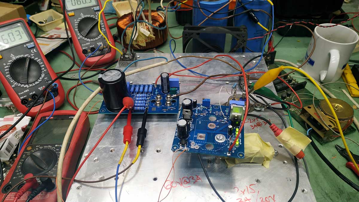

Patience ,my dear Watson ........ and Courage!!
that's what's needed when playing with rare and precious toobz

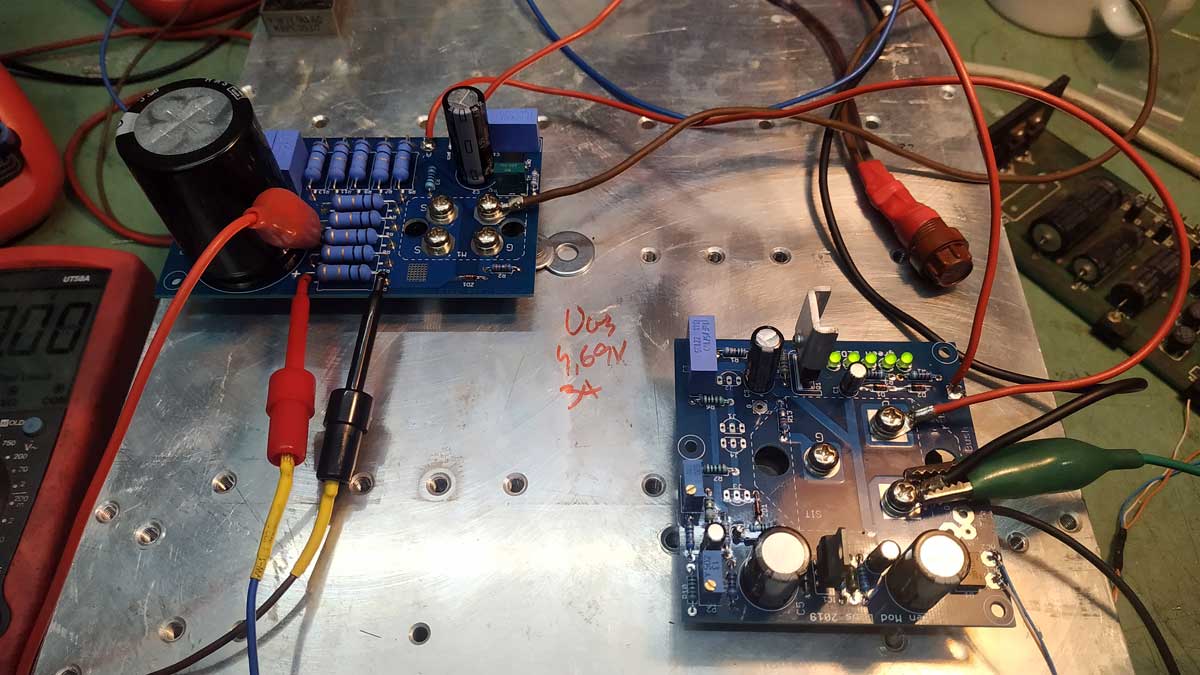

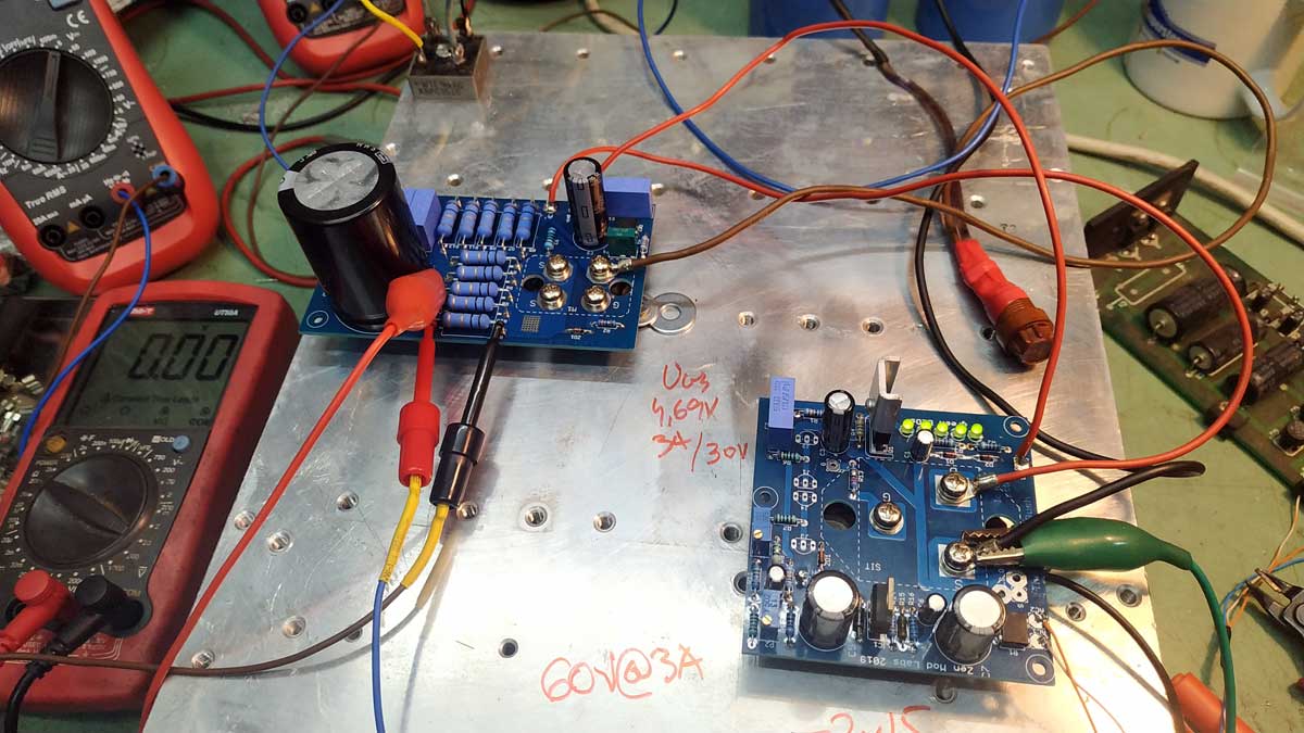

yesterday I followed connecting ZM's half to Mu , enabling full 60V rail , and testing how entire shebang behaves in DC domain
can't be more satisfied .......
voltage potential at output node ( inner side of output cap) ramps up to some 17V nicely fast , then hesitates a little , and goes smoothly to 31V (where I decided to set it) , as Mu starts conducting
3m3 across Opto- Governor is seriously slow to be charged , exactly as intended

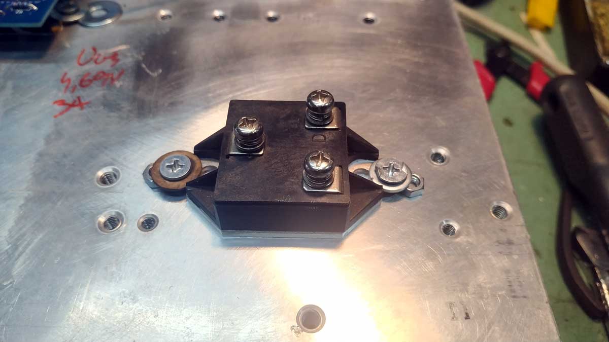

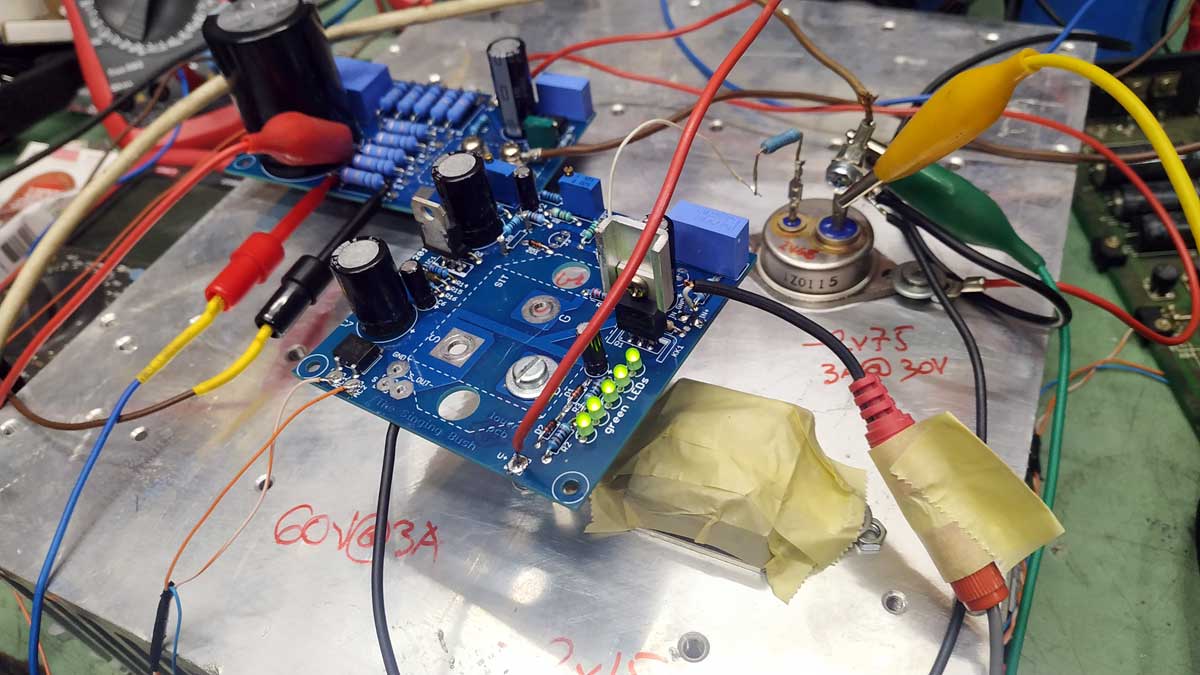

now , show time !!

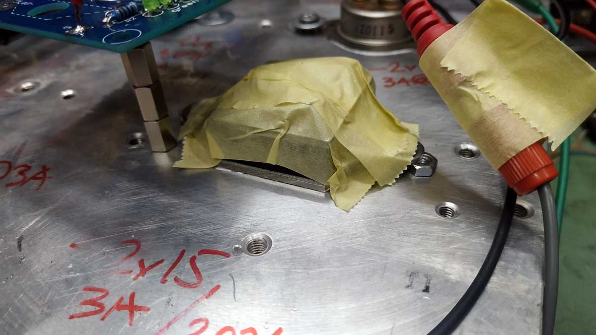

ZM's half pcb removed from my Preciousssss, made some security cover for same , took random THF51ES and connected with short wires , so Poor Man's ZM's amp ( you can call it Vienna Boy's Choir amp , if you like )
was lazy to organize isolator sheet for THF , so entire heatsink is sorta live , at SIT drain potential - approx 30Vdc

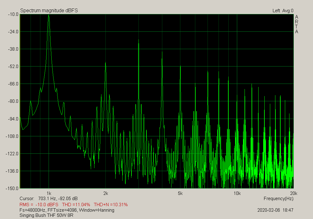

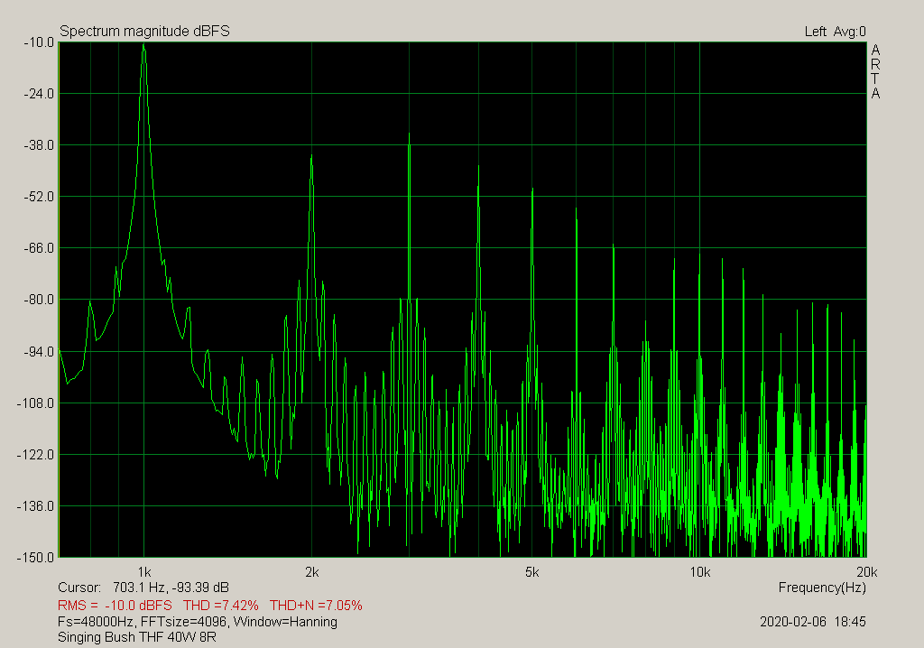

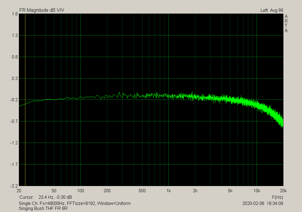

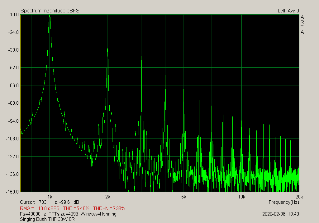

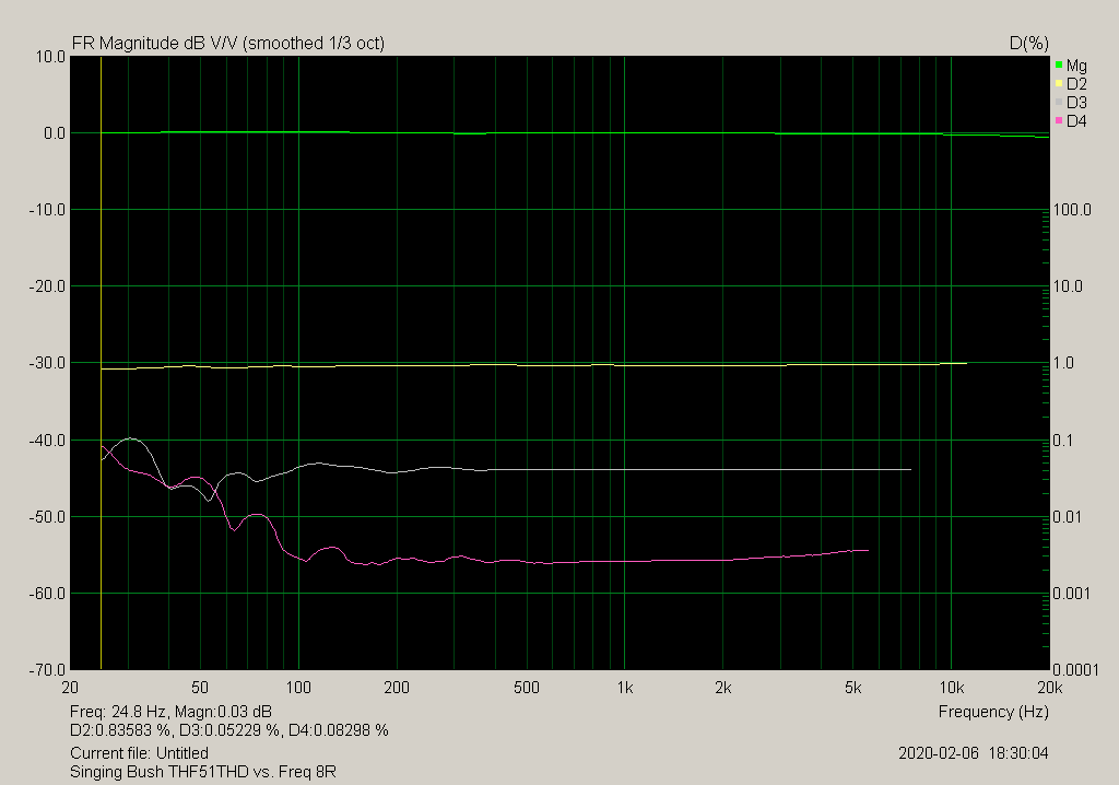

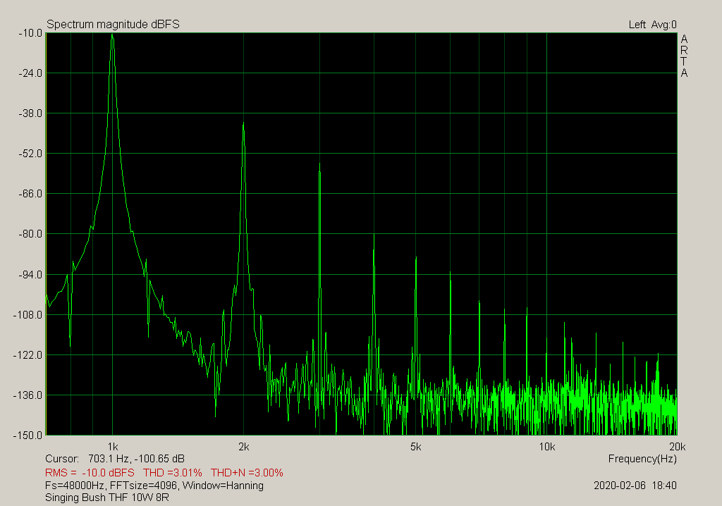

The Singing Bush - THF51ES - yelling!!! at 8R

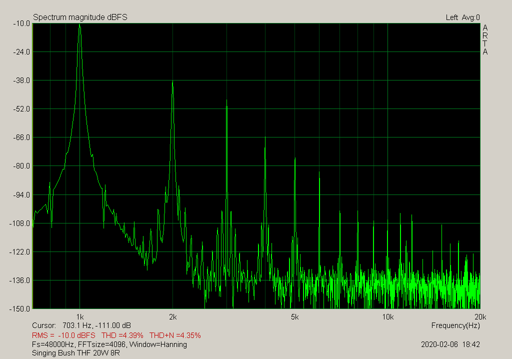

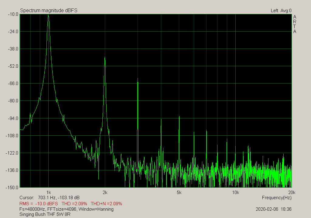

night was young ........... ok , it wasn't even night yet

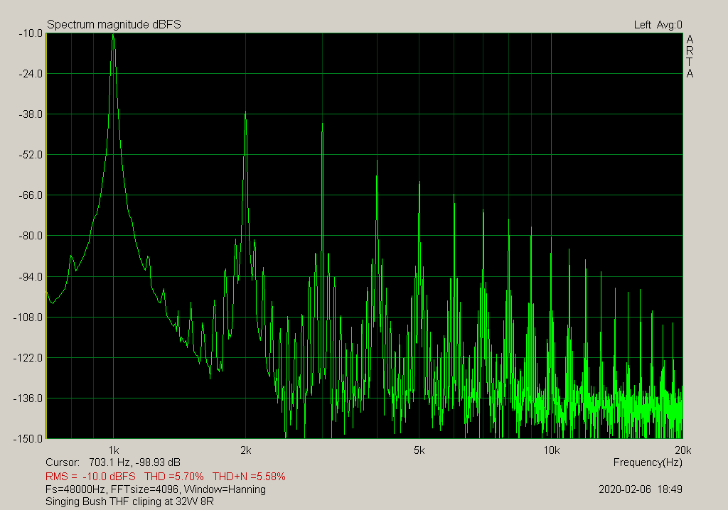

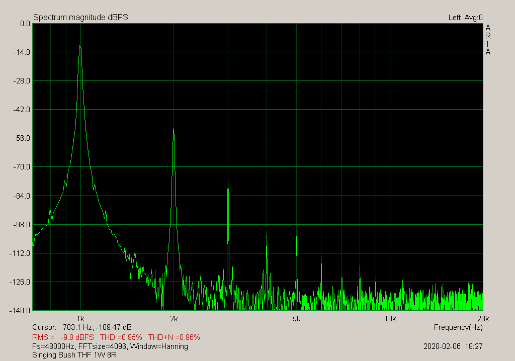

so , why not inducing few Greedy Boyz smiling tonight ..... simply because I know that Regular Greedy Boy expects daily dose of graphs , to sleep peacefully
see few things :
- Singing Bush THF thinks ........ no - it's convinced that he is Toob amp!! (10% THD at full power is normal thing)
-THD ( 1W@8R) , keeping 30V5-31Vdc at output node is nearly doubled , comparing to where I moved it - at 35Vdc

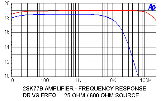

-visible clip at scope starts at 32W/8R

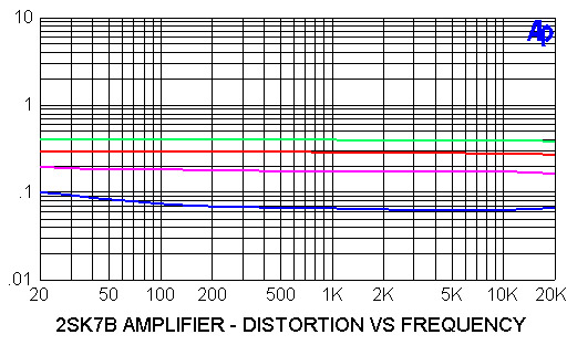

- good to have ballsy buffer - it shows in FR , also in THD vs. Freq. graph
see few things :

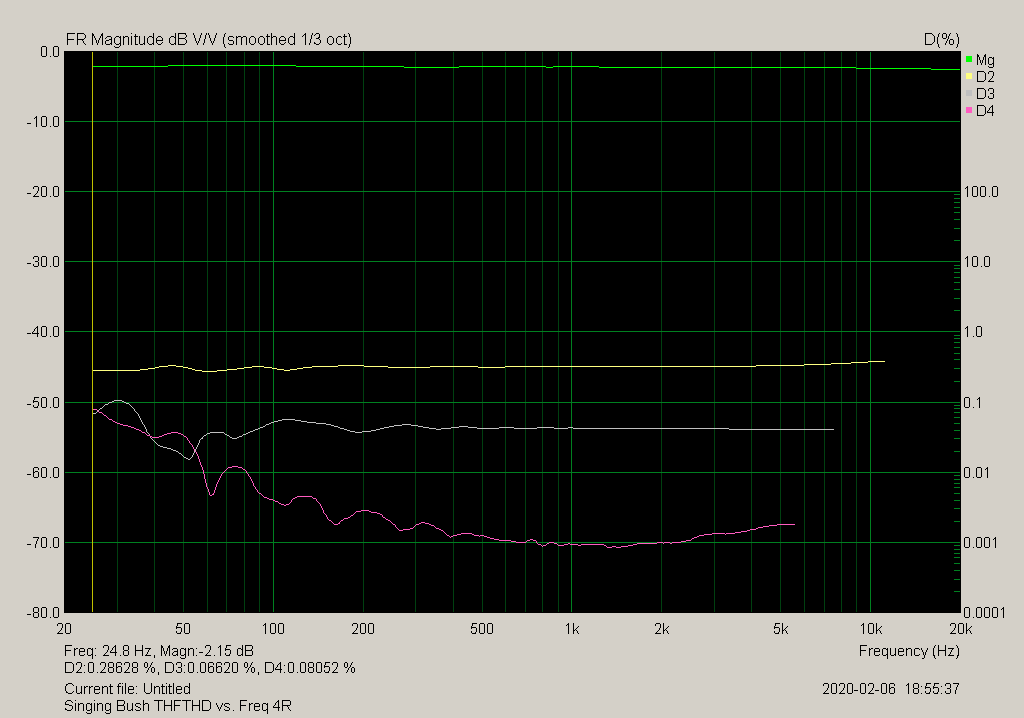

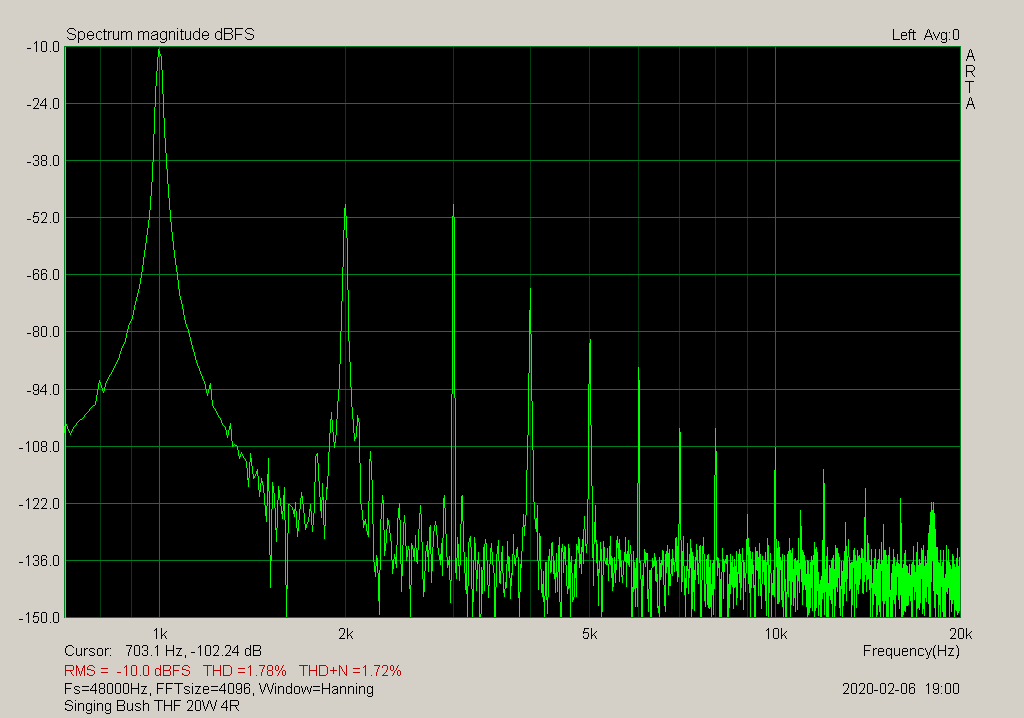

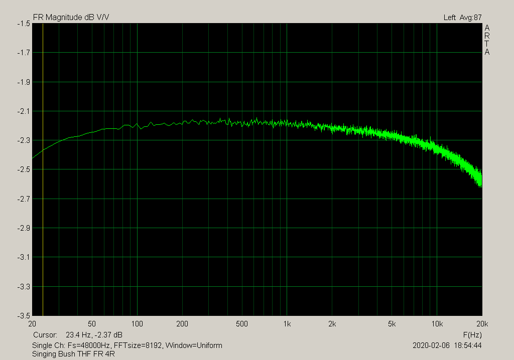

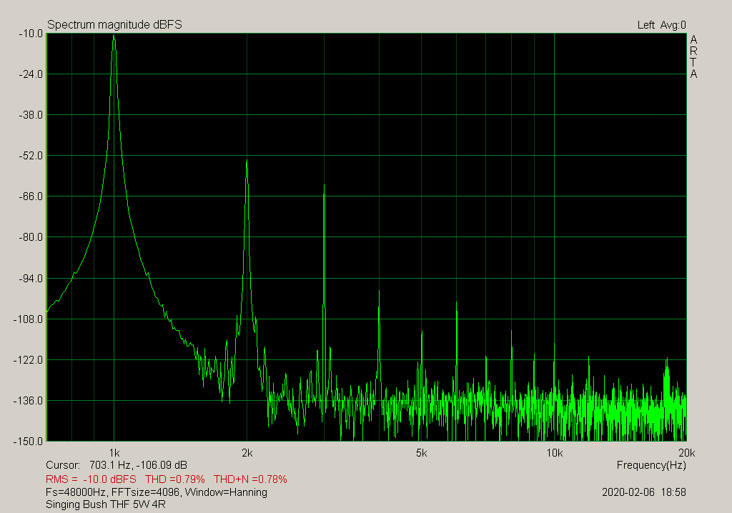

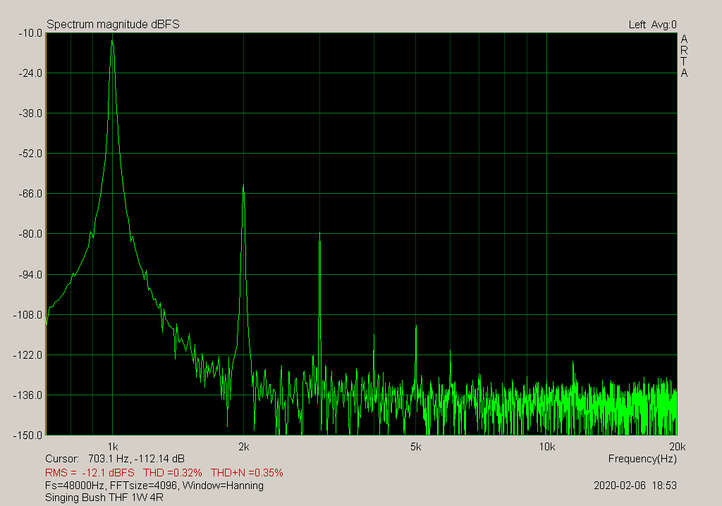

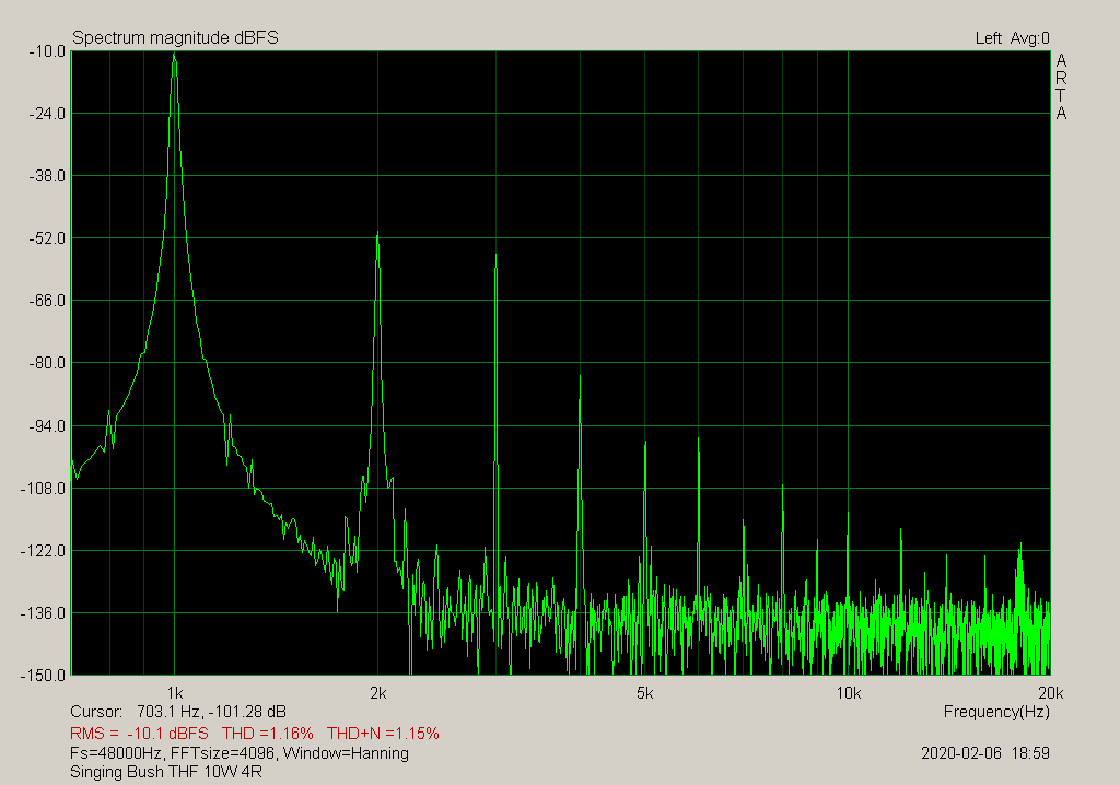

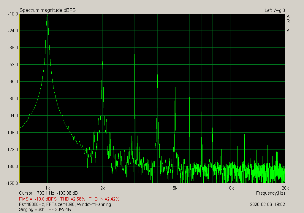

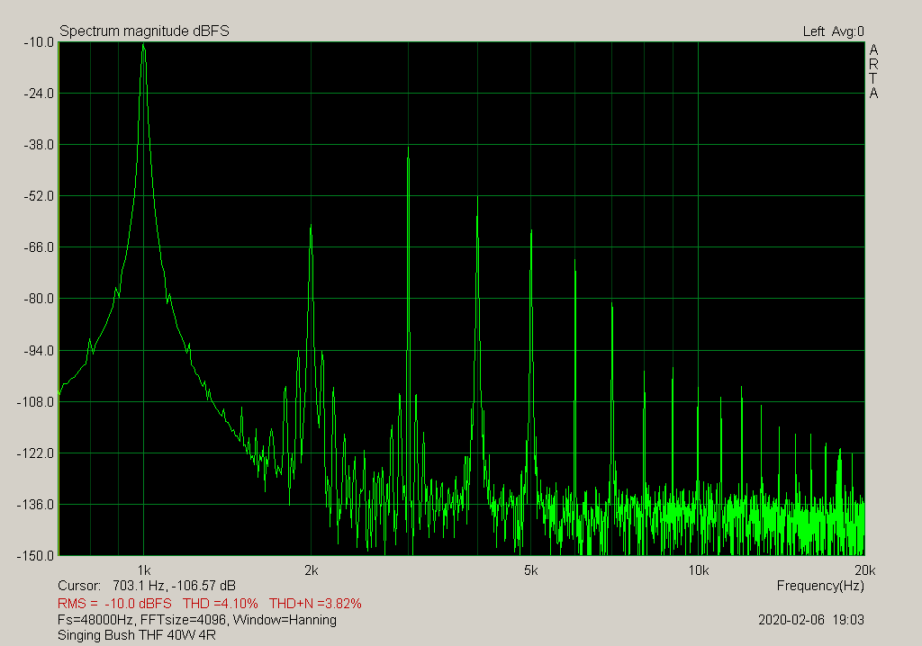

The Singing Bush -THF51ES - yelling!!!!!! cheerfully at 4R
I have no intention to pursue finer tuning than this ( 60V/3A/35VUds) , I'm happy as is
from these graphs you can see:
- Singing Bush THF is convinced that he's Toob amp with Big Cojones , and 4R tap , besides
-slipping is around 40W , and I wasn't in the mood to eek my eyes at that softness ..... nice and easy soft rounding of sine crest .... who cares
